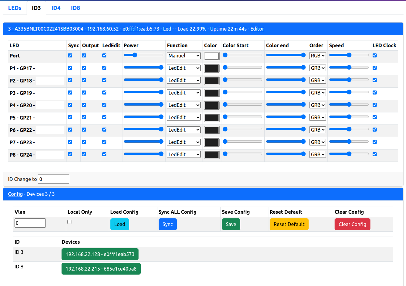

In order to drive the shared memory and extensive Linux application run to manage LedEdit data,  output configuration, some strip doesn't have the same color order, the application can swipe byte to match the same color. There is also test mode that can be activated over the web page to generate color over a selected range of led of a specific output.
The other challange was to distribute the configuration over the BBB's. I one failed, the spare with no configuration should be able to receive the last configuration from this neighbor.
