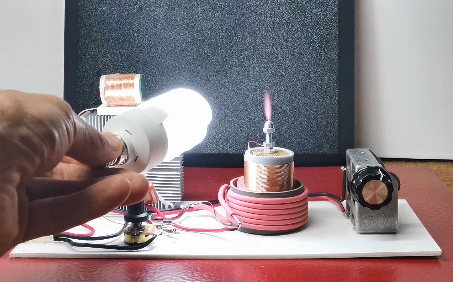

These "plasma flames" are formed by ionizing the air around the Tesla coil's discharge point. This Tesla Coil is based on a Class-E RF power amplifier that’s tuned to oscillate at around 11MHz, and generates about 150kV output voltage. The main advantages of this types of HFSSTC are that it can be powered from a low-voltage DC supply, it doesn’t make much noise and you don’t need to deal with high-voltage primary power supplies.  An interesting property of high-frequency, high-voltage output is its ability to produce a flame discharge, in which the ionised air (plasma) takes on the appearance of a candle flame.
  However, producing  a stable flame is tricky and requires a fair bit of tuning. Now let me briefly explain how the device works.

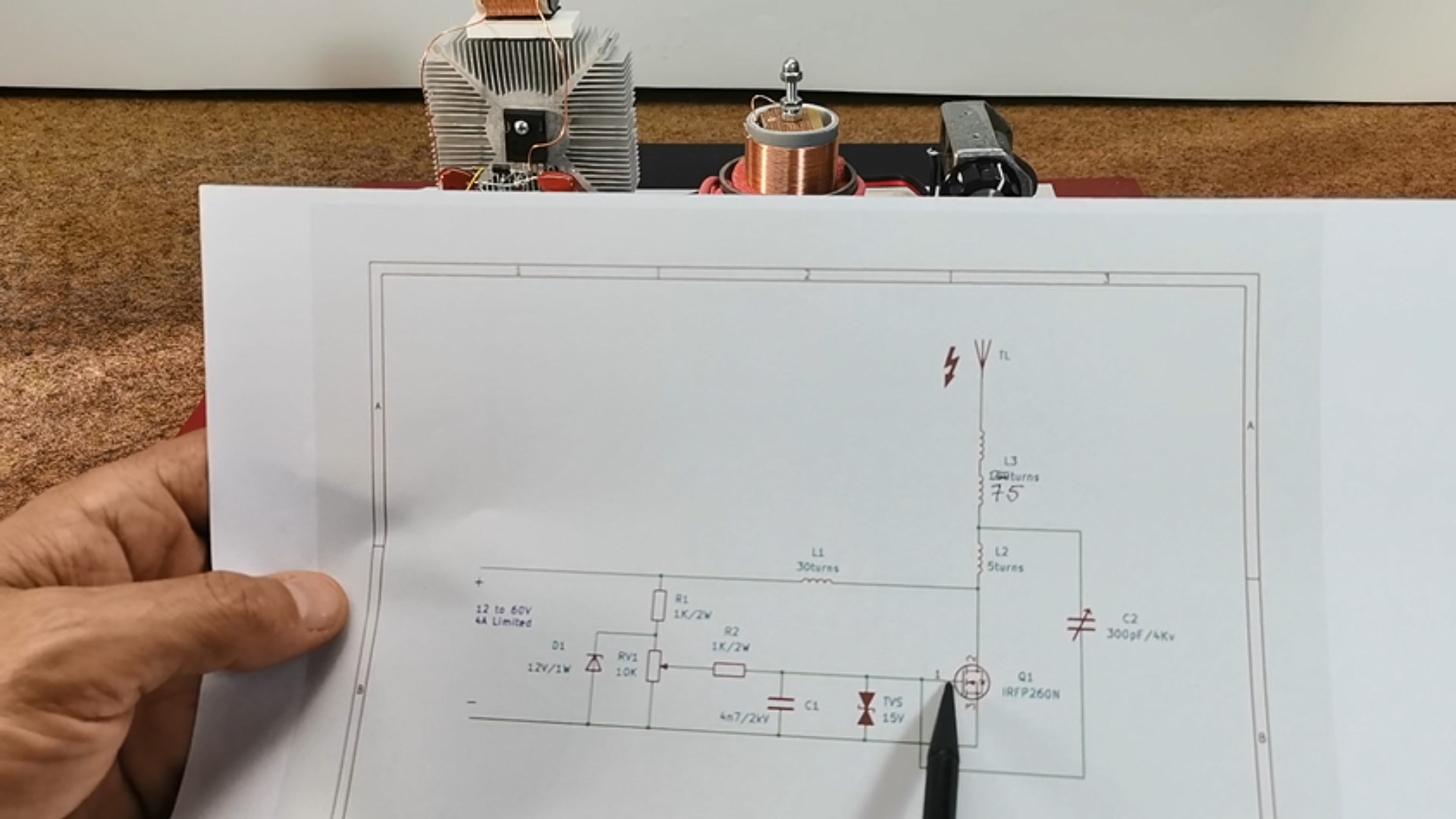

The heart of the circuit is the LC oscillator formed by L2 (2.4μH) and C2 (150pF). The values of these components determine the oscillator’s frequency. In this case, around 11MHz. The voltage divider formed by VR1 and its 1kohm series resistor generates a 5-10V signal at the gate of IRFP260N Mosfet to start the circuit oscillating. The MOSFET should be mounted on a relatively massive heat sink for efficient dissipation of the generated heat. Feedback via capacitor C2 triggers and sustains the oscillation.
 This year, PCBWay celebrates its 11th anniversary of continuous progress and is organizing several activities. On that occasion you can get exclusive coupons, or you can Start Your PCB Order for Just $5, and get Up to 50% off for 3D Printing & CNC Machining. You also get a special discount on selected items and share your projects with the Community and get the sponsorship amount up to 20 US dollars per project. PCBWaynot only counts years but also builds a legacy of quality, reliability and partnership. Together let's shape the innovations of tomorrow!

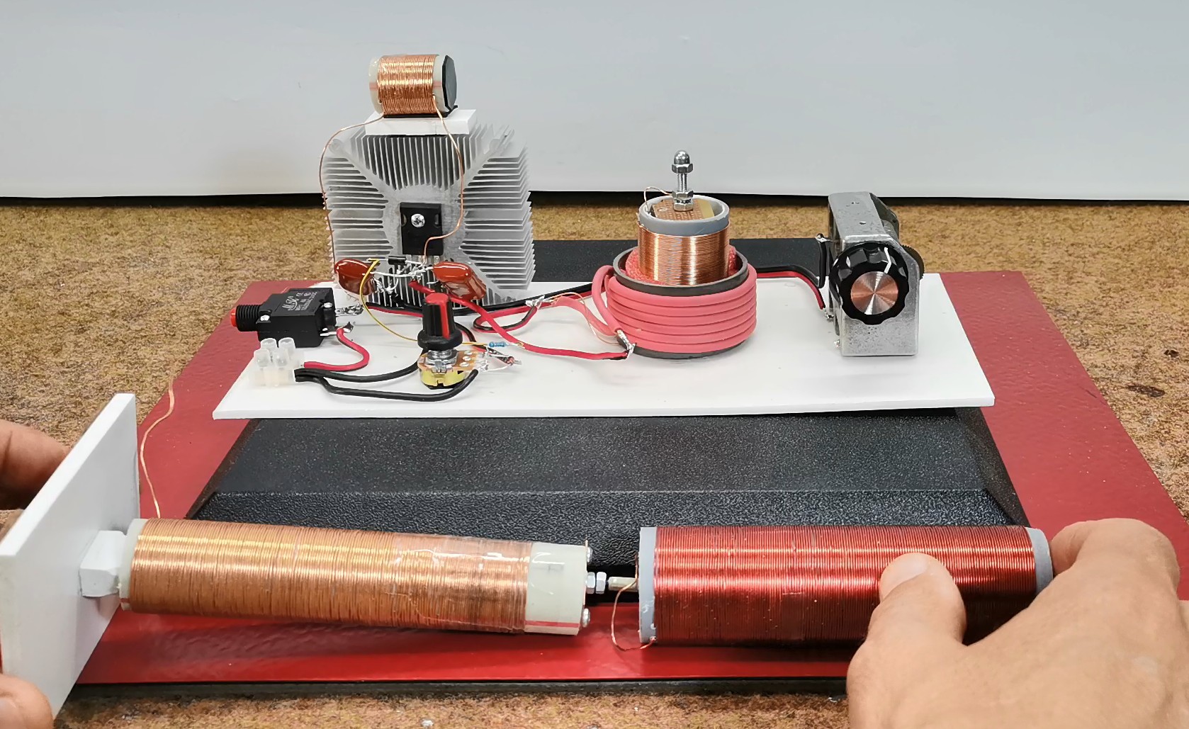

ZD and TVS both aim to prevent the voltage at the gate from exceeding the gate-source voltage specification of the device. L1 have 30 turns of 0.5mm diameter enamelled copper wire on a cylindrical former with diameter of 2.5cm. The primary coil (L2) consists of five to six turns of 1.5mm diameter enamelled copper wire wound on a 5cm diameter former. Instead of a 150pF/4kV capacitor, I used a variable capacitor from an old tube radio, so I can make fine adjustments very easily. For the value of the variable capacitor of 150pF and the primary inductance of 2.4μH gives a frequency of approximately 11MHz. The secondary contains approximately 75 turns of 0.5mm diameter enamelled copper wire wound on a 30mm PVC pipe. An M4 x 12mm stainless steel bolt and a brass acorn nut is used as the breakout point or “top load”.
  During the testing of the device I experimented with several types of secondary coils, with the oscillation frequency of the circuit ranging from 6.5 to 8 MHz. I got the best results with this small coil with 75 turns and I use it in the final version.
 It is interesting to mention that with this setup I managed to generate a plasma flame with relatively low power, specifically less than 70 Watts. In this case the maximum flame length is about 3.5 to 4 cm. As I mentioned earlier, although the circuit is very simple to make, the adjustment should be done very carefully, since we are dealing with relatively high currents and frequencies.  If you have the conditions, it is best to use a laboratory constant current source with a variable output voltage.
   The method of initial testing and adjustment is as follows:
  We set the voltage of the power supply to about 10-12V, and the current is limited to 1A. We set the potentiometer in the far left position and if the circuit has no errors, the current should be approximately 0. We place a CFL bulb close to the secondary coil and gradually turn the potentiometer.
 At a certain point, the bulb should light up, which is a sign that the circuit is oscillating and...
