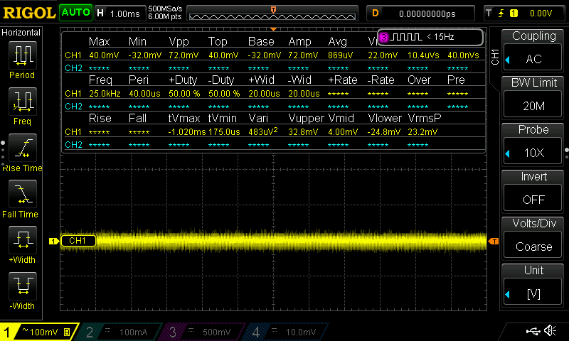

Testing the CH1, CH2 output ripple with load and thermal performance.
Each load test lasted 30 minutes.

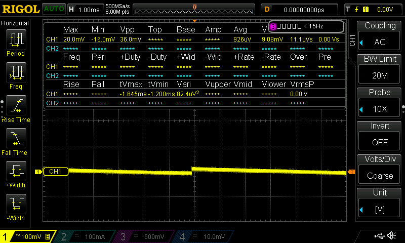

CH2 buck converter output ripple without load (Vpp: 36mV)

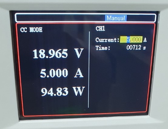

- CH1: 20V/5A (100W)
The USB-C connector and PCB was under 50C

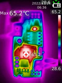

- CH2: 3.3V/3A (9.9W)

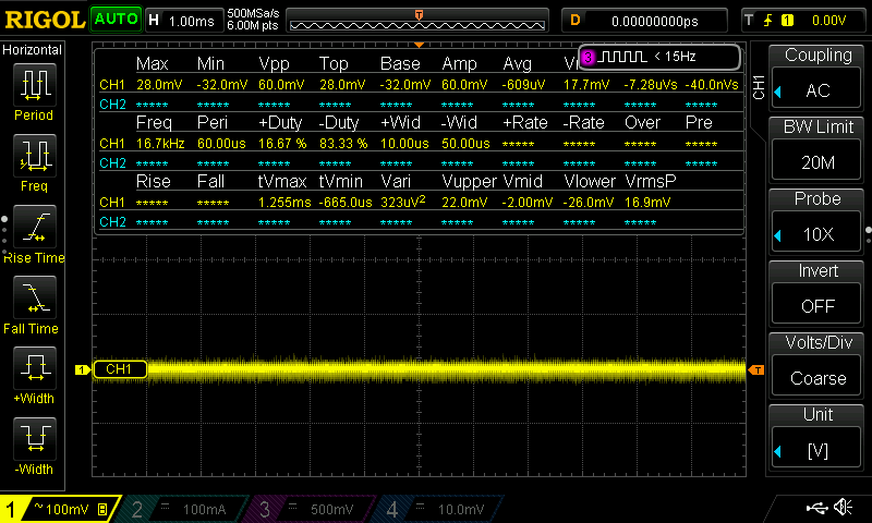

With load: Vpp 60mV
Hot Spot: 65.2C

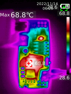

- CH2: 5V/3A (15W)
With load: Vpp 72mV
Hot Spot: 68.8C
