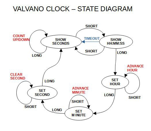

The purpose of this clock is to count the day time in seconds, either up or down. Nothing fancy.
The circuit is built upon an Arduino Nano, a DS3231 RTC module, a SSD1306 128x64 OLED module and one button to select up/down counting an to show and set the time in HH:MM:SS format.
The software uses the DS3231 and u8g2 libraries to interface the RTC and the OLED display, respectively. A custom function debounces the button and return two kind of events: Pulses and Long presses. The user interface is a state machine that ticks every 10ms (roughly) and the states changed depending upon the button events.
