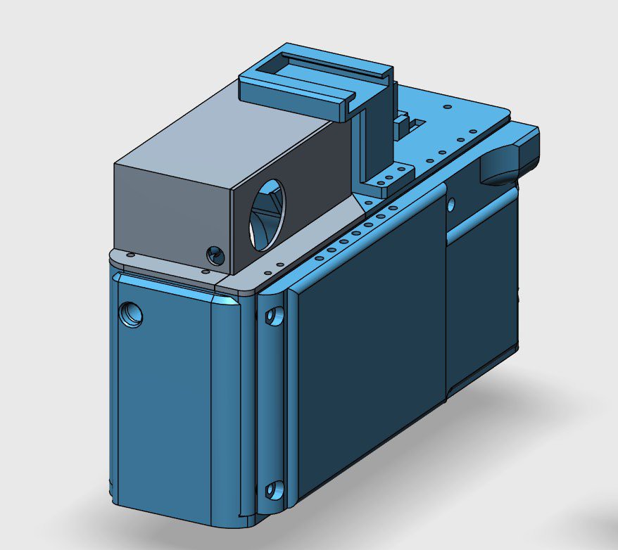

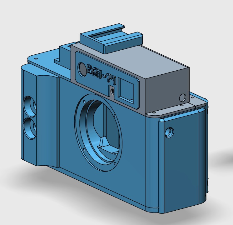

The RGM-79 M Or LTM Digital Rangefinder Camera
Build your own Leica M or Thread Mount Rangefinder now! (BOM typically under $250USD Potentially under $200USD)
This project aims to be the cheapest most accessible way to get into the Digital Rangefinder game. Back in the days of the 2010s it was possible to buy a used Leica M8 or a Epson R-D1 series camera without selling internal organs, but it seems today that isn't the case. As of writing this description in July of 2025 the average used cost of the cameras required to be taken apart to build this camera come in at potentially under $200USD but can be commonly had for $250USD The RGM-79 requires 2 sacrifices: Panasonic GF3 - Commonly had for $100-$120 Shipped on ebay (Plus any customs fees) Fed 5 Soviet Era Rangefinder - Commonly had for $50USD shipped on ebay (Plus any customs fees) The remaining budget would be for 3D printer Filament, and a set of cheap screws (you will need lots) Plus 1 lens adapter (if doing the M-Mount Variant) - https://fotodioxpro.com/products/lm-sne?_pos=4&_fid=82ac7dba6&_ss=c

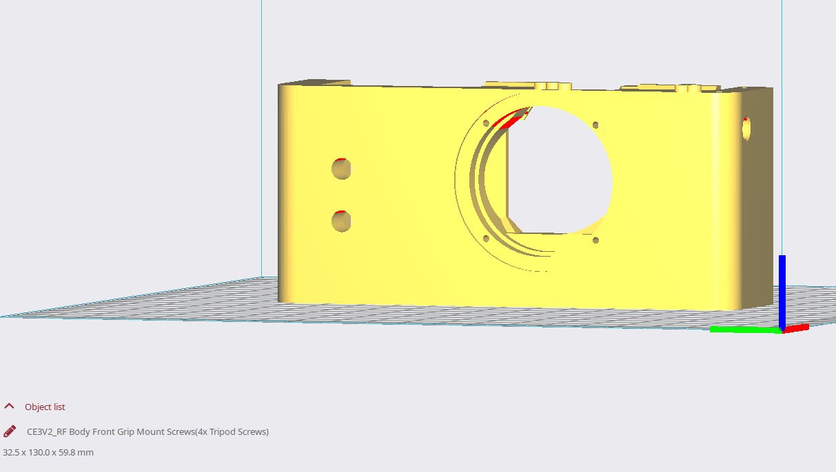

Here's also where I'm going to put the configurations for the prints

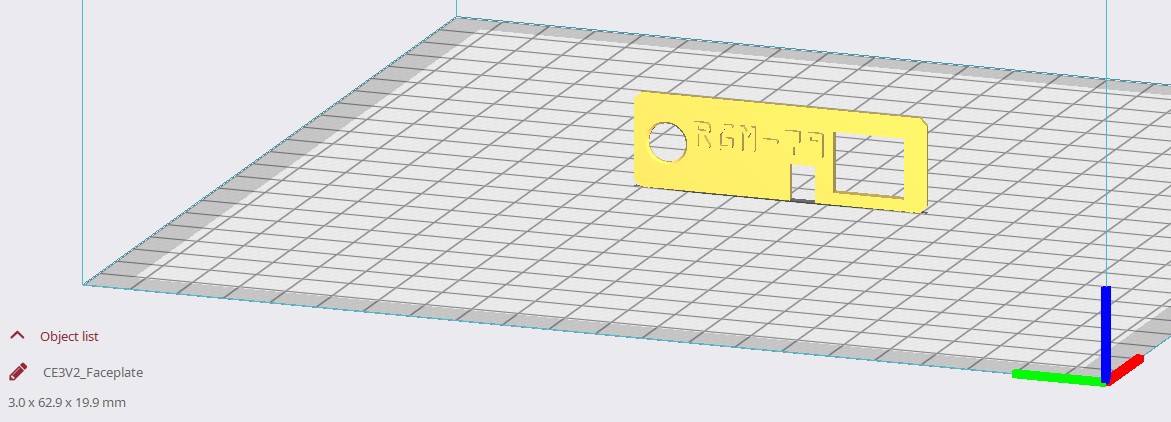

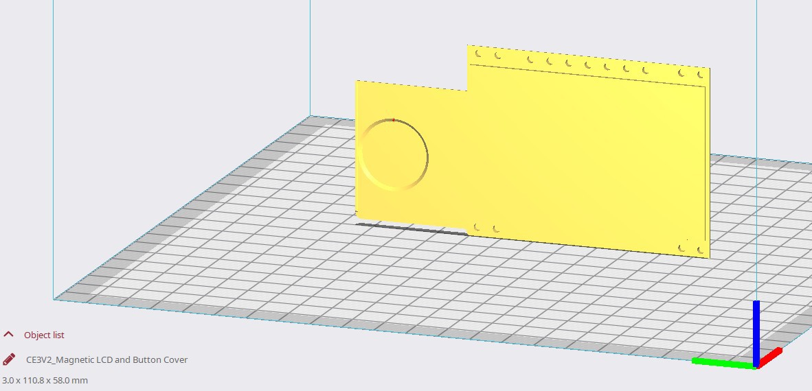

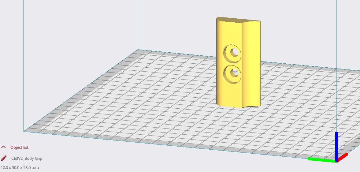

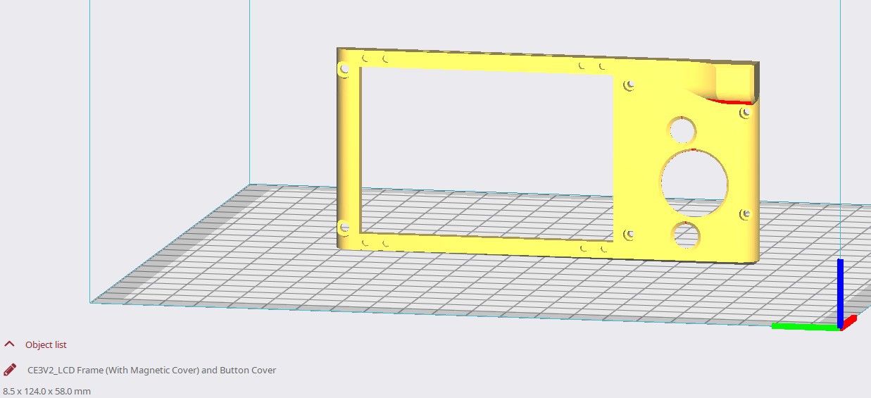

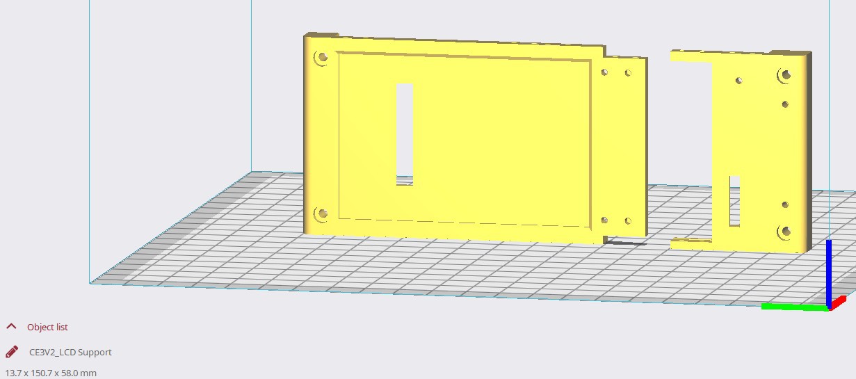

Print option 1 - Rangefinder, Yes Front Grip, Yes magnetic screen cover. Cold shoe optional
Print the Following
RF Body Front Grip Mount Screws(4x Tripod Screws).stl
Body Grip.stl

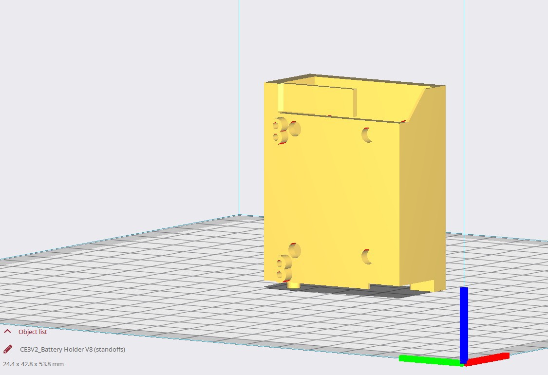

Battery Holder V8 (standoffs).stl
LCD Support.stl
Rear Button Panel Support.stl
LCD Frame (With Magnetic Cover) and Button Cover.stl
Magnetic LCD and Button Cover.stl
Batt Cover 2.stl

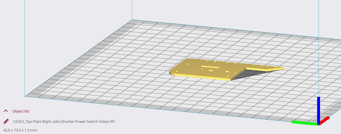

Top Plate Right side (Shutter Power Switch Video) RF.stl
Shutter Button.stl
Video Button.stl
Power Toggle (Thin).stl (Or Thick)
Shutter and Video Button enclosure.stl

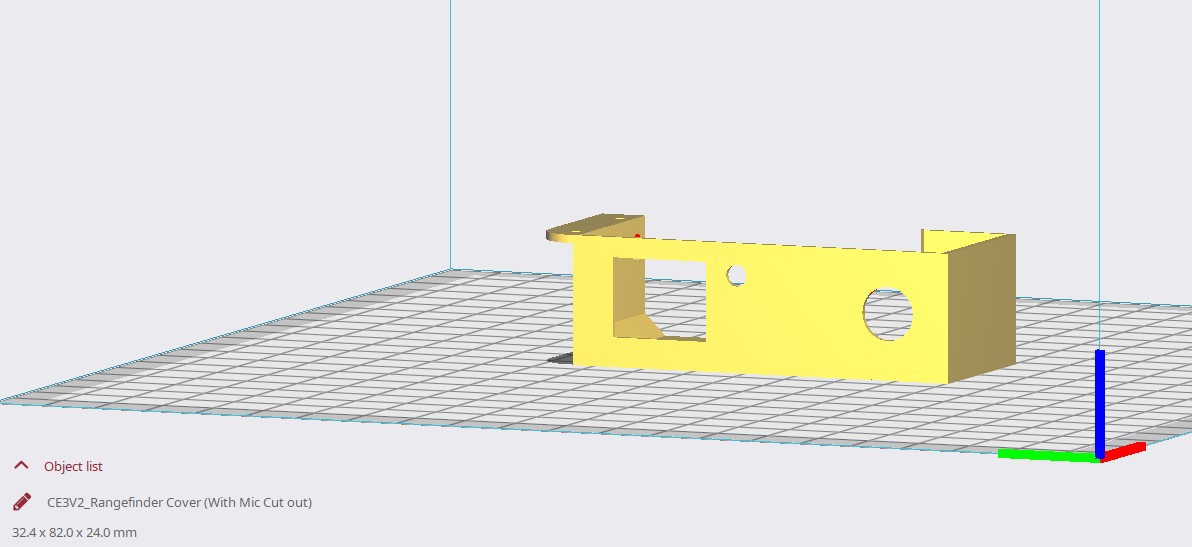

Rangefinder Eyepiece Cover plate.stl

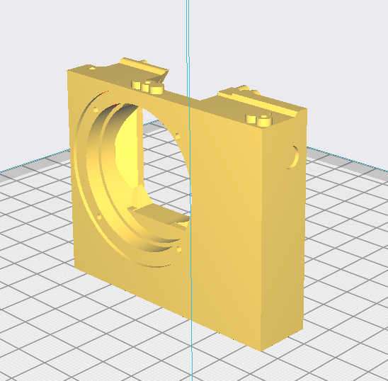

M Body V2.stl
M-Mount Variant
application/vnd.ms-pki.stl - 5.93 MB - 08/10/2025 at 02:48
Download

    In order to better accommodate lenses that recess into the camera I've cleared space in the lens mount the M-Mount body file has been updated as a result, now lenses like the Brighten Star 28mm F2.8 will mount just fine.
  • M-Mount Works!
    Mr.50mm08/10/2025 at 02:53 0 comments
    Good News Everybody!
    This camera can be made into an M-Mount Camera. I've finished the files and will be uploading them as well as build details shortly, expect a video out as well!

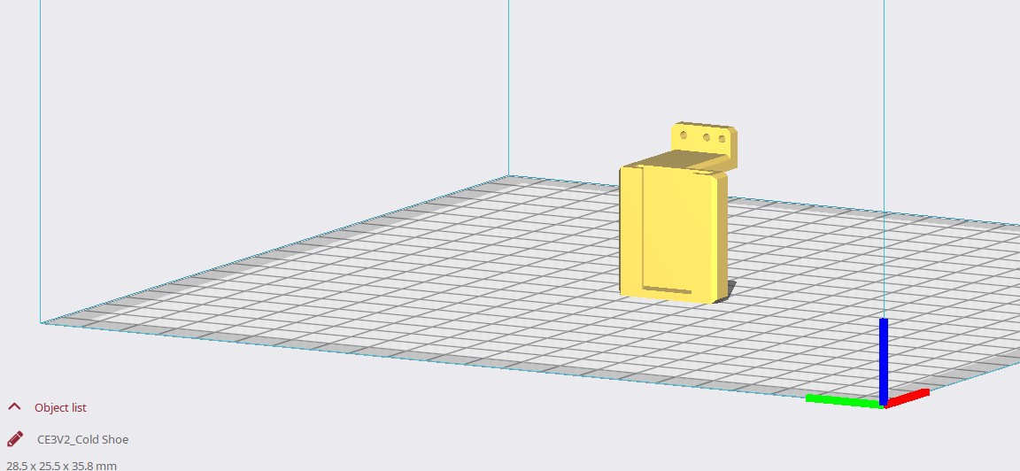

    3D Print Orientations
    Parts are labelled in the bottom left corner, Most prints are printed in the orientation they load up in, there are a couple that do need to be flipped or rotated for best results.
    Notable exceptions are the Battery Holder, RF Cover, Cold Shoe, Shutter button, Video Record Button, Button Enclosure, Power Toggle
    Printing settings
    Cura Print settings for my Ender 3 V2 have been uploaded to the files list
    Material - PLA (Black)
    Supports - Enabled, Type - Breakaway, Support Overhang Angle - 45 degrees
    Wall Thickness - 8 Lines, Bottom Layers - 8, Top Layers 8
    Total Print time @ 200um layer heights on my Ender 3 V2 was approximately 29hrs with the print configuration using magnetic screen and button covers and cold shoe, with rangefinder faceplate other configurations will be a bit different.
    If you'd like the best surface finish use your printer's best setting, mine was 120um, however parts at 200um also are very nice. The total print time is fairly high if all outer parts are done at 120um

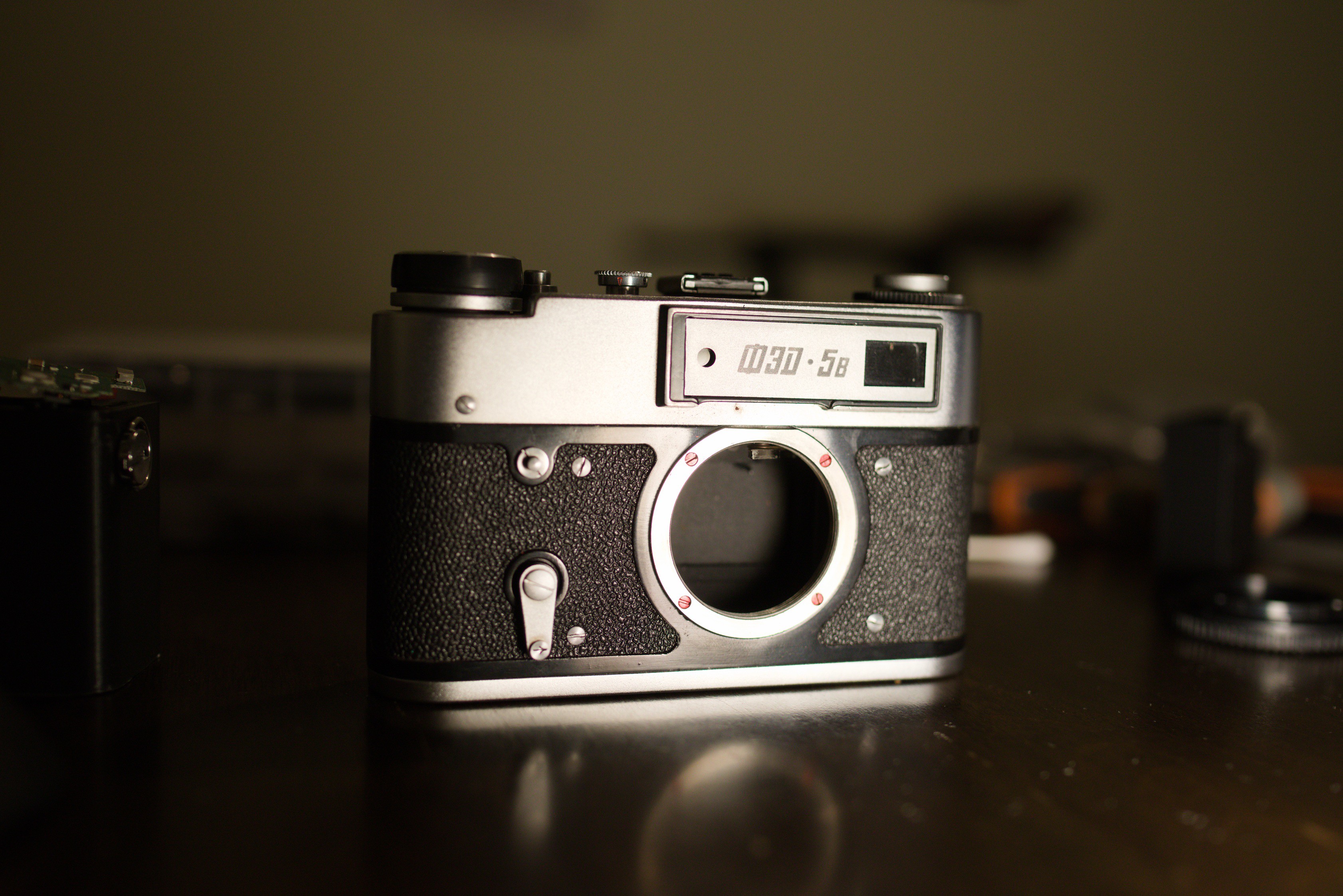

    Removing the FED 5 Leica Thread Mount (Not Applicable on M-Mount Builds)
    This will be the first step, simply get a flat head screw driver and remove the screws on the FED 5 (they tend to be painted red so you can't miss em), before you do so though, beware there are retaining plates that the lens mount screws go into so when you remove the screws you'll probably see them drop out, don't worry we don't need them so set them aside.
    We'll be using the removed mount in the next step to see how your printer is.
