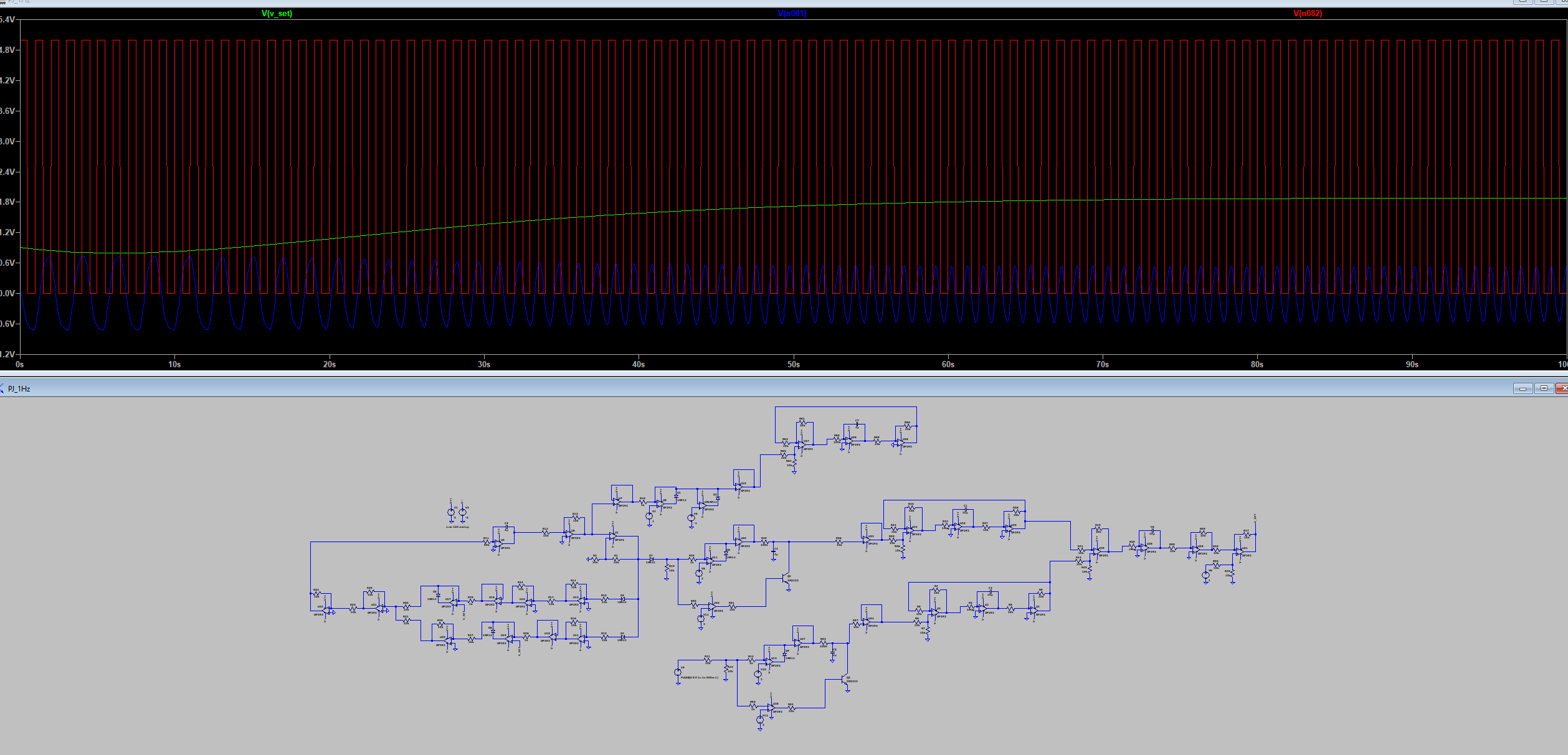

The circuit basically revolves around a classic triangle wave oscillator. Using some shaping and a feedback loop including a precise timer i managed to get a quite pretty sine-wave.
In simulation at least.
Over the course of the 1Hz challenge i will try to build up the circuit in reality and log the results and thinking processes on the logs.
This is my simulation so far using  arbitrary components. The reference clock in red, the setting voltage in green, and the resulting sine-wave in blue.

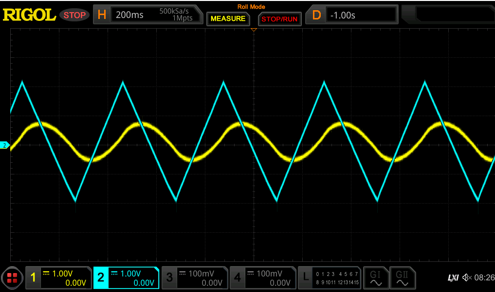

  • results results RESUUUUULTS
    Phil Weasel • 08/18/2025 at 12:00 • 0 comments
    So first assmebly ... power on and ..... nothing.
    The first two hours were just spent with debugging .... or more precisely: finding the few spots where i screwed up soldering.
    After that i spent another hour just tweaking around with the values .... but in the end it paid off:
    What you can see here in blue is the output of the final stage, eg. the sine output.
    You can kinda see how the frequency slowly gets lower towards the wanted 1Hz given from the 555 timer.
    Also the wave itself looks pretty enough for me. Not too much skewed. Im just a bit unhappy with the offset.

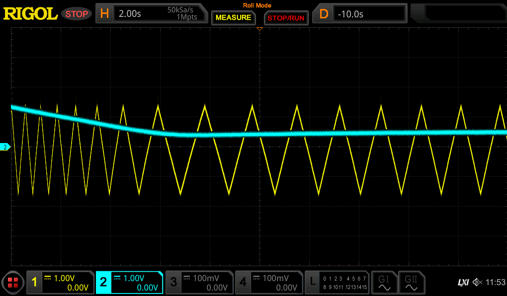

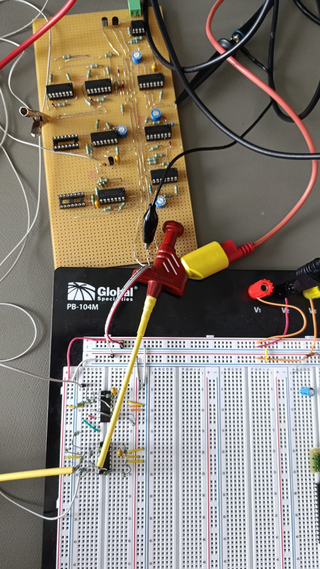

  • Closing the loop
    Phil Weasel • 07/15/2025 at 11:07 • 0 comments
    I went out of space on my perfboard .... and blew my opamp power supply twice .... and broke a thing or two ... maybe even twice.
    So i continued like this:
    Building the reference frequency from my oscilloscope and closing the loop.
    I subtract the voltage from the oscillator from the reference and get an error.
    Another integrator and i added an offset so it wont get stuck on startup.
    The result then gets fed into the main oscillator as a set voltage.
    And .....
    IT ACTUALLY WORKS I CANT BELIEVE IT.
    Yellow = Triangle from oscillator
    Blue = Control voltage to oscillator
    After a few seconds the output actually settles to the given reference frequency i cant believe it.
    Is it accurate tho? well ... no, not yet .... but we will get to that....
  • The frequency counter
    Phil Weasel • 07/15/2025 at 10:59 • 0 comments
    To be able to compare two frequencies we first need to convert a frequency to a voltage.
    One might just use an RC filter .... but at 1Hz thats not feasable.
    So i came up with a different approach.
    I take the positive part of the squarewave output, and charge a capacitor. On the negative half i discharge it.
    Higher frequency = less time to charge = lower voltage
    Lower frequency = more time to charge = higher voltage
    Easy, right?
    On the output we get this.
