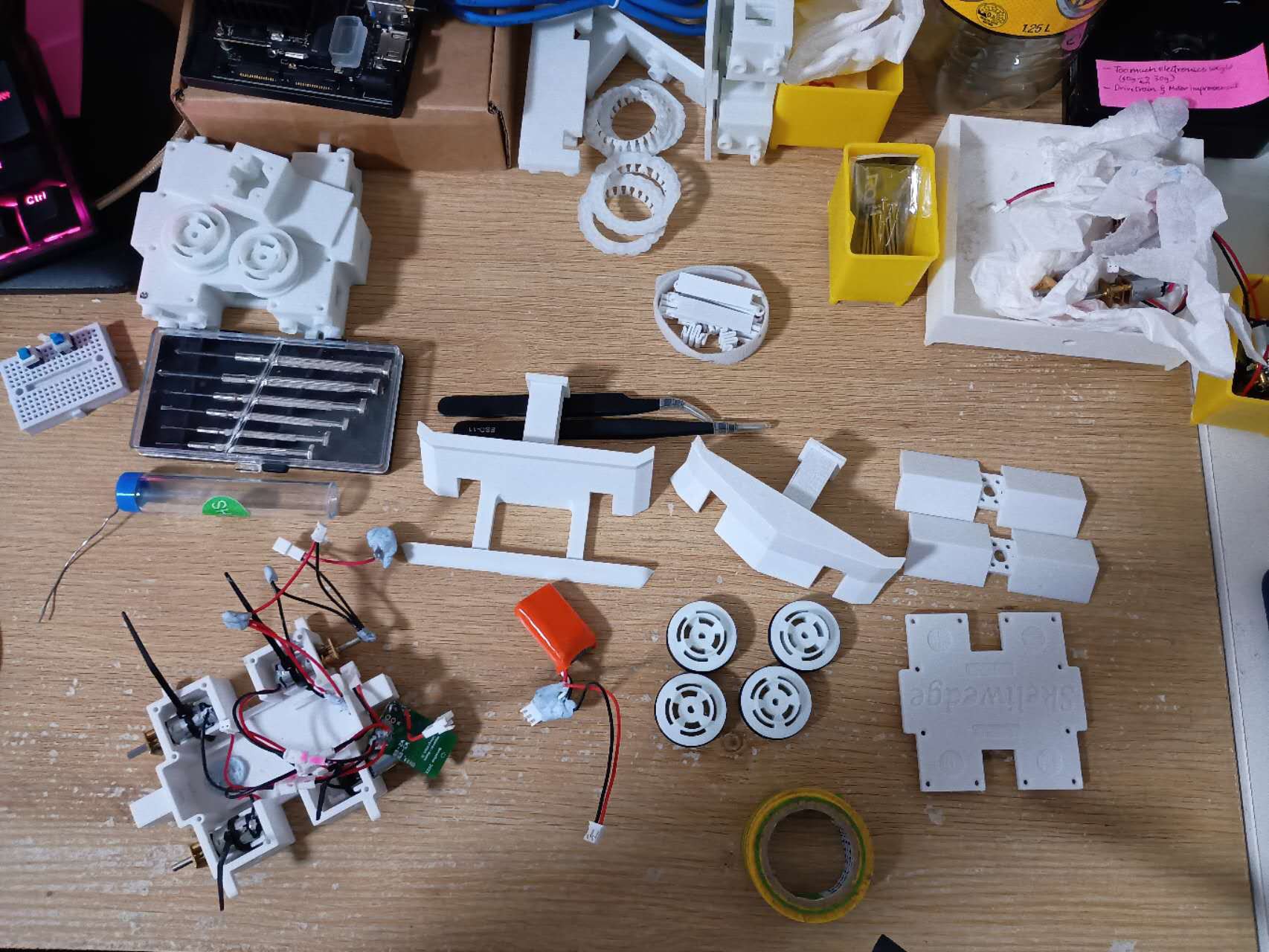

    I was putting in my best effort to finish the robot and prepare for the Sunday's event. I also went to the uni's Makerspace to attempt finishing the prints and preparing the electronics. All my electronics preparation was looking good. However my new ant-switch was not working at all. I ended up swapping in multiple micro-switches. I finally got it to work, but my older solders for motor connectors kept getting loose. In my attempt to fix them, I ended up frying my right side controller of the Malinki.
    I was extremely heartbroken, because with my last Malinki getting damaged, that meant I couldn't bring a working robot to the event.
    After a much needed long sleep and a refreshed mind, I am planning to continue working and improving skeliwedge and prepare it well and way before the next tournament. There is still some work left to do on this front

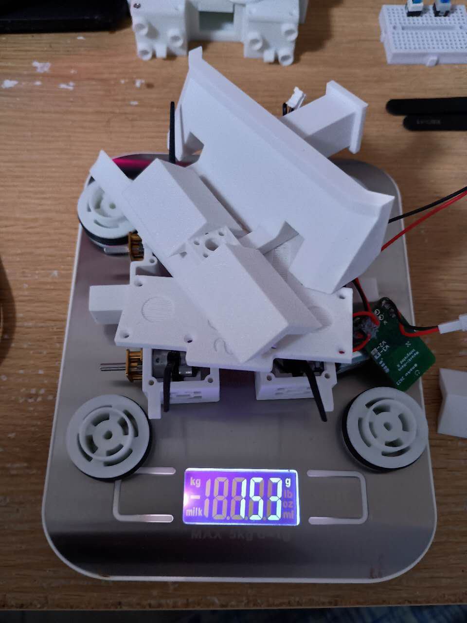

    Going into the last few weeks before the competition, after finishing my CAD design for my current version of Skeliwedge, I started by printing multiple samples of the chassis and testing their weight and strength. These tests showed that due to my electronics and more so the lack of preparation on that side, the weight allowance for physical parts was very limited. My current chassis and wedge parts were way overweight the 150g limit.
    Furthermore my idea for adding metal springs, although being a unique feature, was illegal according to the rules of the Robot Royal Plant class. The rules being a bit ambiguous came out of left field, causing me to look for other ways to implement spring shock absorption. This led to exploration of following options

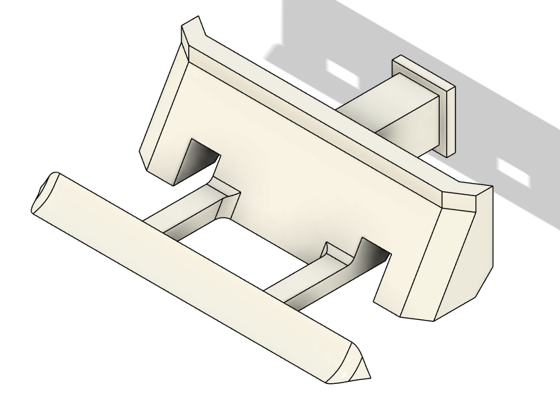

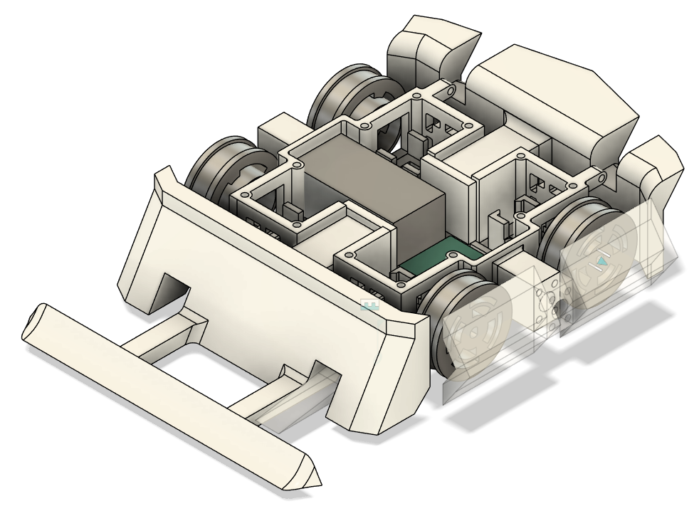

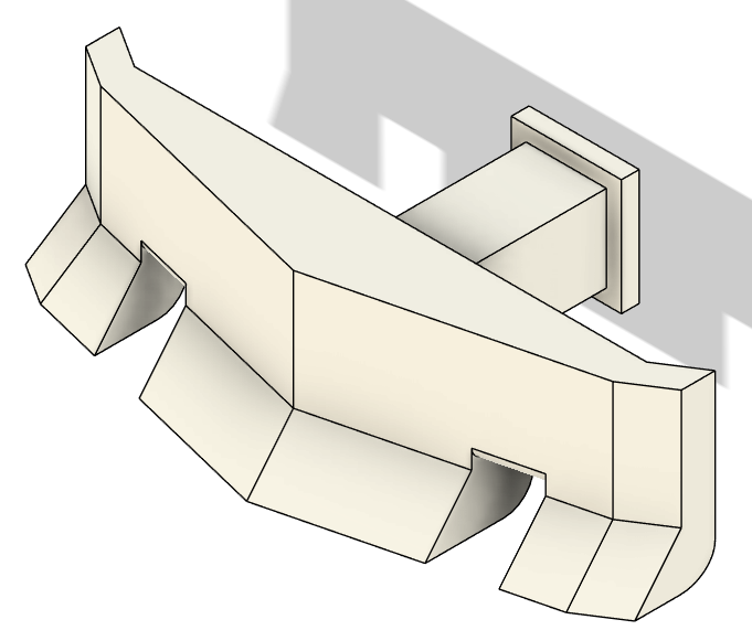

    Following the redesign work and also making changes to the wheel design, I moved forward to designing the key fighting features of the robot, i.e, the wedge and protection parts.
    I wanted to utilize the slot-in style mechanism I used for my previous version of Skeliwedge. Therefore I made a big hole in center section both on the front and backside of the robot. This involves adding a bit more of wall for the wedge attachment's guide and adding the top part of the guide to the top plate.
    Next I thought of adding more free moving forklets just to test their viability. Thus I added small nubs on the front bottom and back top sides of the chassis where I will attach small forklets for ground game.
    I utilized the side holes and the motor-wheel placement to create simple side armor that will protect my wheels from spinners. I need to further polish and design and build final versions of them in PETG.
    As for the wedges themselves, I have just created a template design for them. I need to spend a few hours to finish building and printing the final version in PETG.
    And experimental feature I have added to my current design is shock absorption by the robot using springs mounted between the chassis and the wedge attachments. This is something I thought when trying to come-up with ideas on how to survive impacts from spinner. I feel that this gamble has a good chance to pay against most spinners(overhead saws are still a pain). I have added cylindrical cavities to set the springs.

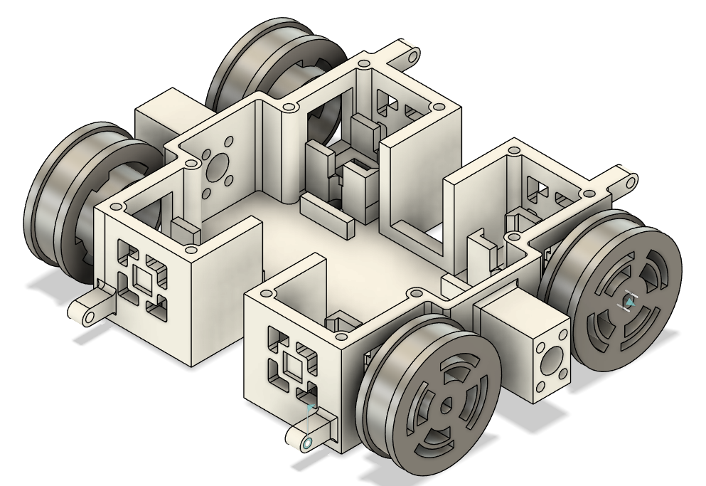

    I decided to first ideate the overall shape of the new version of the chassis. This also involved speaking with one of the more experienced builder. I was advised to increase the width of the robot and reduce the length a bit to improve the turning ability of the robot. I started the CAD process by first taking the base sketch of the chassis from the previous version. I copied and edited the base sketch to get an idea of the chassis dimensions. I also used my paper sketch of the chassis I made previously to get a rough idea of the size of the chassis. From there, I added reference CAD for the main electronics components for the robot and placed and allocated their placements. I went on to also add my reference for the N20 Motor brackets and went on to create the chassis design. I also made the top plate using projections of the chassis' top face. Following that I made side holes for the switch and LED that need to be easy to access and see respectively.
