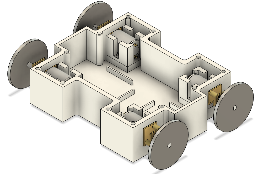

This is my new iteration of Skeliwedge, my 150g antweight Wedge bot

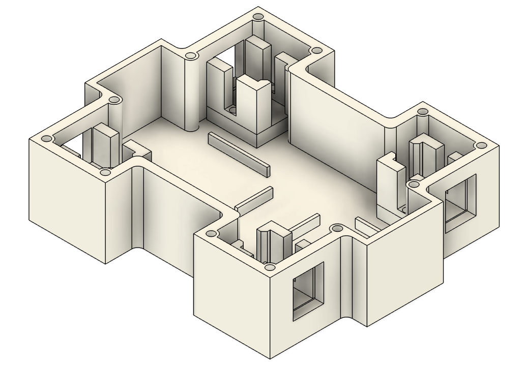

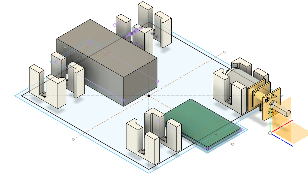

adityaprakash23AdityaPrakash23 • 08/12/2025 at 15:03•0 Comments
