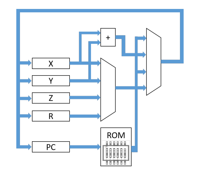

Data path
A distinctive aspect of the architecture is the use of multiplexers in place of a centralized data bus. Each register’s output is piped into a multiplexer used to select the source for write‑back, while a second multiplexer switches the common register input data between the adder, mux output or immediate data. Because every instruction completes in a single clock cycle, control logic is greatly simplified: the opcodes are decodes with a 1-in-4 decoder, and another decoder is used to select the destination register.
