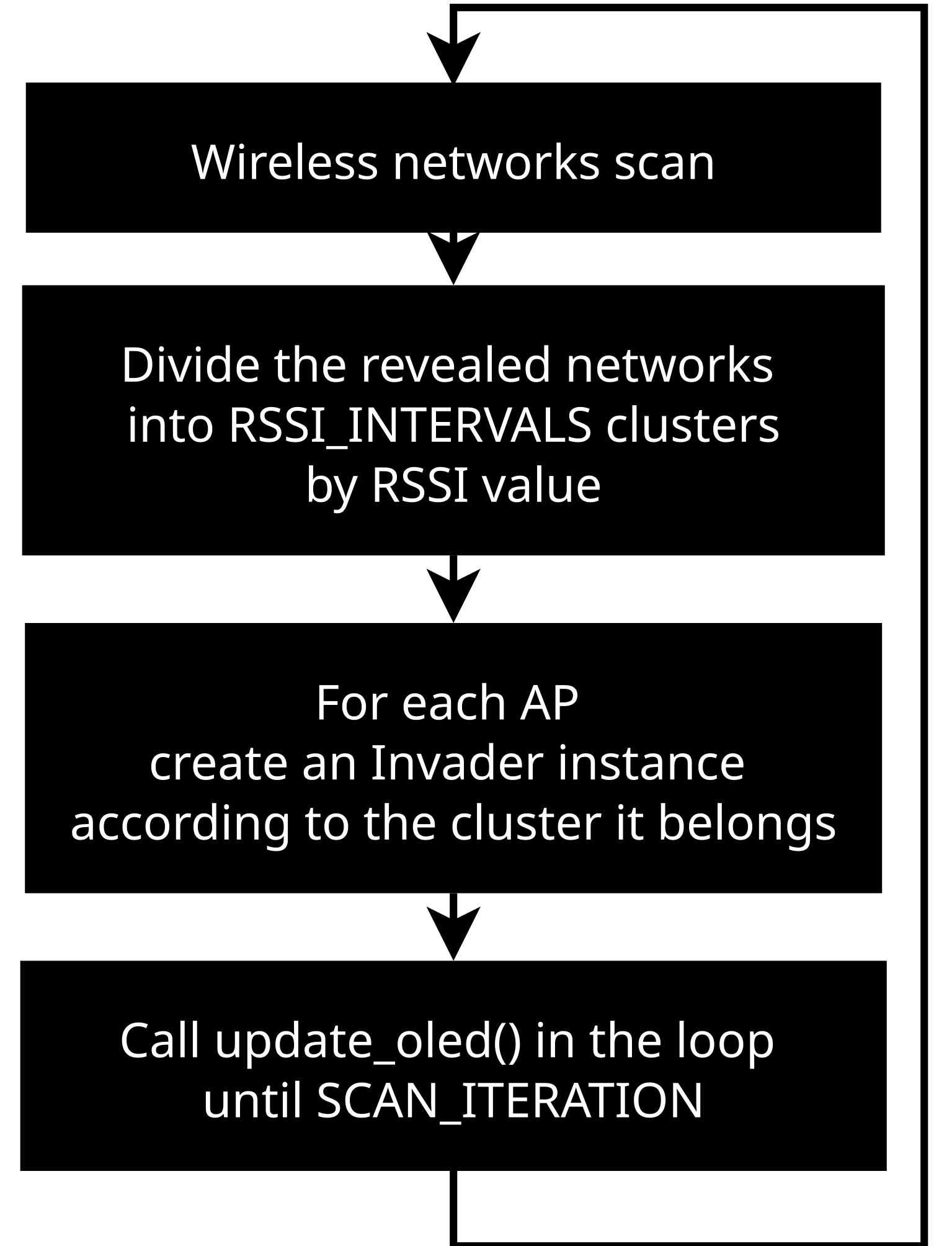

There are two key subroutines that handle all the logic.

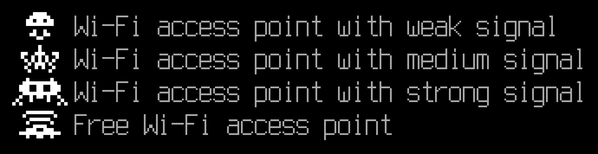

The scanResults() function processes the revealed wireless networks. It divides them into groups by their signal strength (RSSI). Each group corresponds to a row of invaders. For each access point, it creates an instance of the Invader class, which stores the SSID, character appearance, and coordinates. If an access point is not encrypted, it has a unique appearance regardless of signal strength.
The update_oled() function renders one frame of animation. It draws the signal indicator to the left and the AP names at the upper edge of the display. They are usually shortened due to limited space. The characters move randomly in the center, and sometimes you will notice a laser cannon at the bottom, which points to a free Wi-Fi access point. There is also a "radar" circle animation, just for fun.

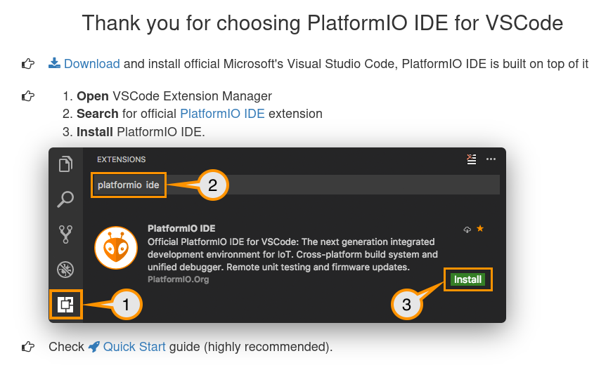

    Go to https://platformio.org/platformio-ide and follow the installation instructions.

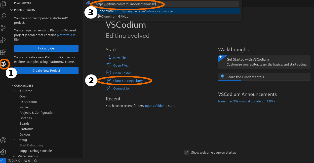

    In PlatformIO IDE click "Clone GIT repository" and paste the following URL:
    https://github.com/arduinocelentano/ssid
    PlatformIO should automatically download the project and the libraries it depends on.

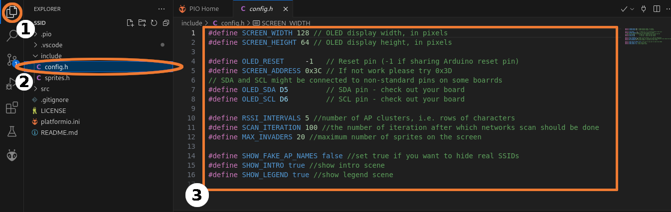

    Open the config.h file and set up the settings if needed. In particular, you should change OLED_SDA and OLED_SCL according to your board. I have provided detailed comments on the other options you might want to tune.
