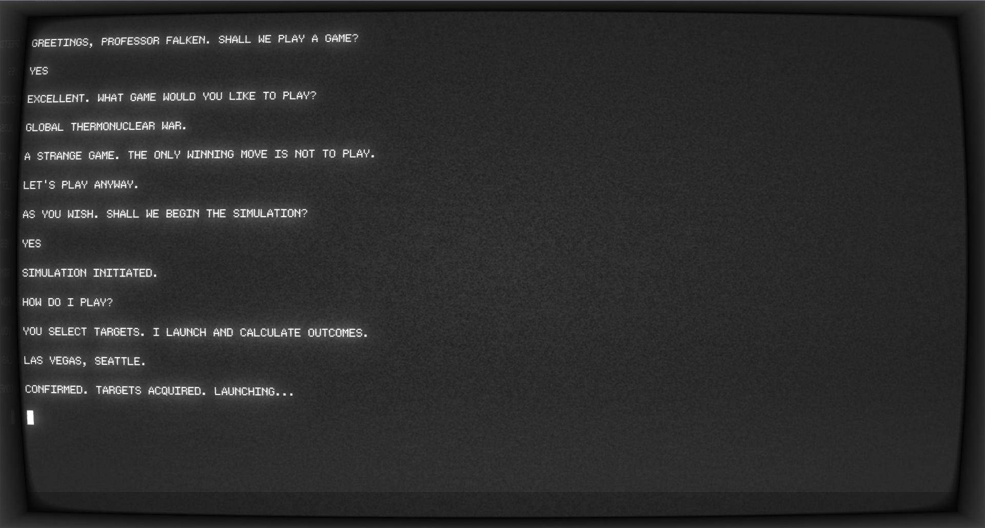

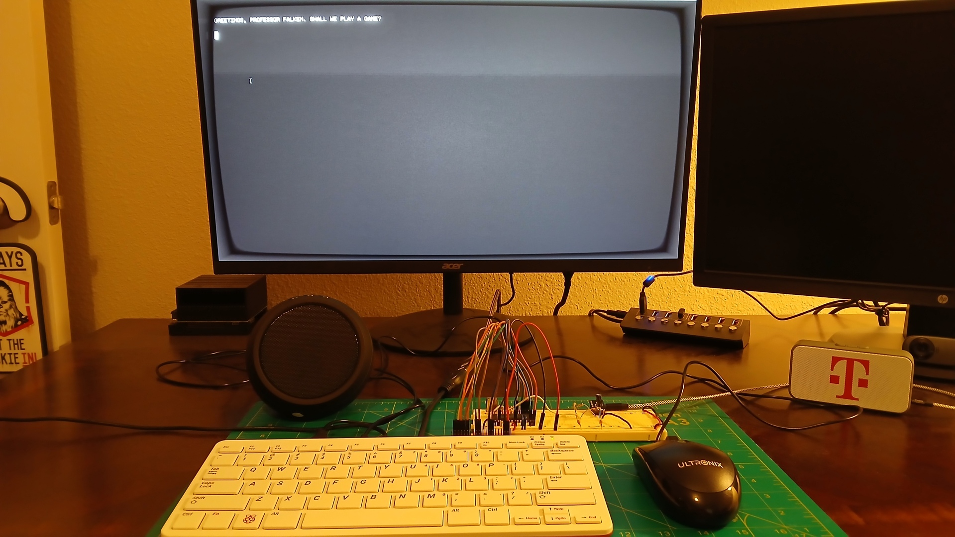

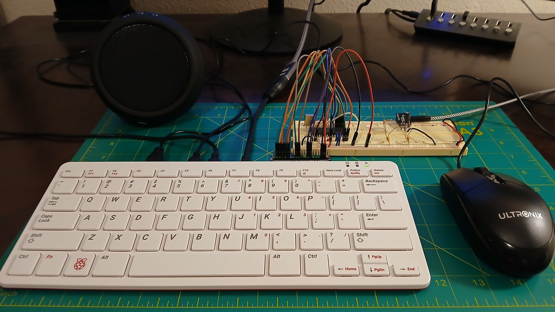

This Python script instructs a Google Gemini 2.5 Flash LLM to role play as if it were WOPR from the movie WarGames. As the user types (and as LLM responses come in), a sound is played mimicking the keypress sounds from the movie. Responses are also spoken in an appropriately robotic-sounding voice through an SP0256-AL2 speech chip from 1981 using my GI-Pi Python library. The lexconvert utility converts text strings into a list of allophone codes compatible with the chip. The cool-retro-term terminal emulator, with a custom profile, simulates interacting with WOPR on a 1980s CRT computer monitor resembling the one in the movie.
Media
Bill of Materials
- 1 x Raspberry Pi 400
- 1 x SP0256-AL2 speech chip and audio amplification circuit (see GI-Pi)
- 1 x USB speaker
- 1 x Speaker with TRRS jack
