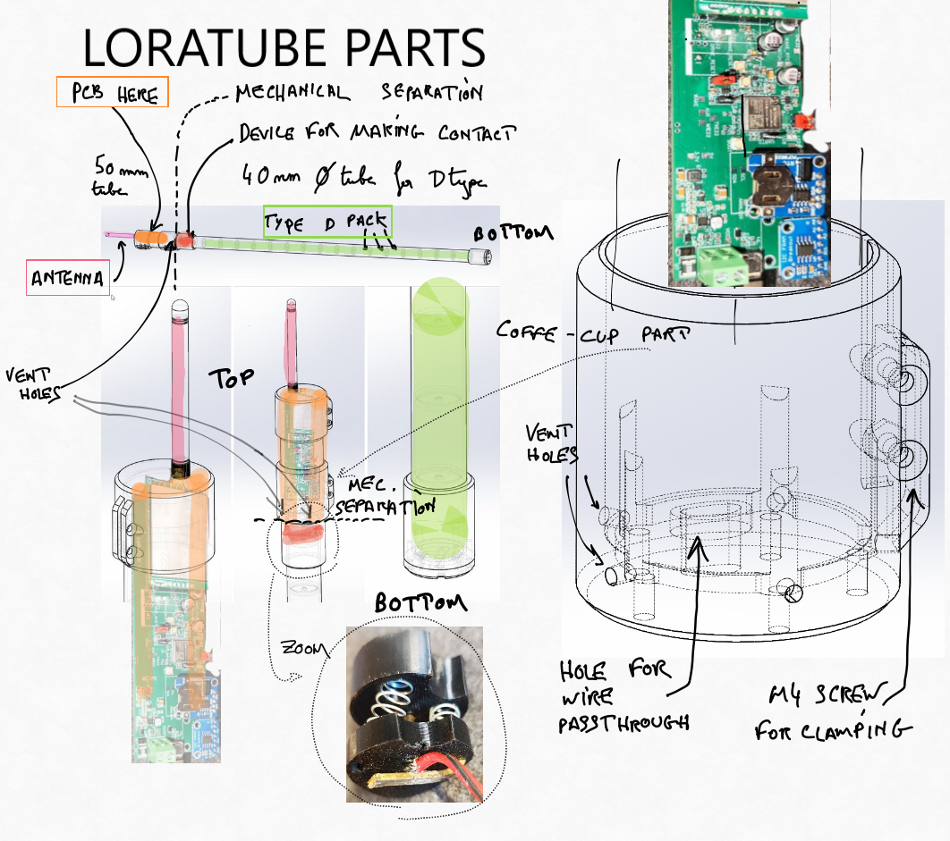

II Protecting the PCB/electronics in case of leakage
The mechanical design answers most concerns:
the PCB is above,
the battery pack is below,
and the two volumes are physically separated by:
the 50 mm “coffee-cup” internal support, screwed into the 40 mm tube,
plus the piece that provides the positive terminal contact for the last cell.
The electronics compartment and the battery compartment are mechanically isolated.
If a cell leaks, the electrolyte cannot reach the PCB.
And if the cells become impossible to remove, the entire tube section can simply be discarded (a 2-meter PVC tube costs around €2).

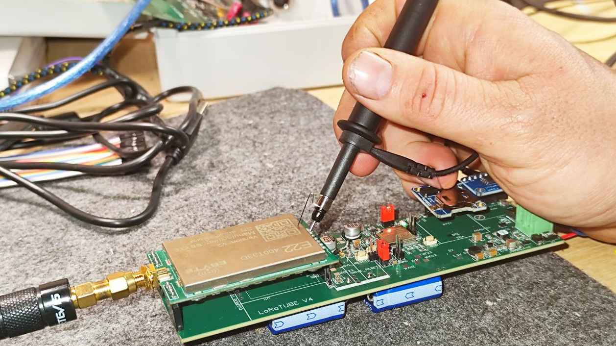

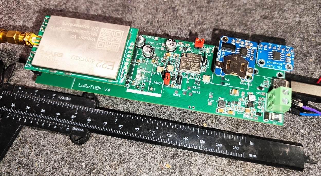

This log takes stock of the bring-up: what works, what still blocks, and what will be fixed in V5.
Power, Supercap and Precharge
On the power front, the foundation is solid: the 5V comes out as expected, and the nominally 3.3V rail is currently about 3.0V. This is actually good for consumption, but offers less brownout margin. Still, in the current configuration everything starts and runs fine. To recover a true 3.3V, for V5 just set R45 to about 267kΩ.
The 5V supercap performs exactly as intended: at 33dBm TX, the buck handles E22 bursts without flinching. On a generous burst of 1000 characters, cap voltage only drops from 4.91V to 4.79V, showing that the buck supplies its max 500mA and the supercap delivers the rest (about 700mA at 33dBm TX).
However, an important point was confirmed for power-up sequencing: if you try to start with the supercap at 0V, the buck sees a near-short, goes into protection and collapses. By precharging the supercap to ~4V before enabling the buck, everything latches instantly and the system stabilizes. V5 will have to integrate this behavior in the power-up strategy (not sure yet how).

Power Rail Noise: PWM vs ECO
I re-did noise measurements with a T3100 probe and a proper ground spring. This completely changes the result from my previous bring-up, where the probe ground was hacked and grossly overestimated the noise (especially in TX, where I picked up noise from the LoRa module’s RF emission).
In WOR mode, buck in ECO, noise on the 5V rail is between 0.8 and 1.6mV peak-to-peak. This is excellent. At 33dBm TX, still in ECO, it climbs to about 6.4mV p-p, with occasional peaks around 7.2mV. Switch the buck to PWM, and you get up to about 8mV p-p. Paradoxically, it's a bit noisier (juste a little bit).
But it’s still very, very good. In all cases, the measured spectrum stays clean, flat, no significant spurs. Conclusion: dynamic buck mode control via PCA9536 expander brings nothing for noise. ECO mode will be the nominal config for consumption, and software control of the buck mode will likely be dropped in V5.
ESP32-C3, I²C Bus, RTC, Expander and UART
On the digital side, everything is OK.
The ESP32-C3 boots and flashes without trouble, logs work, test program hits all the essential hardware blocks and behaves as intended.
The I²C scanner detects RTC, FRAM and PCA9536 expander correctly. Communication is stable, even over time.
On the RTC, register read and write works, CLKOUT is cleanly disabled, and the SQW/INT line is now well-managed: put in Hi-Z when needed, no weird levels or parasitic leakage like during V3 bring-up.
The PCA9536 initializes with no surprises; outputs GP0–GP3 drive E22 power, both LEDs, and buck 5V mode. For V4, this last point is useful for ECO mode characterization, but the final firmware will probably just use a hardware strap.
Radio side: UART1 at 9600 baud works after fixing a missing solder on RX (I'd forgotten to solder the center pin of the E22’s female header). C1 00 07 command returns a header and seven coherent parameter bytes, which validates the C3 ↔ E22 link. TX power register writes work, and a full-power TX test with 1000-char bursts, 2 seconds apart, passes with no issue.

Mechanically everything is OK. The PCB fits cleanly into the PVC tube with the 3D-printed endcaps, all in line with the LoRaTube concept. Everything is secure and seems well-arranged.
Thermally: Continuous TX tests (33dBm, 1000-char frames, 2s pause, several minutes) show the 5V buck just gets warm. The PCB under the converter heats up by a few degrees, barely perceptible to the touch. No hot spots; dissipation appears sufficient for long-term use.

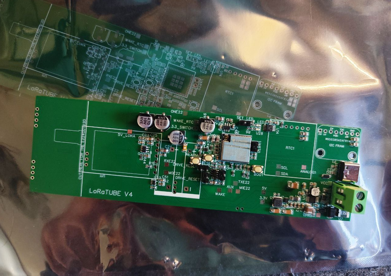

V4 is validated as the hardware base for firmware implementation. All essential functions are there, consumption numbers match the initial goals, power noise is very low, thermal is managed, tube integration is clean.
Some design errors remain : notably the too-nervous watchdog, fuse sizing, and voltage supervisor to be removed, jumper place around TPL5010, but they’re easy fixes for V5.
I received the assembled V4 PCB today, along with five unassembled boards. Many thanks to PCBWay. I’m short on time and have a lot to catch up on right now, but I’ll get to the bring-up soon.

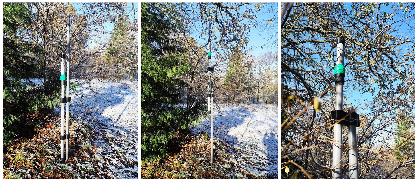

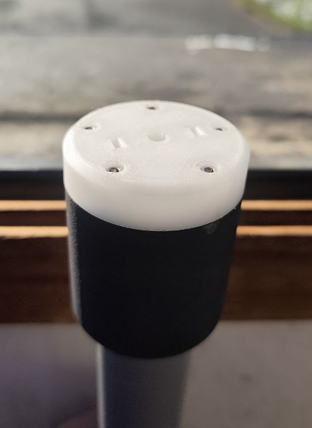

After four months outside and the first cold spells, here’s a status update on the mechanical side.

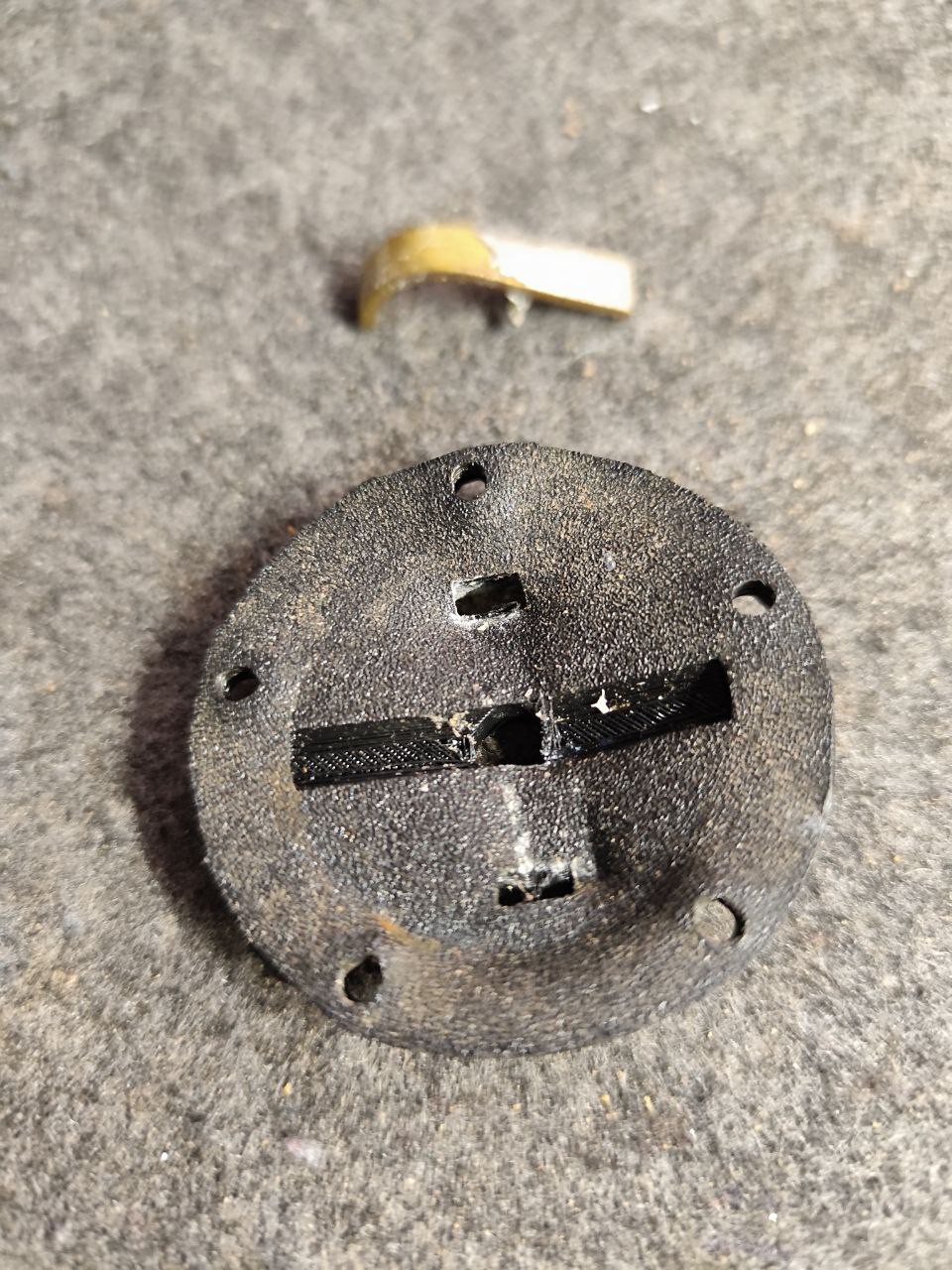

I dropped the LoRaTube and broke the part at the end of the tube (the piece that’s glued to the PVC pipe).
In addition, the end piece of the assembly, the one bearing the weight of the whole battery stack and the contact pressure from the springs, had been printed too “light” and had slowly deformed under load. I redesigned it as a beefier part, matching the diameter of the new glued sleeves, and printed it with higher density (40% infill + gyroid pattern).

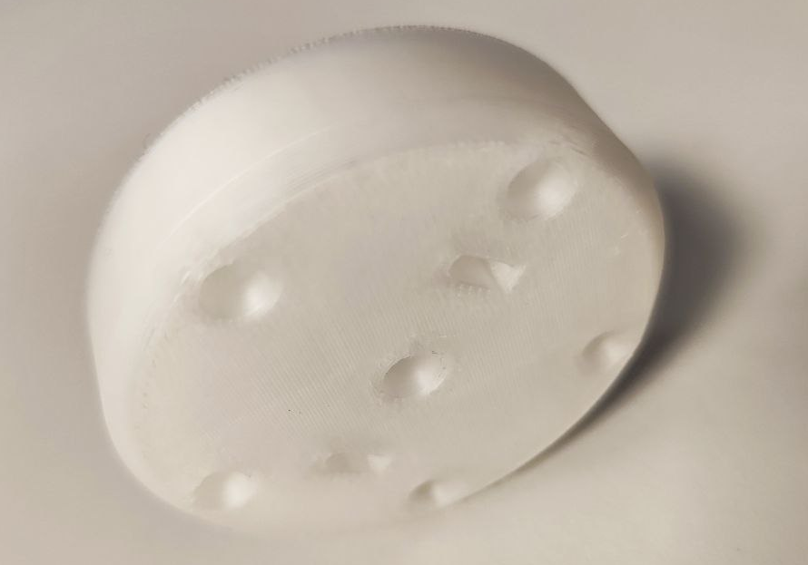

New Design
In hindsight, I had printed it too thin and not dense enough. I reworked the cap as well as the glued end-piece of the PVC tube, increasing the wall thicknesses and printing at 40% infill with a gyroid pattern.
I should also mention that I changed printers, moving from my old Ender 3 V2 to a Bambu Lab machine (huge upgrade). The part, even though it is still PLA, comes out noticeably denser. Under-extrusion on the Ender? Slicer differences? Whatever the cause, the whole assembly feels much more solid now.
Here is the new end piece of the assembly, which both closes the tube and holds the batteries in place. Here are the new end caps for the PVC tube.
And here is the new mounting bracket that holds the 50 mm PVC tube (the tube that carries the electronics).
And the end part of the tube :
I also changed the part that holds the 50 mm tube. It’s thicker, I increased its diameter, and I printed it with 40% gyroid infill as well. It’s the green part in the photos below.

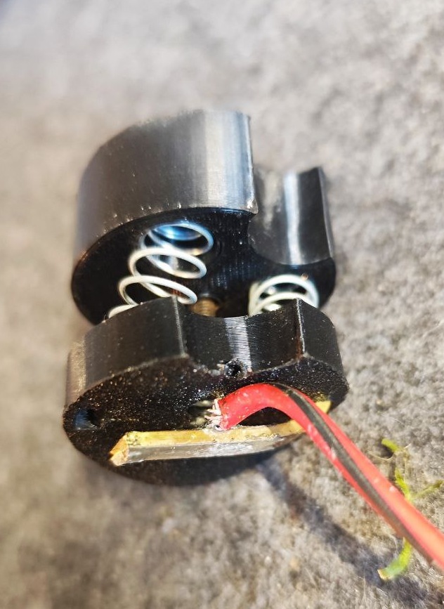

In the last photo, you can see the device responsible for making contact with the positive terminal of the last cell.
It consists of two parts that can move relative to each other. Contact pressure is provided by three compression springs. The travel is about 15 mm. The system looks robust and works well so far…

Here are a few photos I received this morning of the fully assembled PCB, manufactured by PCBWay.
This is Revision V4.
The build quality is excellent ; clean soldering, crisp edges, and a layout that finally looks exactly as intended.
Once the board is in my hands, I will publish a detailed bring-up report for this V4 revision as for the V3 revision: power-on tests, rail validation, firmware loading, radio checks, and early measurements.
The Gerbers and BOM have been sent to production : the V4 is now in production.
This revision marks, I hope, the closure of the hardware development phase and the beginning of firmware optimization.
Next phase:
bring-up of the V4 in few weeks
firmware (il everything is OK) : Focus will shift to thefinite-state control, FRAM ring buffer, and the orchestration of wake/sleep cycles with deterministic timing and energy budgets.
Many thanks again to PCBWay for their continuous support in this next iteration.
