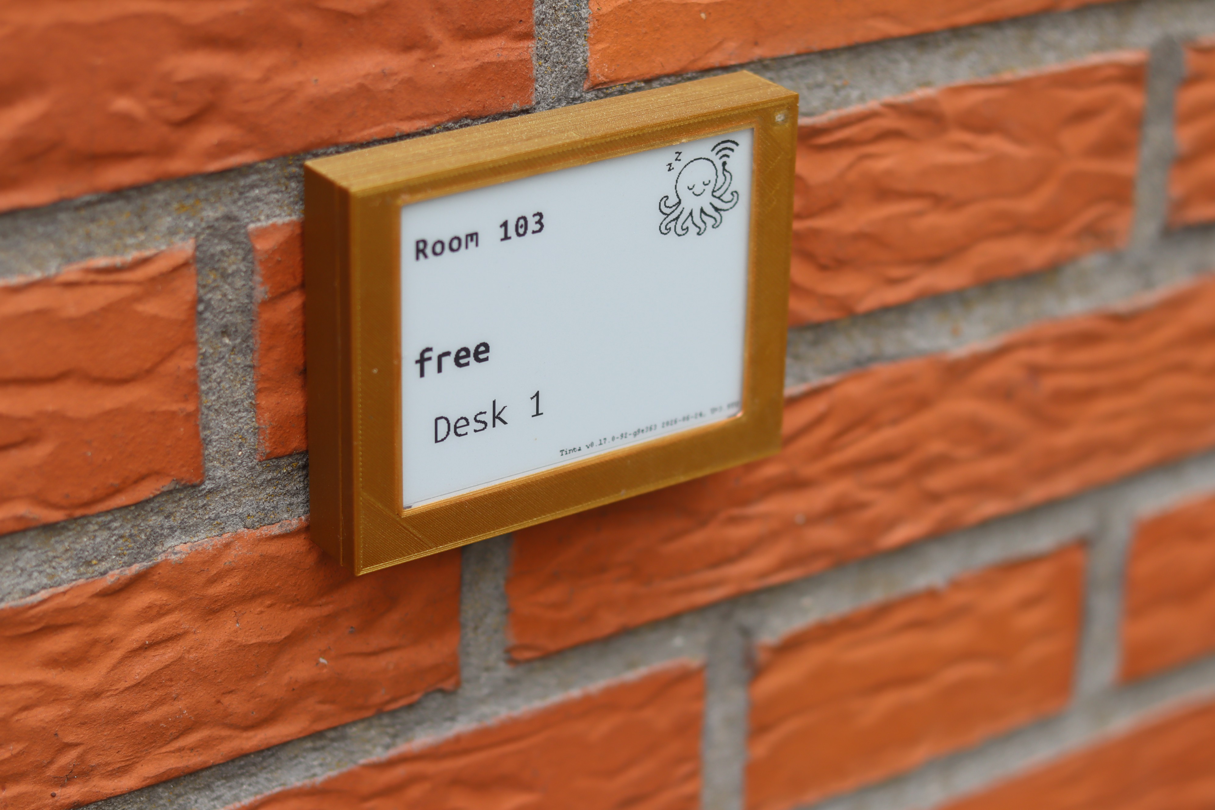

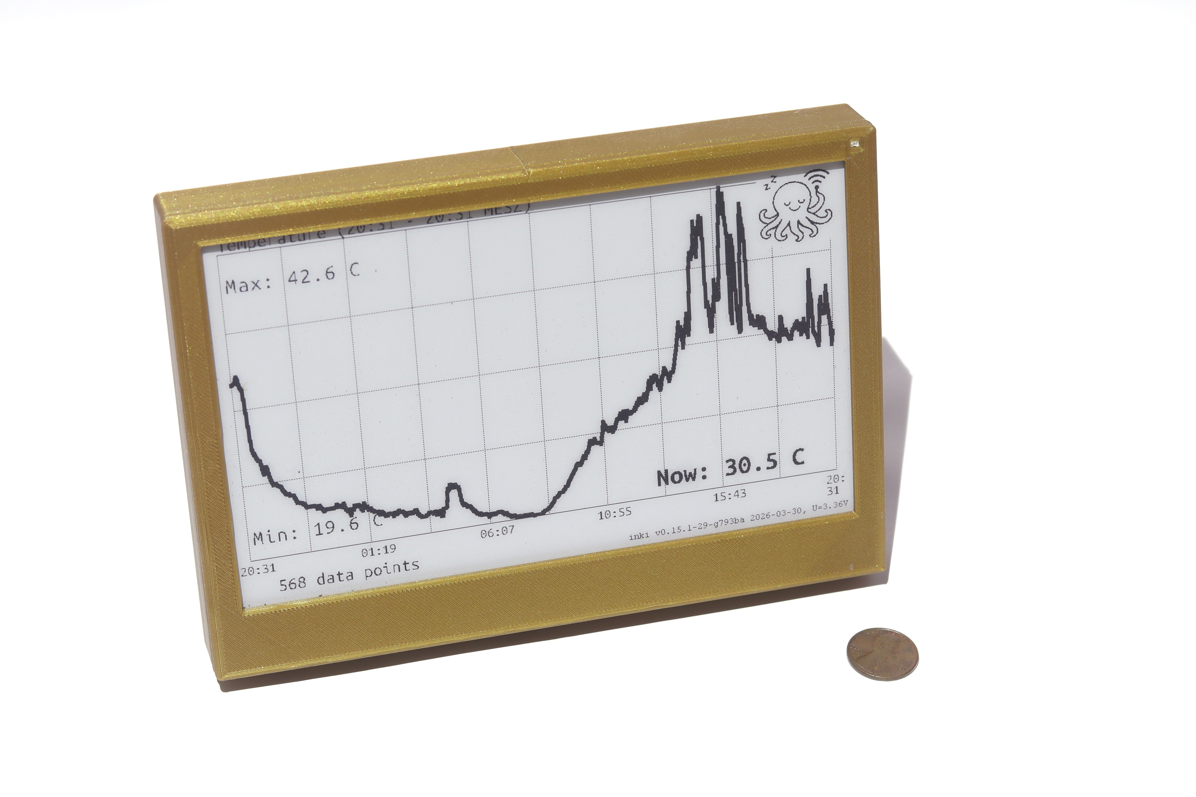

    I designed and constructed the case with FreeCAD, and then 3D printed it on my cheapish printer. The most important figure of merit was that the device can be easily and quickly installed anywhere. This is achieved by a holder that can be either screwed or simply glued to the wall with tape. Onto this holder, the device is then clipped.
    The mechanical connection is provided by a 45° dovetail mount. This ensured that the push buttons on the bottom can be used with the device staying in place.
    I am pretty amazed how well this worked with FreeCAD. As you can see in the animation, the real devices nicely works as expected from the FreeCAD rendering.

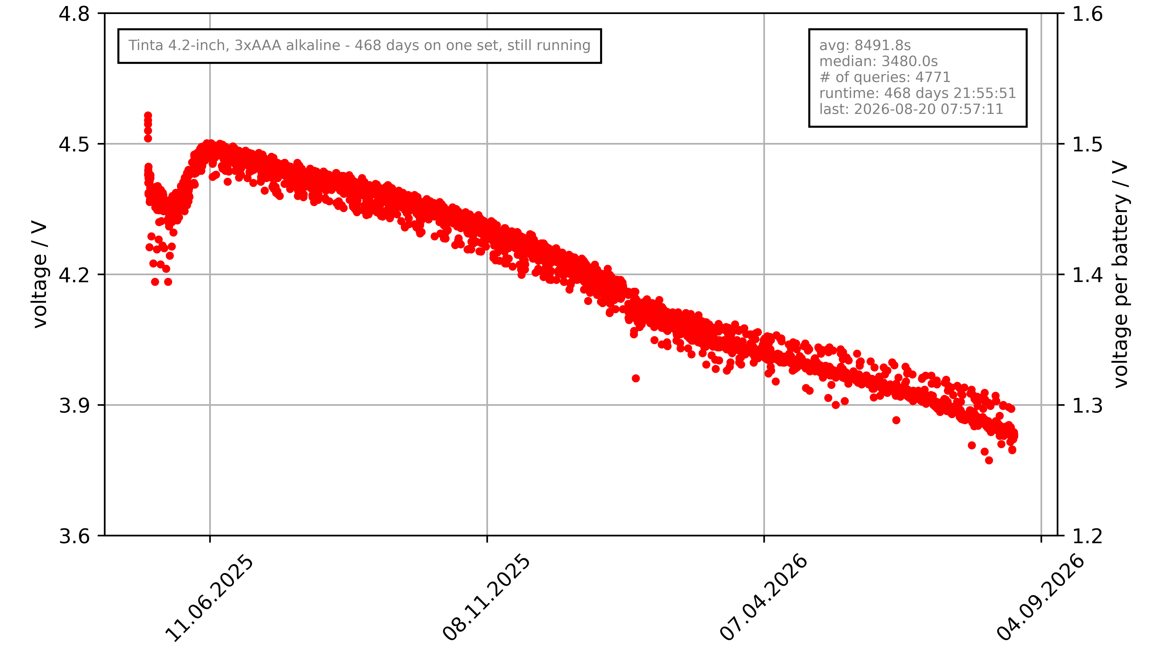

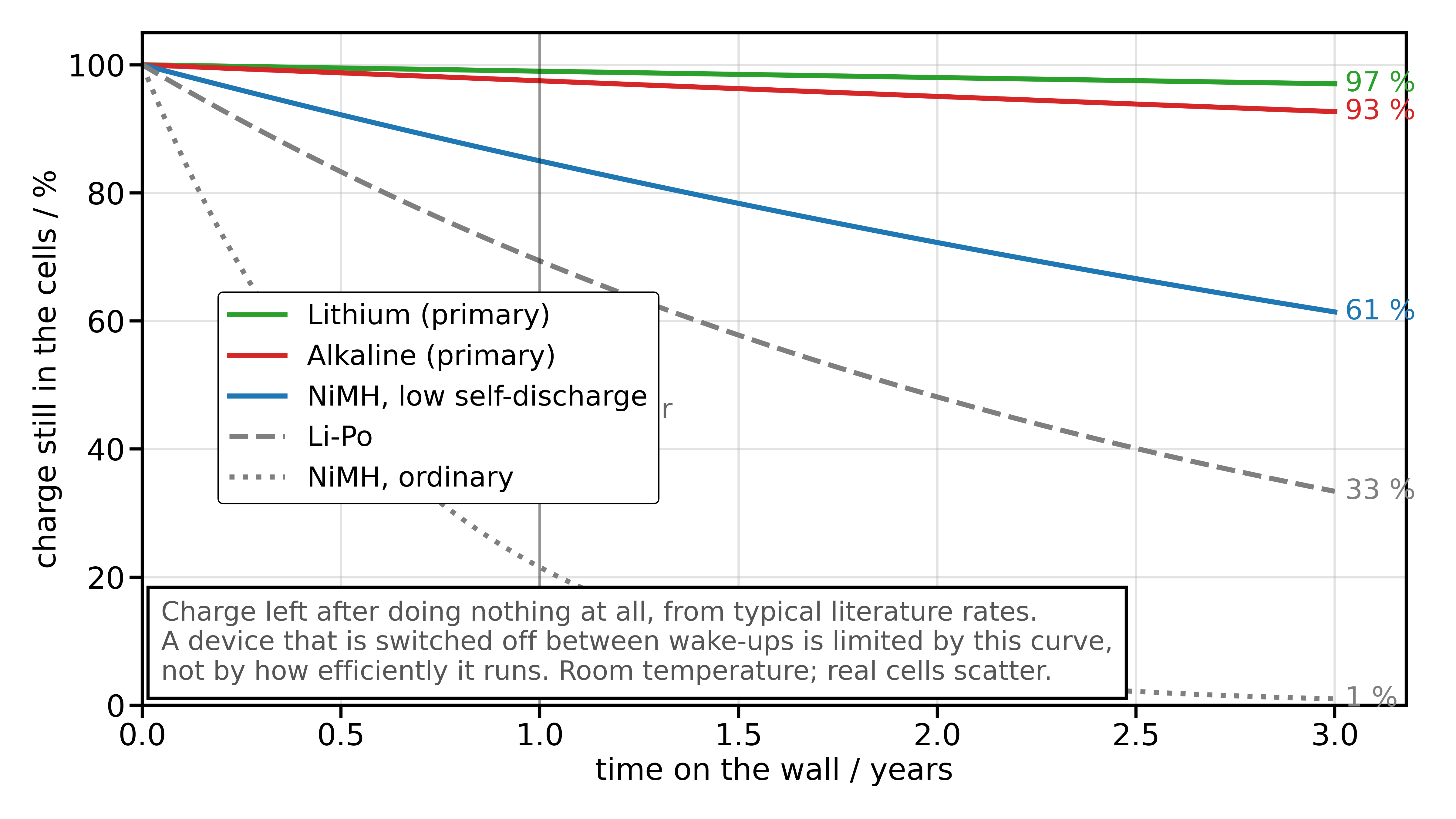

    Tinta's low power consumption relies on switching itself completely off between wake-ups. An easy way to see whether that works in practice is to look at how the lifetime scales with the wake-up interval — or, put differently, whether a set of batteries delivers the same number of wake-ups whether Tinta wakes every two minutes or once an hour. In the very first log of this project I tested exactly that, with intervals of 2 and 30 minutes, and wrote that "battery lifetime is not limited by power consumption in the off-state for these refresh times" and that "lifetimes in the range of years are realistic". That rested on two runs of 15 and 198 days: two points and a straight line through them.
    Log # 2

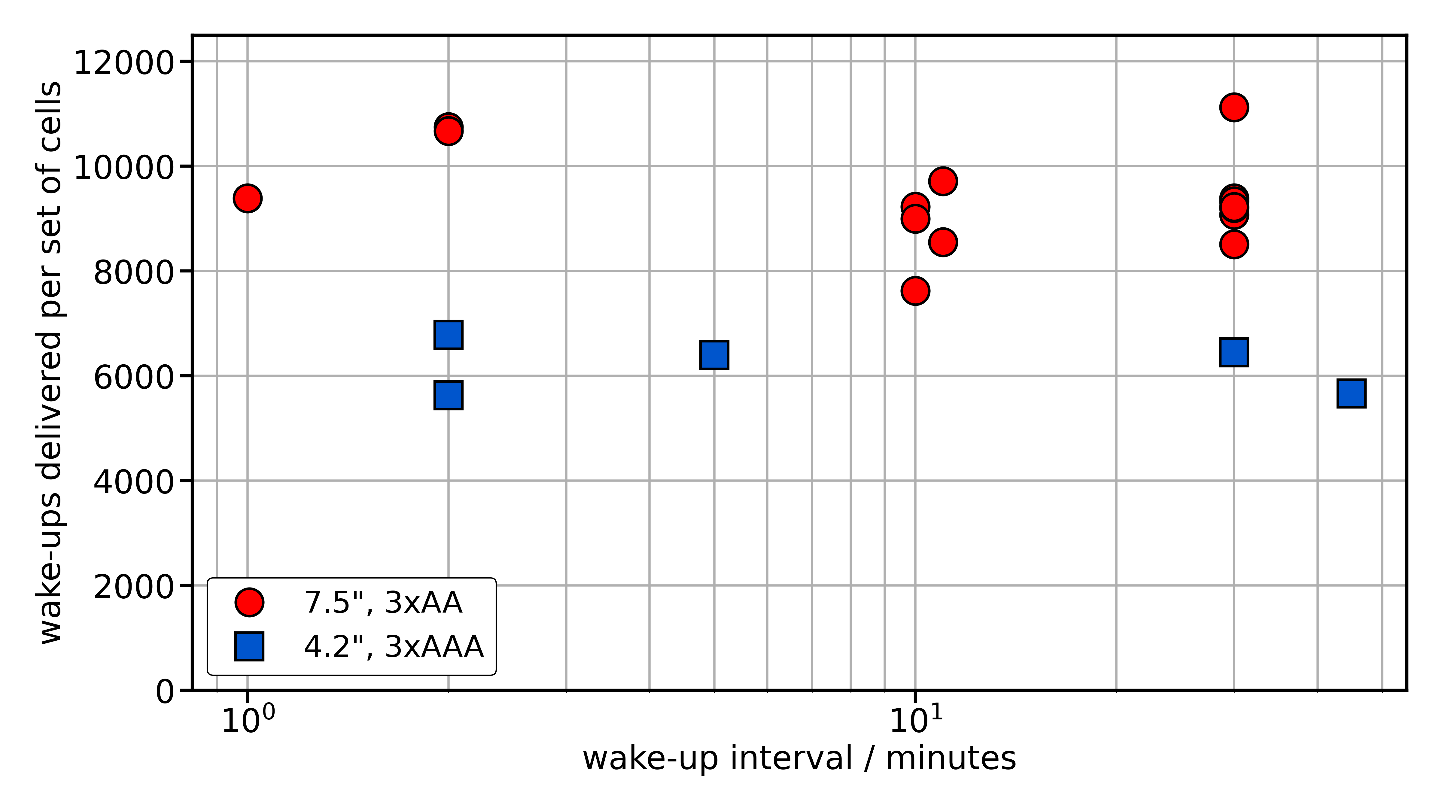

    A year later I have much longer runs and more data to check it against. One device has now been on the wall for 468 days on the set of cells it was built with, still going, and another managed 433 days and 5,665 wake-ups before it stopped. That sits nicely on the roughly 5,000 wake-ups per set the 4.2-inch version was designed for, and the 7.5-inch version reaches about 10,000 on its larger AA cells. Note that some of the devices only wake during office hours to save power, which is why the same wake-up budget stretches over more calendar days on some units than on others.
    This picture is confirmed by looking at the data of all devices in operation up to now. A set of cells delivers a roughly fixed number of wake-ups, and how often the device wakes barely moves it, as you can see in the figure. The energy goes into waking up, connecting and refreshing the panel, and almost none of it into the time in between.
    ### Why alkaline?
    Rechargeable batteries are the obvious choice for a device like this, and for this one they are the wrong choice. When nothing is drawn between wake-ups, the limit is no longer the electronics but the chemistry: cells lose charge on their own whether the device uses them or not. Alkaline cells are cheap, sold everywhere, and happen to be very good at exactly that.
    Cell type Typical self-discharge Charge left after 1 year After 3 years
    Lithium, non-rechargeable ~1 % per year 99 % 97 %
    Alkaline, non-rechargeable ~2.5 % per year 97 % 93 %
    NiMH, low self-discharge ~15 % per year 85 % 61 %
    Li-Po / Li-ion ~3 % per month 69 % 33 %
    NiMH, ordinary ~12 % per month 22 % 1 %
    Typical literature values at room temperature. After a year on the wall an alkaline cell still holds almost all of its charge, while an ordinary NiMH is down to a fifth, having powered nothing at all. Over three years it is empty. Only lithium primaries do better than alkaline, and not by much.

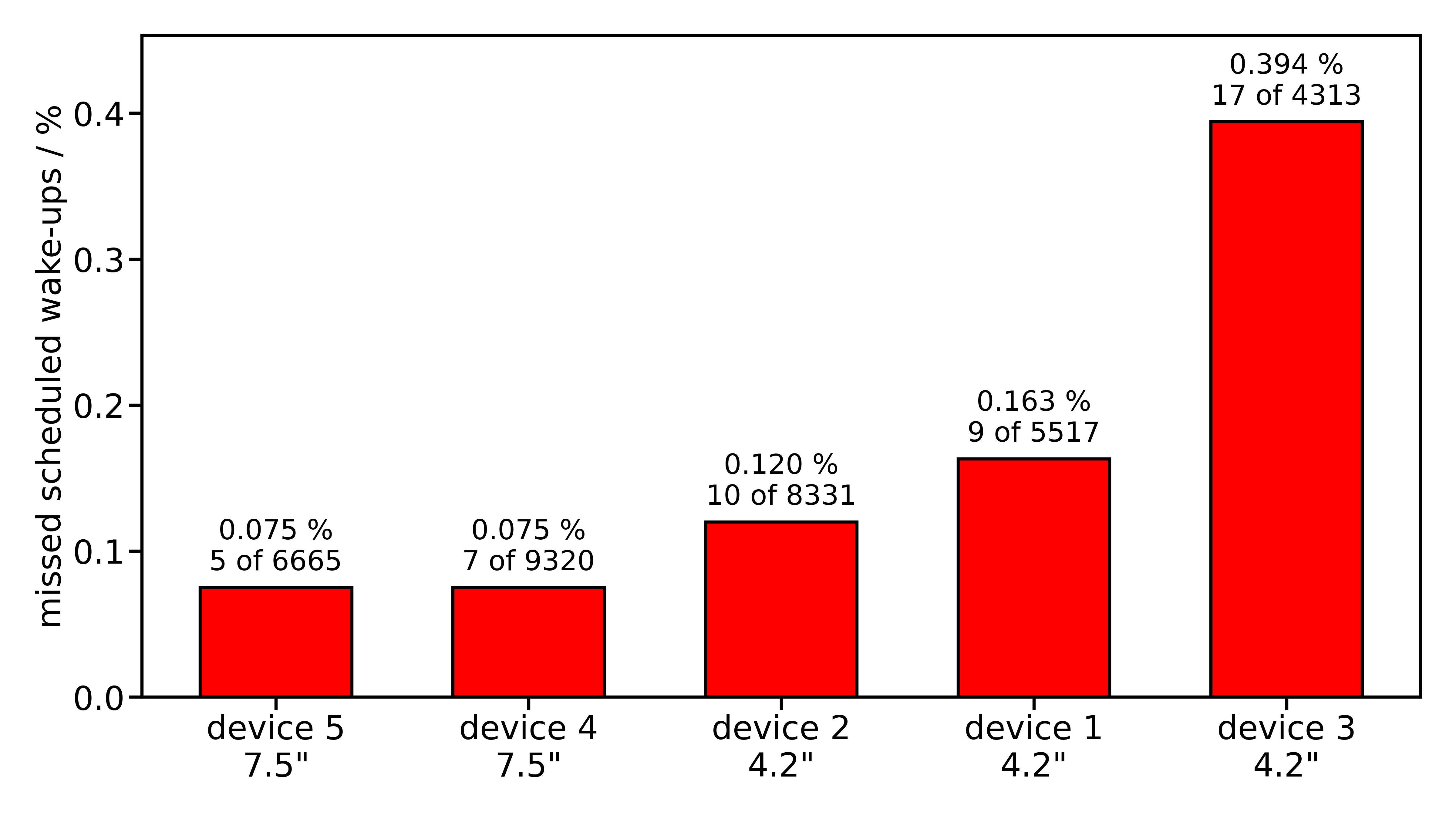

    Unattended, prolonged operation is the central idea behind Tinta. For that, reliability is key.
    The technical implementation for this employs something like "electronic suicide": after the circuit has done its job, the Pico is first setting an alarm for the DS3231 realtime clock (RTC) when to wake up next, and is then cutting its own power supply completely off to save power. Well, it is not really suicide, however, it is more disruptive (and saves more power) than going to sleep mode. This better works, otherwise the device never wakes up again, and user interaction is needed (or worse). However, this also comes with conceptual advantages. Tinta always wakes up in the same state, the only things that change are the time (RTC) and the information on the server — making the concept very robust, no memory leakage, locked-in state or so. Only a few seconds of lifetime, always the same day, Groundhog Day for a microcontroller — poor Pico ;)
    The first prototypes are now running since more than a year in the field, so I checked how well this works in real life.
    Missed scheduled wake-ups over a time of about one year, counted inside each unit's own active window.
    The figure shows statistics for five devices. Missed wakes: 48 of 34146 = 0.141 % -> 99.859 % delivered. Probably most of those misses are due to an unsuccessful Wi-Fi connection — devices will timeout after a few attempts. More importantly, also after missed wakes, all devices kept operating on schedule afterwards.
    I think this is a very good result and the circuit is working as it should. What else can we learn from this data?

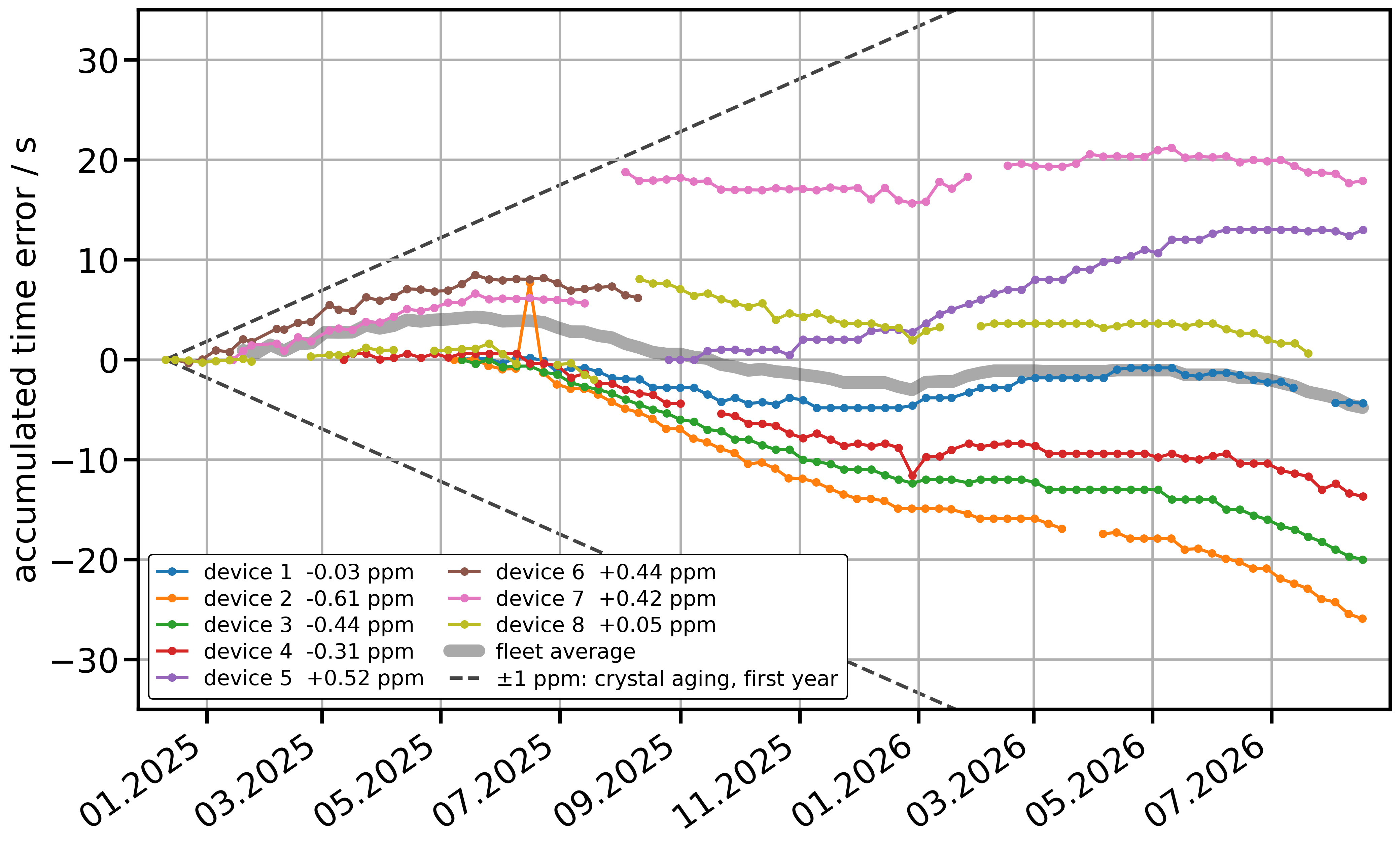

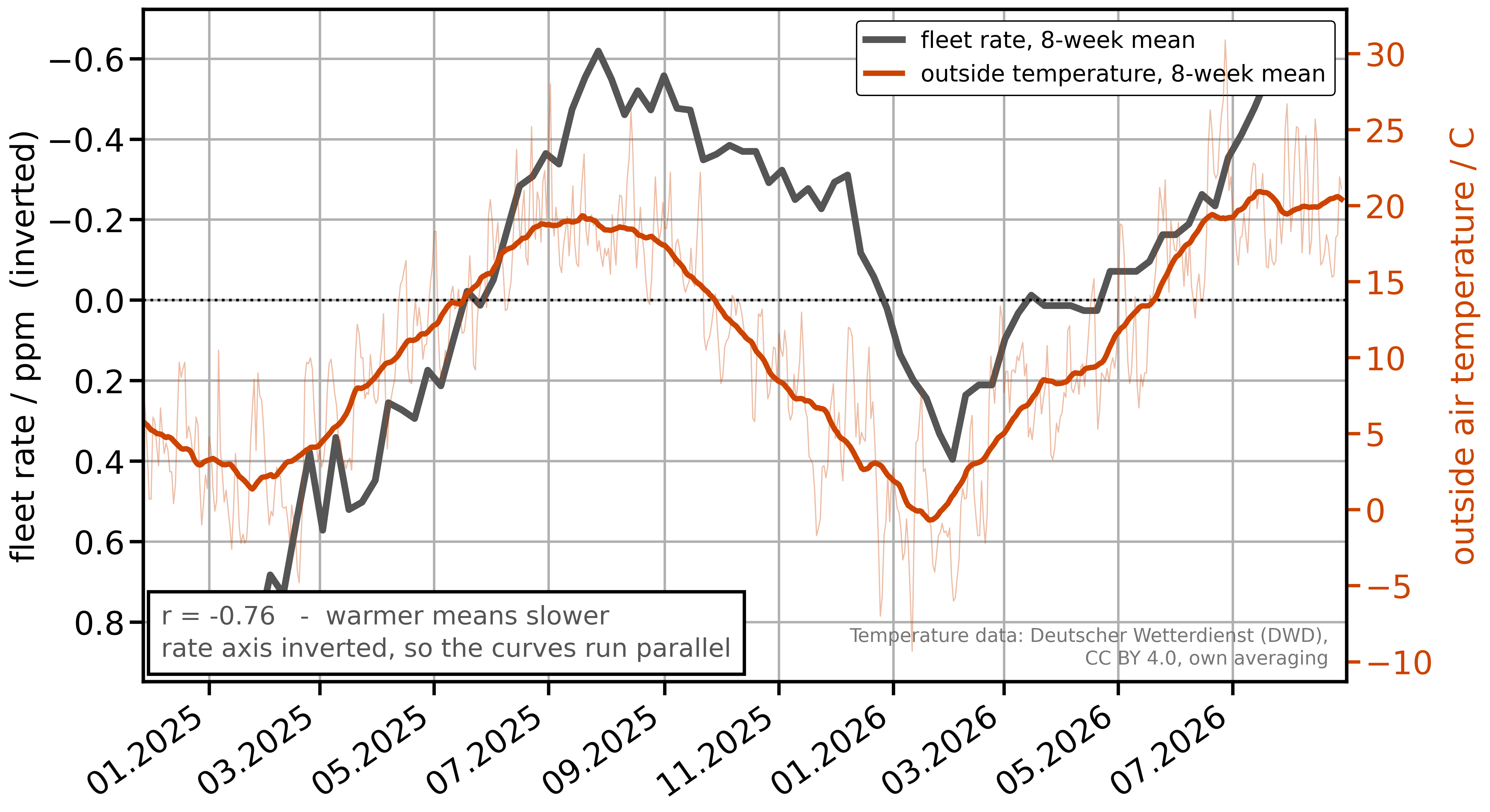

    Every time data is queried, Tinta is writing a short log message to the server. The RTC alarm is firing at a known time. So, we can compare the log message time and thus the RTC time with the server's time, and learn if the RTC is accumulating a time error. This is plotted in the figure below as time error. Of course, time needed to connect via Wi-Fi can fluctuate on a scale of several seconds or more. If we average over many Wi-Fi connections, that noise averages down and the slow accumulated error becomes visible over long times. However, this is a "hack of a measurement" and everything below has to be taken with caution.
    Accumulated time error of each device against the server clock. Dashed: max. crystal aging in the first year according to data sheet. Note: I did modify and reprogramme some of the devices, visible as jumps in the traces where the firmware and thus the timing was reset.
    A clear evolution of the time error is visible, and every device stays inside what the datasheet grants to aging alone — even though our number contains all the effects of the table below at once. The average over the fleet is close to zero, as expected if the server is not drifting at that level, i.e. locked via NTP. Stated the other way round: with eight independent clocks, the fleet average is a better reference than any single one of them.
    The DS3231 datasheet specifies several separate contributions, and what we measure is their sum:
    Contribution Datasheet Over a year
    Accuracy, 0 °C to +40 °C ±2 ppm ±63 s
    Crystal aging, first year ±1 ppm ±32 s
    Supply voltage 1 ppm/V 1.4 V over a battery life → up to 44 s
    Temperature sensor ±3 °C shifts the compensation point
    Aging trim register 0.1 ppm per LSB at +25 °C quantisation of the correction
    What we measure −0.61 … +0.52 ppm −19 … +16 s
    Aging and supply voltage are contributions on the level of the observed time error. The devices all sit in the same building at a temperature around 20 °C. The DS3231 features a temperature compensated oscillator, strongly improving accuracy vs temperature.
    The rate — the derivative of the curve above — against outside air temperature, both smoothed over eight weeks. Same time axis as the figure above, so the two can be read against each other....
