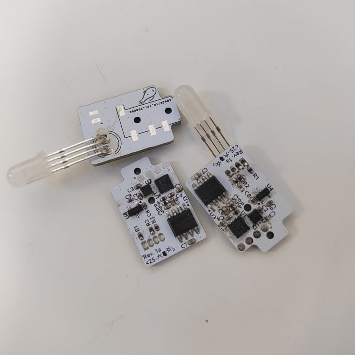

    No, it is not worth the effort trying to assemble these by hand (>_<) At least not without a stencil and a heating plate or oven.
    That aside, having replaced the soldering iron tip, the toolset now works like a charm. A rusty tip should retire! Pushing it to the limits by a hot core might strain the rest of the parts.

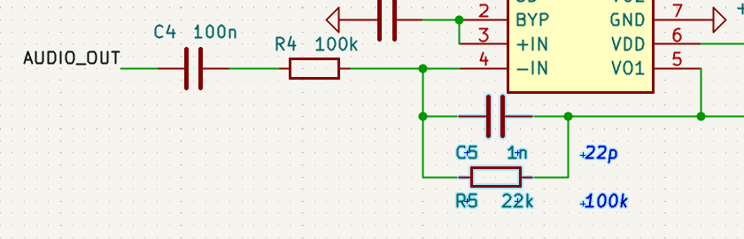

    In the last run, the speaker was just loud enough with a full-range signal; it needed a higher gain. The speakers sounded well after the audio filter was revised to bear a gain of 1 (rather than the previous 0.22).
    Part of the schematic diagram showing the filter components.

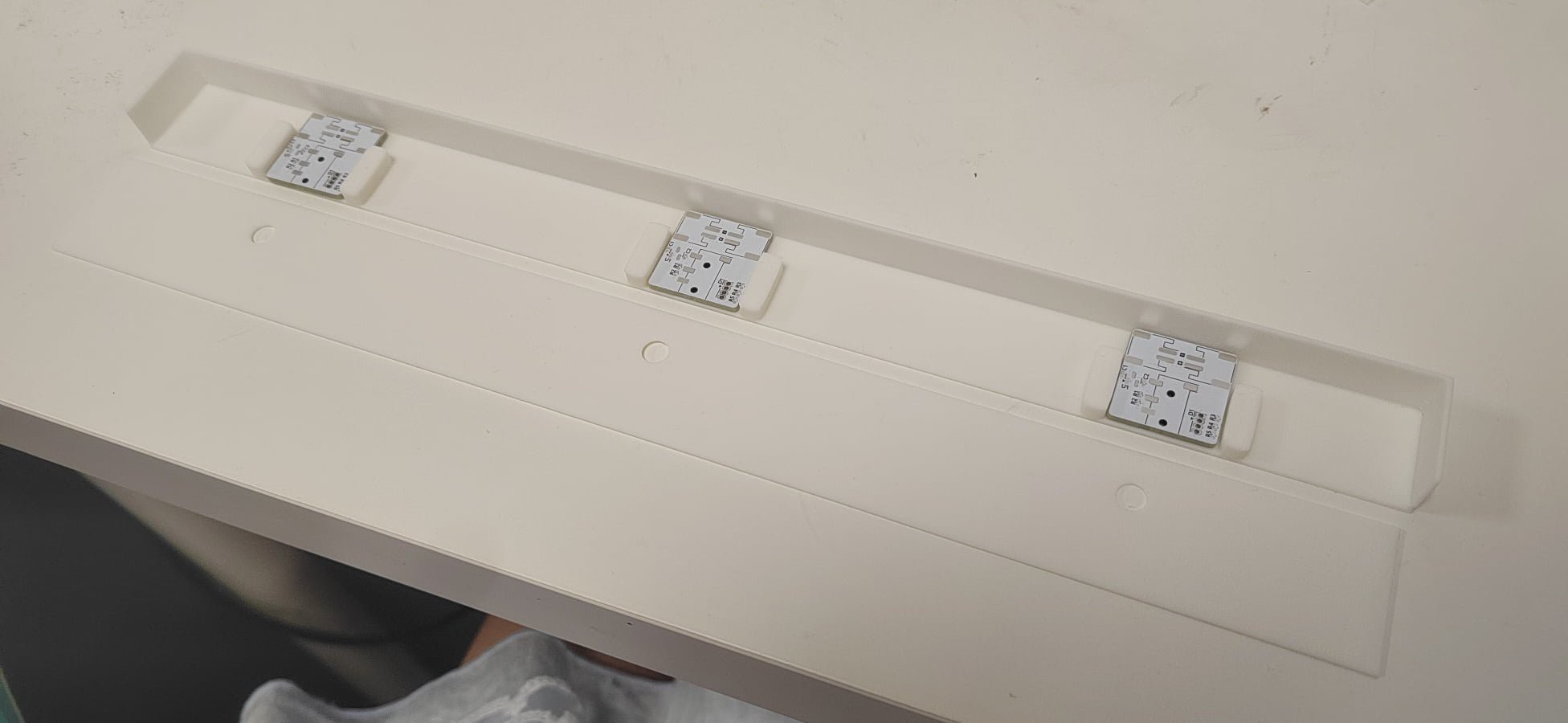

    The correct boards for the unit and the rack have arrived. The rack units fit in the case nicely.
    A 3D-printed case holding three small, square circuit board units.
    Completed assembly by hand-picking components and a hot-air gun, and the first bring-up went rather smoothly. The IMU was placing readings into its FIFO; the PWM audio was correctly playing through the speaker.
    Assembled circuit boards, with through-hole LEDs and speakers.
    Ball units and rack units (some LEDs to-be-mounted).

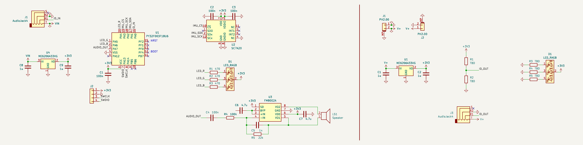

    While we wait for the correct boards en route, here is the batch that has already arrived. There has been a serious mistake: I connected the data line to the IMU's SDO pin, instead of SDx. As with most IMU sensors, this model SC7A20 (which closely follows the widely-deployed LIS3DH) works with either I2C, 4-wire SPI, or 3-wire (half duplex) SPI mode. In 3-wire SPI, the controller (main/master) and the sensor (subsidiary/slave) take alternate turns to write/read the data line, which for the controller means the MOSI pin, and for the sensor — SDI (SDx)! T-T Why would anyone fly through this without double-checking the datasheet...
    Excerpts of the schematic before and after the revision.
    In the revision, I also took the chance to add a bypass capacitor for the sensor's VDDIO, although that is much less likely to cause problems.

    Two schematic sheets.
    Complete revised schematic (ball's unit and rack's unit), for reference.

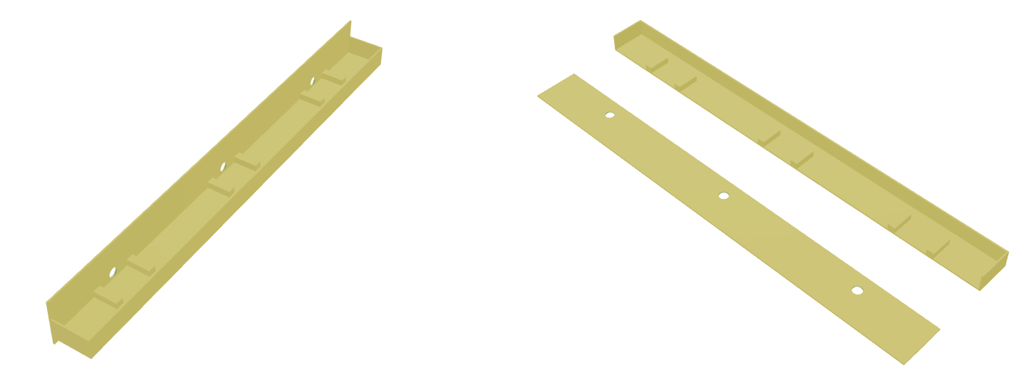

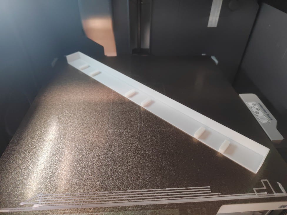

    Created a 3D model for the rack and sent a 3-unit version to the printer. The print came out smoothly!
    Views of a case with an elevated body, and a version with the front cover split.
    Full model and a version with the front cover split for easier printing.
    Printed object in the 3D printer.
    However, at a length of 29 cm, it only barely fit inside the printer (which works with a 256-mm cubic space). A 10-unit rack will be around a metre in length. I probably need to reconsider how this will be printed and assembled.

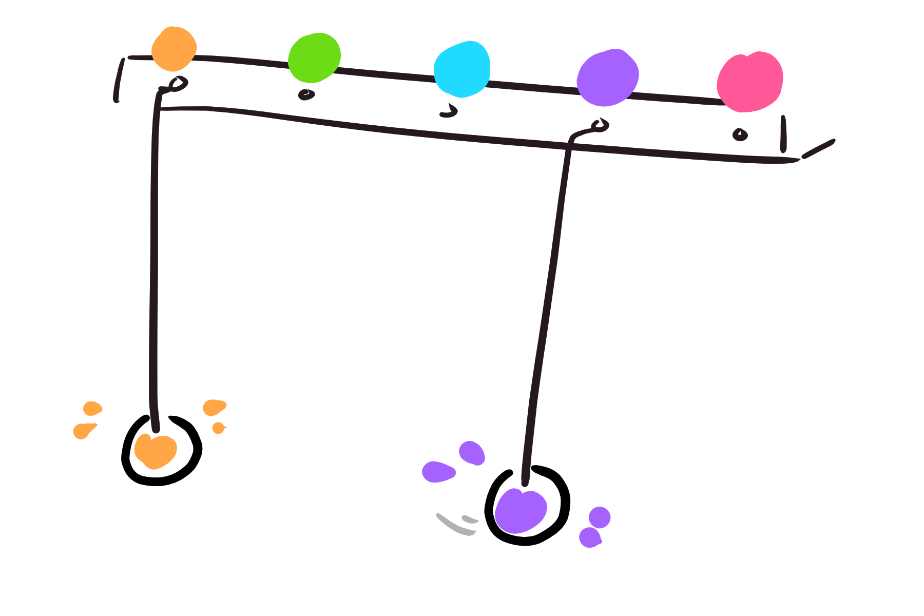

    Following Drifting Pulses: Fire, there was another insight: why restrict ourselves to electronics? In the tangible world, inaccurate periods exist everywhere. Just look at the swaying trees. The chirping cicadas. Look at the sun, the moon, the planets and stars. Look at our own bodies.
    This second interpretation, Drifting Pulses: Wind, tries to embody such physical variations. It consists of sound- and light-emitting balls hanging down from a rack. As a ball swings past the lowest point, it gives a sounding tone and a blink of light. The whole installation is similar to a wind chime; the tiny differences in each ball's swing naturally create a desynchronising ensemble. To invite participants' interaction, the rack carries a line of plugs, each denoting a tone in the common major scale, and the participant can move the balls around different plugs to change the chord in play.
    I cannot deny its resemblance to my previous NIME project Malletwand, where a handheld pendulum becomes the music's metronome, or to some extent, the conductor. However, in this project (this Drifting Pulses series in general), I'd like to focus more on the musical phrase morphing on its own, during times without human intervention.
    The electronic implementation will consist of two parts, the rack unit and the ball unit, connected through a 1-metre TRS cable (so that the period is 2 seconds — note that the pulses happen every half period). The cable will deliver power as well as identify the plug's index. The circuit boards will arrive very soon; the wind's voice awaits.
    Illustration of the construction: balls hanging down from a rack with coloured lights
