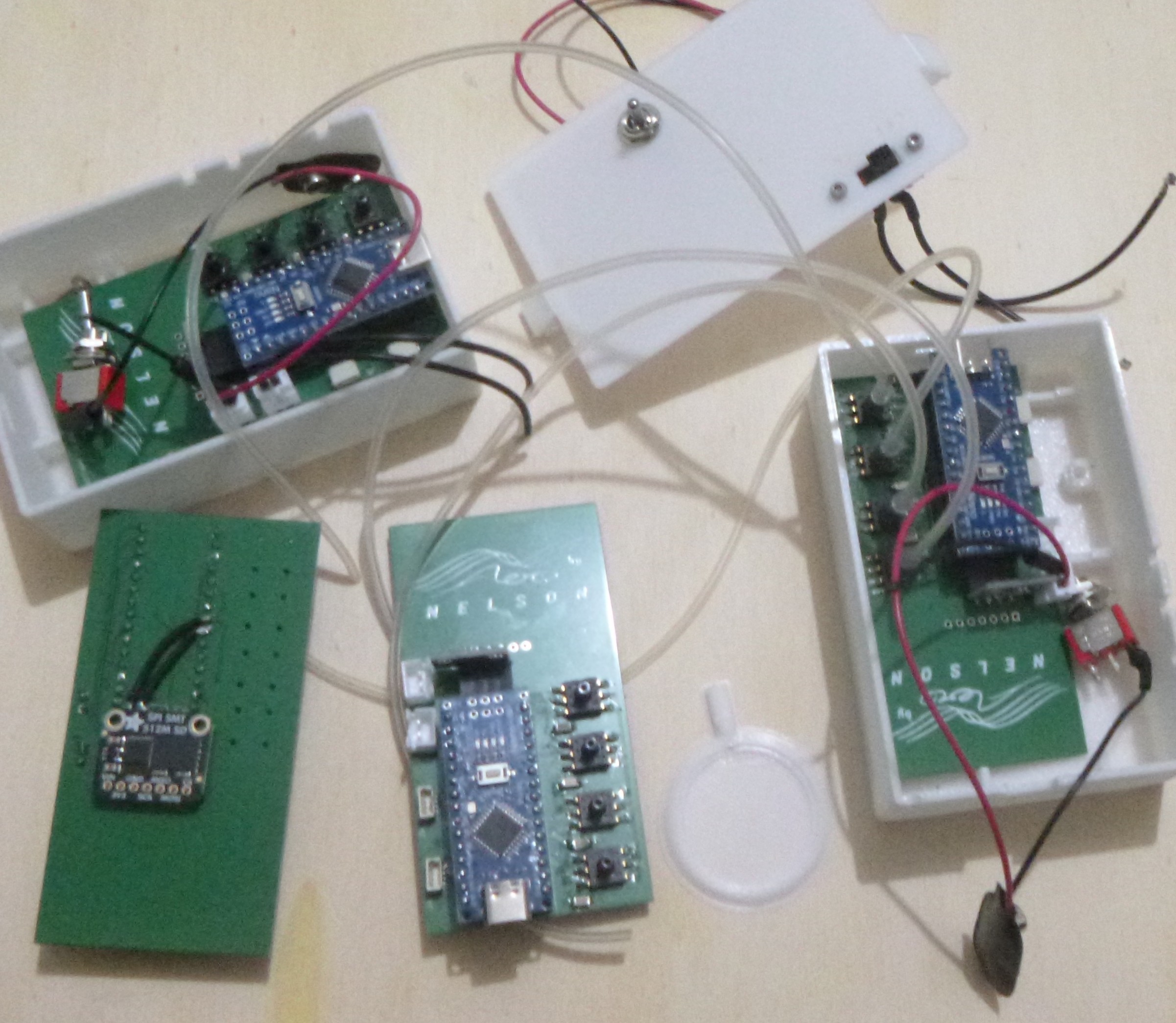

This is an air pressure kit primarily to measure the pressure field acting on a car. Intended to be cheap and accessible way of understanding the aerodynamic of a vehicle. Based around the Arduino nano it has 4 analog pressure transducers for measuring the gauge pressure and a BMP280 Barometric sensor to give a absolute measurement reference. An advanced version of this kit is available which has a 500Mb flash memory chip and up to two additional arrays of four sensors each. The idea it can be used by anyone interested in aerodynamics applied to the real world. It isn't intended to be a professional kit, but something useful enough for an enthusiast.

  • 4 × Air Pressure Transducer -5 - 5kpa 5 volt analog output
  • 1 × BMP280 Barometric pressure sensor measures the absolute pressure for the gauge sensors to reference
  • 1 × Arduino nano usb-c
  • 1 × 9 volt battery connector
  • 1 × Custom pcb
View all 14 components

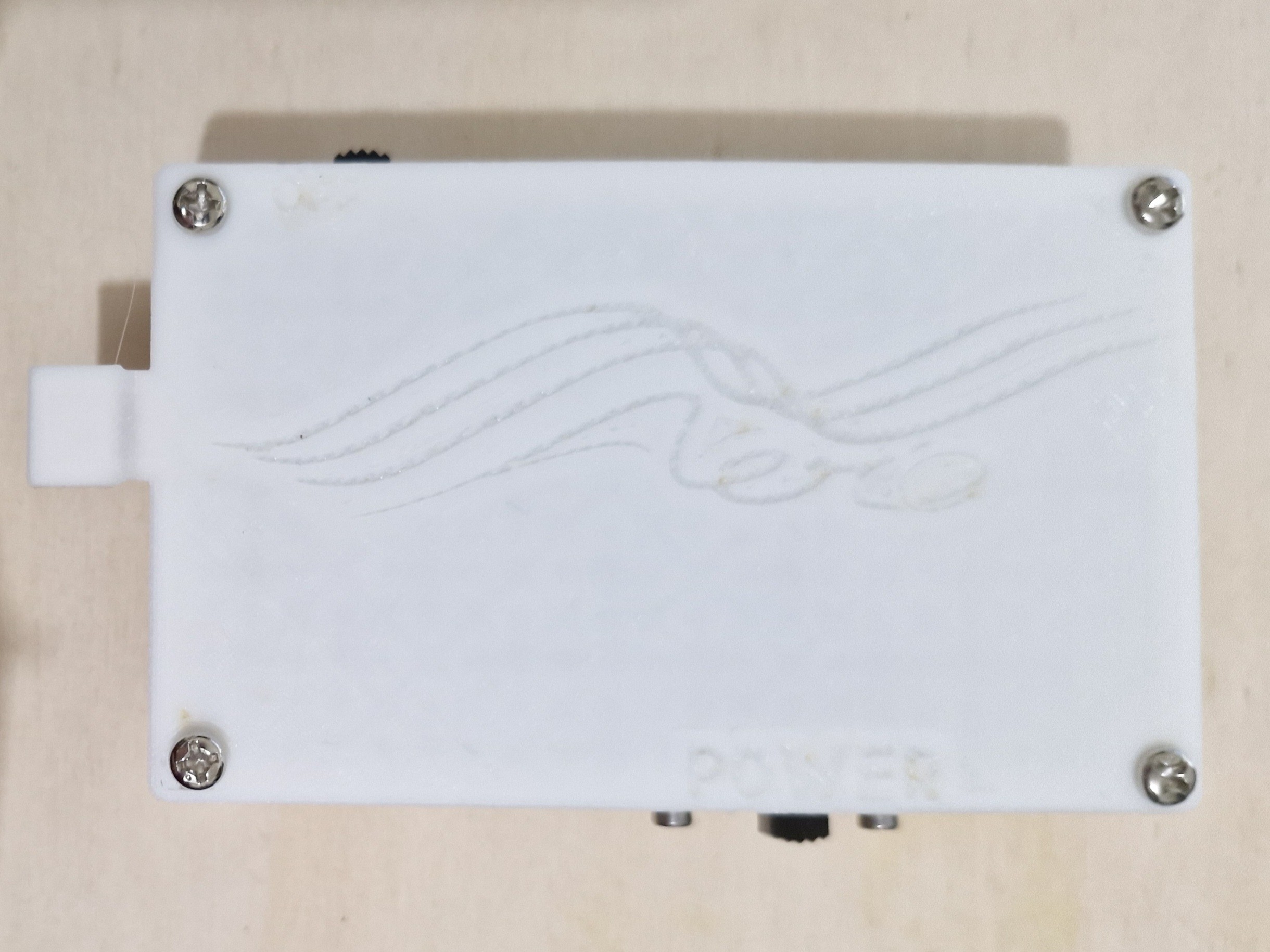

    This device is able to run via a usb-c plugged into a computer(power source) or by 9v battery. The process is the same, other than a computer can send command for saving data to a computer file for later analysis.
    When the device is turned on, automatically with a usb cable, with a battery installed via the power switch the green light become apparent.

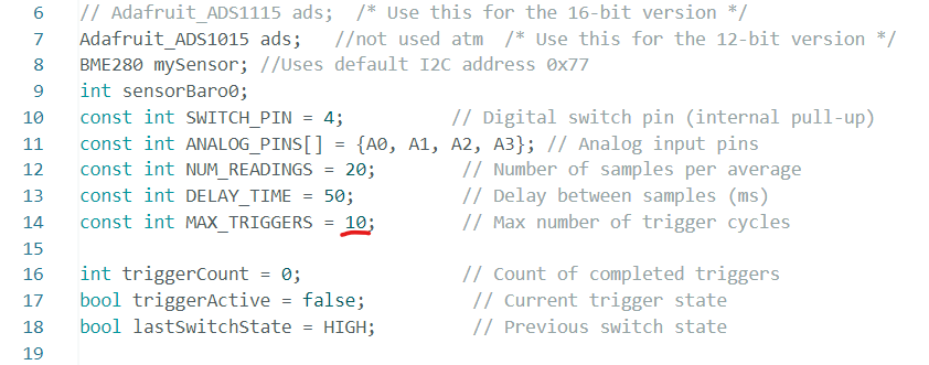

    Using a battery; after powering up the device it would be a good idea to set a baseline measurement by triggering it using the red button. This first measurement will be labelled "trigger 0" in the data. The data will be read from the four main analog sensors for 1s and then averaged to be stored in the EEPROM(memory). After this another data set can be trigger by pressing the button again, up to ten times unless the code is changed.
    Subsequent data measurements are trigger by sliding the switch which will save data to sequential "trigger 1, 2, 3,....." labels.
    Each time the microcontroller is switched off and powered up again the trigger count resets and over writes the data from each triggered data set.
