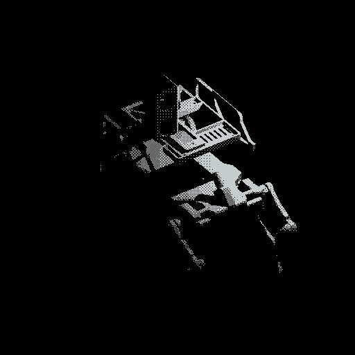

Module for Waveshare Wavego. Transforms your robot into an autonomous walking piratebox with voice-controlled LLM integration. Features speaker/mic module and ultrasonic sensor for enhanced navigation alongside the camera. Deploy it to roam autonomously while sharing files and make it respond to voice commands through AI integration.
Ever wanted to build a robot assistant that not only responds to voice commands and navigates autonomously, but also serves as a remote file server accessible from anywhere on the internet for less than 400$? I created a module for the Waveshare Wavego - a Raspberry Pi-powered quadruped robot that evolved from a basic voice-controlled bot into a sophisticated autonomous system with dual WiFi walking server capabilities.
Apologies for the simple formatting, I'm really struggling with the options hackaday gives me and it keeps removing my html code every time I need to make a small change.
The three panels require you to use some superglue, I found this to be the easiest option to connect them together and this allows us to cleanly print everything with minimal support. The ultrasonic part of the module can just be stacked into the slot.

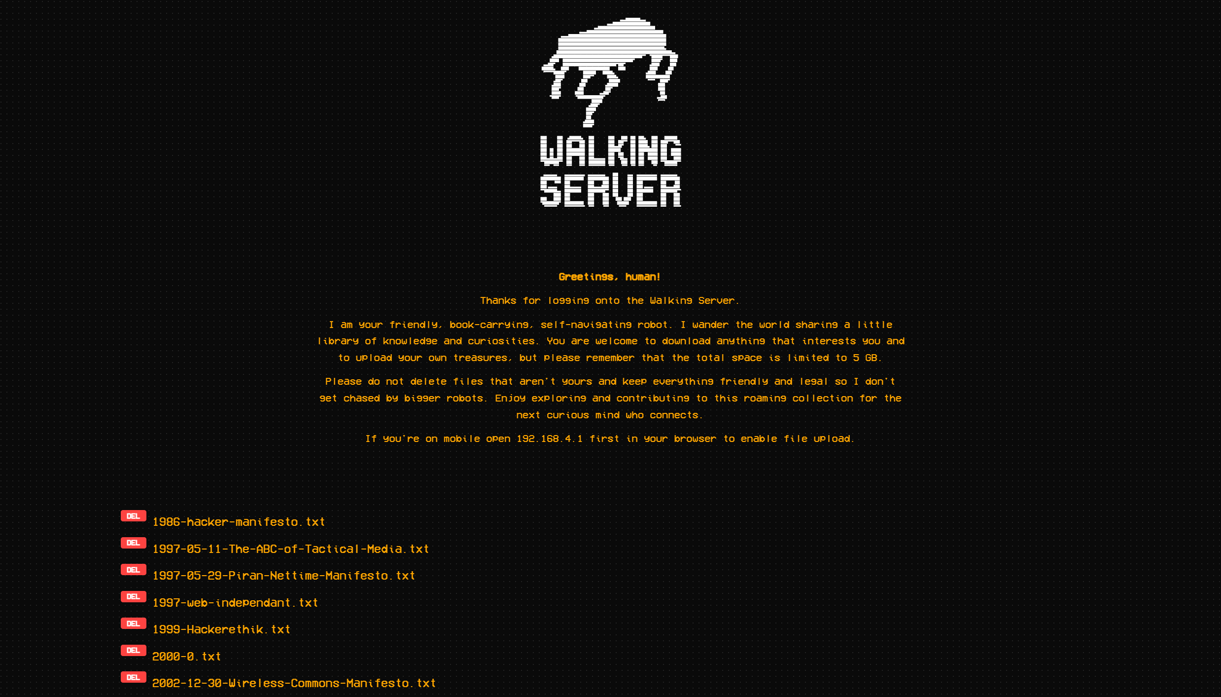

Files are served over a simple webpage, you will be forwarded directly after connecting to the WalkingServer hotspot. If it won't forward you you can connect to it through 192.168.4.1 in your browser.
The delete option is a bit risky but I just left it in as a social experiment for the next hacking convention.

To connect the ultrasonic sensor you'll either need to splice the cables together for Ground and 5V or get a split cable connector, I'm sure there are other ways, it's fairly straighforward:
# Connect ultrasonic sensor
# TRIG -> GPIO 23
# ECHO -> GPIO 24
# VCC -> 5V # GND -> GND
The ultrasonic module helps it to navigate in dark environments where the camera is not sufficient and also assists with regular navigation.

wavego_module_v1.3.stl
Reworked version, goes along with the updated image. Ultrasonic sensor now points slightly upwards and code will compensate for body reflection. Ready to print with minimal support.
