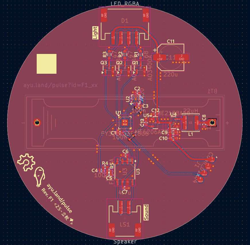

    First, mount the bulk capacitor C11. This is originally intended to resolve the light's dimming, but it actually reduced the hiss, while the dim persisted! What is happening?
    Components on the circuit board.
    I also added a parallel 100 nF at the LDO's input (C12), to no observable effect.

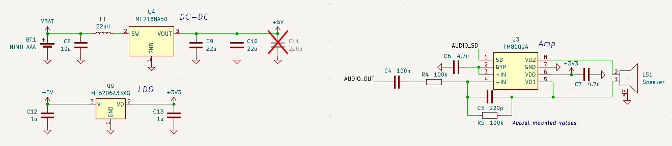

    Let's check the theory. Here is the power supply and the audio filter circuit:
    Circuit diagram of a DC-DC, an LDO, and an amplifier with filter.
    The DC-DC converter works at 320 kHz. The LDO's datasheet specifies 50 dB PSRR without a graph. The amplifier IC specifies a minimum of 60 dB. The filter is a first-order high-pass followed by a first-order low-pass, the passband from 16 Hz to 7.2 kHz, with an overall unity gain.
    Does the hiss come from switching noise? The filter alone provides an attenuation of 20 log10 (320/7.2)) = 33 dB. LDO's PSRR at this high frequency will be lower, but still in the range of bels. This combined attenuation is likely sufficient to supress the switching noise coupled into the audible signal.
    Furthermore, the hiss appear only when the light and the speaker are both plugged in, and not with the speaker alone. This renders the original hypothesis highly improbable.
    Returning to the workbench: our test tone is a 375-Hz sine wave (which comes from the 24 kHz sample rate divided by a wavetable length of 64 samples). Somehow I noticed that, to the ear, the hiss is the same pitch class i.e., it is a few whole octaves above 375 Hz. By simple elimination, the exact frequency is likely at 375 Hz × 24 = 6 kHz which coincides with the PWM frequency of the light. This surely is no coincidence; when the PWM frequency is changed in the program, the hiss changes its pitch accordingly. Hence, we can conclude with confidence that the hiss originates from the LED's high-frequency power draw coupled into the LDO's output, which correctly predicts that the bulk capacitor will reduce this noise.
    Now that the root cause has been identified, we know how to fix the problem. Either add a filter at LDO's input, or increase the PWM frequency beyond the filter's passband. For the dim (power dip), we need more bulk capacitance, of course!

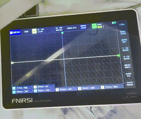

    The oscilloscope brings us a step closer.
    Oscilloscope recording. As time passes, loops between: (1) straight 0 V reading; (2) 2.4 Vp-p centred at 0 V, 23.5-kHz triangle wave; (3) triangle wave superimposed by an oscillation at lower frequency.
    Voltage measured between speaker output pins, load plugged in. Amplifier alternates between shutdown, idle, and sounding.
    What is this 23.5-kHz triangle wave?? (To be continued...)

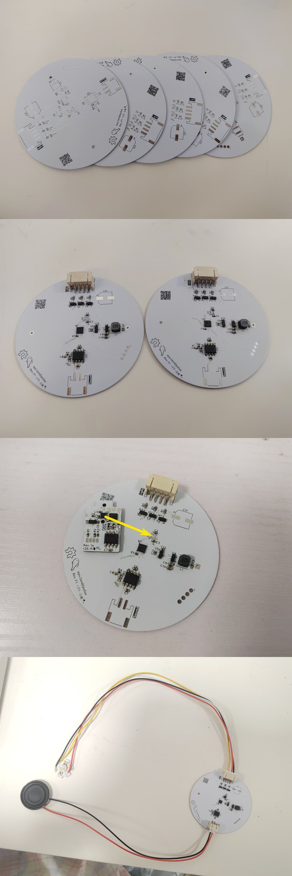

    The circuit boards have arrived! Large boards are way easier to handle than miniature ones like those for Wind.
      Steps of assembly: (1) empty circuit boards; (2) mounted components; (3) borrowing a component from another board; (4) plugged-in LED and speaker.
    As I've lost track of my IMU stock, I had to borrow one from those previous assemblies (^ ^;)
    The first-ever bring-up succeeded without friction. Both light and sound worked; the light at full intensity consumed around 150 mA at 3.3 V or 500 mA at 1.2 V (from a 1250-mAh AAA-sized NiMH battery).

    The first revision of the circuit board has been designed and is now on its way from the fabrication house. It will be powered by a NiMH battery; interaction will be sensed by an accelerometer IMU. Let's see how this will turn out.
    Circuit board design screenshot.
