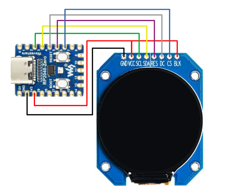

To accomplish that, only two components were used, a rp2040 Zero (for compactness) and a GC9A01 round display (for style)
The circuit is wired as shown in the schematic below
The rp2040 runs a script in Circuit Python that was installed using the excellent Thonny IDE.
The script is based on a demo by todbot named gc9a01_picture_locket. The list of files to be displayed was adapted and the new pictures were added. It was also necessary to change the pin configuration to use the rp2040 zero.

tft_clk = board.GP2 # was 10 # must be a SPI CLK
tft_mosi= board.GP3 # was 11 # must be a SPI TX
tft_rst = board.GP5 # was 12
tft_dc = board.GP4 # was 13
tft_cs = board.GP6 # was 14
