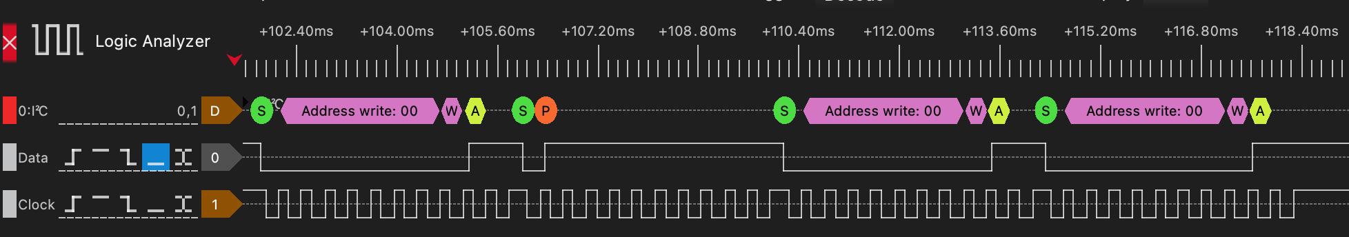

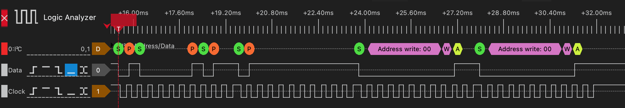

    Yes, I'm aware the decoders are still present, I don't have the original screenshots anymore, these are from the traces. You can see that the clock line is clearly a clock signal, but what you can also see is that the data line is different (and you'll have to trust me it repeats), across the first of four bytes.
    Which mean the SCL and SDA meant "Serial Clock" and "Serial Data" but not necessarily "I2C" traffic.
