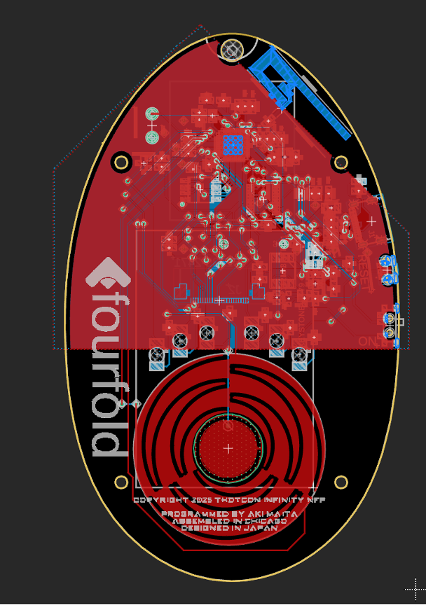

With the screen problem taken care of, we turned to the rest of the board layout. Remember that touch wheel? Texas Instrument’s parametric CapTouch template came in handy here for a few reasons: 1) It only took up three pins on the ESP’s board, and 2) it knocked $4.38 off every badge that we would’ve had to spend if we’d gone with a traditional dial. Multiply that by 2,000 units and the “small” change is real money.
Because the template was parametric, we could script the wheel’s diameter instead of redrawing it each time the enclosure shifted. Seven script cycles landed us on a 32 mm wheel perfectly nested inside our oval—clear of the TFT ribbon and every mounting boss.
Copper thickness was the last silent negotiation. Too thin and the wheel’s resistance drifts with Chicago’s spring humidity; too thick and we blow the cost target. The sweet spot: 1-oz copper with 8 mil traces and gaps, keeping series R under 50 Ω without torpedoing the budget.
