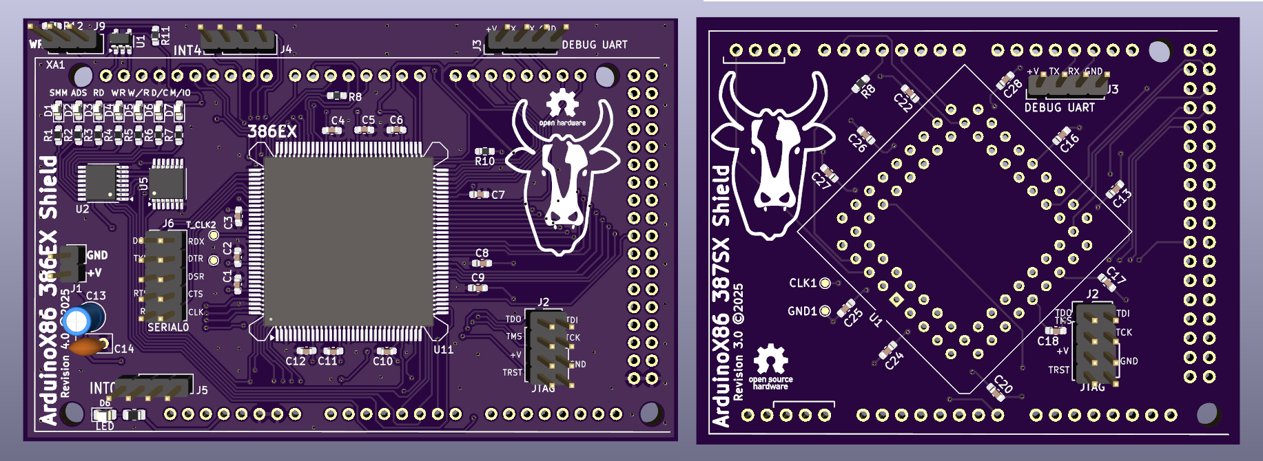

    V4 Board Design
    I've taken some lessons learned from the V2 board design, most relevant being that the extension of the clock line over to the 387SX socket has been problematic due to its length and lack of series termination.
    The size of the PCB also makes it more expensive.
    So I decided to split the board into two modules, one for the CPU and one for the FPU.
    I made a 'V3' design that connected these two boards via a 40-pin ribbon cable, but @f4grx@chaos.social on Mastodon gave me a great suggestion to make them simply stack on top of each other.  I'm not sure why I didn't think of that. So V3 went in the bin, and now we have V4.
    Stacking the modules neatly solves the issue of the clock line - it's not extended at all if you don't have the FPU module plugged in, and it's much shorter even when you do.
    I also had some fun by rotating the 387SX socket 45 degrees.  This actually does make the routing a bit cleaner.
    Power is brought up on the JTAG header, which if you plan to stack these modules should be a female 2x4 header on the CPU board.
    Some other additions include spots for series termination resistors on the clock lines, test pads, some extra filtering caps on the external power connector, and an i2c EEPROM I plan to add to all my boards for automatic shield detection.

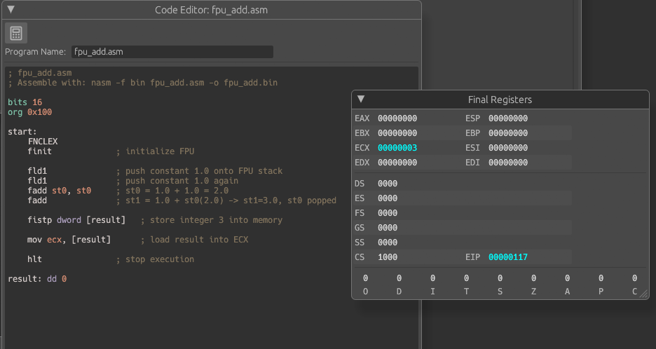

    The V2 board is not a total loss, however, as I did get the 387SX to function with some tinkering to reducing ringing on the clock line.
    Here is a simple program to calculate 1+2 using the FPU, you can see the correct result 3 in the final ECX register.
    Ultimately, I'd like to provide a window where you can define the initial FPU state just as you can define the initial register state for the FPU.   We'll use the FSAVE and FRSTOR instructions to bookend program execution when an FPU is detected.

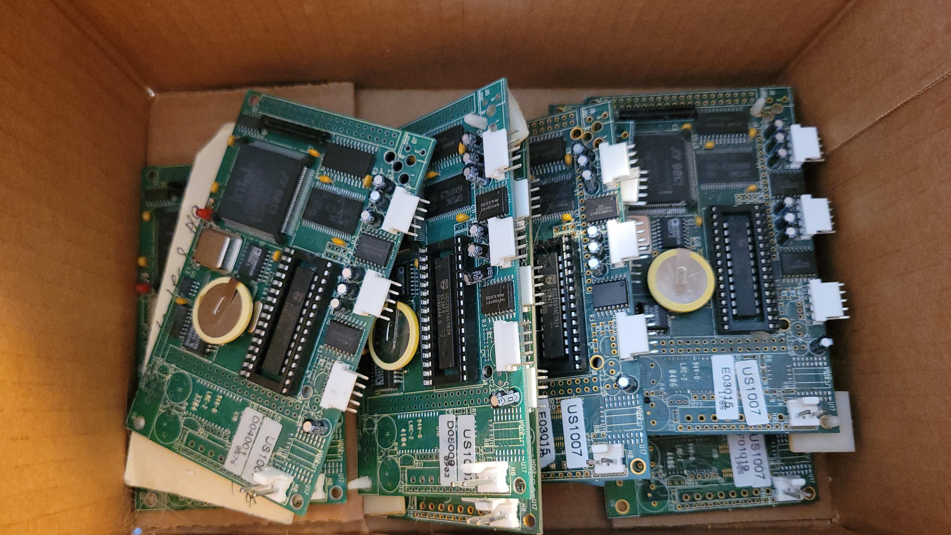

    I'm using some small 386EX Single Board Computers as CPU donors.
    These are i386-Engine-M boards from Tern, Inc.  They lived their previous lives as serial interface boards in gambling machines.  386EX's aren't exactly growing on trees these days, so when I had the opportunity to acquire the lot I jumped on it.
    Getting the CPUs off is a simple matter of applying hot air for about five minutes until the PCB is hot enough to melt the solder itself.  Patience is key.

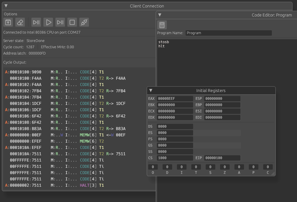

    Meanwhile, progress on the GUI for ArduinoX86 continues.
    We can assemble x86 programs in NASM-syntax, set up a desired initial register state, then execute the code on the 386EX and receive traces showing each cycle of execution and all bus activity.
