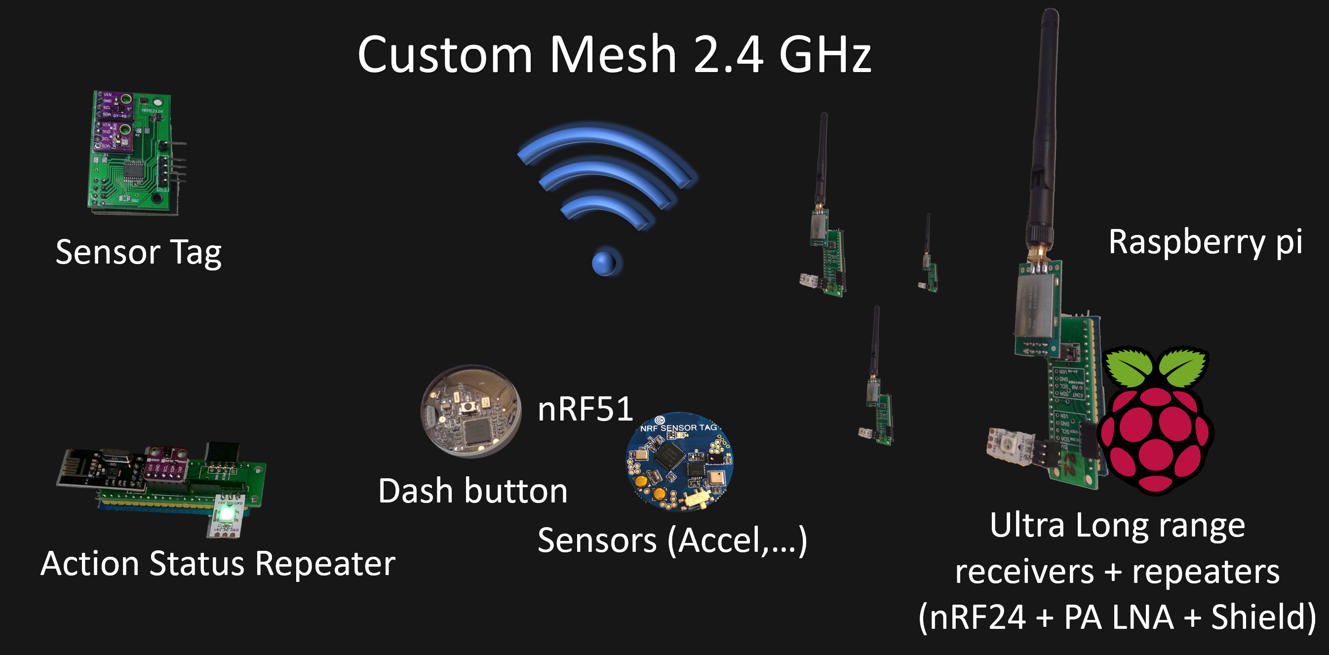

Home Smart Mesh
Mesh of sensors, zigbee, custom RF, BT, wifi, all to MQTT Gateways on Raspberry Pi with database, dashboard and webapps.
The custom RF mesh started with nRF24L01+, STM8L to STM32 with mbed-os, then nRF51, nRF52832, and nRF52840. Then Xiaomi off the shelf zigbee sensors kicked in. On server side, Raspberry pi, MQTT Mosquitto, json, influx time series database and Grafana as dashboard, also custom web with websockets, reactjs webapp, d3js and even 3d webapps with three.js. Python used for different services. The ESP32 is used for non low power sensitive projects.
All SW and HW is opensource on github.

  • nRF24L01 Flood Mesh Protocol
    Wassim05/14/2017 at 12:20 0 comments
    Mesh use cases
    before talking too much about mesh concepts, let's see end results what useful things can we get of this ?
    Flood versus Routing
    This is a Flood mesh type opposed to routing mesh types.
    • With a Flood mesh, Zero configuration is required, just throw nodes in, every node has its id.
    • A Peer to peer message just need to know the destination id, the stack handles an end to end acknowledge with retries if necessary.
    • This type of mesh is router less, which means it get advantages such as
      • the nodes do not need routing tables to define the shortest path
      • which is also hard to configure if the nodes move or would have to be identified on startup.
      • A routing mesh would also require a central server or duplication of management in every node acting as a server.
    • But there's no magic in here, a Flood Mesh have some compromises to do which might be completely irrelevant in some scenarios.
      • The mesh Range is as wide as you have nodes and capacity to live through jumps, yes but then why don't we use a huge time to live for an endless range ?
      • Well the problem is the echo, as the nodes have no routing info, they will keep repeating messages to each other, even back to those they got the messages from !!!
      • This Echo is born from the flood concept itself, it reaches all the nodes around who keep singing along for one single message until that message dies.
      • During a time to live group repetition, all the impacted network is busy with that single message. which highly increases collision chances and messages loss.
      • In the scenario of a home, this compromise is not of much relevance as you barely need a single repetition jump, one Time To Live can get you through a villa, and two through a huge building, this is not fit for a city network as its name says this is a #Home Smart Mesh.
    • As two nodes listen to an RF message at exactly the same time, they are likely to react with a repetition at exactly the same time as well. To avoid that, every node uses a per id delay configuration to repeat the message with a shift in time.
    Leaf versus Repeater Nodes
    Leaf Nodes are acting like beacons. They are wireless low power sensors that cannot keep listening, thus the frequent Broadcast for them is strategically a better compromise than a Message to a server. The unpredictable time listening waiting for the acknowledge can allow to re transmit much more frequently with the same power budget. Additionally, these nodes do not need to be configured to know the server Id.
    The Mesh Protocol
    • This Mesh protocol was custom designed to take advantages of the hardware it was designed with. The reason it is different than others is simply that the RF transceiver nRF24L01+ is much cheaper. With up to x10 times cheaper, well you get some side effects such as packet size limitation. With 32 bytes, if your protocol header is big, well then you have no more room for a payload.
    • The protocol above uses only 8 Bytes at max while fulfilling all conditions of end to end addressing, redundancy checks, acknowledgment and repetitions.
    • By design, messages do not have time stamps nor sequence ids, which let the multiple repetitions reception be filtered at the destination side. That means that yes, filtering time has to be slightly higher than the Flood echo time, and the sensors broadcast frequency must be slightly lower than the listeners filtering time.
    • The only complexity we get here is in the Pid that has been compacted to handle both the message type (e.g. Temperature, rgb color request,...) and the message status, if it is a broadcast or in case of peer to peer Request or response.

Hi Wassim,
I was wondering how does the 24L01 6 channel limitation applies here.  Does that mean I can't have one node talks to more than 5 nodes in the same level? If I have, let's say 50 leaf-nodes (STM8), how do I get all the sensor data back to RaspberryPI with minimal number of repeaters?
Thanks
Wassim wrote 02/25/2018 at 15:09 point
Hi @Ling , in the nRF24L01, there is an RF channels frequency, which is here set to the same for all nodes, and there are TX and RX addresses which are only numbers sent in a protocol header to filter messages. I do not use these addresses in my user sw protocol, and I set them the same for the whole network nodes. These addresses could help avoid conflicts with your neighbor for example using the same protocol, not secure but avoids conflicts. As you can see in the description, I have a user SW protocol that defines a node id. This information is received by all listeners in the payload, so every listener can know which user node id have sent the message. There is also driver level, and application level, where you can filter to get a callback only for broadcasts or received messages. I have implemented the same user protocol in all of STM8, STM32 and nRF51, and the nRF51 has even SW control for some bytes that were in the nRF24 controlled by HW only.
So your example of 50 leaf nodes would all be listened to with one repeater or uart gateway.
The current limitation is 256 Nodes per mesh, as I have used 1 Byte for the Node Id. Currently I declared up to 44 Nodes only, but already thinking of having Id-less nodes, that would use an exception id where they would extend the address space to be unlimited, and depending on the exception, you could feed the complete serial number as identifier.
Another idea could be to make those 256 addresses dynamic, same as in the Ethernet, MAC addresses are long and unique, while ip addresses v4 are shorter and temporary retrieved through DHCP.
Ling wrote 02/26/2018 at 22:15 point
Hi Wassim,
Thank you so much for your detailed explanation. Initially I thought there are lot of limitations because of your light-weighted protocol (number of nodes, security)...   But  after I read though your project log again and digested what you posted in the comments. I realized the simplicity is the beauty.
The number of nodes and the range are not issue when the repeaters are used. The user defined encryption can be added in the payload data to prevent your neighbors to peek into your sensors and control your light. The use of Raspberry Pi connects the whole mesh to the internet.
You really did a great job!
Thanks again!
