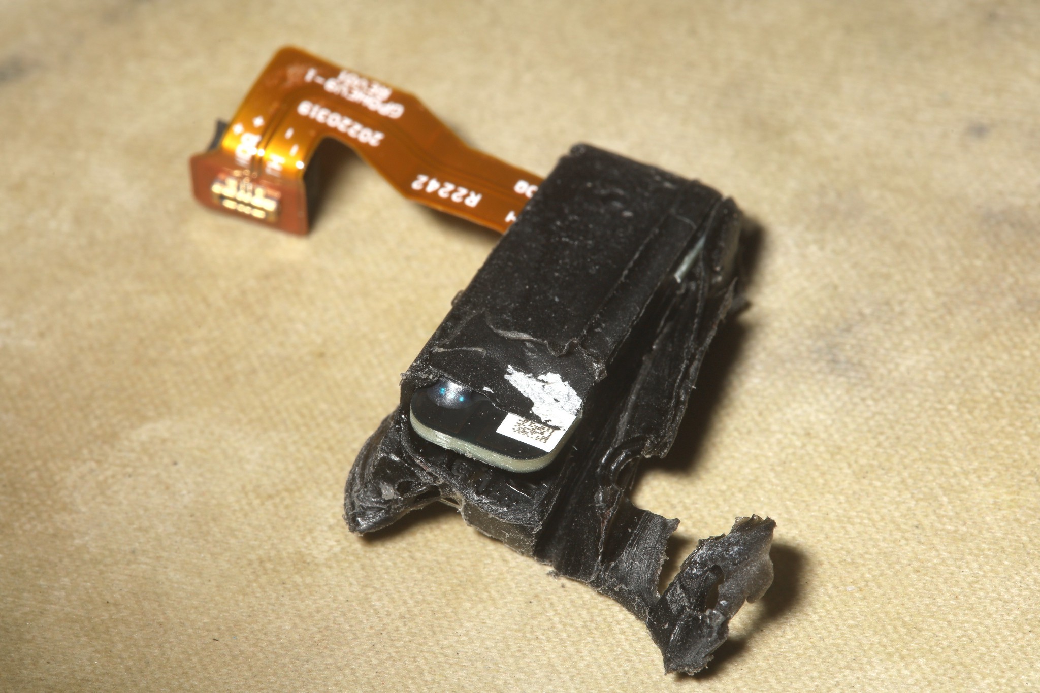

Marked the chip outline.
Used the plastic liner to mount it without breaking it.

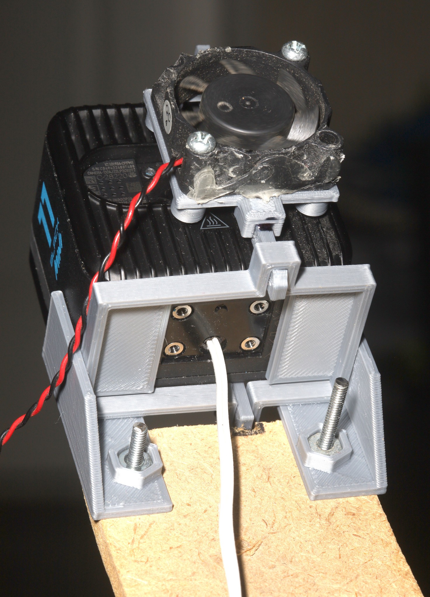

So this assembly of cooling fan & heat sink clamp is a pain to transfer between a tripod & vehicle mount. What's really needed now is a way to mount the CF rod mounted camera on a tripod.

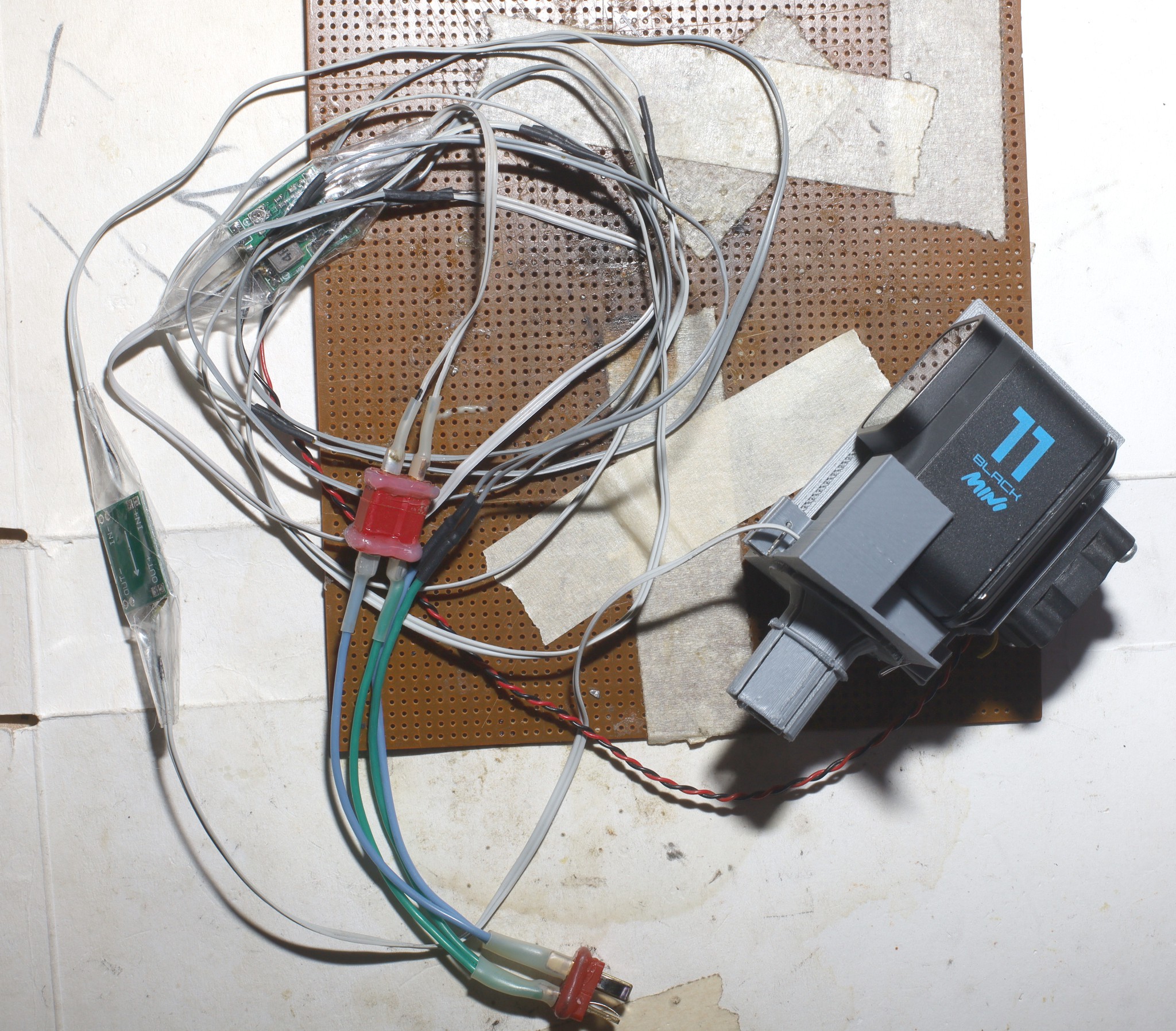

09/16/2025 at 06:38 • 0 commentsFinally converged on an outdoor system where the camera & fan run off the same 12V input.
Haven't had a lot of luck with a general purpose splitter. The idea with building a splitter into the camera connector was to reduce the number of connectors & hopefully make it more reliable. Suspect the problem with general purpose splitters is some connectors tend to go unused & pick up dirt.The fan converts it to 6V. 7V gave off a magic smoke odor.
Then the indoor system converts 5V .4A to 13V to power the big fan. That way all the 5V drops in the apartment can power any camera.

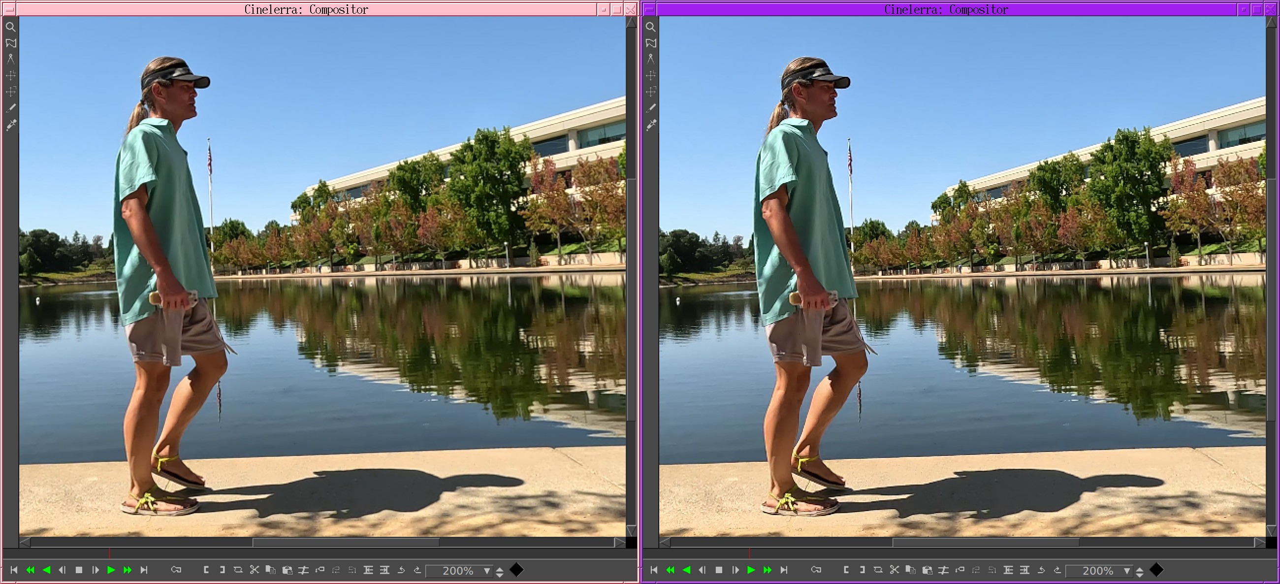

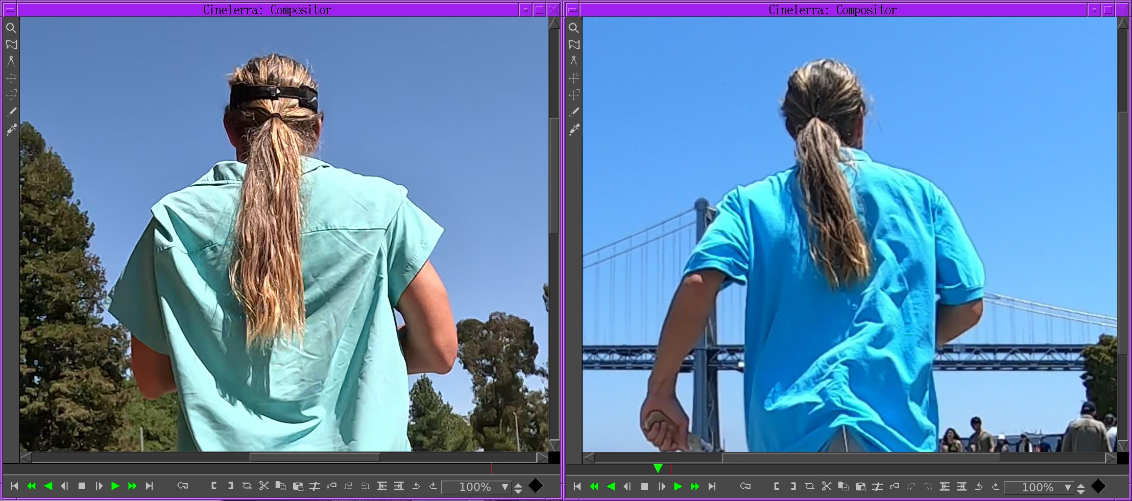

Comparing 1920x1440 to 4000x3000, all this hardware definitely brings a big improvement in detail.
Slightly sharper results are possible by downscaling with nearest neighbor by a power of 2.

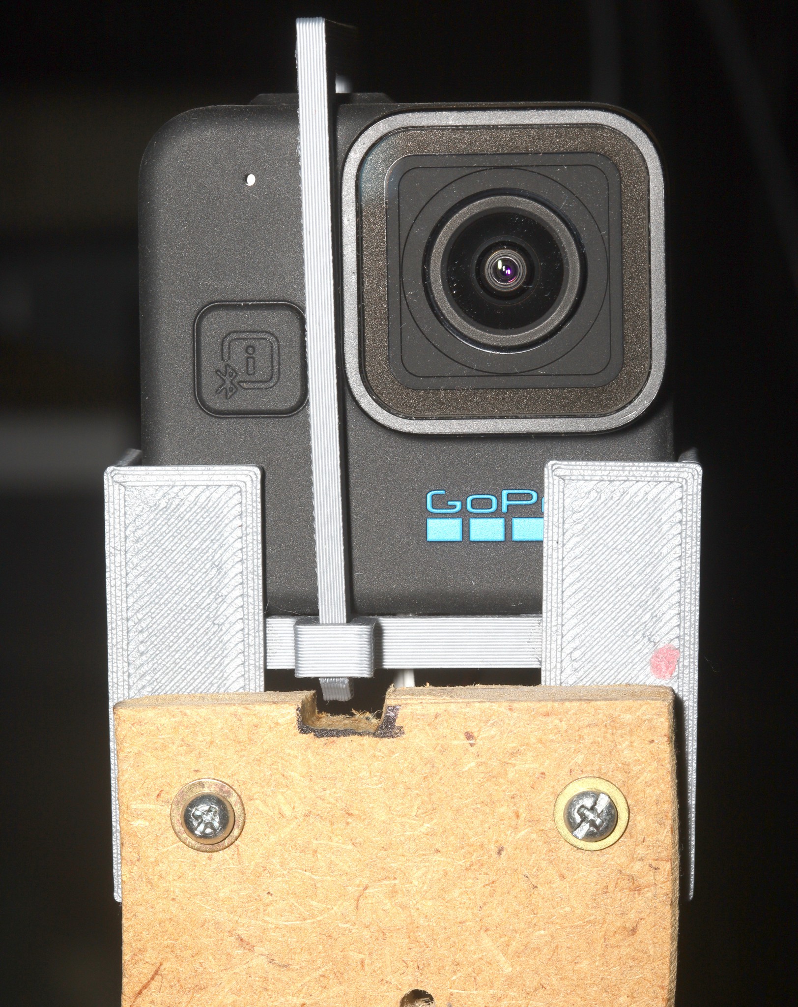

The trick with the truck is if the camera breaks free, the heat sink is going to separate & rip the flex cable off. The strapping mechanism needs to be permanent.

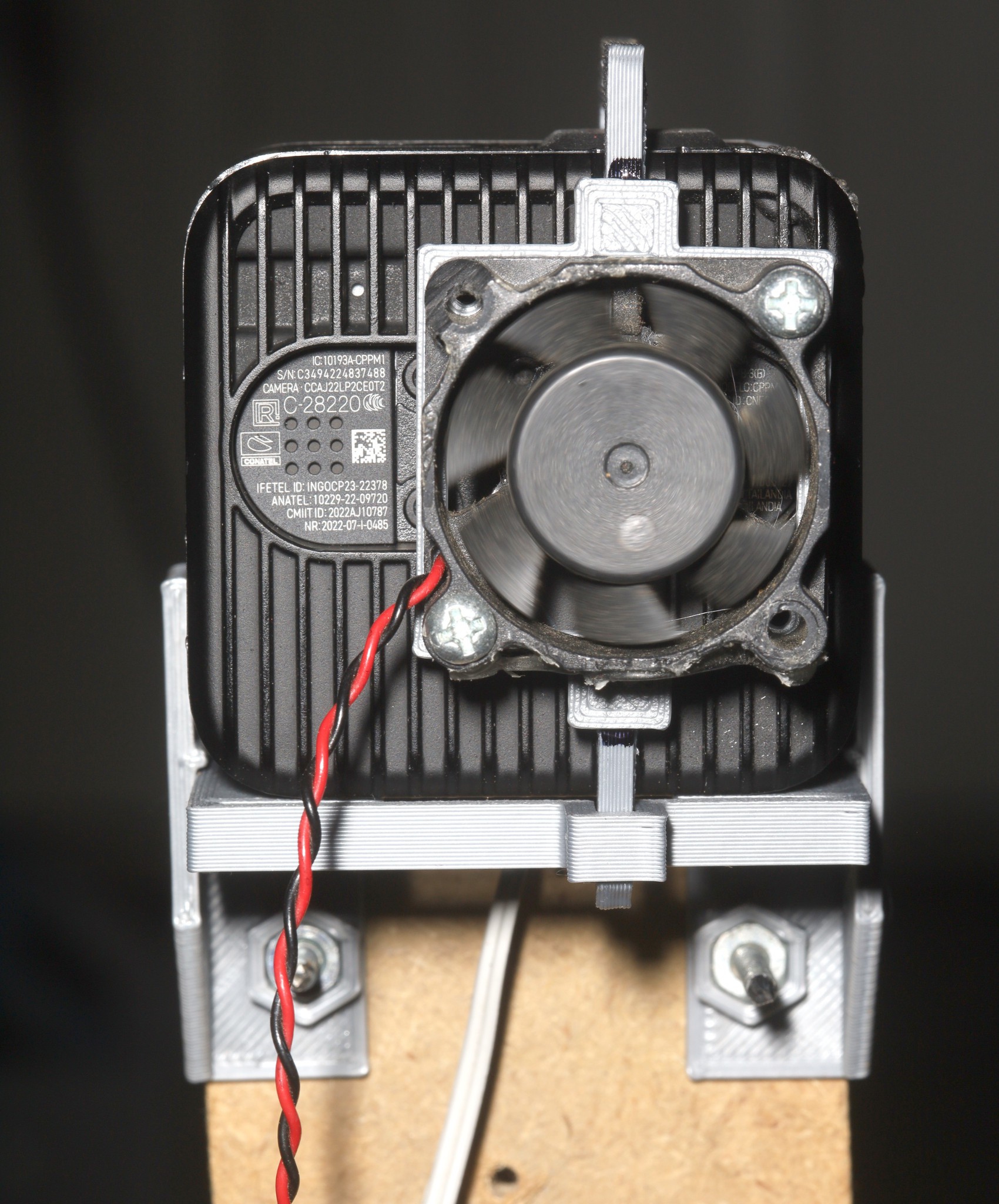

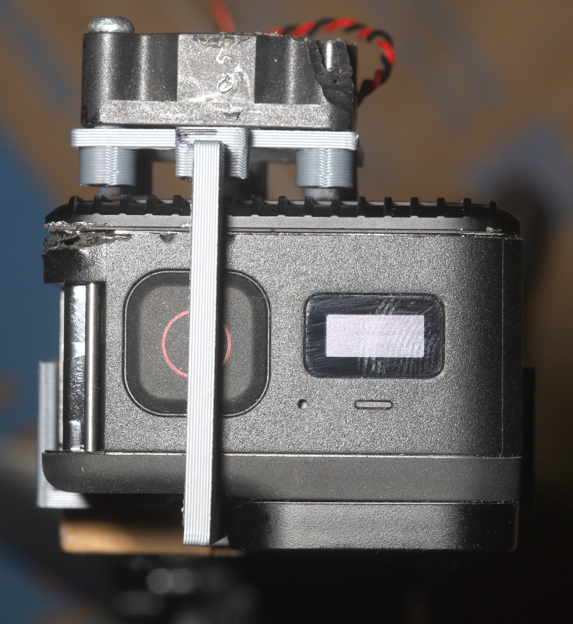

A test with a diagonal strap overheated on 4k 24fps, so it's more effective with the fan right on top of the CPU. Indoor use definitely requires a bigger fan.
A 50mm 1.2W fan continued overheating anywhere above 4k 4:3 24fps despite the camera feeling nominal. The SIL pad may no longer be making good contact since the teardown. These pancake fans are notorious for breaking. The lion kingdom once had many & they all broke.

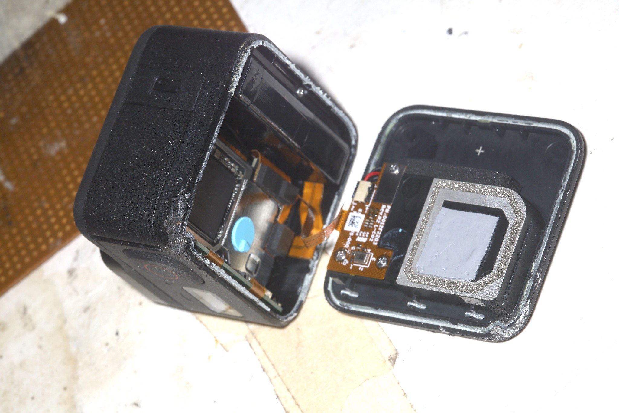

The next step was a stack of heat conductive tape. It had to be stacked quite high to make any contact with the heat sink. The blue putty had to come off. A + symbol on the heat sink indicated it was making some contact. This appeared to get it up to the 8W modes before it died.
The grounding sponge & its adhesive tape might also be interfering & have to come off. The heat sink was basically designed too far from the CPU. This could be a source of a lot of manufacturing variability, allowing some units to work & some to not. Thoughts turned to reducing the distance by sticking a piece of aluminum on the heat sink or grinding the case down. Grinding the case down would increase the pushback from the flex cables.
The 11 mini with dummy battery, heatsink clamp, & no fan is 89g. The 7 with dummy battery is 85g. In the spectator economy, there is no knowing the final weight of something until experimenting. The next step is mounting it on the robot & seeing how it does outside without a fan.

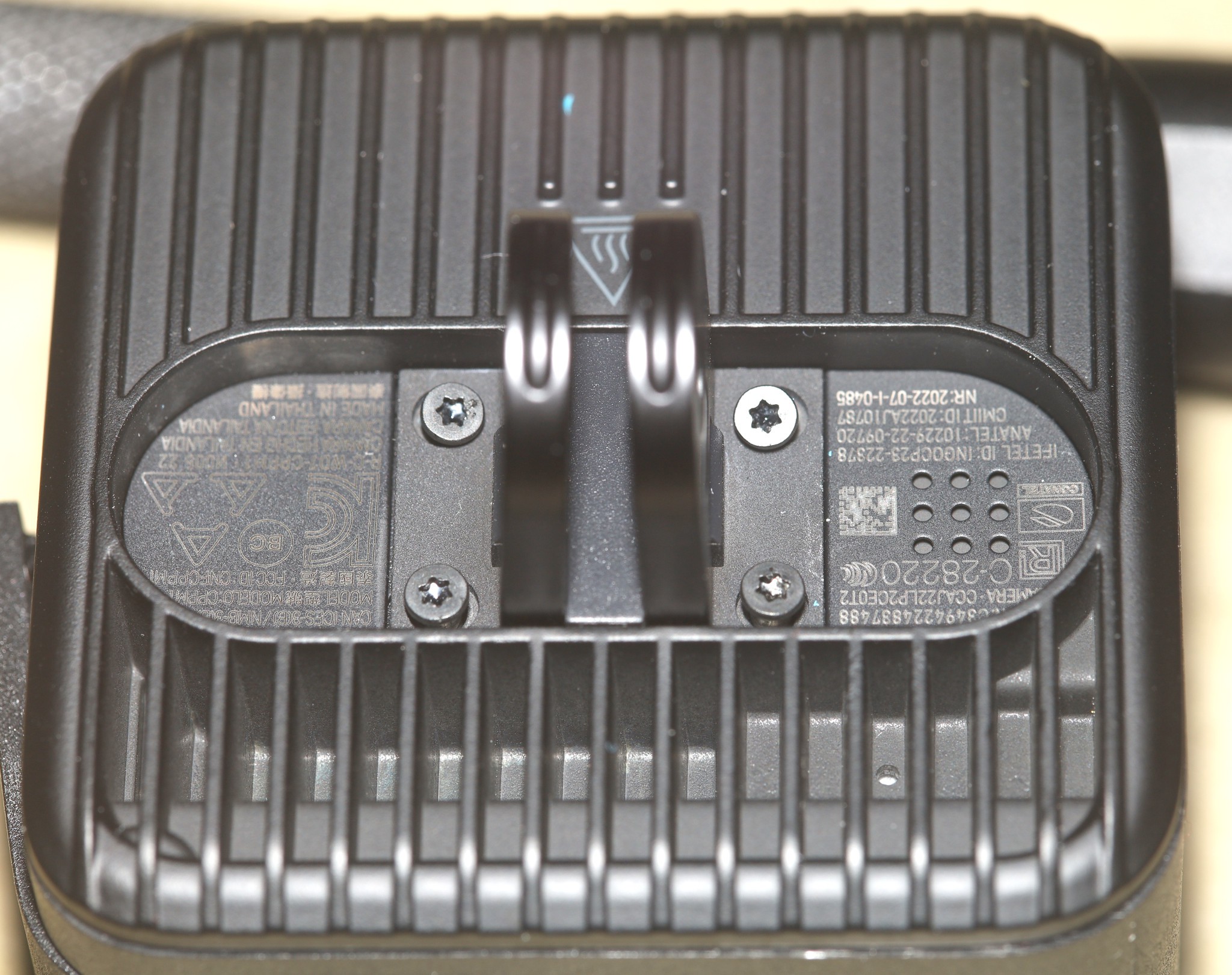

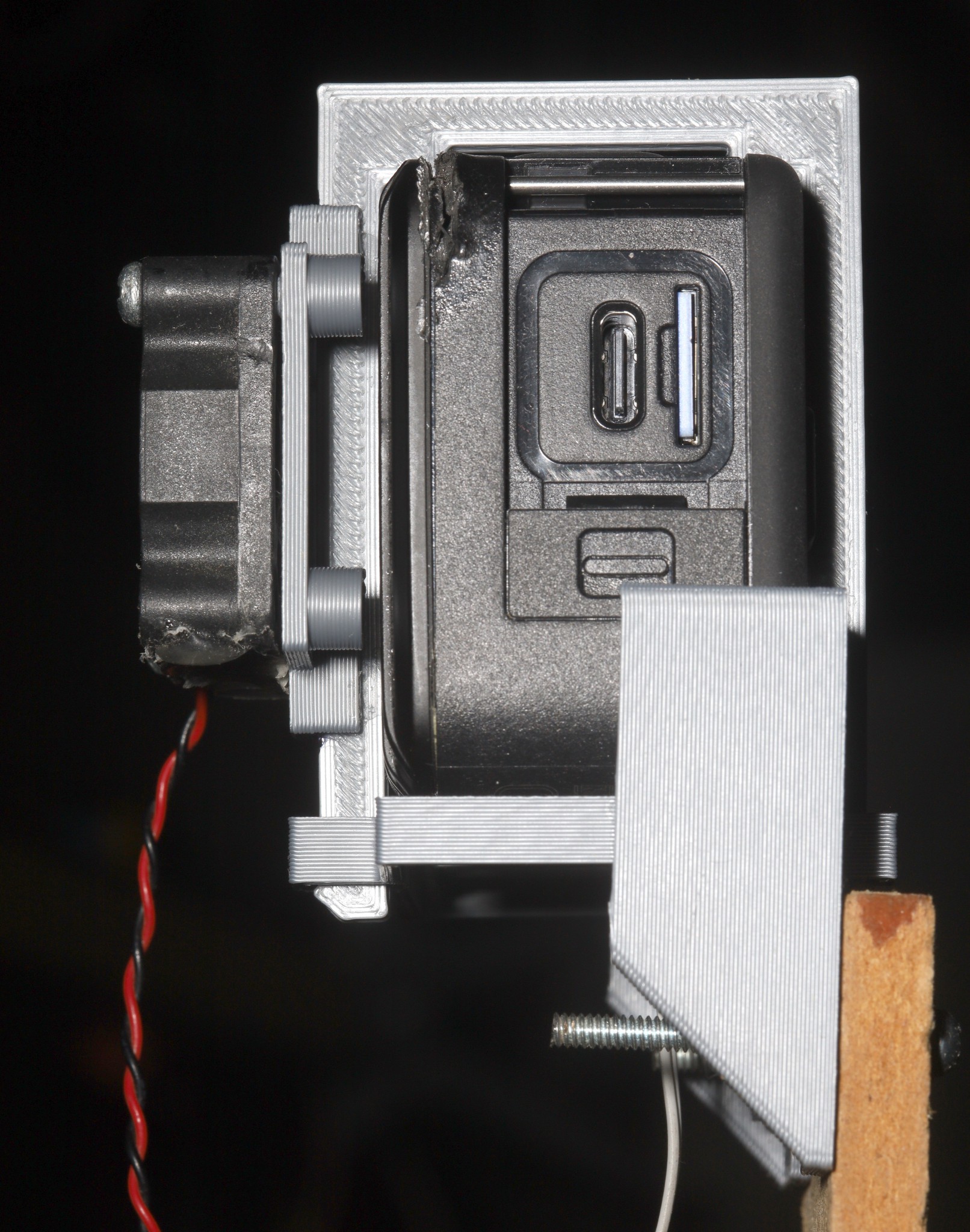

09/11/2025 at 18:34 • 0 commentsThe great task came to be a case which cools while also clamping the heat sink on & being as light as possible. The entire heat sink needs to be unobstructed & well blown on. The internet abounds with big old fans strapped on the back. It makes lions wonder if all those 3D printed fleebay listings are just fishing. The fan needs a different voltage than the camera. Even without the battery eliminator, it requires the infrastructure of a pro studio camera.
The hardest codec for it is 5.3k 60fps hypersmooth. That's burns 2.5A, but died from file corruption.
The other 5.3k modes are limited to 30fps & burned 2A before they continued to overheat. 4k 4:3 30fps overheated. 4k 4:3 24fps was as high as it could go without file corruption or overheating. It might be reporting some overheating events as file corruption. The Samsung 128GB pro plus V30 was rated for 120MB/s write speed.
Centering the fan might improve the cooling but an S curve around the record button would be hard to print. It would need a bending jig. Only a bigger fan or 2 fans would do. A bigger fan is acceptable for indoor use while the outdoor system could be limited to a lower bitrate.

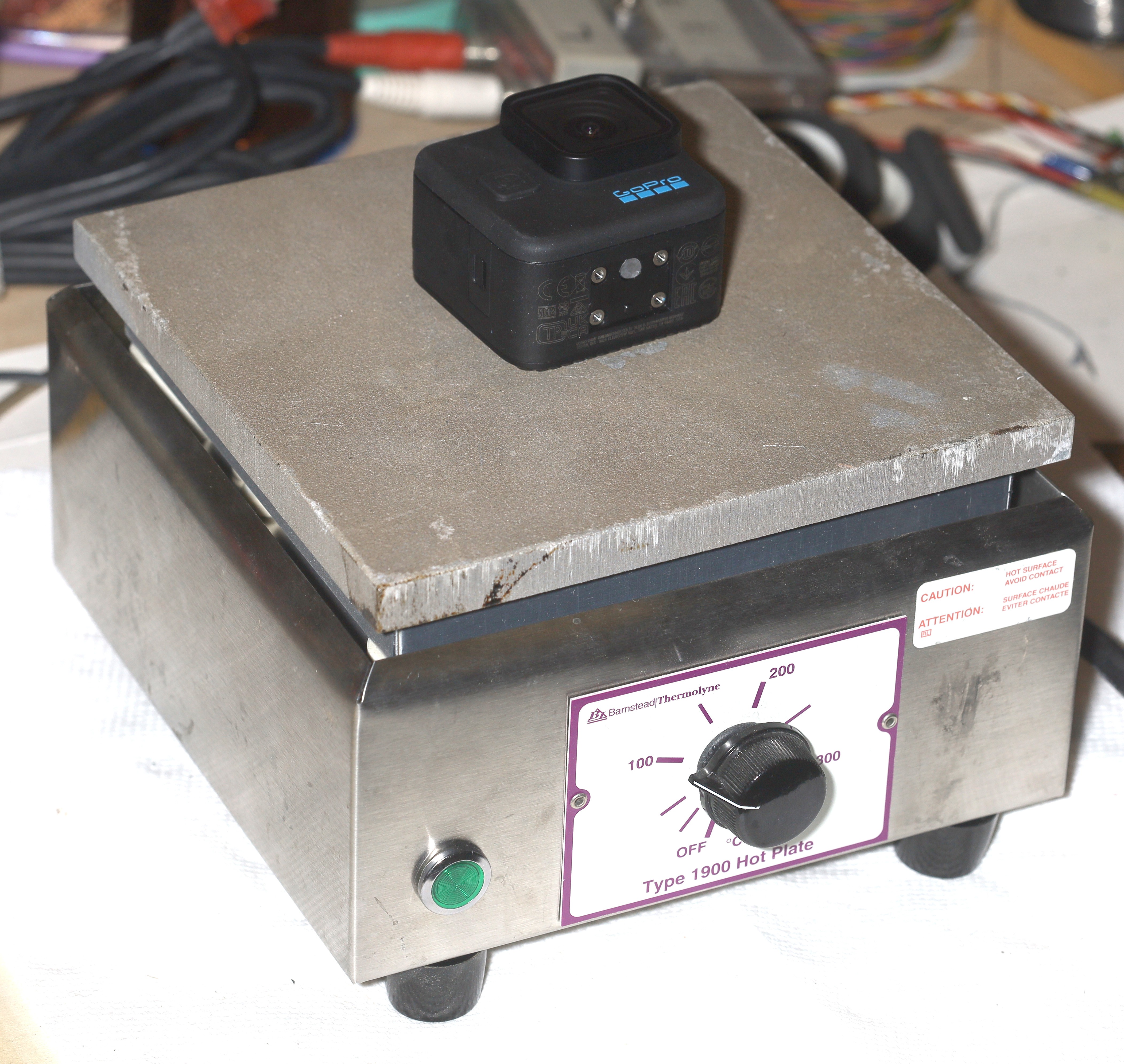

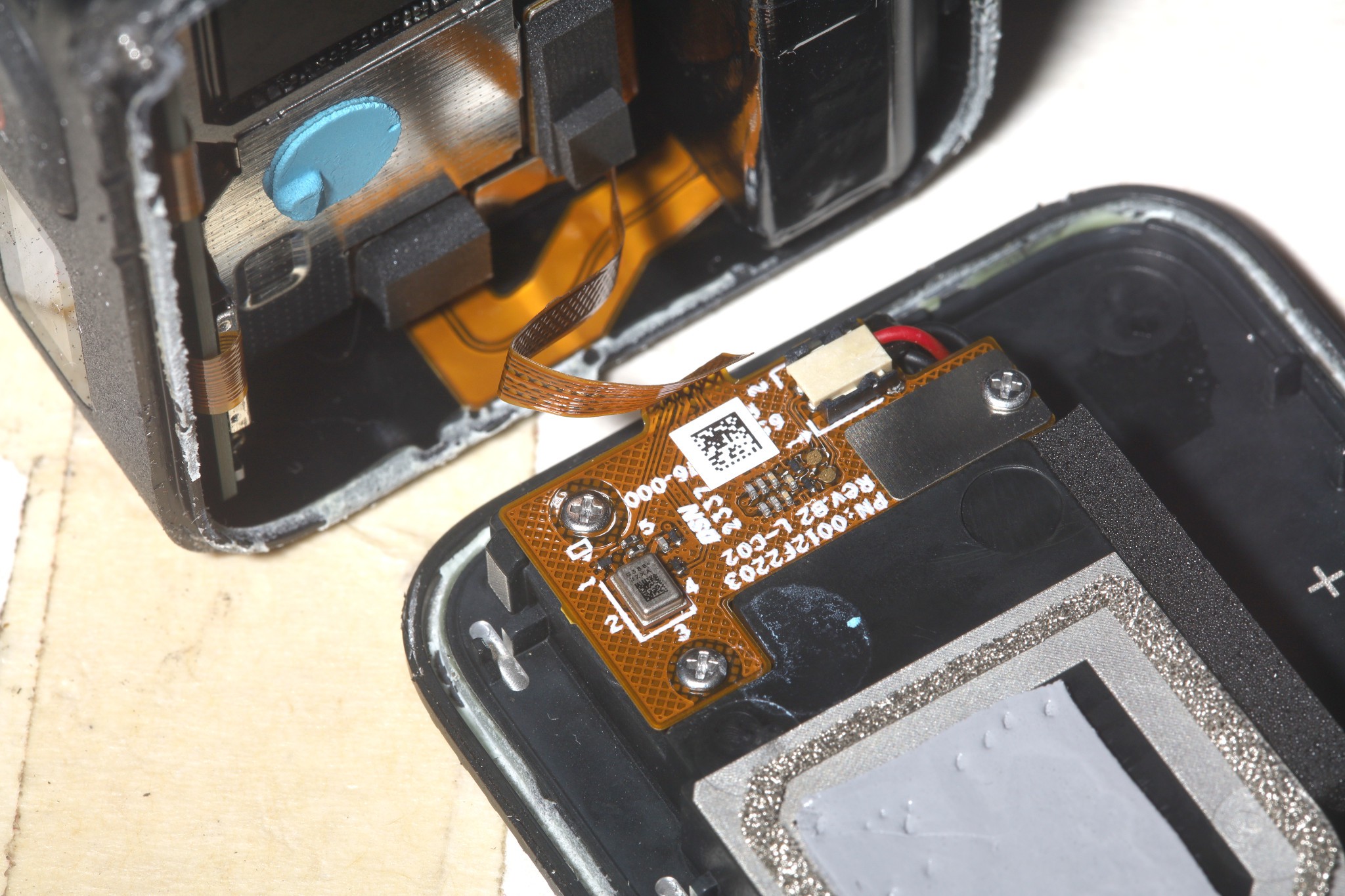

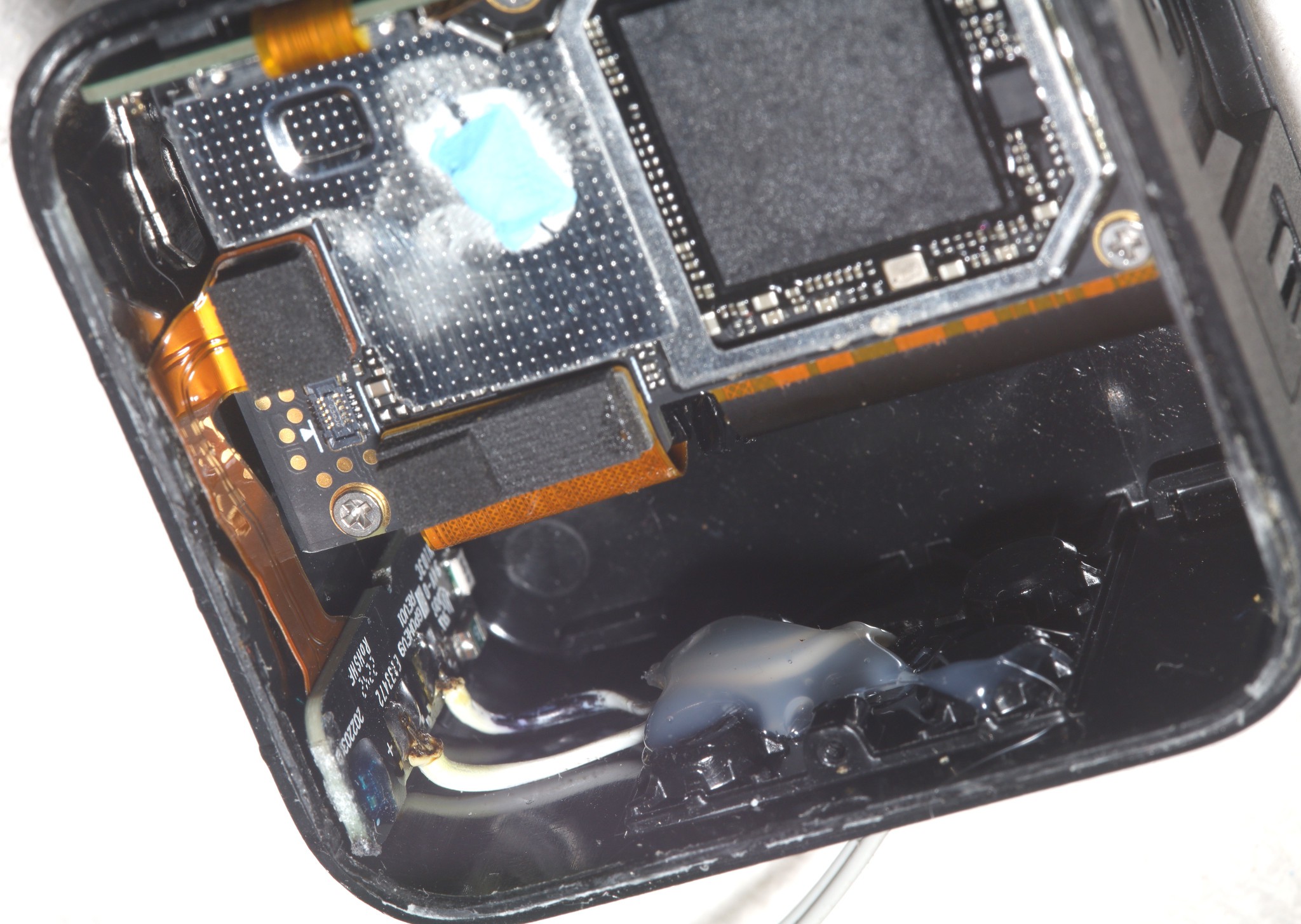

09/10/2025 at 23:22 • 0 commentsAlways trying to get a free lunch, the lion kingdom decided it was time to upgrade to the cheapest, lightest gopro available. The trick is it has a fixed battery with 1 hour of recording time, while a typical lion run is 4 hours. The battery contains a DRM chip which the camera requires to start up. A USB cable on top of the battery would be really heavy & the battery management chip is known to randomly fail.

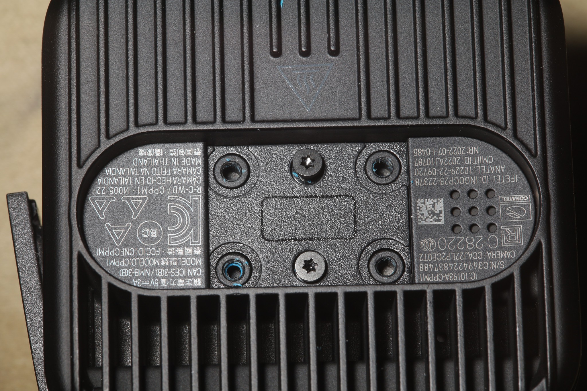

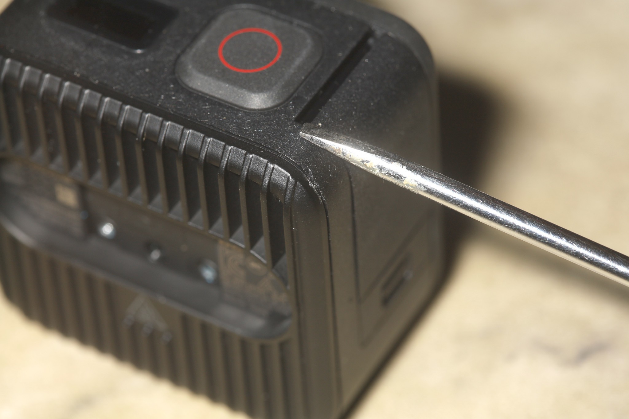

The journey begins by removing the easy screws.

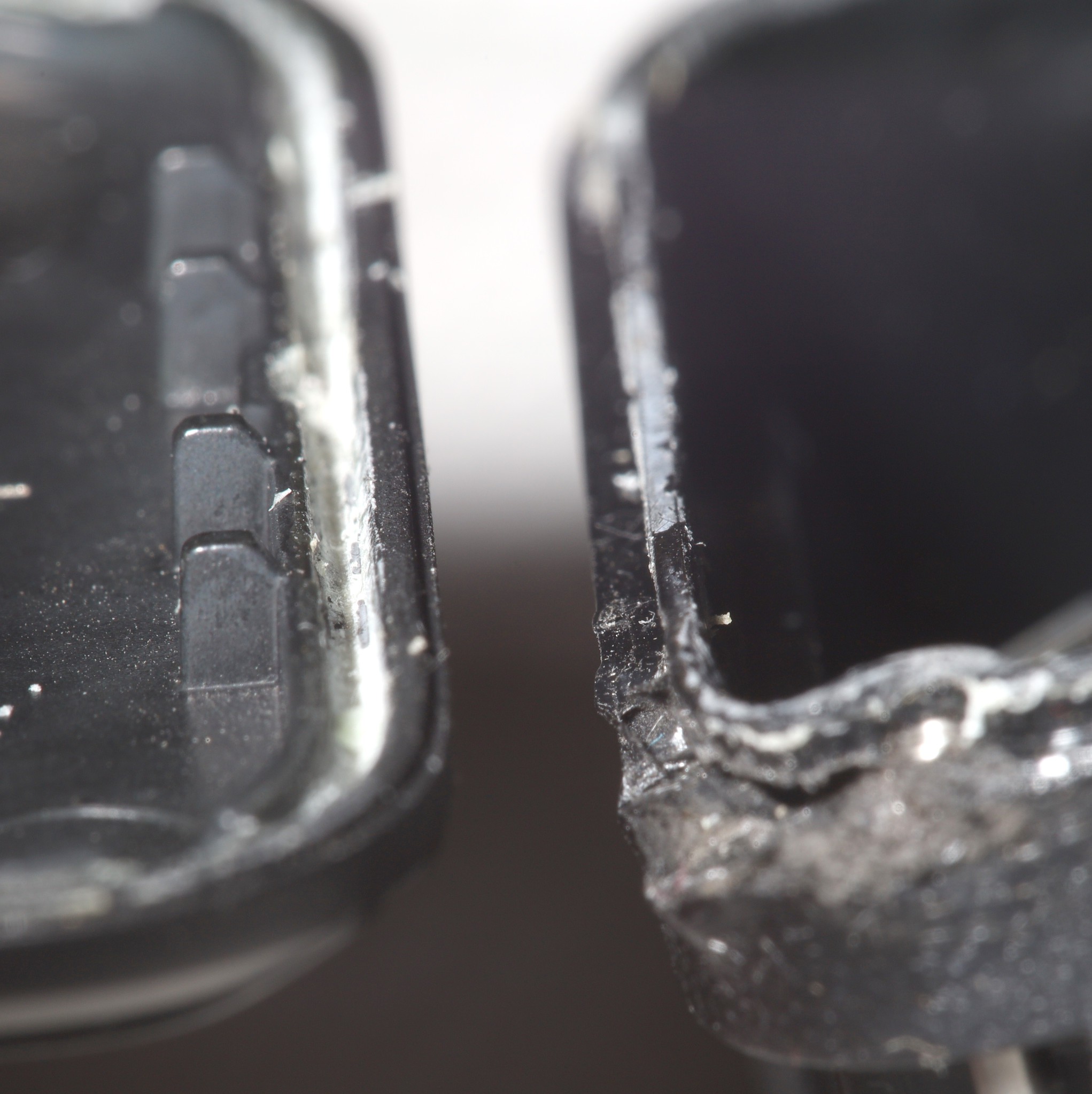

This hot plate had to be set to 150C to get the heat sink hot enough.

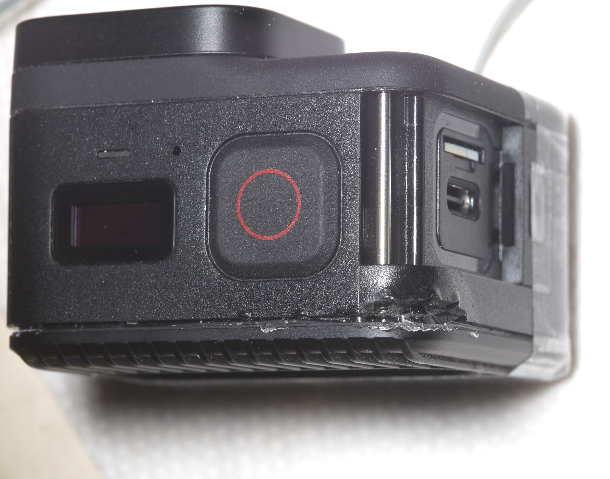

After many attempts to heat it & pry the adhesive with an xacto & screwdriver, the decision was made to grind a starter groove into the plastic in the top right corner.
Then let it sit on the hot plate for a long time to get the heat sink over 80C, while probing it to make sure it doesn't go over 80C. Then the groove gave the screw driver enough purchase to pry apart the heat sink. This had to be done carefully to avoid breaking the flex cable.
The speaker & microphone are on the heat sink.

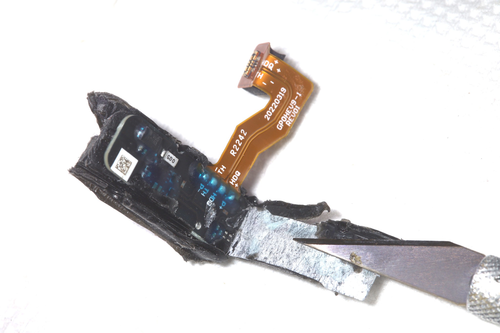

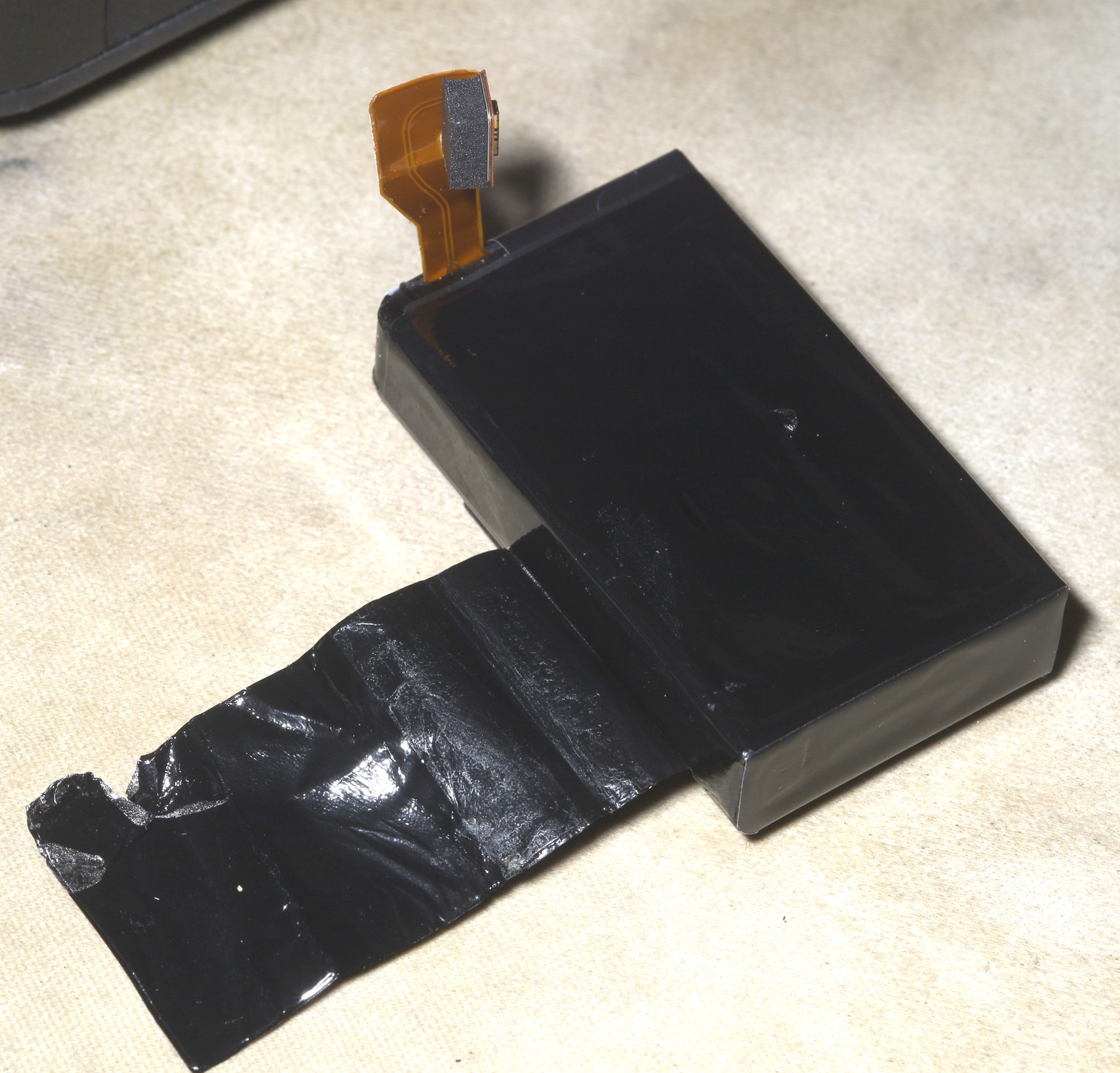

Then the battery flex cable had to be peeled off its adhesive. The battery caddy had to be unscrewed.

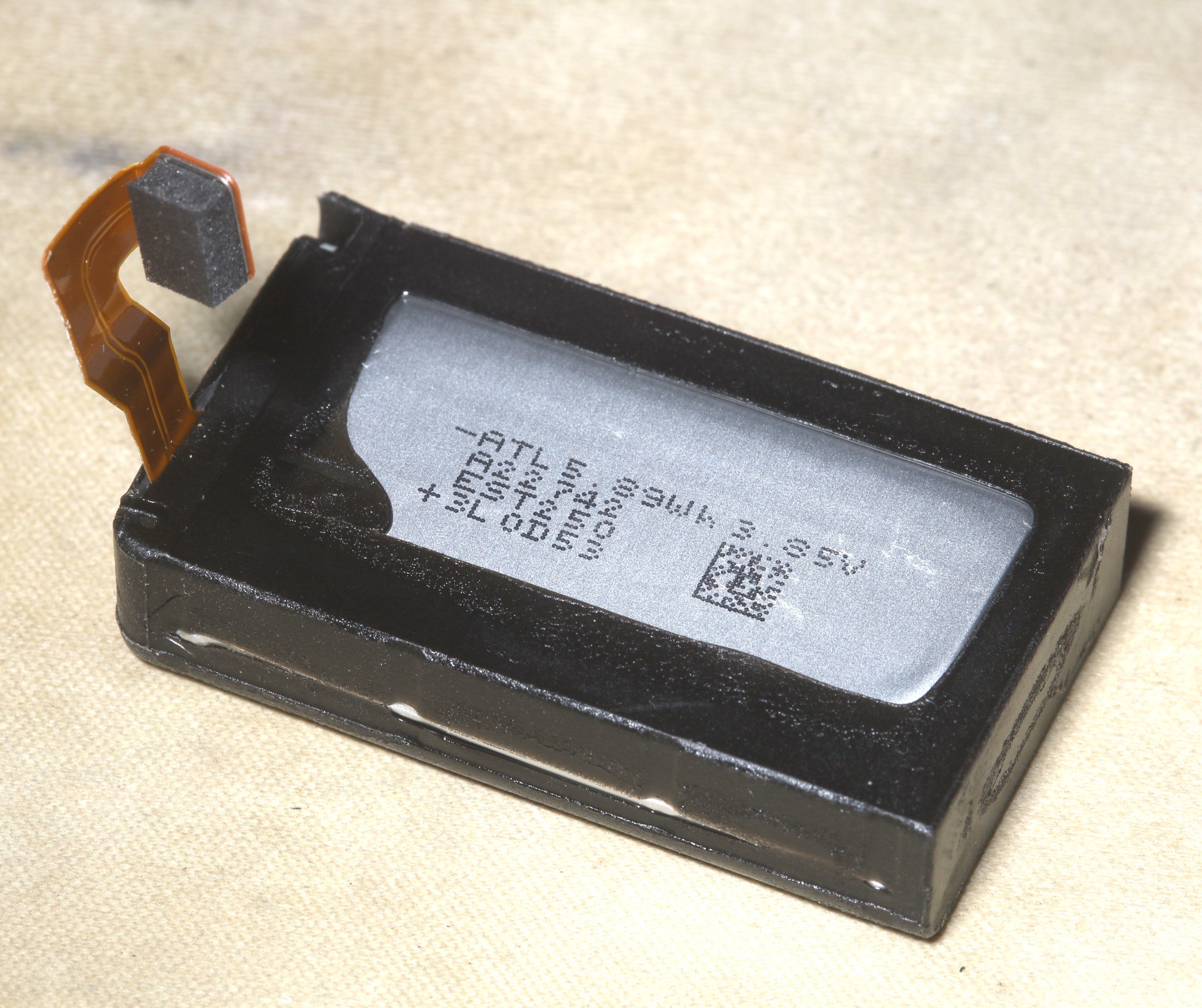

Then the battery is pulled out by the wrapper.
The DRM board & battery are potted.
The potting compound rips off.
Eventually revealing the tabs. These can be work hardened until they break off.

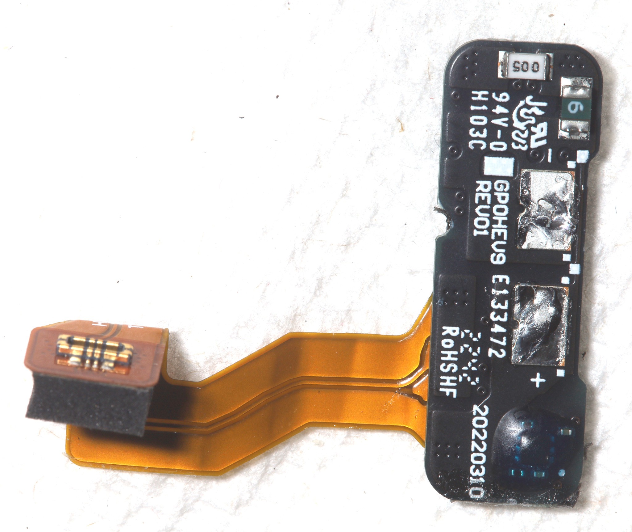

Then potting compound can be slowly cut off the DRM board.
The DRM board is finally revealed.
Now the great task is routing the former battery pads outside the camera, where they'll connect to either a single cell or buck converter. Lions don't have any single cells of suitable size so a soldered buck converter seems ideal.
Some time was spent scraping adhesive so the heat sink would press fit back in place.
The wires came in a widened hole on the bottom. Lions did the best they could with the hot snot in such a confined space.
The heat sink was taped back on. It wouldn't power up unless the speaker module was connected. The heat sink has to exert a static force on the flat flex cables & the SIL pad. It won't passively stay in place without adhesive or a new enclosure.

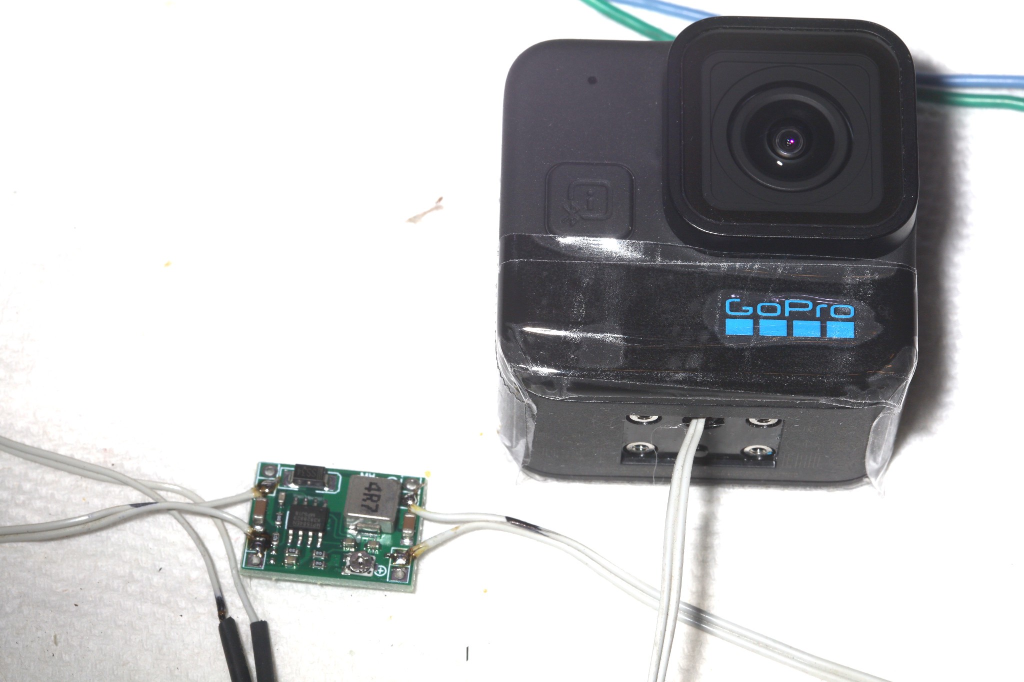

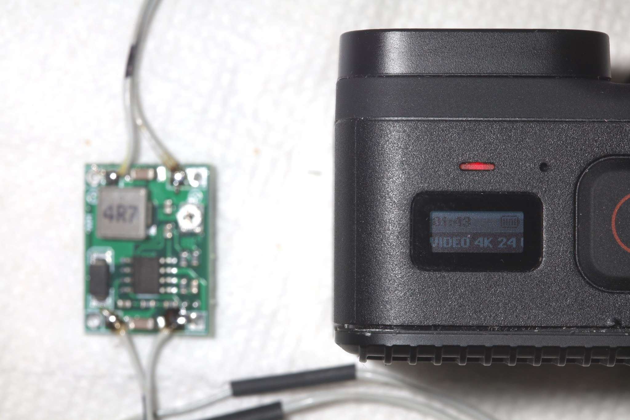

It was set to 4.5V. It could handle 4.6V, but it's so hard to trim the pot, lions set all the gopros to 4.5V. The buck converter was 270mm of wire from the camera.
The mane problems were insufficient SD card speed to record 5.3k 60fps. Lower resolutions died from overheating. This camera doesn't support 1920x1440 or frame rates below 60fps below 2.7k.
It burned 3A 4.5V when recording 5.3k 60fps so it probably needs a bigger buck converter. The mane problem is the overheating. Squeezing it to make the SIL pad more assertive, it gets too hot to touch & shuts down.
The internet stories of attaching a fan instead of the heatsink are the chatgpt garbage we've come to know & love. It's going to need a fan on top of the heat sink & an enclosure to keep the heat sink attached. It may end up being just as heavy & bulky as the full gopro.
