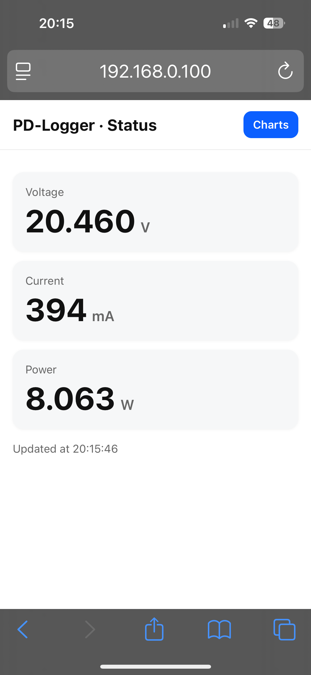

    Once assembled and flashed, the PD Logger is very straightforward to use.
    1. Connect it between a USB-C charger and the device you want to power. In this example, I tested it while charging a tablet.
    2. As soon as the charger negotiates with the load, the PD Logger powers up and joins the local Wi-Fi network.
    3. Open a browser and go to pd-logger.local (or the device’s IP address). You’ll see a simple web page that shows the current voltage, current, and power. The values update automatically every 5 seconds.

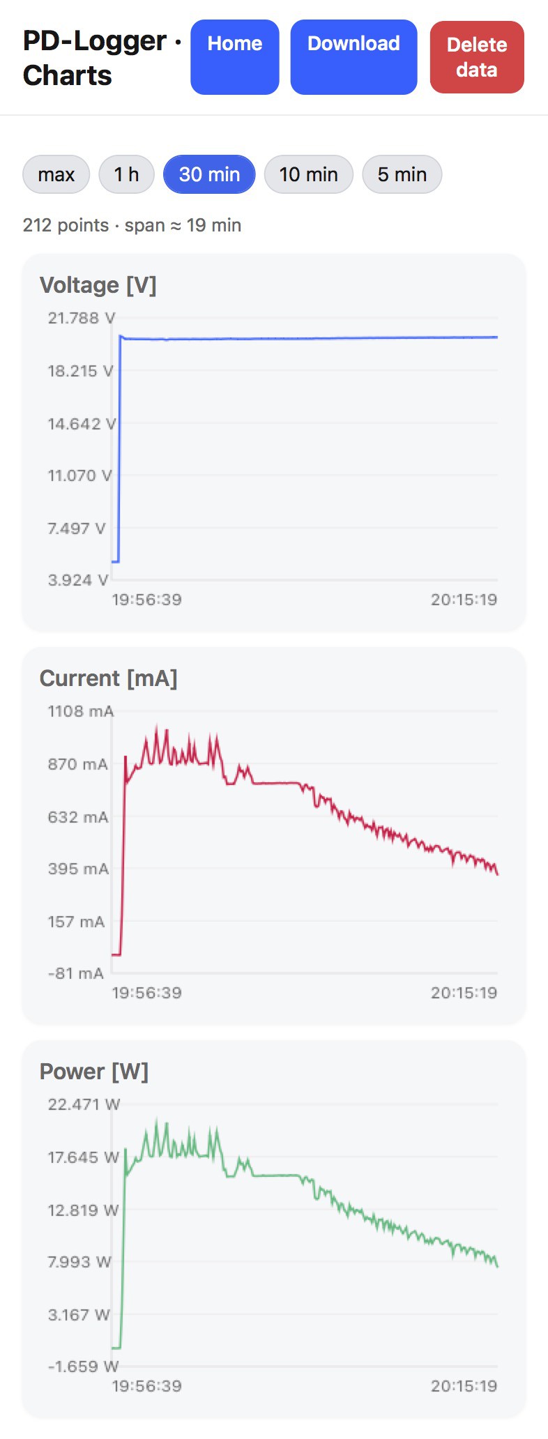

    But the Logger can do more than live readings. All measurements are stored locally for several hours. By opening the /graphics page in your browser, you get interactive plots for voltage, current, and power over time.
    This makes it easy to analyze charger stability, load behavior, and even spot small fluctuations. The Y-axis auto-scales, so sometimes the variations look dramatic—but a closer look at the scale often reveals that the changes are tiny.
    Finally, the Logger also provides a CSV export button, so you can download the data and analyze it further in tools like Excel or Python.
    With this setup, any USB-C charger becomes a transparent, measurable power source—and all you need to access the data is a web browser.

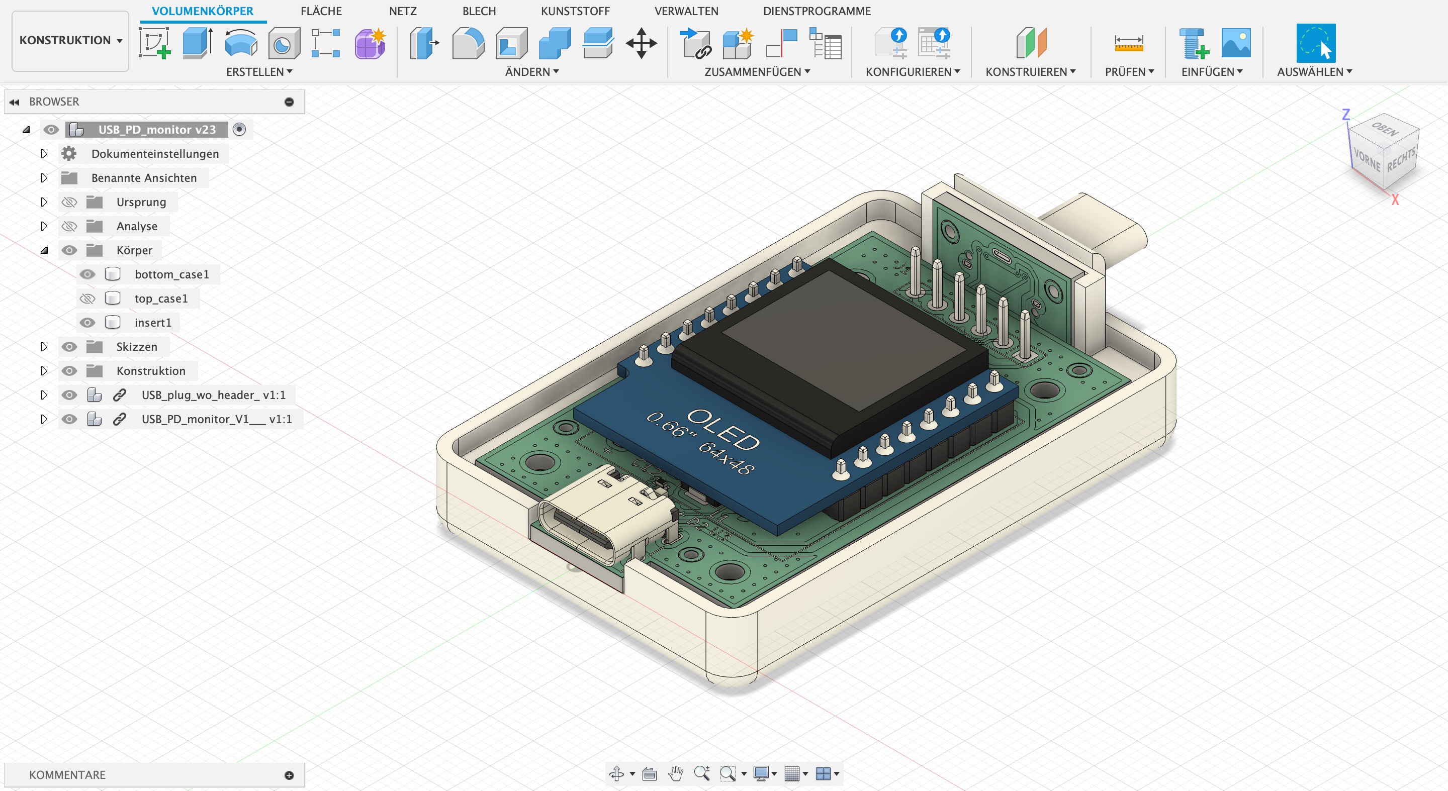

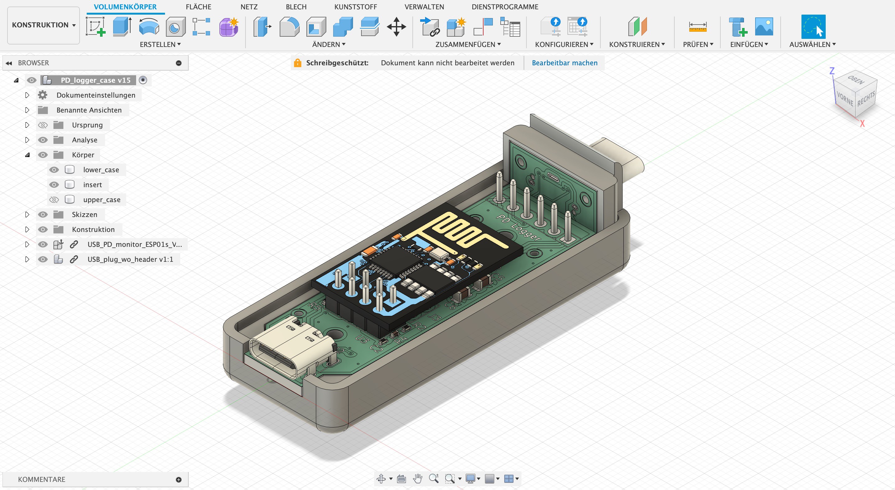

  • Designing and Printing the Case
    Ludwin09/11/2025 at 12:53 0 comments
    The enclosures for both devices were designed in Fusion 360. The design is intentionally simple: two shells and a small insert, which together hold the electronics securely in place.
    I wanted the cases to be not only functional but also practical for repeated use. Instead of using fragile plastic clips, the design relies on M2 screws to close the enclosure. To make this possible, M2 nuts are embedded during the print. The print is paused at just the right height, the nuts are inserted into the cavities, and then the print continues. This creates durable threads that can handle many assembly cycles.
    The models are included in the GitHub repository and can be 3D-printed on any FDM printer. PLA works fine, but PETG is more robust if you expect frequent handling.
    This approach keeps the assembly straightforward: slide in the electronics, close the case with four screws, and the device is ready to use.

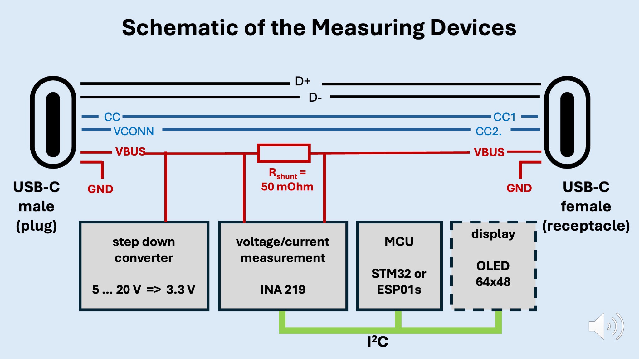

    Here’s a high-level schematic of how the measuring devices are built. At the core, the design is simple but effective:
    • USB-C plug and receptacle
      The device sits in-line between the charger and the load. All essential signals are passed through so the load can negotiate properly with the charger.
    • CC and VCONN lines
      These are carried from input to output to maintain proper Power Delivery negotiation.
    • VBUS shunt resistor
      A small 50 mΩ resistor is inserted into the VBUS path. By measuring the voltage drop across it, we can calculate the current flowing to the load.
    • Step-down converter
      Converts the charger voltage (5–20 V) into 3.3 V, powering the electronics regardless of the PD profile.
    • INA219 measurement chip
      Handles accurate voltage and current measurement over I²C.
    • Microcontroller
      Either an STM32 (for the OLED Power Meter) or an ESP-01s Wi-Fi module (for the PD Logger).
    • Optional display
      The OLED Power Meter uses a small I²C display to show live data. The PD Logger skips the display and instead serves a web interface.
    This modular architecture allowed me to build two different tools from the same foundation—one optimized for quick bench checks, the other for long-term monitoring and logging.
