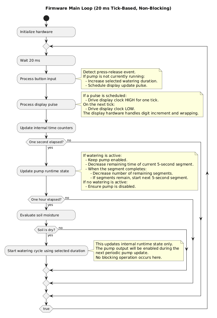

I was thinking that water won't disperse immediately into the entire soil volume when the pump starts, so the sensor might still report that it's dry if checks are too frequent. This could cause the device to water the plant multiple times in a short period.
To fix this, I think the firmware will check every hour if the soil is dry and only then start watering. One hour should be enough for the water to dissipate.

Software
Software is written in PIC-AS assembler dialect.
Flow diagram is shown below.

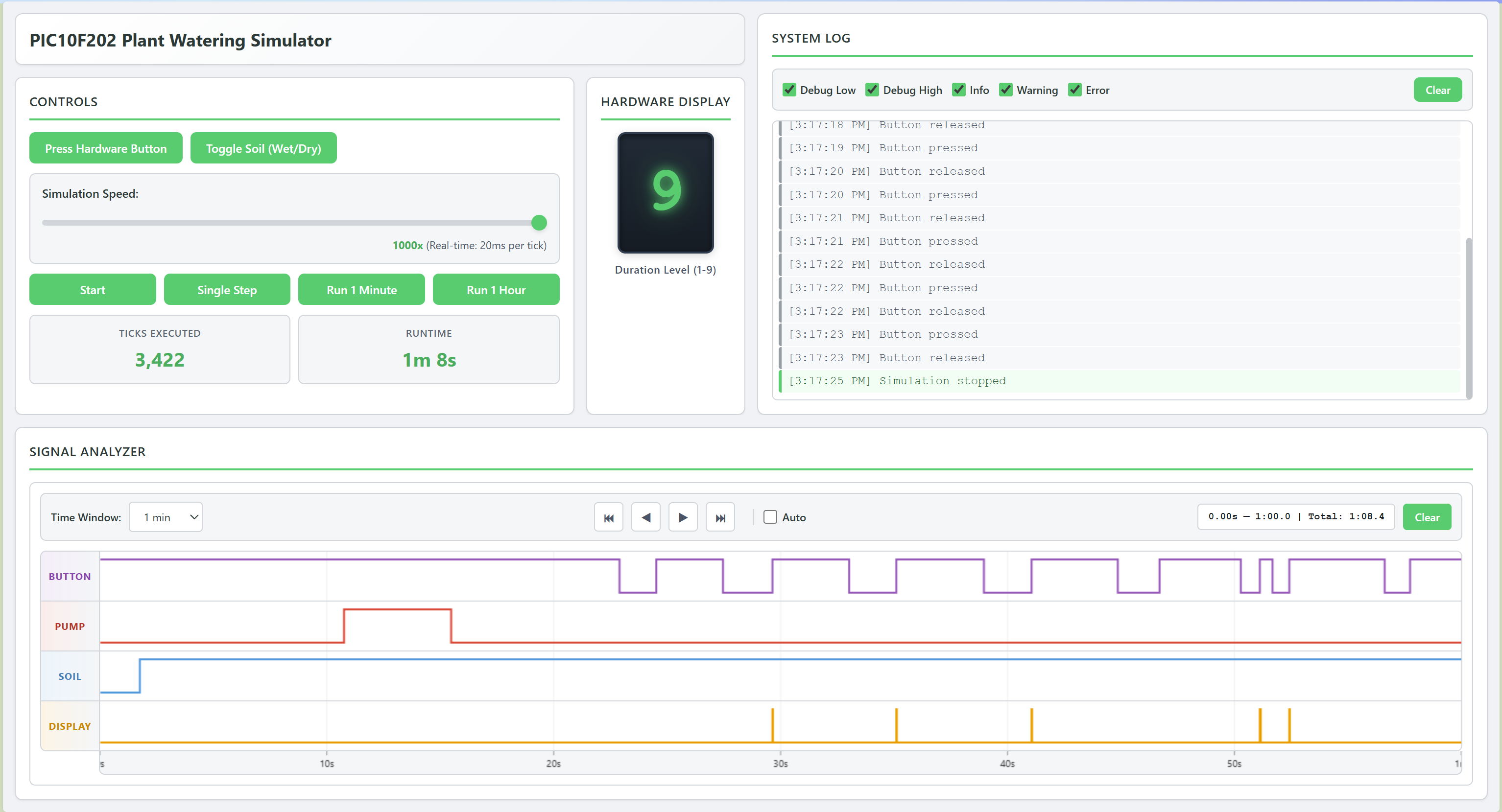

Simulation
The software can be run in a web browser to speed up development (no need to flash the device, soil humidity can be simulated as wanted, etc.).

  • Firmware Emulation in the Browser Using WASM
    Robert Gawron03/08/2026 at 16:13 0 comments
    I've built a version of my C firmware that runs in the browser. I stubbed the hardware peripherals using JavaScript, I can run, test, and validate high-level logic directly in the browser without needing to flash the real device.
    This approach has several benefits:
    • I can simulate soil humidity changes and similar inputs, making firmware validation much easier.
    • It allows for logging directly from the firmware (which the hardware build can't do, since the PIC10F202 lacks a UART peripheral).
    • Additionally, I have coded a small logic analyzer that displays the state of all the microcontroller's GPIOs and allows me to set input pins, simulating data from push buttons and soil sensors.
    The simulation setup includes:
    • High-level firmware code: this does not communicate with hardware directly, but instead uses a Hardware Abstraction Layer (HAL).
    • Tiny HAL in firmware: when built for hardware, use real peripherals; when built for emulation, use JavaScript hooks.
    • WASM Compilation: the firmware is compiled from C to WebAssembly using Emscripten, which also generates the necessary JavaScript glue code. The build process uses Meson (I wanted to try something new, could be cmmake instead), and for easy launching, I use the just tool - it’s excellent for automating one-liners, and I’ll definitely be using it more often!!
    • TypeScript application: this orchestrates the firmware via the aforementioned hooks and handles the web page display.
    • HTML and CSS: The frontend structure for the web interface.
    You can check the source code on project's GitHub.

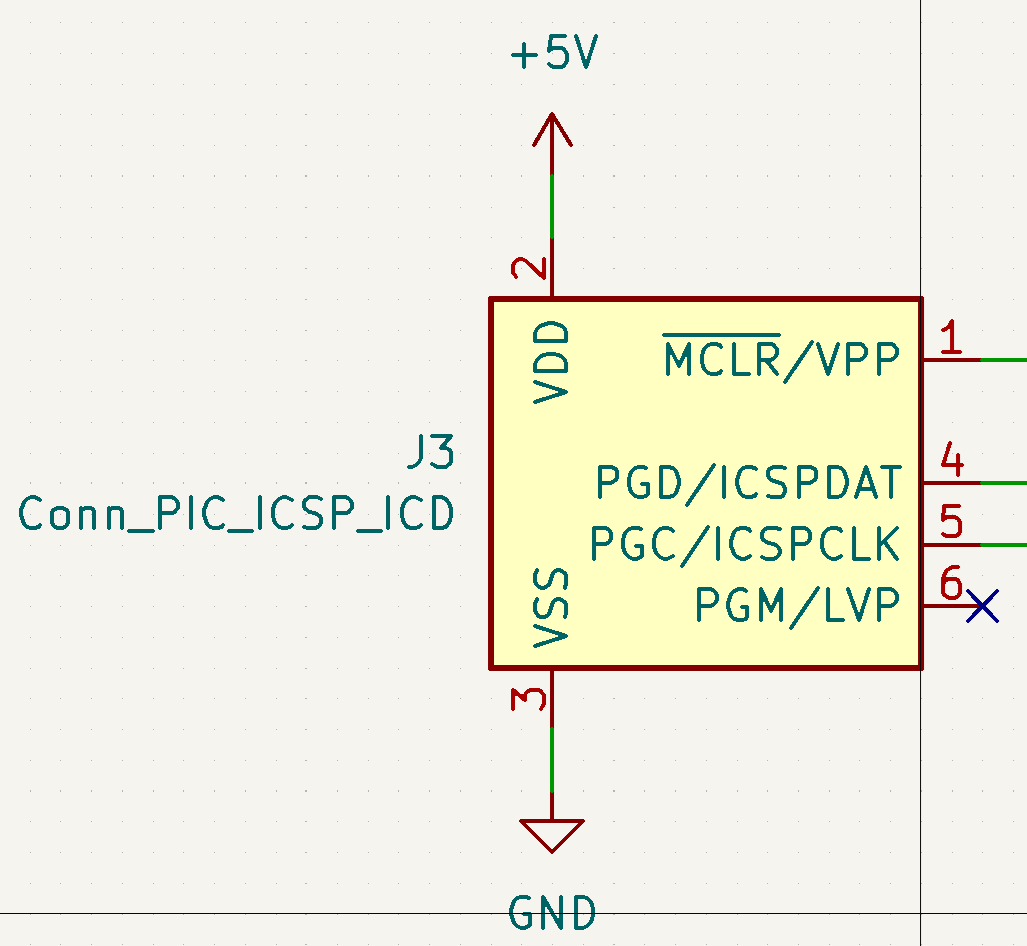

    • KiCad has a connector for a PIC ICSP programmer (component name: Conn_PIC_ICSP_ICD). I will use it so that the programmer can be plugged directly into the board—no need for jumper wires, which are error-prone.
