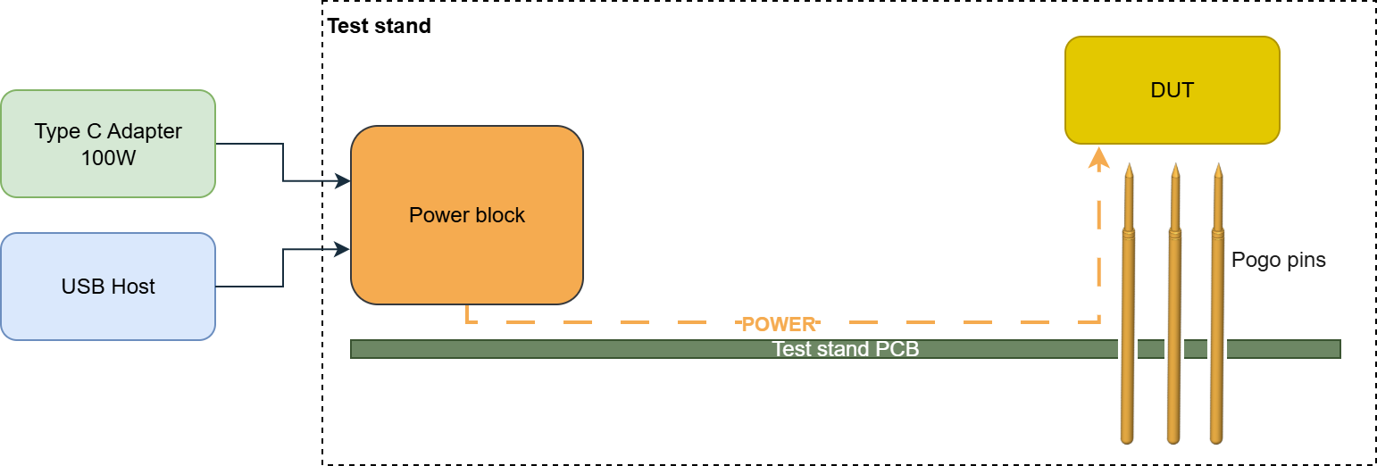

Structure
  • USB Host - control device (PC, single-board computer, laptop, etc.),
  • DUT - load, device under test
  • Type C Adapter - any USB-C power source, e.g., mains, power bank, laptop, phone.
  • The MCU controls all parts of the unit. This makes it possible not only to control the source from a PC, but also to load presets according to a predefined algorithm and link the power supply to external events.
  • PLD connector - a universal connector that provides input and output power, USB control, microcontroller interfaces, and logic power.
Of course, this is a specialized power supply, and we do not intend to replace laboratory power supplies. Let's talk more about the application options.

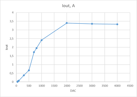

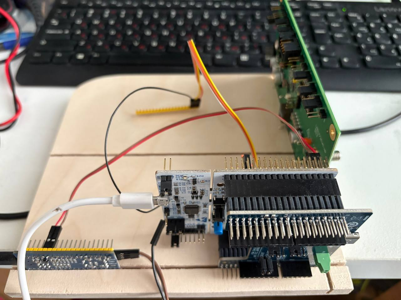

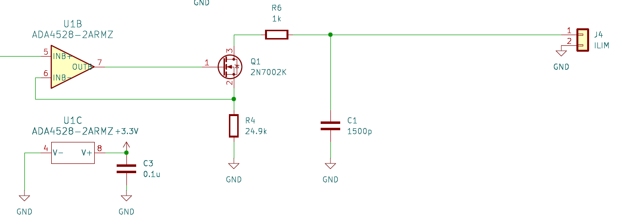

  • ILIM emulation test
    Ioan Larionov10/06/2025 at 19:39 0 comments
    We've stuck a little bit with the average current regulation when our supply goes to the CC (constant current) state. The LM51772 has an internal DAC for Iset, or we can set a resistor between ILIM and GND. Our goal is to substitute Riset with our scheme so that we can set it with the DAC of the MCU:
    At first, it was ringing a lot, but after the wires shortened, it became much stable and we can control the current! That was because our auxiliary scheme had become a part of the control loop. In the prototype, we should be very careful with it.
    Here you can see gorgeous soldering PLS to PLS. Anyway really small current goes about 7cm from the chip to our loop...
    Let's get to the result:
    We can control the current from 40mA to 3.4A with a step of 0.7mA.
    - Shunt should be bigger, not 10 but 20mOhm
    - Add filters to ILIM to adjust the speed and stability of the loop
    - Be careful with routing in the prototype due to high sensitivity and tiny currents.
    - DAC signal should be divided

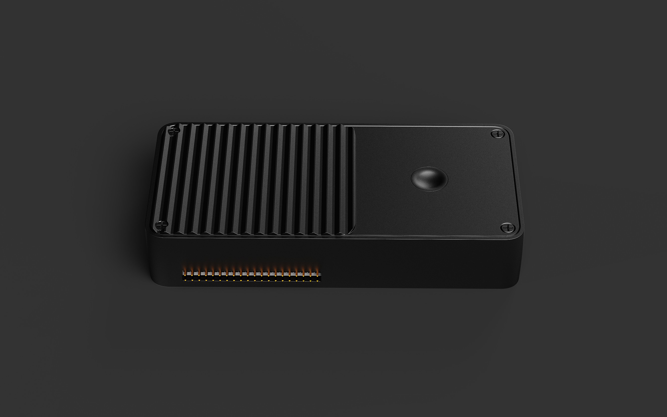

  • Design Update: PowerBlock-323 Housing
    Andrew10/03/2025 at 01:57 0 comments
    Our team at Encadra has joined the development of PowerBlock-323.
    We are contributing our experience in product design and enclosure engineering to help move the project forward.
    As part of this work, we are now evaluating two enclosure directions: one made from bent sheet metal and another from solid aluminum. Both versions share the same functional layout, but they differ in manufacturing methods and trade-offs.
    We will continue to share design updates as the project evolves. Next topics may include thermal aspects, assembly approach, and finishing options. Feedback from the community is very welcome.

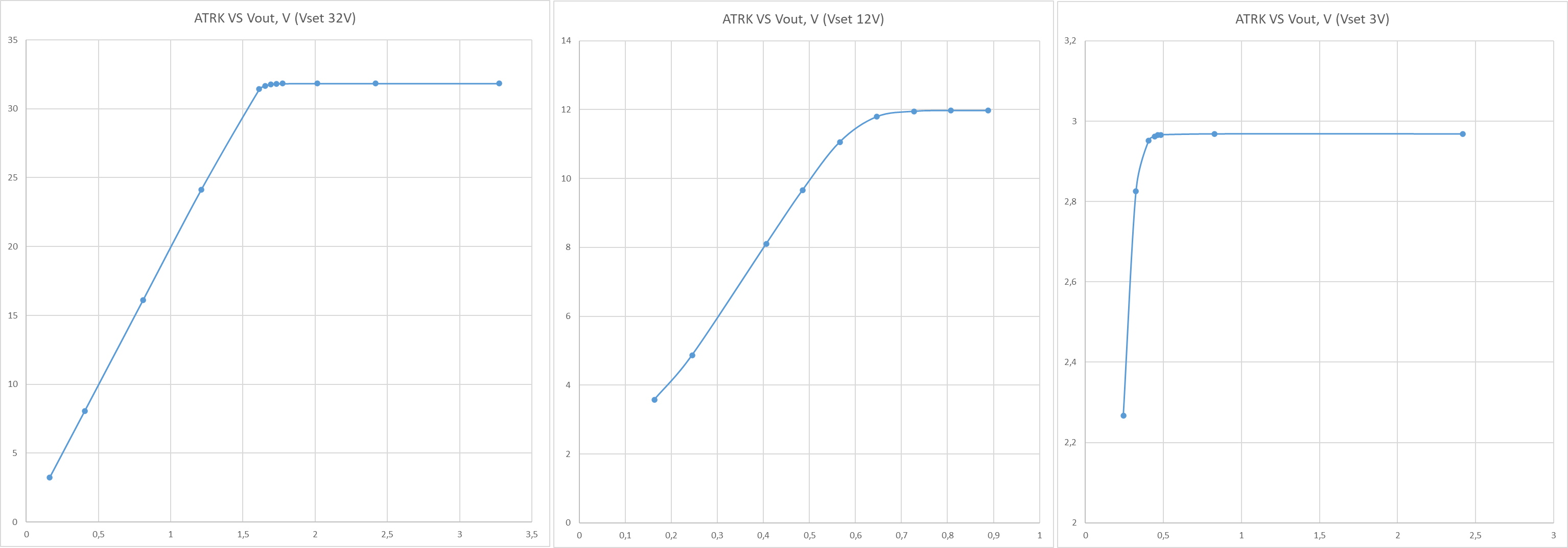

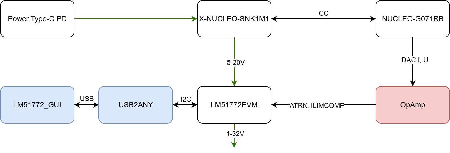

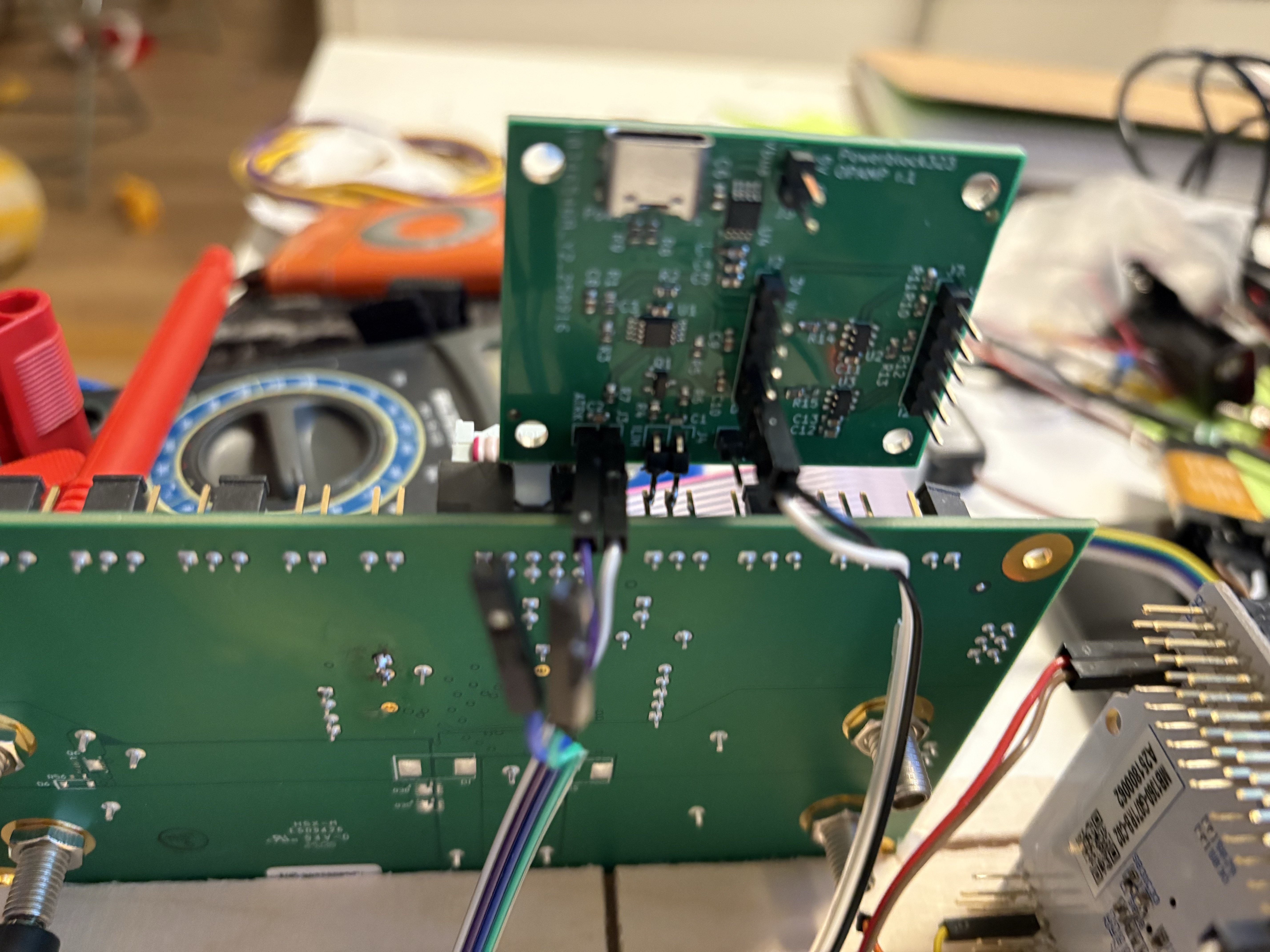

  • Testing ATRK Regulation – Mockup #1
    Ioan Larionov09/24/2025 at 17:50 0 comments
    Our op-amp PCB is currently stuck somewhere in Finnish customs (classic…), so instead of waiting, we kicked off Mockup #1 testing without it.
    The first experiment focuses on the ATRK input for output voltage regulation on the LM51772EVM. The datasheet isn’t very clear about how this feature behaves, so let’s figure it out ourselves.
    Setup
    • STM32 DAC connected directly to the ATRK input of LM51772EVM
    • Sweeping DAC voltage while measuring Vout
    • Three different Vout setpoints, setup over I²C
    Observations

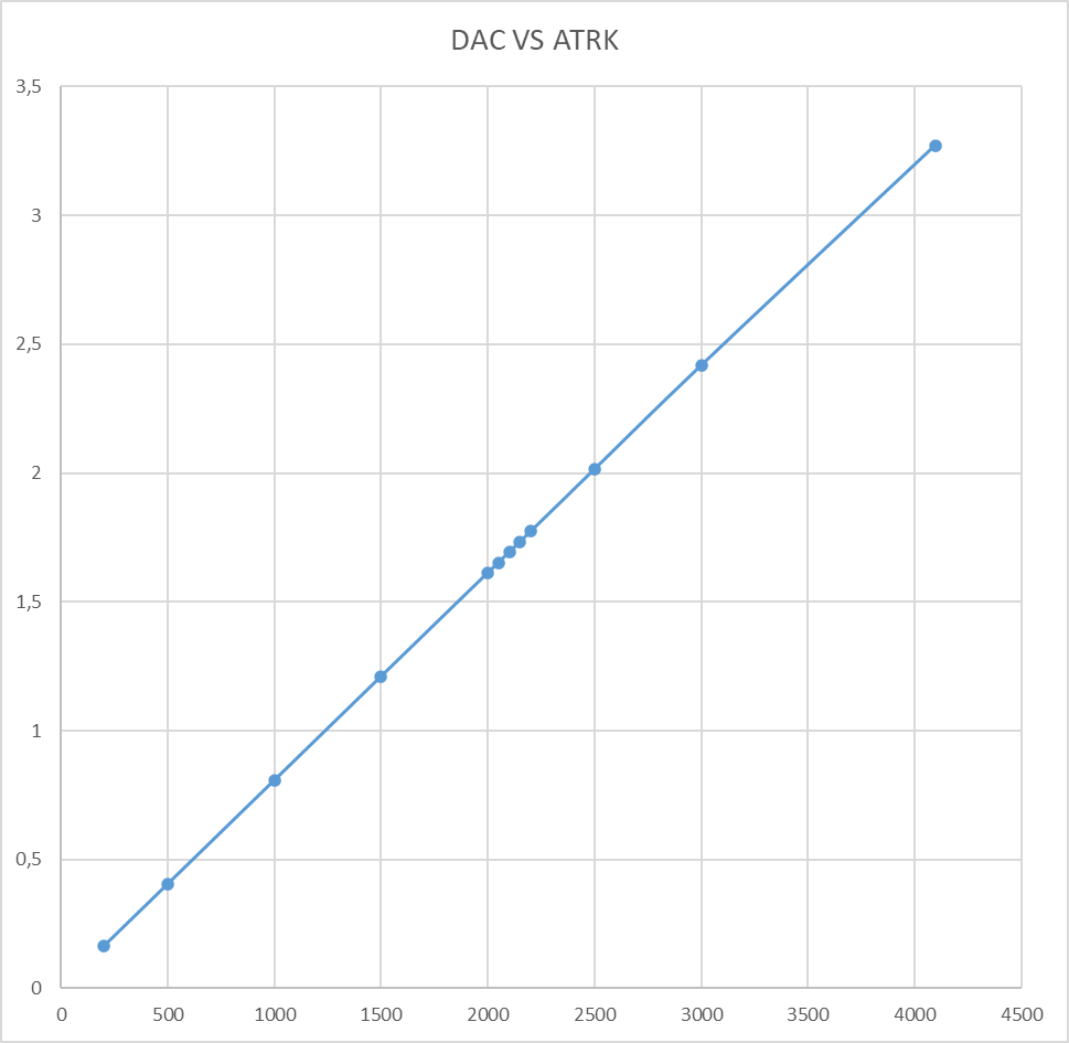

    At first glance, the DAC seems a bit nonlinear — maybe due to bias current? So we checked linearity directly.
    Result: DAC looks fine. That means the nonlinearity is a quirk of the LM51772 itself. And that’s actually fine for us. All we need from ATRK is the ability to slightly trim Vout (no more than ±50 mV).
    Results
    Near the maximum output of 32 V, the trim resolution looks promising:
    • ~200 µV/step for the last 10 mV of Vout
    • ~600 µV/step for the last 60 mV of Vout
    With an additional op-amp stage to amplify the DAC voltage into the desired range, resolution will only improve.
    DAC StepsATRK dVVout dVdV/step
    1000,080,060,0006
    500,040,010,0002
    Next steps
    Once the op-amp PCB finally arrives, we’ll move on to testing ISET regulation, comparing direct ATRK control vs. buffered DAC inputs with op-amps.

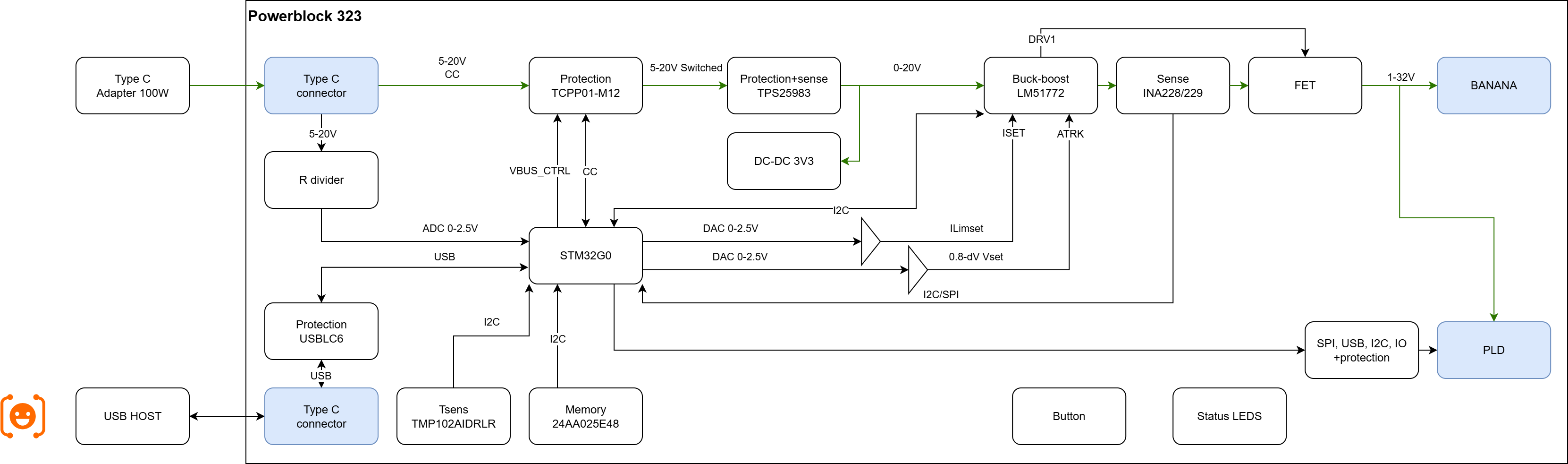

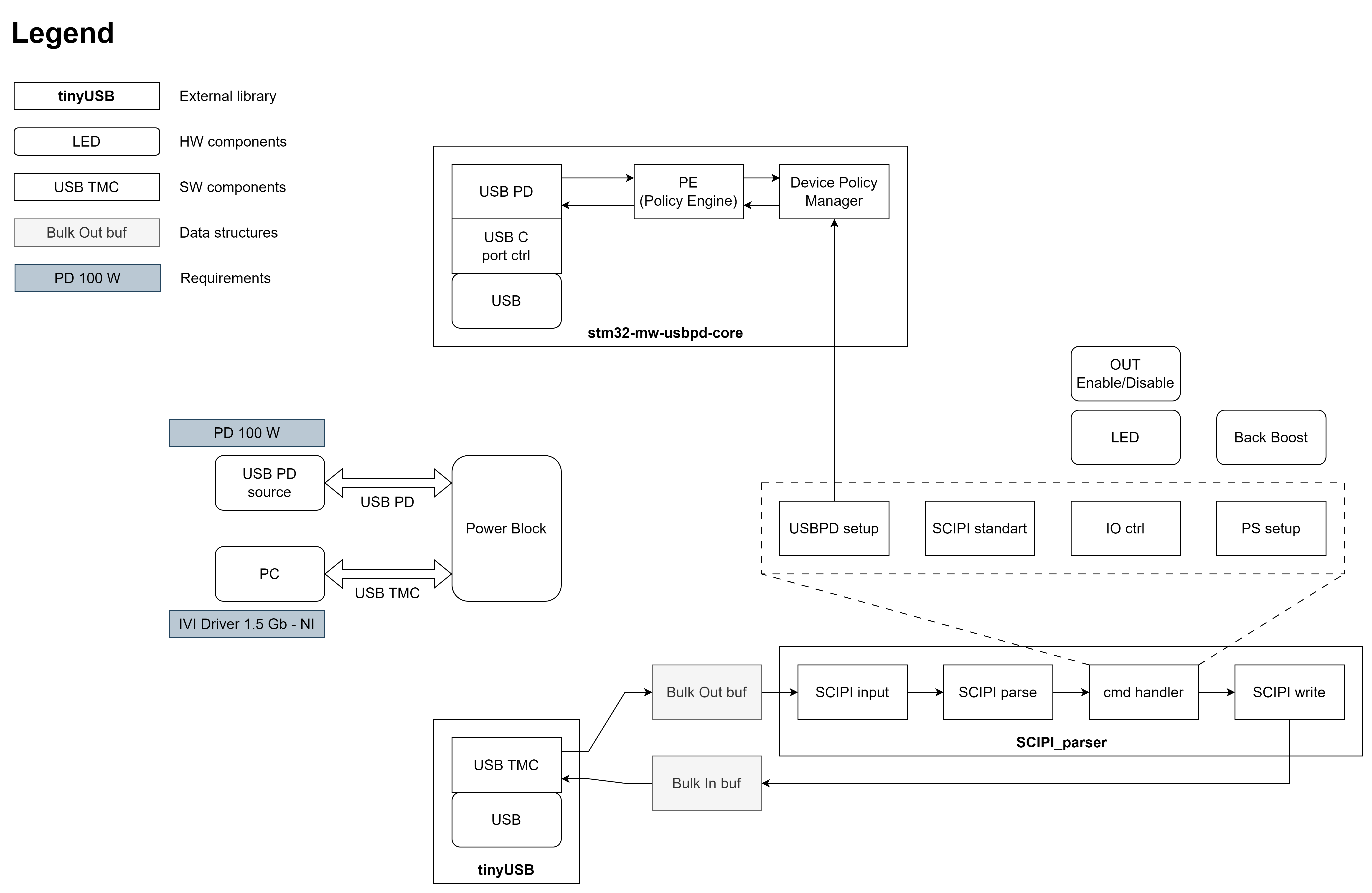

  • Embedded software architecture
    Ioan Larionov09/24/2025 at 17:29 0 comments
    When people hear “power supply,” they usually think about hardware: schematics, PCB layout, components, thermal design. And yes — our project is indeed a significant hardware challenge. But the real killer feature of the Powerblock 323 won’t just be its silicon — it’s the embedded software running inside.
    Why? Because in automated testing, reliability isn’t about shiny knobs or displays. It’s about software that can:
    • Negotiate USB-C PD profiles,
    • Parse SCPI commands without surprises,
    • React to overloads,
    • Stay stable after thousands of enable/disable cycles.
    That’s why we’re starting to outline the firmware architecture early. The block diagram above illustrates our conceptualization of the system.
    In short: we’re treating firmware as a first-class citizen, not an afterthought. A PSU for DUT testing is only as good as its software brain.
    This is just the first sketch, but it already helps us see where complexity lies and what needs extra attention.
    BTW, SCPI parser works + first USB PD negotiation tests ok. Next step - make them work together.

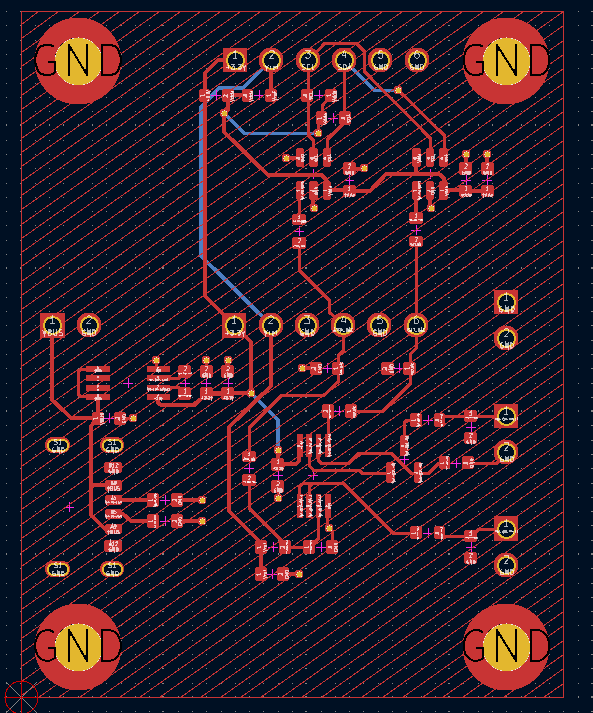

  • Mockup #1 - Opamp board
    Ioan Larionov09/22/2025 at 08:39 0 comments

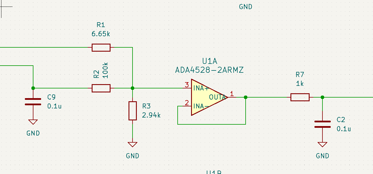

    Scheme
    Voltage control
    LM51772 gives the ability to control the output voltage in two ways simultaneously: I2C and external(ATRK or DTRK). To achieve a small error, we could set a rough voltage with I2C, then fine-tune it with ATRK. The DAC signal should be attenuated and shifted to near FB, 0.8V
    The goal is to manipulate the ATRK lower than 0.8V. So, adding 750mV and choosing a gain 20mV/V.

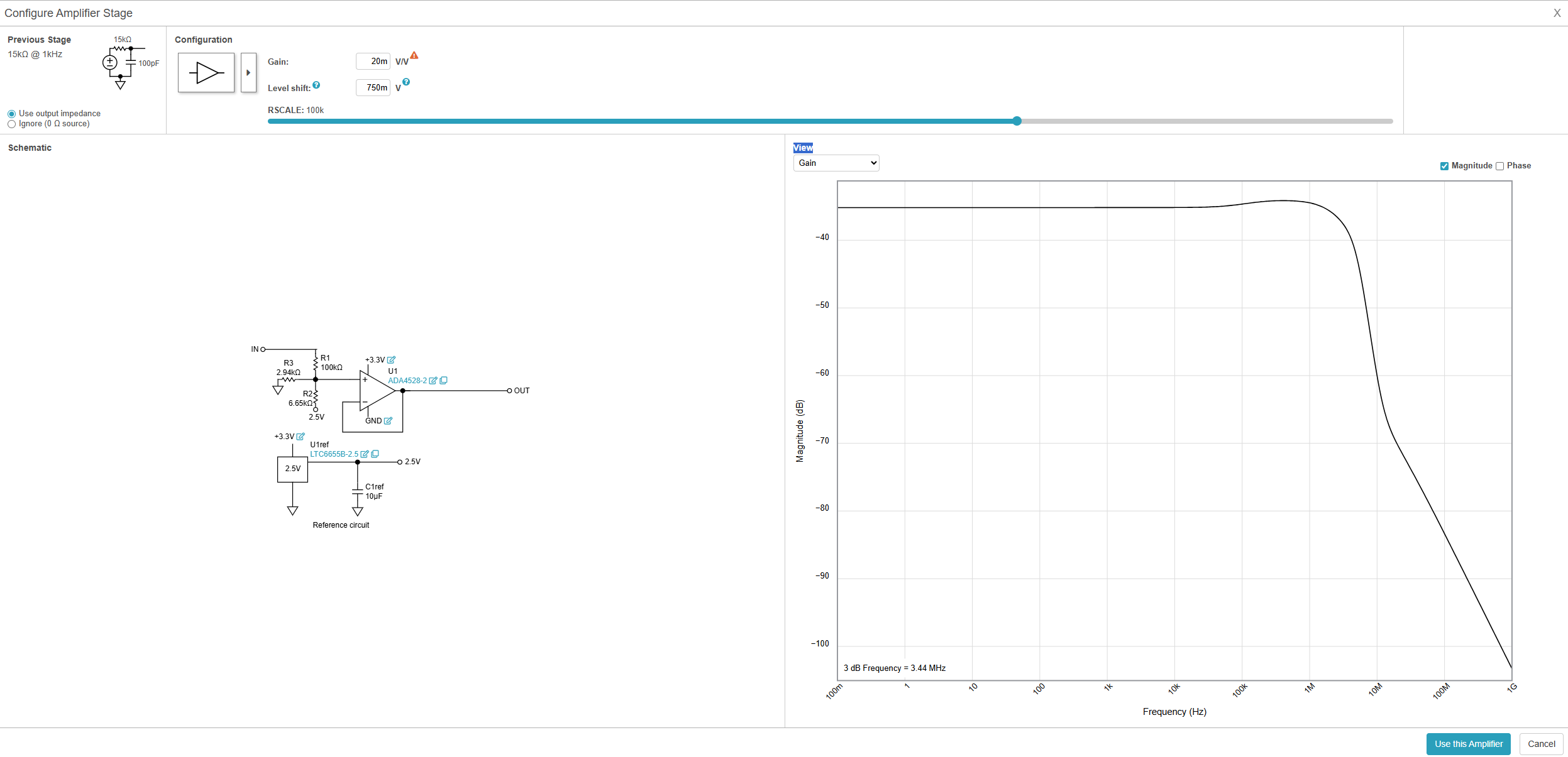

    Modelling with tools.analog.com
    AnalogDevices has an instrument for designing, so it's simple to generate new schematic:

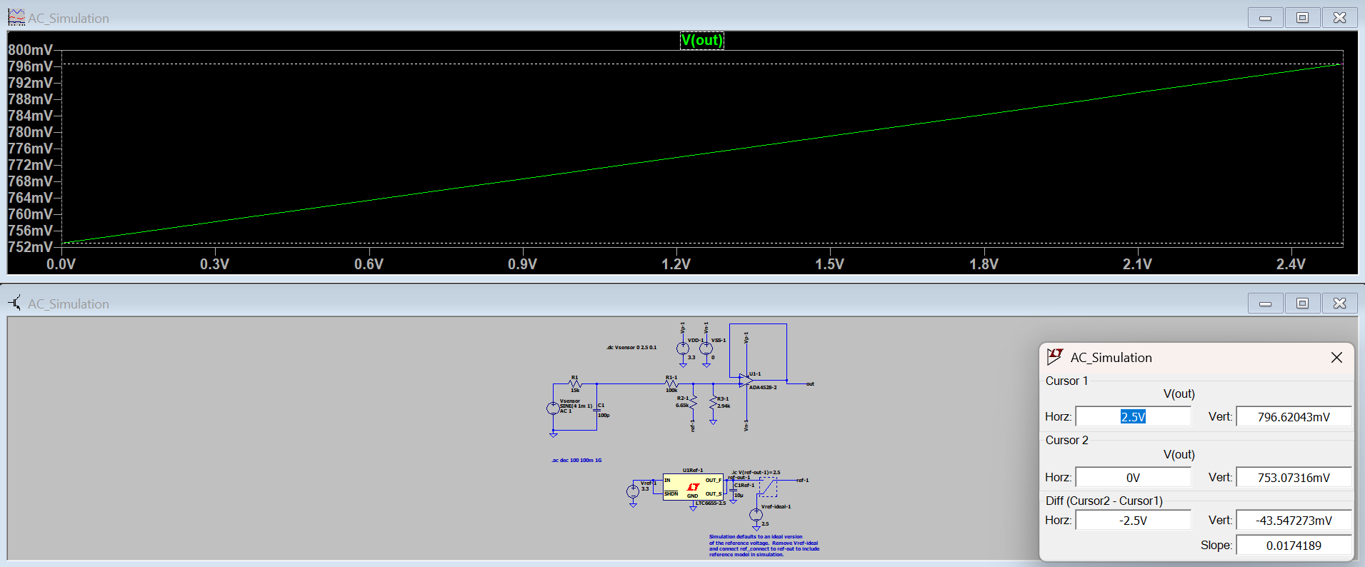

    Looks fine. Let's export and model in LTSpice
    Modelling with LTSpice
    DC sweep 0-2.5 Vin
    Achieved range in simulation from 753 to 796 mV. ATRK step - 12uV, Vout step - 0.5mV
    Average current control
    Average current control has another architecture, so we have two options:
    • 10/20mA steps via I2C. The desired step is 1mA.
    • External ISET with a resistor.
     Instead of a resistor, we'll use a DAC with a FET, stabilising the current in the ISET net.

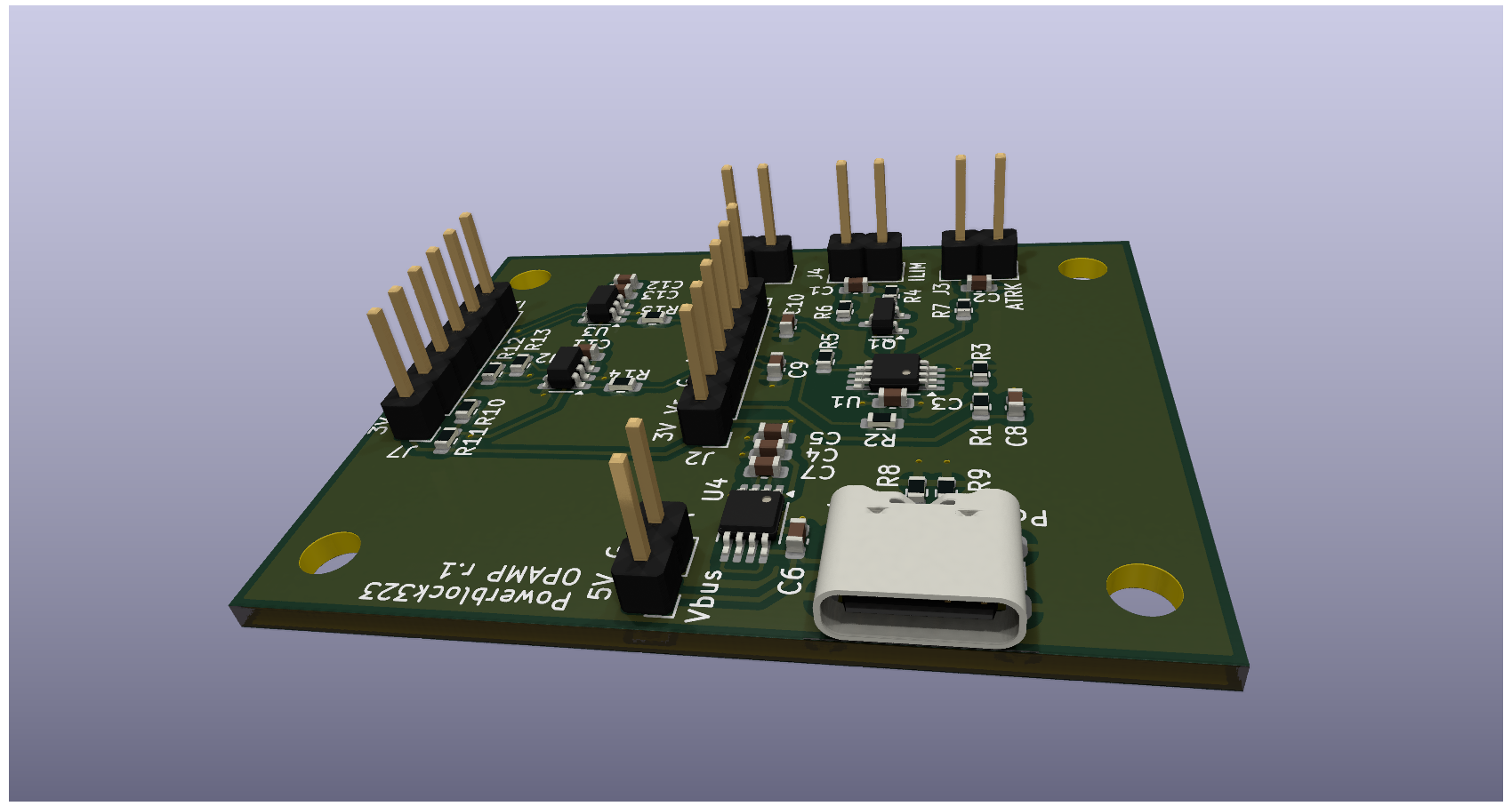

    External DACs
    Added DACS on the board just in case something goes wrong with the built-in STM32.
    PCB
    Simply put everything on the board
    This board connects the Nucleo board with the LM51772EVM. We're almost ready to test everything together!

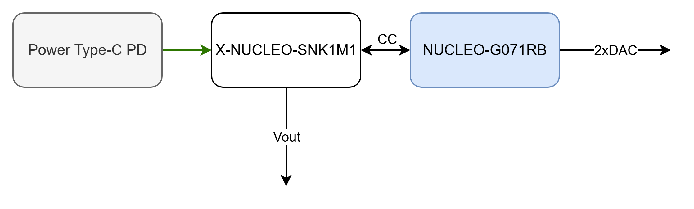

  • Mockup #1 testing software
    Ioan Larionov09/22/2025 at 06:36 0 comments
    Goals
    Test software is ready. Time to test the test software!
    Features to test:
    • STM32 PD controls the voltage from the Type-C power supply
    • 2 channels of the STM32 DAC are controlled in the terminal
    Why did I choose them? Regulation of Vout and average current - the biggest risk at the moment. PD is needed to test the power supply EVM with real Type-C inputs.
    Scheme
    Simple connection of two devboards from ST and a power adapter.
    Test
    For power delivery, there is a ready solution from ST. On the PC side using Stm32CubeMonitor UCPD. Manipulating voltage through the GUI is straightforward.
    The only moment was inconvenient - UCPD utilises Nucleo's USB-VCP only when the built-in ST-LINK is reconfigured to VCP + debug. In the default state (Drive+VCP+Debug), they don't work together.
    Results
    • 2 DACs are controlled through the terminal, but are twisted and
    • Can request USB PD supply with profiles:
      • 5V 1.5A
      • 9V 3A
      • 20V 3A
    Ready to power up LM51772EVM!

    Features to try:
    • STM32 PD controller
    • LM51772 Voltage and AVG current manipulation with MCU's DAC
    Key requirement: less development, use of the shelf solutions.
    • Eval board for LM51772 has ready - to -use GUI and USB-I2C converter USB2ANY. Means no need to implement I2C control in the MCU at this point.
    • STM has its own eval for USB PD - X-NUCLEO-SNK1M1 - great, just connect it to the Nucleo board with the MCU.
    The only thing I need to develop here - OpAmp board. It serves to convert DAC signals to the LM51772 levels of ATRK and ISET.
    Voltage control
    LM51772 gives the ability to control the output voltage in two ways simultaneously: I2C and external(ATRK or DTRK). To be able to achieve a small error, we could set a rough voltage with I2C, then fine-tune it with ATRK. The DAC signal should be attenuated and shifted to near FB, 0.8V
    Current control
    Average current control has another arcitecture, so we have 10/20mA steps via I2C or external ISET with a resistor. Instead of resistor, we'll use a DAC with a FET, stabilising the current in the ISET net.
    Next step - design of the OpAmp board!
