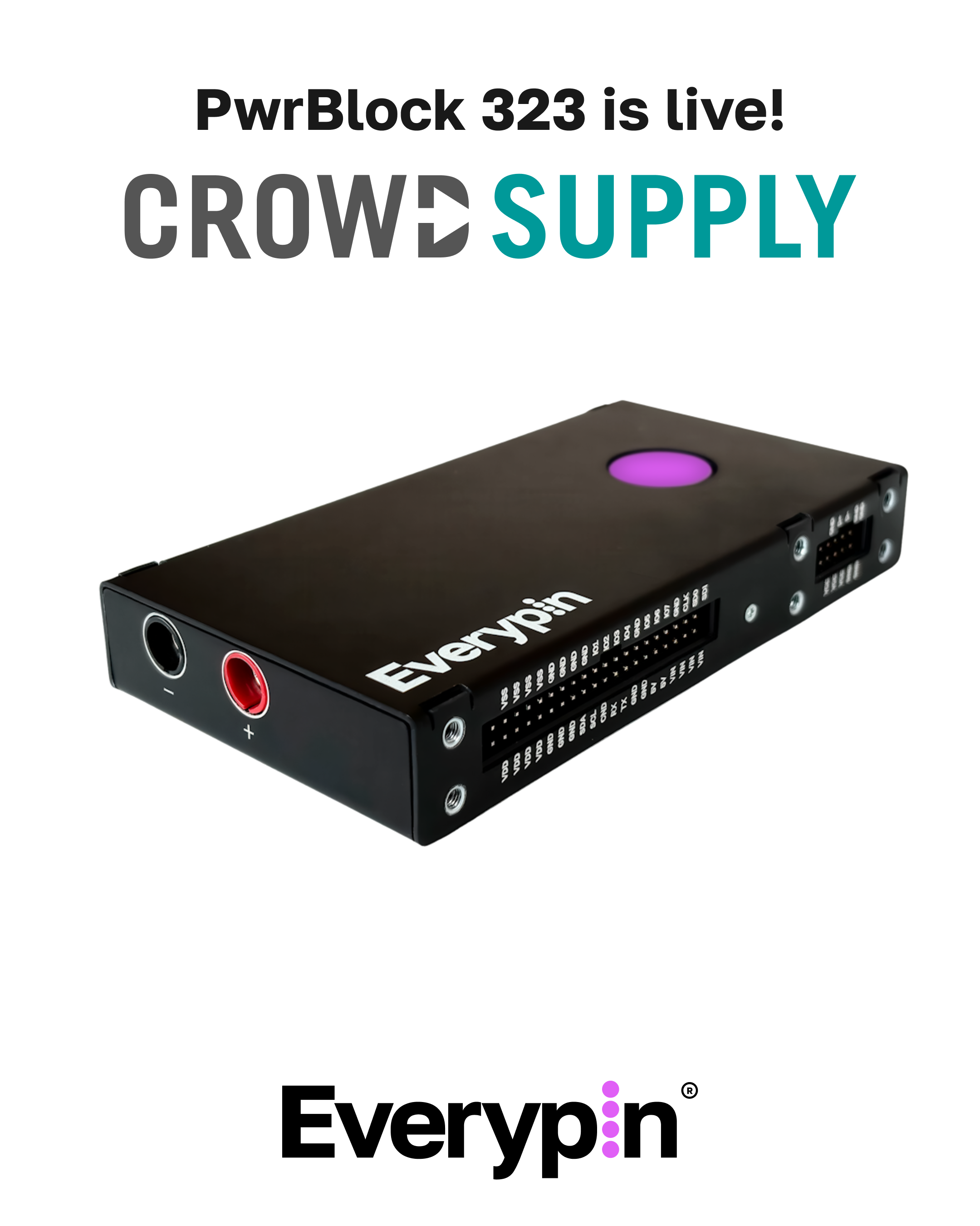

  • From Prototypes to Production: PwrBlock 323 is Live on Crowd Supply
    Ioan Larionov08/18/2026 at 12:29 0 comments
    A few months ago, we shared the first real hardware results from PwrBlock 323.
    Since then, we’ve continued testing the power stage, measurement and control functions, working on firmware and SCPI control, and refining the design for production.
    Today, we’ve reached the next milestone:
    PwrBlock 323 is now live on Crowd Supply.
    PwrBlock 323 started from a simple problem we kept running into while building automated test fixtures: powering the DUT is often much less automated than the rest of the test stand.
    A bench power supply works, but it sits outside the fixture and is easy to reconfigure accidentally. Generic DC-DC modules are compact, but usually lack a stable software interface, measurement, protection, and long-term availability.
    So we built PwrBlock to become part of the test system itself.
    The current design provides:
    • 1–32 V programmable output
    • Up to 3 A output current
    • USB-C PD power input
    • SCPI control
    • Python-friendly host tooling
    • Voltage and current measurement
    • OVP, OCP, OPP, and OTP protection
    • Banana outputs for bench work
    • Pin headers, UART, SPI, I²C, and digital I/O for fixture integration
    The idea is that a test script can configure DUT power, enable or disable the output, monitor voltage and current, and power-cycle the DUT without any manual interaction.
    That makes PwrBlock useful not only as a compact programmable supply, but as a building block inside production jigs, HIL systems, automated lab setups, and field-debug rigs.
    What happens next
    The core power, measurement, and control functions are already running on working prototypes.
    The Crowd Supply campaign is the next step toward finalizing the production design and manufacturing the first batch.
    We’re also building PwrBlock as an open platform. We plan to publish the hardware design files, firmware, mechanical files, and host-side software so it can be understood, integrated, repaired, and adapted instead of becoming another black box inside a test fixture.
    Every production unit will be calibrated and tested by Everypin in Finland before shipment.
    During the campaign, we’ll keep posting technical updates here: hardware tests, SCPI and Python examples, design decisions, manufacturing progress, and probably a few things that don’t work on the first try.
    If programmable DUT power is something you need in your own test setup, take a look at the campaign:
    https://www.crowdsupply.com/everypin/pwrblock-323
    And if you know someone building automated hardware test fixtures, please send it their way.
