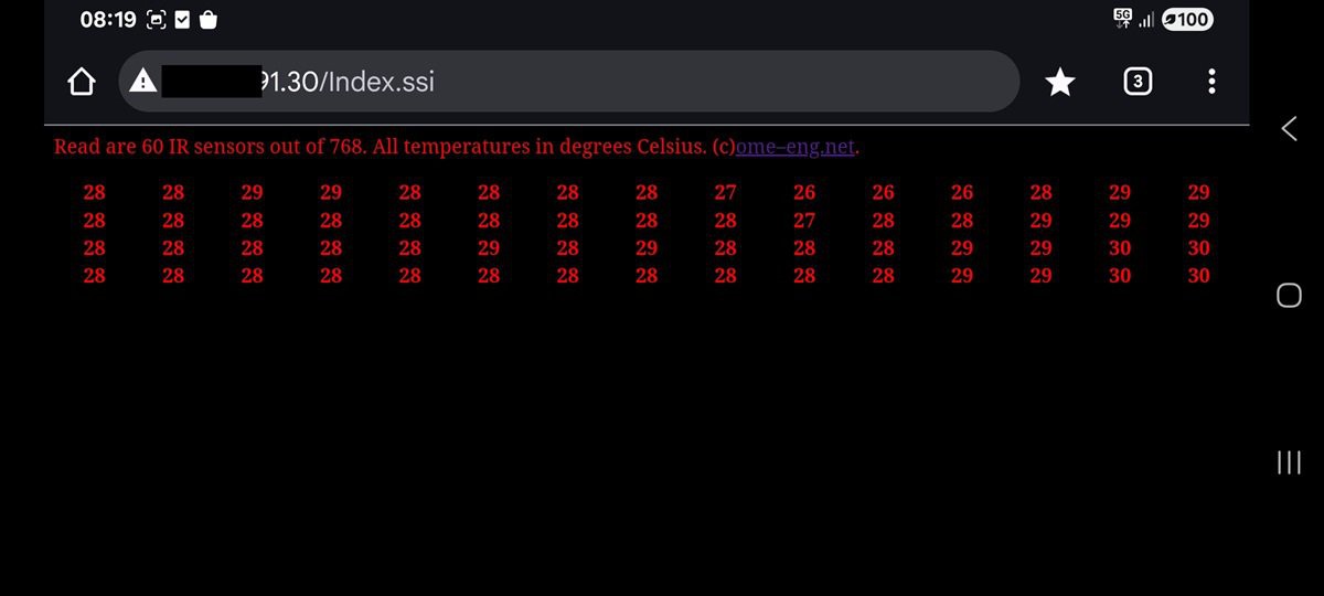

Example implementation where 60 sensors are read and displayed (15 pixels in 4 rows from left to right):

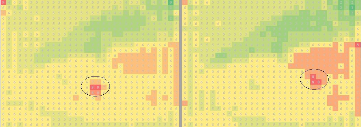

Implementation when all 768 pixels are read and data is visualized (moving object in 5m distance in an outdoors area), see also project log:
Note: for a simple burglar detection however, all of this may not be necessary and setting off an alarm may be sufficient.
