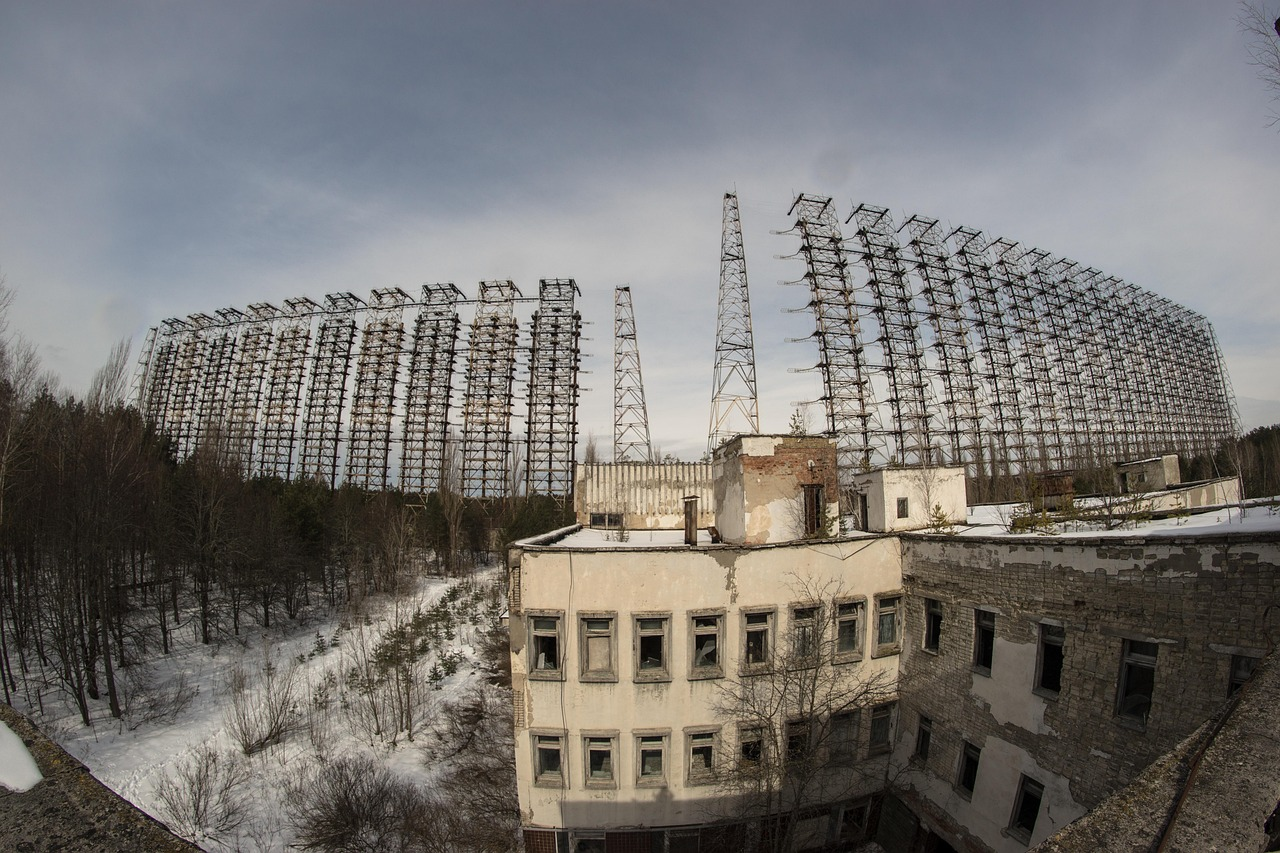

The Inspiration: Duga and the mysterious K340A
I recently stumbled upon some urban exploration photos from the Duga radar site near Chernobyl and an excellent documentary video : (www.youtube.com/watch?v=kHiCHRB-RlA&t=605s).
This gigantic over-the-horizon radar, made of hundreds of antennas, is famous for its distinctive shortwave noise — the “Russian Woodpecker” — that annoyed ham radio operators in the ‘70s and ‘80s.
Among the pictures, one can still spot a massive computer left inside the abandoned building: the K340A.
Not your average 1970s computer.
Back then, the USSR was lagging behind in microelectronics. To process the data streams from such a large radar, engineers had to invent clever architectures. The K340A used a very peculiar number system: the Residue Number System (RNS).

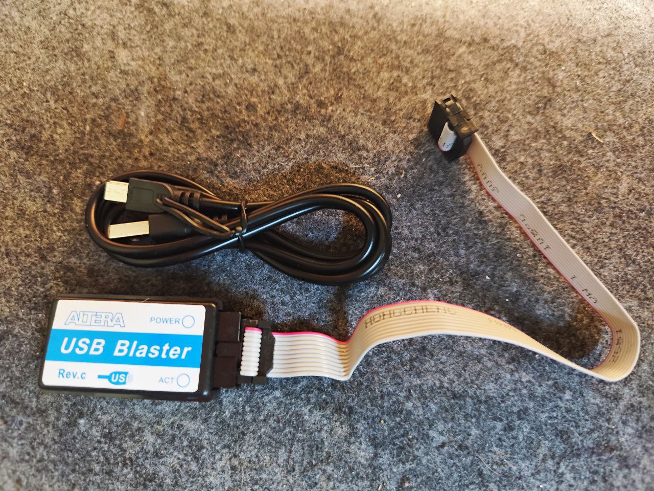

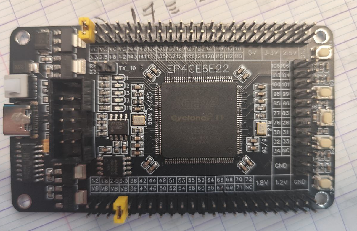

  • USB BLASTER V2 OK
    Bertrand Selva11/15/2025 at 19:27 0 comments
    I had bought a USB Blaster on AliExpress for 2€.
    If it had worked, it would have been great…
    I tried it with Quartus 13 and Quartus 22. Nothing worked: it just wouldn’t function.
    So I bought a Waveshare Electronics USB Blaster V2, and this time my FPGA was detected immediately and everything worked on the first try with Quartus 22.
    I paid around thirty euros for this version, but it actually works perfecty !
    The EP4CE6E22 Cyclone IV was detected at the fisrt try....
    At the same time, if I’d bought the 10-wire ribbon cable on its own, it would have cost me more than 2€. I don’t have the motivation to open it up and see what’s inside. But it’s definitely better to go for another model…

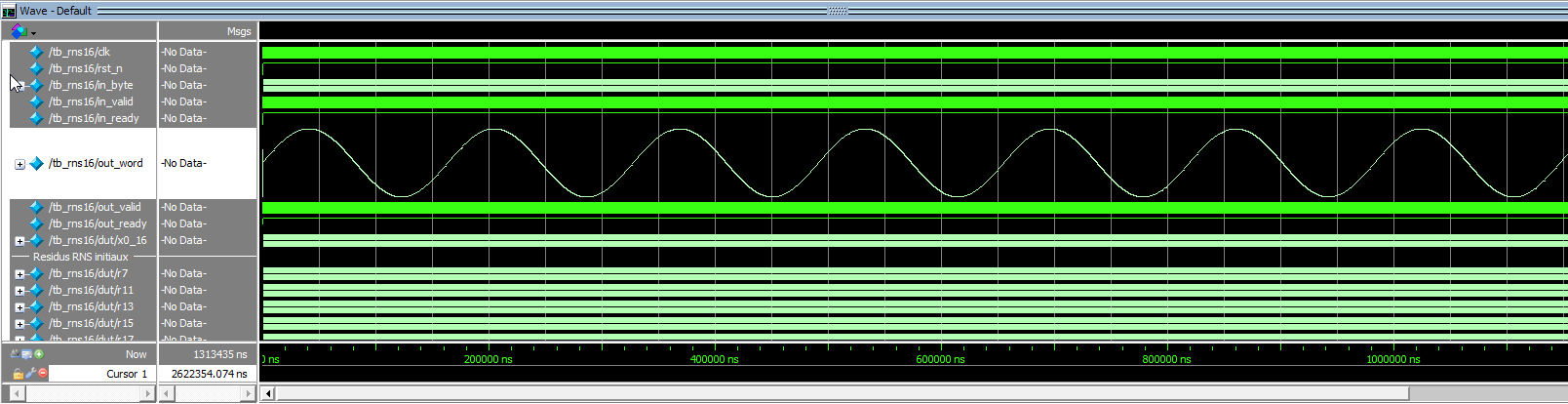

  • 64 TAPS RNS FIR
    Bertrand Selva11/10/2025 at 16:34 0 comments
    I’ve uploaded the new version of the RNS-based FIR filter, now extended to 64 TAPS (see PROGRAMME16BITS_FIRCOMPLET64TAPS.zip in project files) .
    Everything is OK !

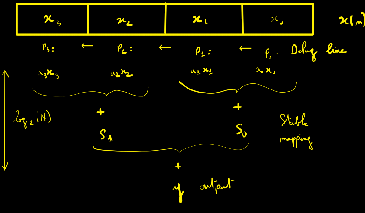

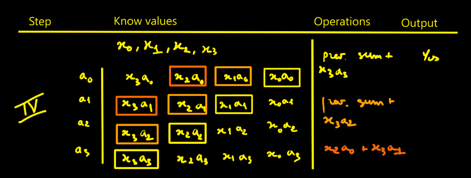

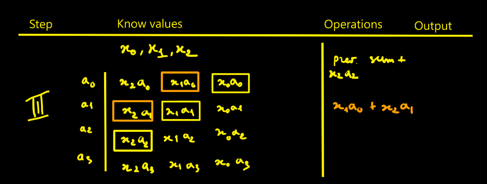

    Minimal FIR: Validating the Pipeline
    Since I had to abandon the initially targeted filter, and in order to simplify debugging and verification, I implemented a symmetric 4-tap FIR with coefficients (1, 3, 3, 1), without exploiting symmetry internally. The goal was to preserve a general architecture that can be reused for non-symmetric filters if needed.
    In this configuration:
    • Around 2,800 logic elements are used

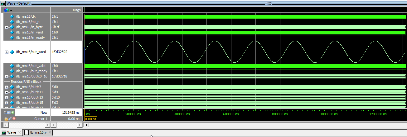

    • No embedded RAM, no DSP blocks, no conventional multipliers
    Simulation becomes manageable again: each pipeline stage is easier to track, and debugging is more straightforward. This makes it a useful intermediate step before moving back to longer filters. The code is provided in a ZIP file attached to the project files.
    The design works. The maximum achievable frequency is about 100 MHz.
    To validate the behavior, I injected a harmonic input over 8,192 samples, covering the full dynamic range.
    The filter output matches the expected response, confirming that the FIR operates correctly in RNS, using only pure logic (including the full pipeline: the FIR itself plus the two correction stages).

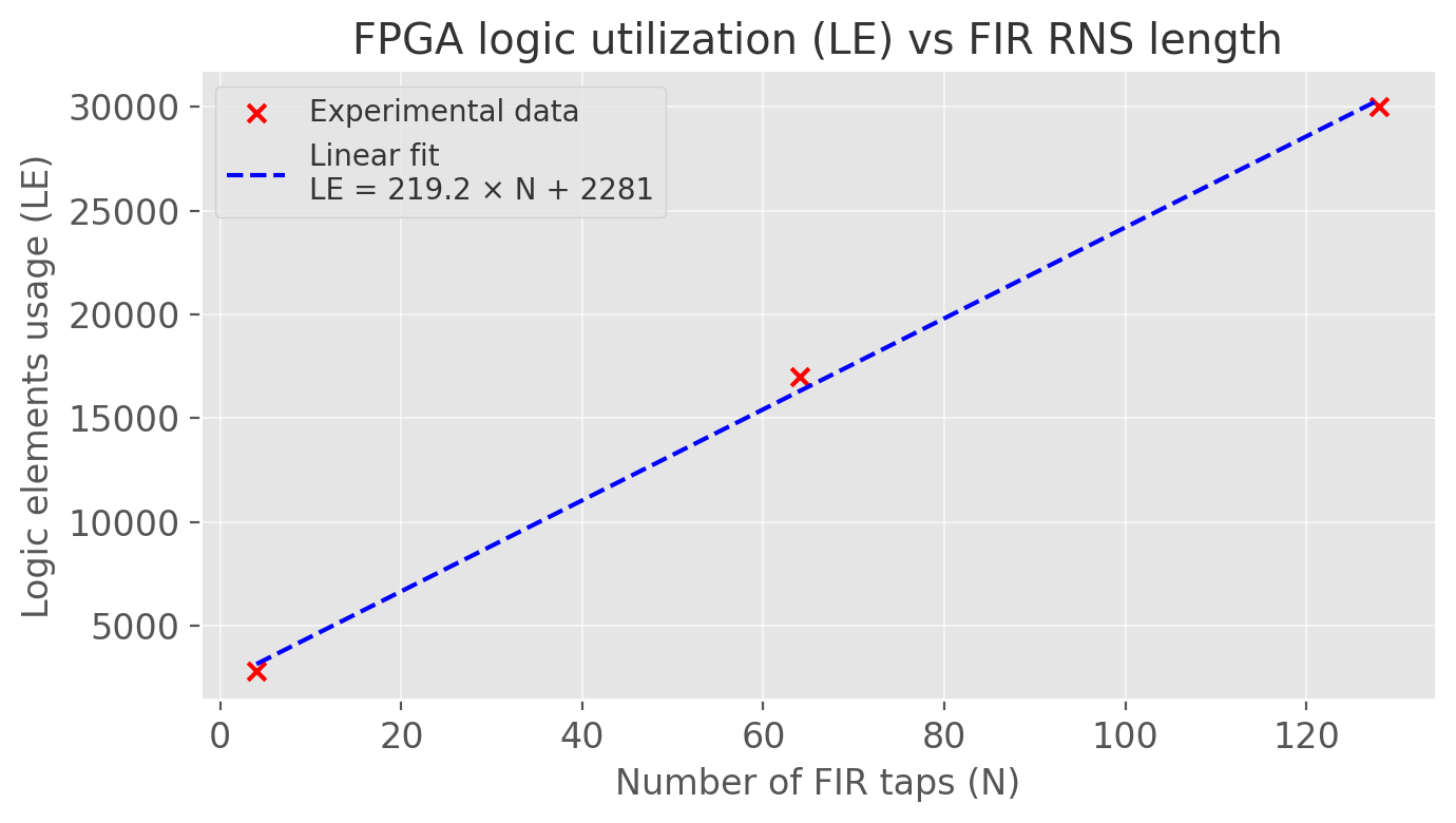

    These results show that it is possible to implement an RNS FIR on a standard FPGA with 0 RAM and 0 DSP usage. The following figure shows the (approximately linear) relationship between FIR length and logic element usage.
    From the measured points, the logic usage scales approximately as:
    LE≈220×N+2200
    (there is likely room for improvement with a more optimized implementation, but this gives the correct order of magnitude).
    For a symmetric FIR, a reasonable target is about:
    LE≈110×N

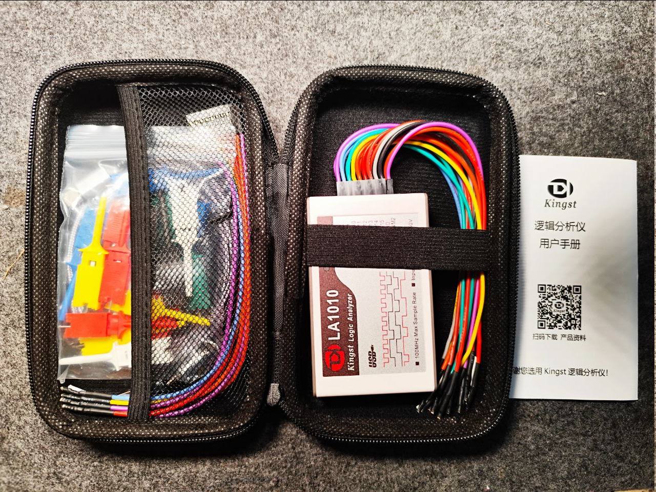

  • Received the 16-channel logic analyzer
    Bertrand Selva10/23/2025 at 13:57 0 comments
    Another small step forward in the project: I’ve (quickly) received my 16-channel logic analyzer! The package and the box look nice.
    It will allow me to observe the behavior at the FPGA pipeline output and check the signal synchronization.
    No more hardware excuses for not moving forward…
  • Reflections on FIR Filter Architecture
    Bertrand Selva10/18/2025 at 14:53 0 comments
    I thought designing the FIR filter would be simpler -  in fact it isn’t that straightforward. To picture how data flows through the filter, I drew tables showing successive cycles with the propagation of values and the operations done at each step. The filter parameters are noted ai. The data to process are xi. Here we choose N = 4 for illustration.
    I started with a direct approach, the way you’d do it on an MCU. You’ll see it’s probably not the right method here.
    Per modulus mi, the FIR is:
    yi[n] = ( Σk=0…N−1 hi[k] · xi[n−k] ) mod mi, for all i in [1, p]
    Reconstruction by CRT:
    y[n] = CRT( y1[n], y2[n], …, yp[n] )
    To escape purely sequential thinking, it helps to reason in terms of a production line: separate “lines” manipulate data items, cycle after cycle, as in a factory.
    Moreover I count the operations and accumulations involved in an FIR with N taps and it easier to do with the following tables:
    • N−1 additions
    • N multiplications
    • N cycles of latency (here one “cycle” means the time to ingest one full sample into the FPGA. The input sample is 16-bit, the input bus is 8-bit, so it takes 2 clocks to advance one cycle.)
    • Looking at the step-5 table, we need to realize N + (N−1) + (N−2) + … + 1 = N(N+1)/2 intermediate products to fill the pipeline.
    • We need to keep N products
    • We also need to keep N−1 partial sums (accumulators)
    Step-by-step

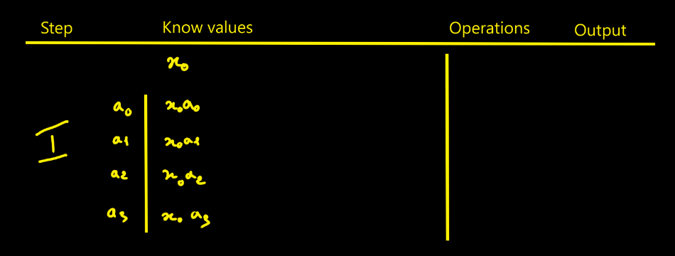

    FIR step 1 diagram
    Figure 1. With x0 ingested, compute the four products tied to the filter {a0, a1, a2, a3}.

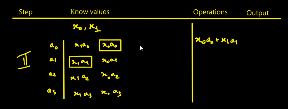

    FIR step 2 diagram
    Figure 2. When x1 arrives, compute its four products and start summing: x0a0 + x1a1.
    FIR step 3 diagram
    Figure 3. Ingest x2, add the new term x2a2 into the highlighted box. Start a new accumulator with x2a1 + x1a0. One more addition is still missing to complete a full convolution cycle.
    FIR step 4 diagram
    Figure 4. First full cycle completed: we can extract the first valid output.

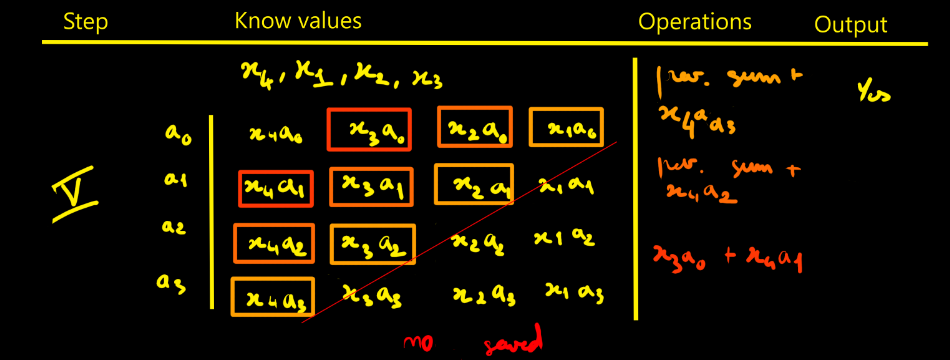

    FIR step 5 diagram
    Figure 5. Continue the process. Values like x1a1, x1a2, x1a3, x2a2, etc., are not kept. A red boundary in the step-5 table marks what must be stored vs. what can be discarded.
    This is the direct approach. Of course, you must replicate that whole pipeline for each modulus. With k moduli, you duplicate it k times — that’s exactly where RNS parallelism comes from.

    Parallel direct form (fully parallel direct FIR)
    If one wants a “hard” (stationary) pipeline, the solution is to let the samples slide through a delay line:
    X₃ ← X₂ ← X₁ ← X₀ ← x[n].
    The multipliers always see the correct positions (x[n], x[n−1], x[n−2], …): no more dynamic addressing.
    That’s much better — but there’s still a hard point:
    • the reduction of N products (modular addition tree) must itself be pipelined;
    • otherwise, the final addition becomes heavy and limits fmax.
    Pipelining this reduction introduces a few extra cycles of latency. In practice, if one addition combines two values, the reduction tree has log₂(N) stages. ...

    This marks one of the key milestones towards the final objective: a design that performs +2, but this time using all 9 moduli, allowing for a dynamic range of 237.
    Input data arrives via an 8-bit bus, in two cycles per word, while output data is mapped to 16 pins.
    You can find the program on my github : https://github.com/Bertrand-selvasystems/rns-pipeline-16bit

  • Receiving the USB Blaster
    Bertrand Selva10/14/2025 at 14:17 0 comments
    I just received the Altera USB Blaster, used to program the Cyclone IV FPGA.
    What it’s for:
    • JTAG interface between the PC and Intel/Altera FPGA or CPLD (Cyclone, MAX, etc.)
    • Programming of configuration files (.sof, .pof, .jic) via Quartus
    • Hardware debugging access (SignalTap, JTAG UART, boundary-scan)
    • Low-level memory read/write and diagnostic operations
    The real tests will begin soon. I’ll post a log once the first successful programming sequence is done.
