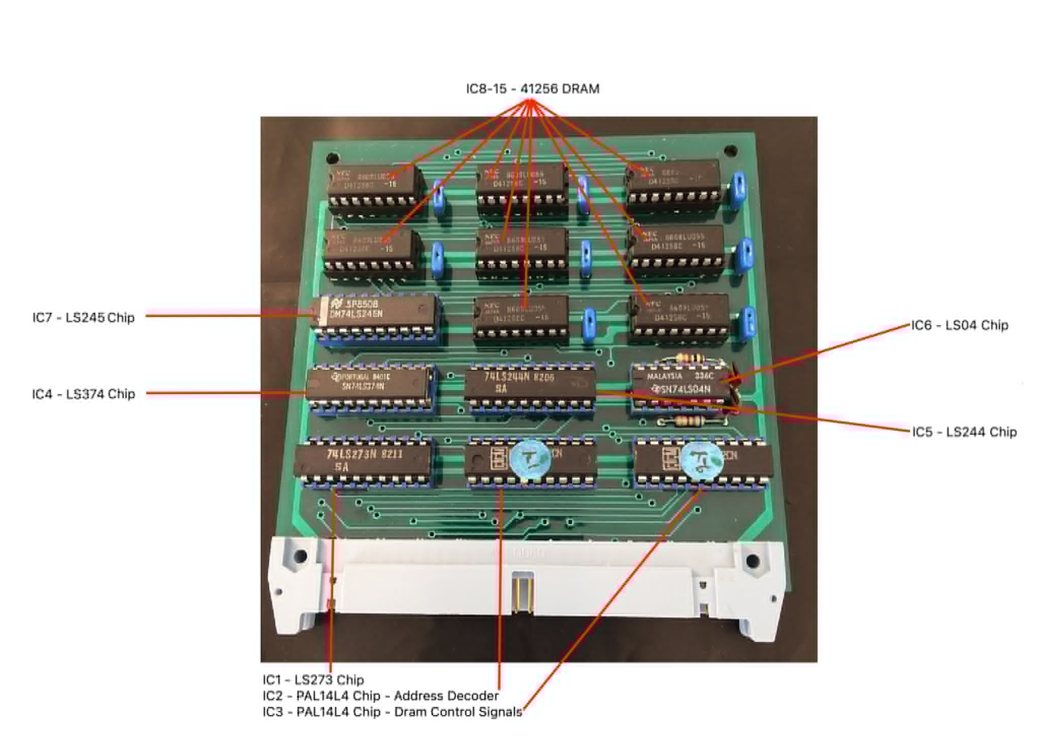

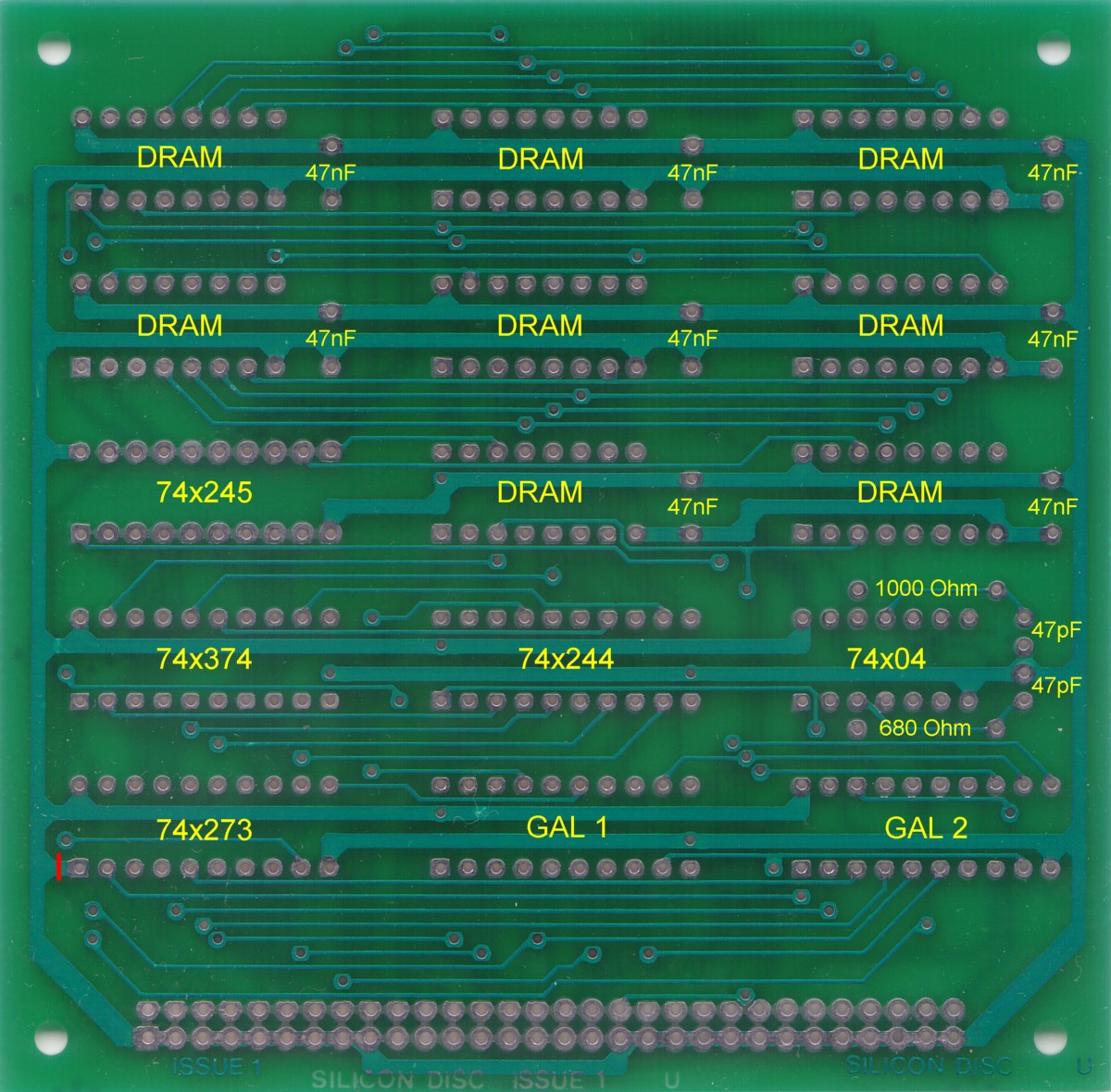

When you have a cramped 64K memory space, slow disks, and need to do disc-intensive work, then a RAM disk speeds things up a lot. This only had 256k, but that was four lots of memory space back then. Normal disks provided capacity, RAM disks provided speed. This project is about analysing the PAL14L4 chip equations to understand them, and see how they might upgraded it to at least 1.5 MByte, to hold a whole disc.
I have enough 41256 chips (24 off) to make six Silicon disks.
The design could be adapted to use 4-bit DRAM chips, or three 512K byte SRAM chips to emulate a whole 1.44 megabyte floppy disk. Perhaps with battery backup too.
It would be useful to have a RAM disc as big as a physical disk. The physical disks for the TC-01 were 3-inch, with a capacity of approximately 380 KB (usually formatted as 360K or 400K). This could be emulated by a single 512K RAM.
