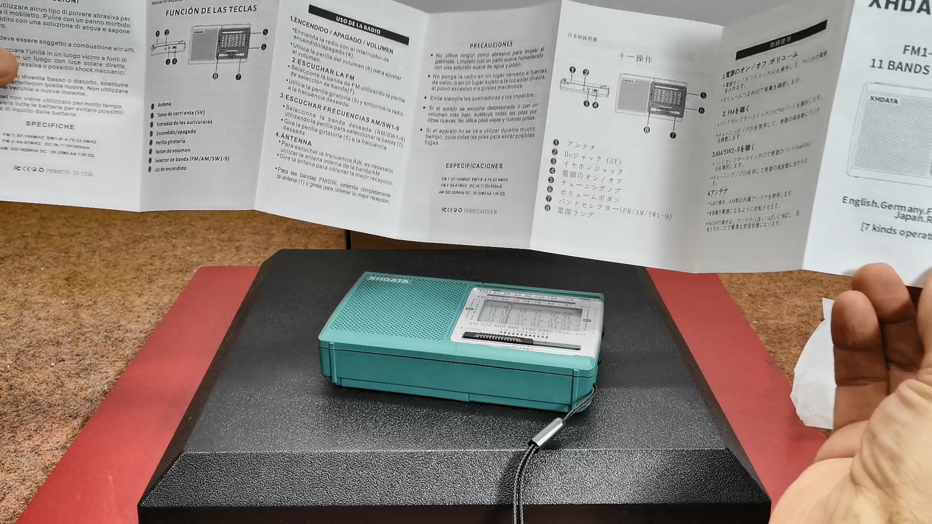

The box contains the radio and a user manual in multiple languages. This is a new limited edition of this model in matte colors specifically grayish white and malachite green like my sample. It is immediately noticeable that the radio, at least for now, is solidly made externally. On the front side there is a speaker, AM and FM scale, Power LED and Band switch.

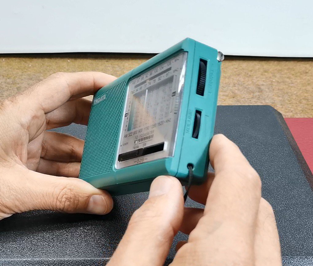

 Both scales are clear with precisely printed readable font. The switch has 12 positions for selecting Band and moves easily with an audible click at each new position. Two dials are placed on the side, one for tuning and the other smaller for volume control.

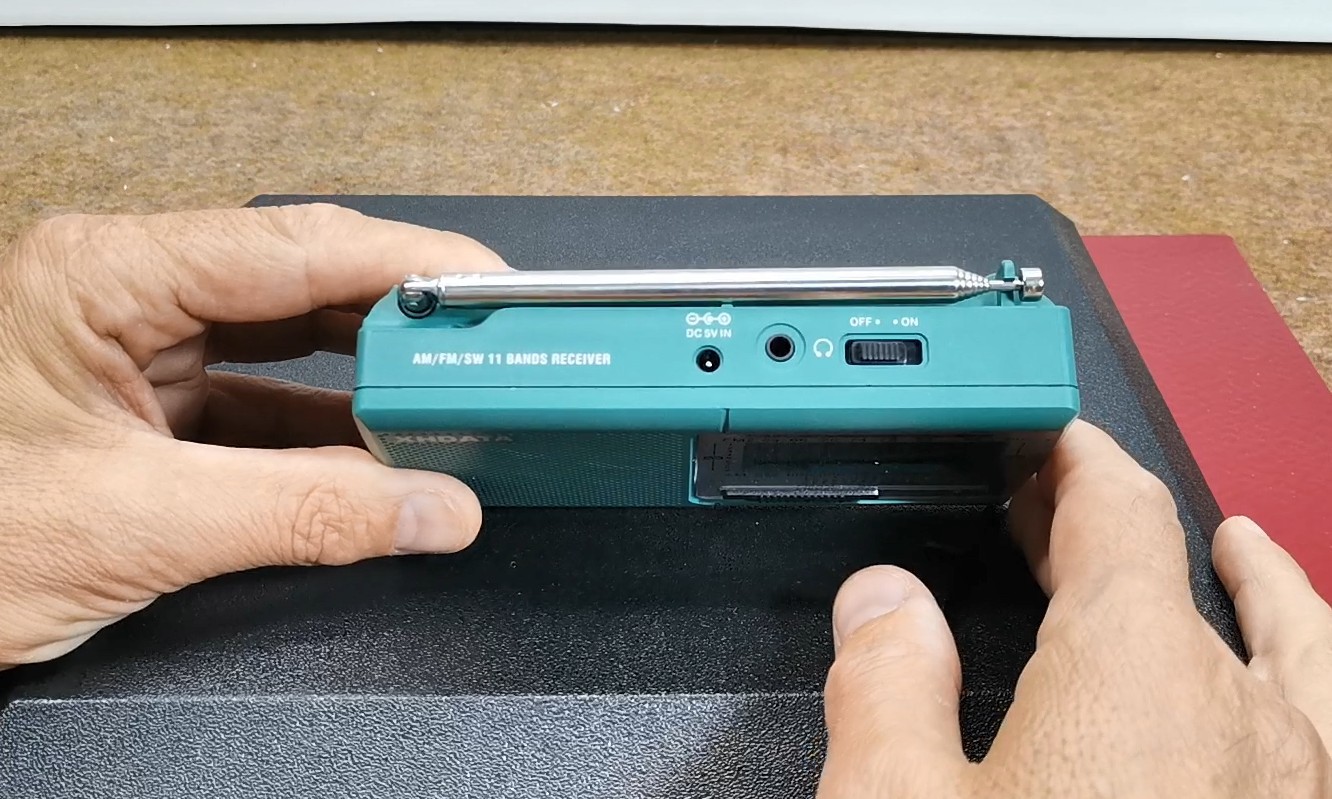

 On the top side there is an On-OFF switch, a headphone jack, as well as an external 5-volt power supply. Also on the side there is a large telescopic antenna with a length of 55 cm for better reception.

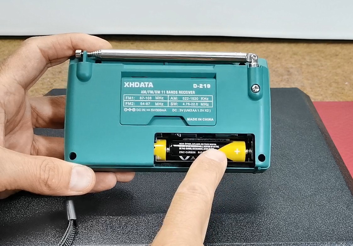

 On the back there is a bracket for support and a space for batteries. The device works with two 1.5 Volt AA batteries, and this is perhaps the only small complaint, because for a price slightly lower than the 20 dollars total this receiver costs, it could have contained a lithium battery.

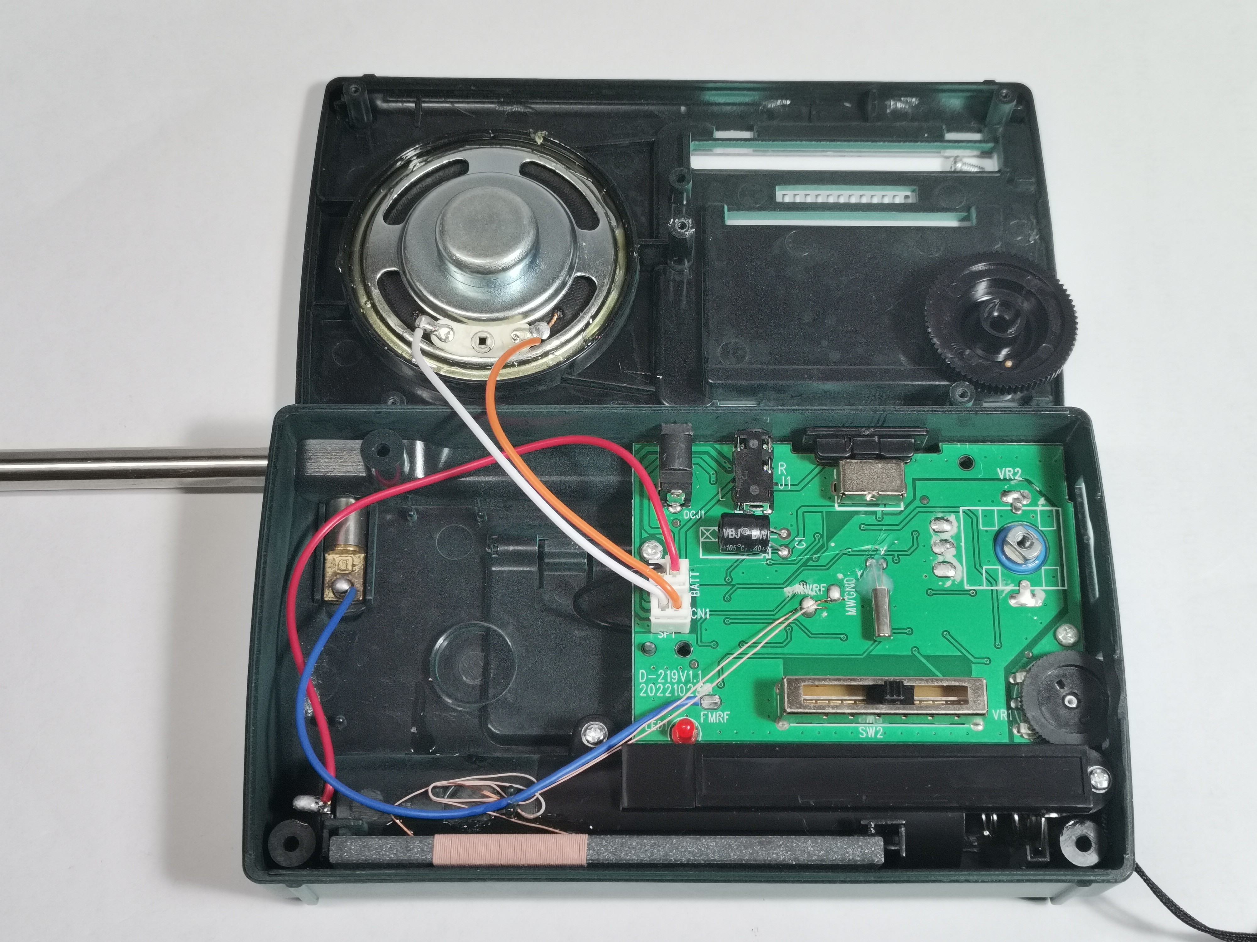

   Unlike the exterior, at least according to the advertisements, the interior contains a modern DSP chip.   To verify this claim, I decided to open it up and take a look at what the interior is made of.
After opening the lid, a large speaker with a diameter of 5cm immediately catches the eye, which is actually the reason for the clean, voluminous sound.
Here is the main PCB with speaker and a battery  connectors, then a large ferrite antenna for Medium Wave, potentiometers for selecting stations and volume, as well as switches. Let's see what is on the other side of the PCB.

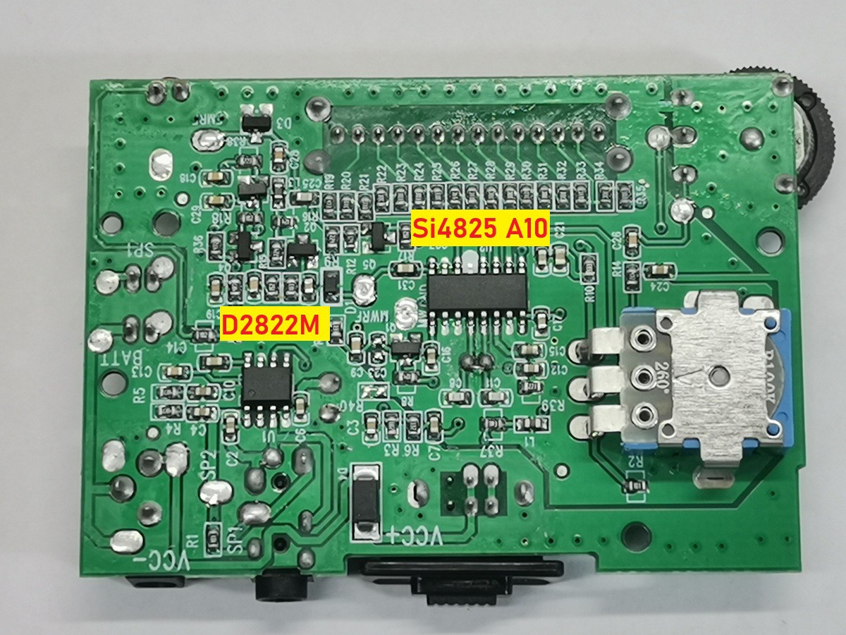

To get the PCB out I had to unsolder the antenna and the wires from the ferrite core coil. On the back of the PCB board are two SMD chips and the accompanying passive and active components. This is the well-known Si4825 A10 from Skyworks which is defined as a "broadcast mechanical tuning AM/FM/SW radio receiver". In one of my previous videos you can see how I made a radio receiver with this radio chip.
The smaller chip is the D2822M which is actually a Stereo audio amplifier, in this particular case connected in a mono bridge circuit for higher output power.
