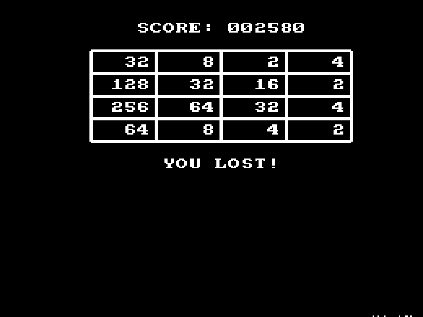

    Now it's time to explain the development details and the code organization. Here's the memory map of the Midway 8080 hardware:
    0000-1fff: 8K ROM
    2000-23ff: 1K RAM
    2400-3fff: 7K VRAM
    4000-: RAM Mirror
    Even that the system has 8K ROM, the Amazing Maze ROMs uses 4K ROM, so I'm limited to this amount. I'm using the RAM to store the variables, such as the score digits and the array grid.
    For the VRAM (video display), I implemented text video mode with a cursor and some basic font to draw on the screen. For 256 unique tilesets it'll consume 2048 bytes (256 * 8), which will be too much, so the strategy is to use few font tilesets. If I use only 64 unique tilesets it'll consume only 512 bytes (64 * 8), which will be sufficient for special glyphs.
    I'm organizing the code by using the assembler directives like defining the data segment and code segment, and using a macro to help loading the video address to the BC register.
    For the strings I'm using a custom encoding and the strings terminate with 0xff. I have a subroutine to print it passing the string address to HL register and cursor position to BC register.
    Remember the RET opcode on the 8086 assembly which you can optionally pass an immediate value to pop the bytes after returning to calling procedure? It's very useful to implement the Pascal-style calling convention which the callee (the subroutine) is responsible to clear the arguments of the stack.
    The problem is that the RET opcode on the 8080 assembly doesn't have that, so I have to use a different calling convention. The first parameter is stored on HL register, the second on BC register, and the third on DE register.
    After all the explanation, here's the drawing of the losing screen of the 2048 game on the system (I still need to implement the gameplay):

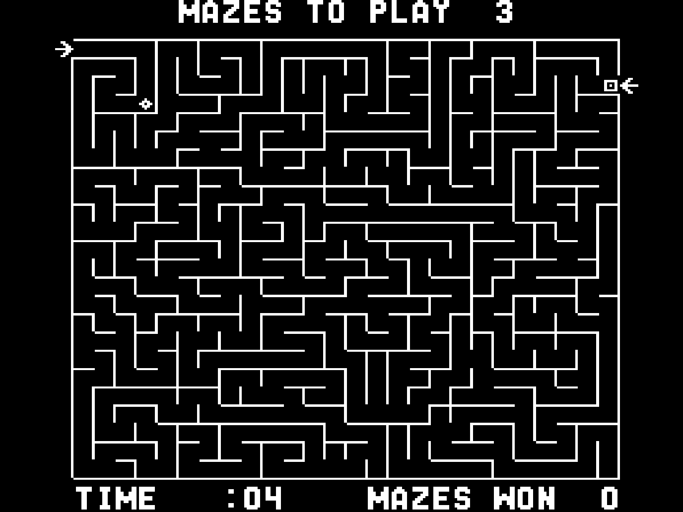

    Looking at the arcade specifications, the Midway 8080 system is a black & white arcade hardware, has a 260x224 display, and the first game made for the hardware was Gun Fight (and the first arcade game using a microprocessor instead of being discrete logic). But the hardware is better known as the one which powers Space Invaders, there are even tutorials about how to make a emulator for it.
    However Gun Fight and Space Invaders aren't the only arcade games on this system, other games listed are Boot Hill (a sequel to Gun Fight), Sea Wolf, Laguna Racer, Clowns, Amazing Maze, and others.
    Amazing Maze one player mode (second player controlled by computer)

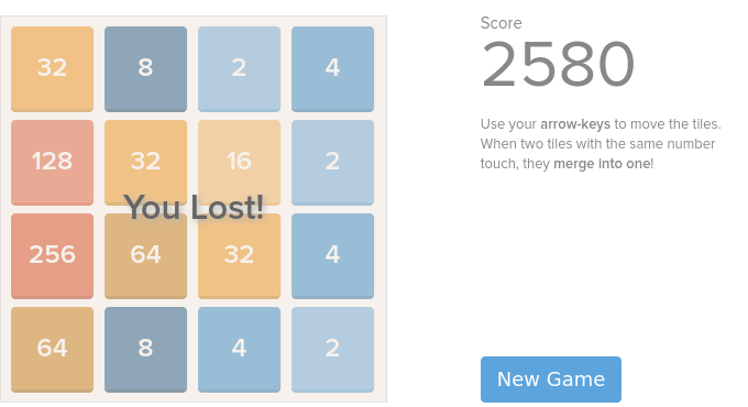

    Now for the explanation of the 2048 game, it's a sliding tile puzzle game created by Gabriele Cirulli in 2014, the objective of the game is to create a 2048 tile on a 4x4 grid, and the input is the arrow keys. It was hugely popular in that year, but nowadays isn't so popular anymore. Here is a image of the game in DuckDuckGo when you search for 2048 game:

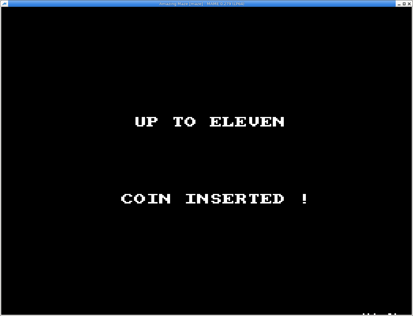

    For running the generated binary, first I assemble the code, split the binary into two 2048 bytes files, then I replace the Amazing Maze ROMs for the custom ROMs. MAME will complain about the checksums, but you can ignore it and run the new generated binary. I'm limited to 4K ROM size though, so I have to be careful to not exceed the size.
    For the moment I managed to draw the screen and read the coin input, for the next days I'll implement some sort of state machine to manage the insert a coin mode, the game itself, and maybe the attract mode.
    Testing the coin input action (it took a while to make it work)
