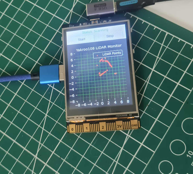

The project highlights:
Hardware integration: Connecting the YDLIDAR X2 to the Unihiker through USB.
Real-time visualization: Displaying LiDAR scan data on Unihiker’s touchscreen as a radar-like map.
Portability: A compact setup that does not require an external PC for monitoring.
Applications: Obstacle detection, indoor mapping, or educational demonstrations of LiDAR technology.
This setup provides a low-cost and interactive way to learn about LiDAR and data visualization using Python on embedded hardware.
Key Features
-360° real-time visualization
-Auto-scaled graph to fit the screen (320x480)
-Connection status display (Connected / Disconnected / Reconnecting)
-Start and Stop buttons to control scanning
-Filters out data that is too close (< 0.1 m) or beyond the max range (> 10 m) for a cleaner graph view
Key Code Components
-LidarX2("/dev/ttyUSB0"): Opens connection to the LiDAR via USB
-Matplotlib + Tkinter: Draws a scatter plot to display LiDAR points
Usage
1.Connect the YDLIDAR X2 to the Unihiker’s USB port
2.Run the code on the board
3.Press Start to begin scanning — blue points will appear, showing objects around you
4.Press Stop to stop scanning
