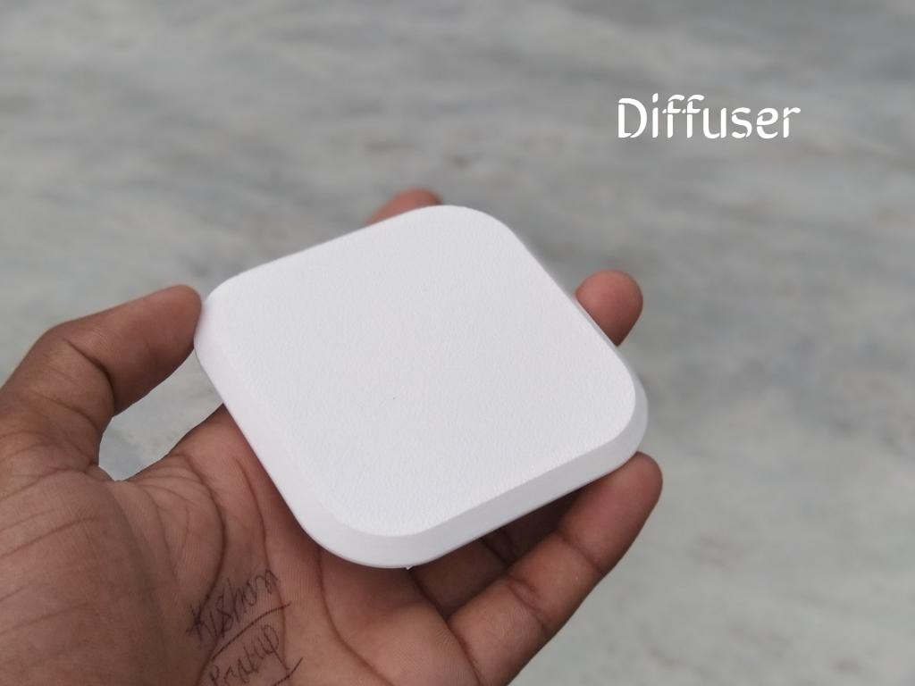

Pocket Glow offers three soothing light modes – Cool White, Warm White, and Natural White – using a clever combination of two 12V LED strips. With just one device, you can switch between a bright white for focus, a warm glow for comfort, or a natural tone for daily use.

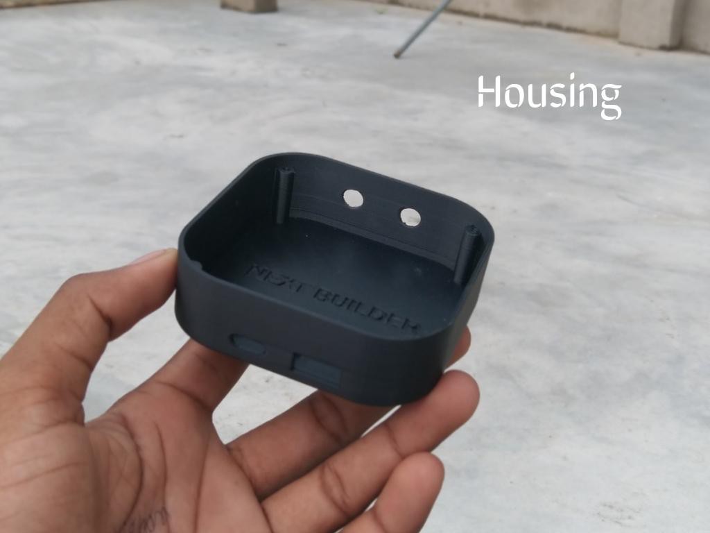

    CAD & 3D Printing
    To start this project, I designed the Pocket Glow CAD using Fusion 360. It’s a simple and compact design that’s easy to print and assemble. If you’d like to view or edit the model, you can open it directly in your browser using the Fusion 360 web viewer. Feel free to customize it however you like.
    For 3D Printing, You can directly download the required STL files below:
    1. Housing.stl
    2. Cover.stl
    3. Diffuser.stl

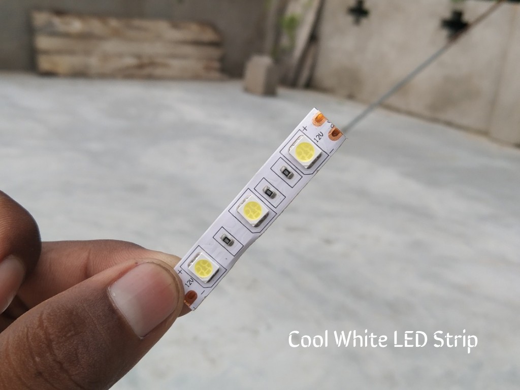

    Strip Light Assembly
    Begin by preparing the 3D-printed cover for the strip light installation. First, measure the length of the cover and cut both the cool white and warm white LED strips to the required size. Once the strips are ready, peel off the adhesive backing and carefully press them onto the cover. For a more balanced and natural lighting effect, I arranged the strips alternately—starting with cool white, then warm white, followed again by cool white and warm white. This alternating pattern helps create an even and pleasant color combination.

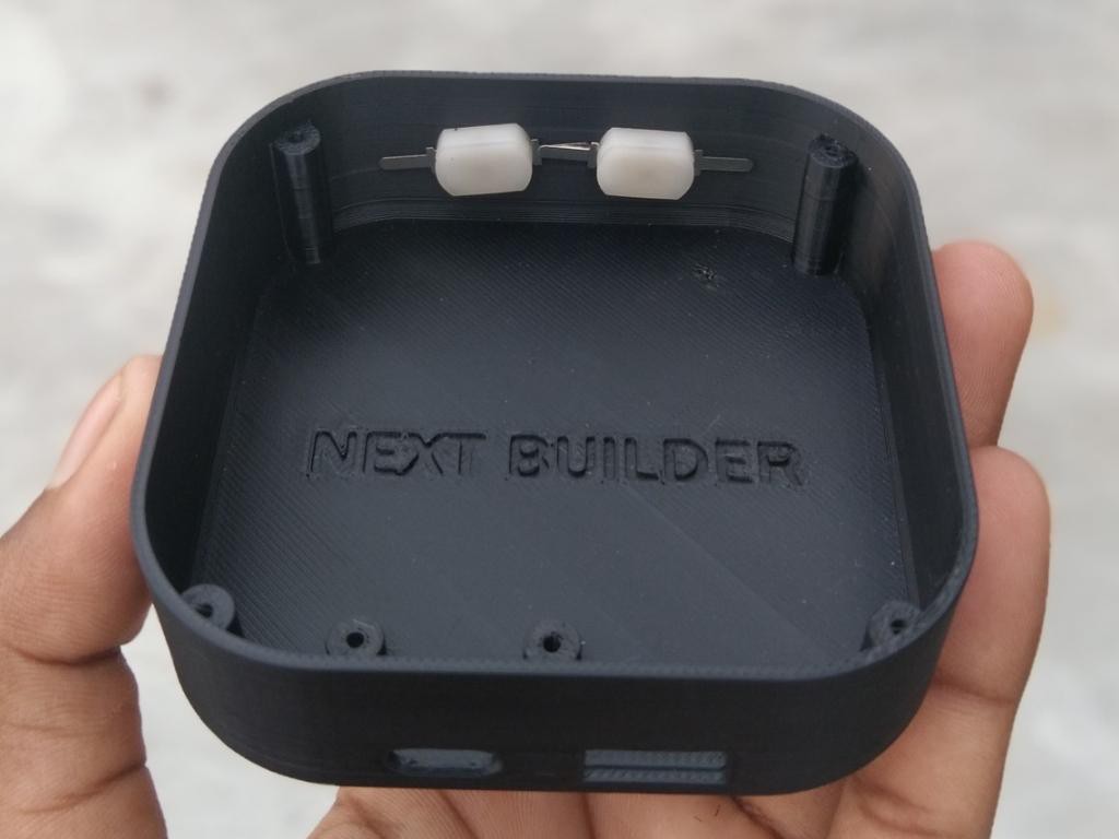

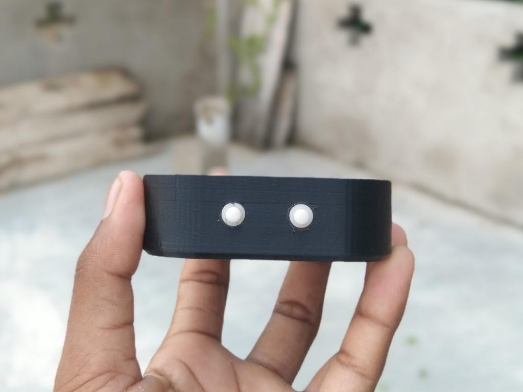

    Switch Assembly
    On the opposite side of the housing, you’ll notice two small holes designed for switches. I used two locking-type push switches here—one to control the cool white LED strip and the other to control the warm white LED strip. To assemble them, simply insert each switch into its slot and apply a very small amount of T-7000 glue to hold them in place. Be careful not to use too much glue, as excess adhesive could damage the switches or make them difficult to operate.
