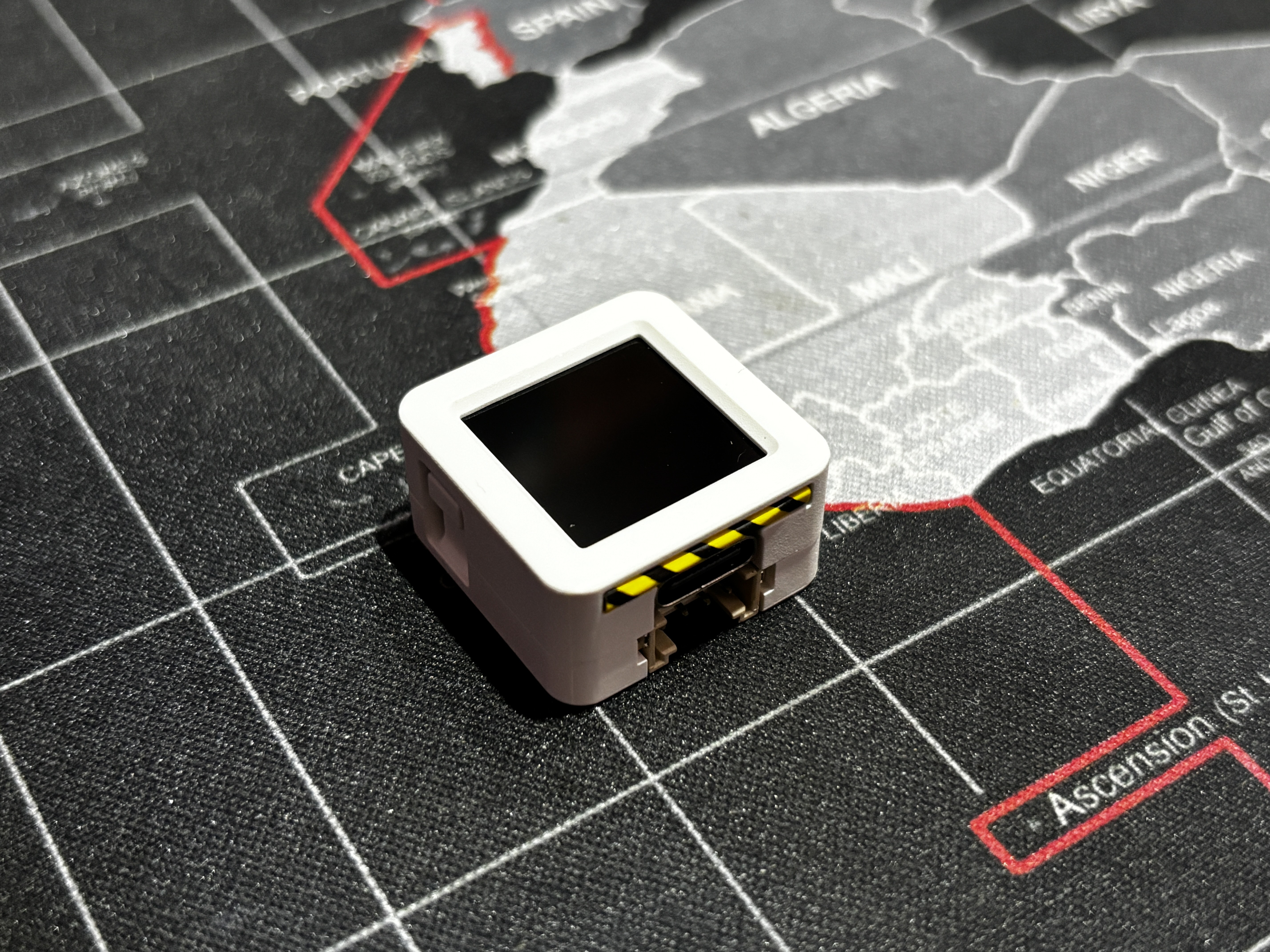

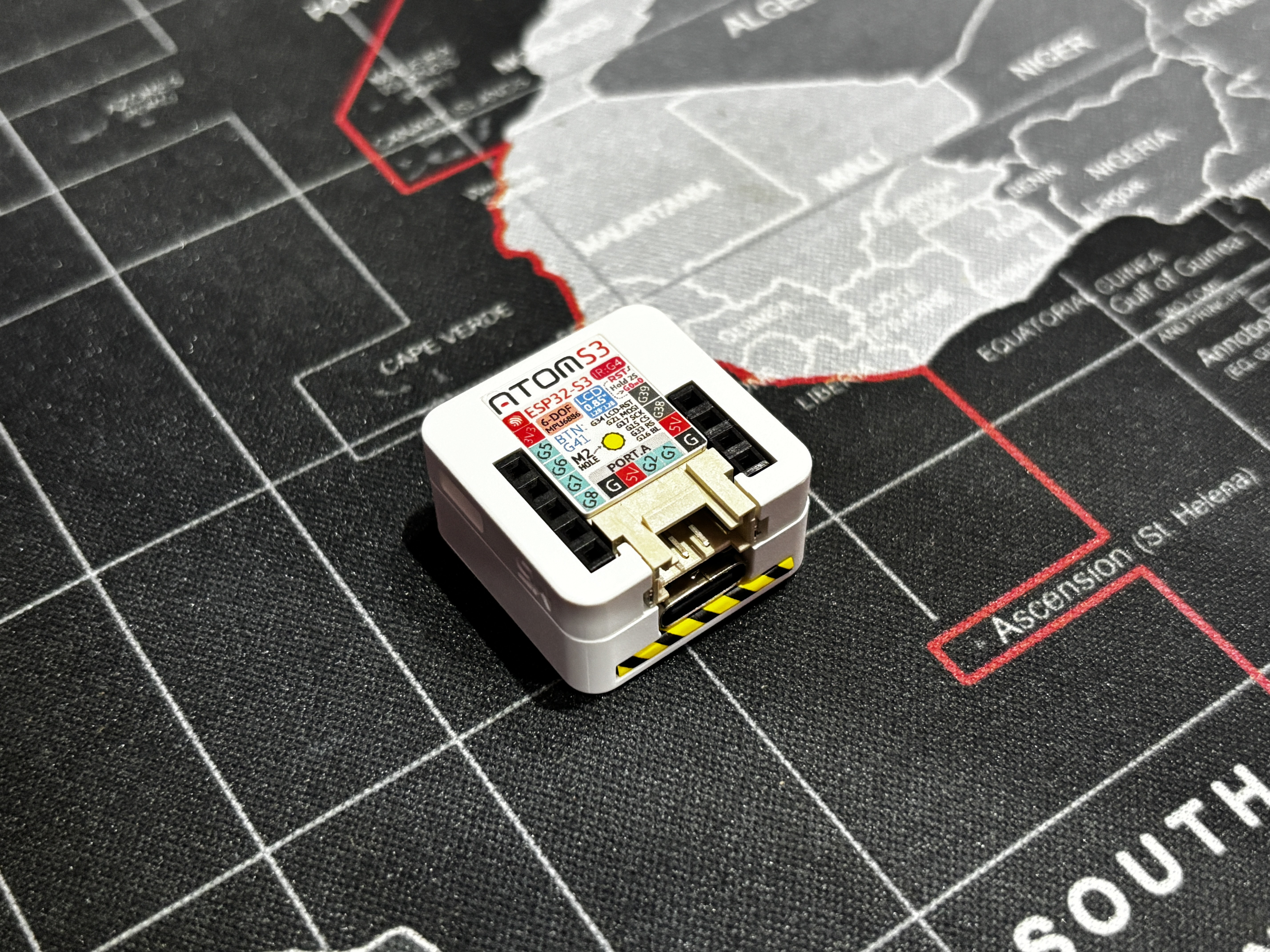

M5 STACK ATOM S3
At the heart of HitPad is the M5Stack AtomS3, a compact yet powerful development board built around the ESP32-S3 microcontroller. The ESP32-S3 features a dual-core Xtensa LX7 processor running at up to 240 MHz, with built-in support for Wi-Fi and Bluetooth 5.0, making it ideal for fast, responsive embedded applications.
Despite its tiny 24 × 24 mm footprint, the AtomS3 offers a rich set of features that make it perfect for compact DIY builds. It includes multiple GPIO pins, a programmable RGB LED, a USB-C port for power and programming, and a Grove connector for easy expansion. The board also supports low-power operation, which is useful for portable or battery-powered devices.

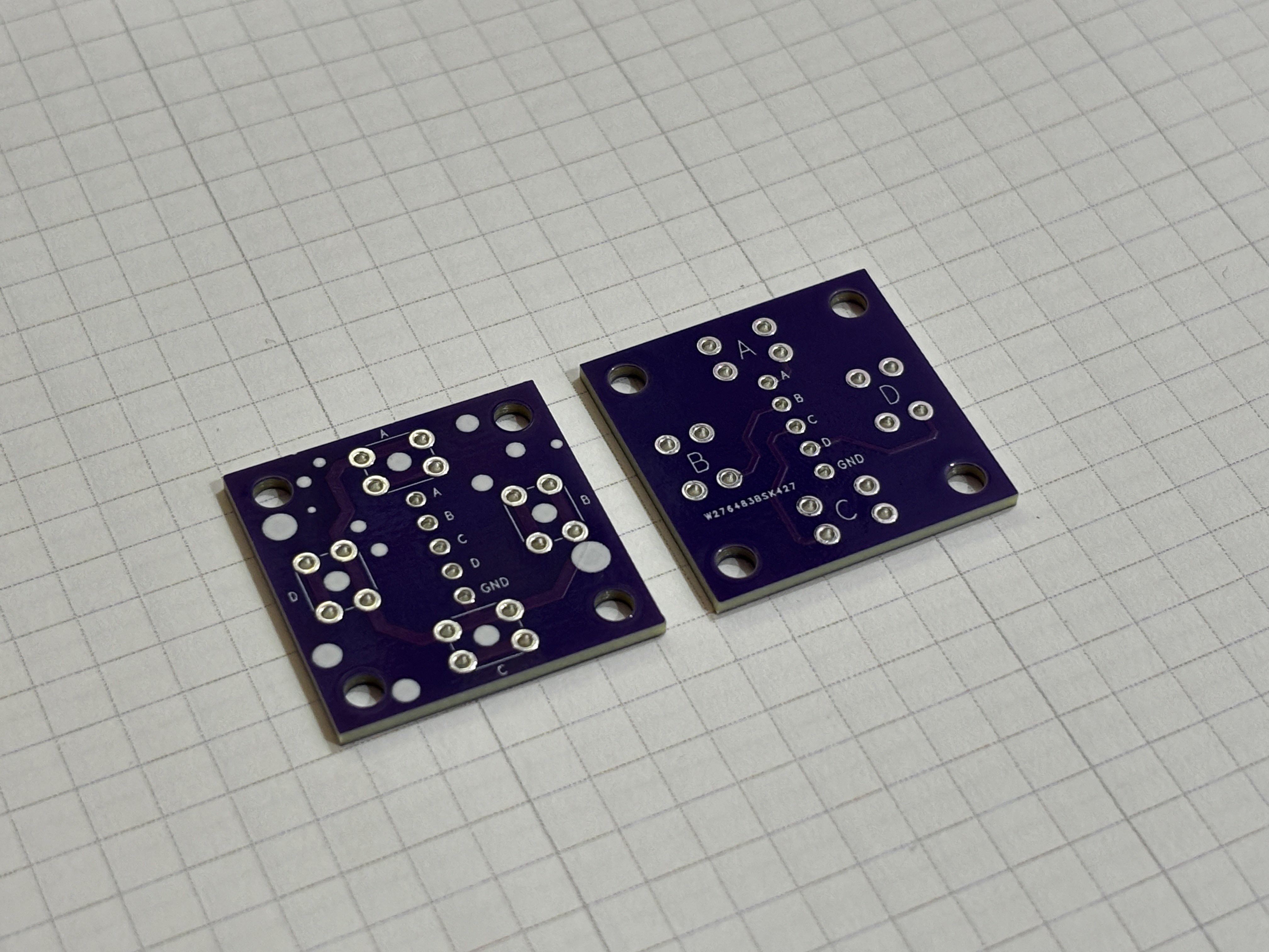

CUSTOM SWITCH PCB
The circuit design for this project was fairly straightforward. The goal was to create a switch PCB featuring four 4×4 tactile push buttons. We began by adding the buttons to the schematic and connecting all four of their pins together, forming a common ground. To simplify wiring, we introduced a CON5 connector, where all button pin 1 terminals were linked along with the shared ground connection.
For the PCB layout, we used the enclosure’s CAD model to define the board outline. The push buttons were placed in their designated positions, and traces were routed from each switch to the CON5 port.
Once the pcb layout was complete, we added custom graphics to the silkscreen layer to enhance the visual appeal of the board and give it a more polished, finished look
PCBWAY SERVICE
Once the board design was finalized, I opted for a purple solder mask with white silkscreen and uploaded the Gerber files to PCBWay’s quote page for fabrication.
While I typically go with a white or black solder mask for most of my builds, this time I decided to try out PCBWay’s Purple option just for a change. The order was placed smoothly, and the PCBs arrived within a week.
The quality was excellent—clean finish, sharp silkscreen, and everything matched the design perfectly.

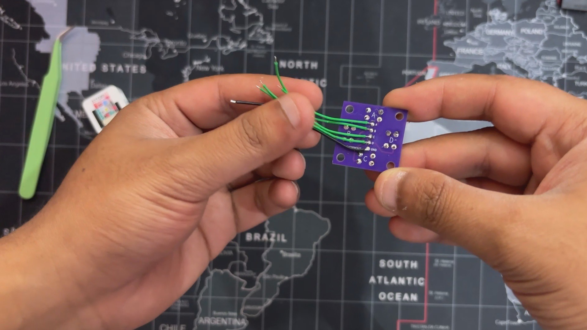

    SWITCH PCB ASSEMBLY
    • The switch PCB assembly process starts by placing all the 4x4 through-hole push buttons in their place, then flipping the board over, and then using a soldering iron to secure all components by soldering their pads.
    • Next, we added five connecting wires with the CON5 terminal on the backside of the Switch PCB.

    WIRING PROCESS
    • We began the wiring process by adding a CON4 header to the back of the M5Stack AtomS3’s pin header. This connector serves as the interface between the switch PCB and the Atom module.
    • Each of the four push button outputs—A, B, C, and D—was carefully soldered to G5, G6, G7, and G8 on the Atom, respectively. The ground pin from the switch PCB was then connected to the GND pin of the Atom to complete the input circuit.
    • Next, we wired the speaker, connecting its positive lead to G2 and its negative lead to GND, enabling PWM-based audio output.
    • Finally, we connected the lithium cell, which powers the entire device. The positive terminal of the battery was soldered to the 5V pin on the Atom, while the negative terminal was connected to GND, completing the power circuit and making the device fully portable.
