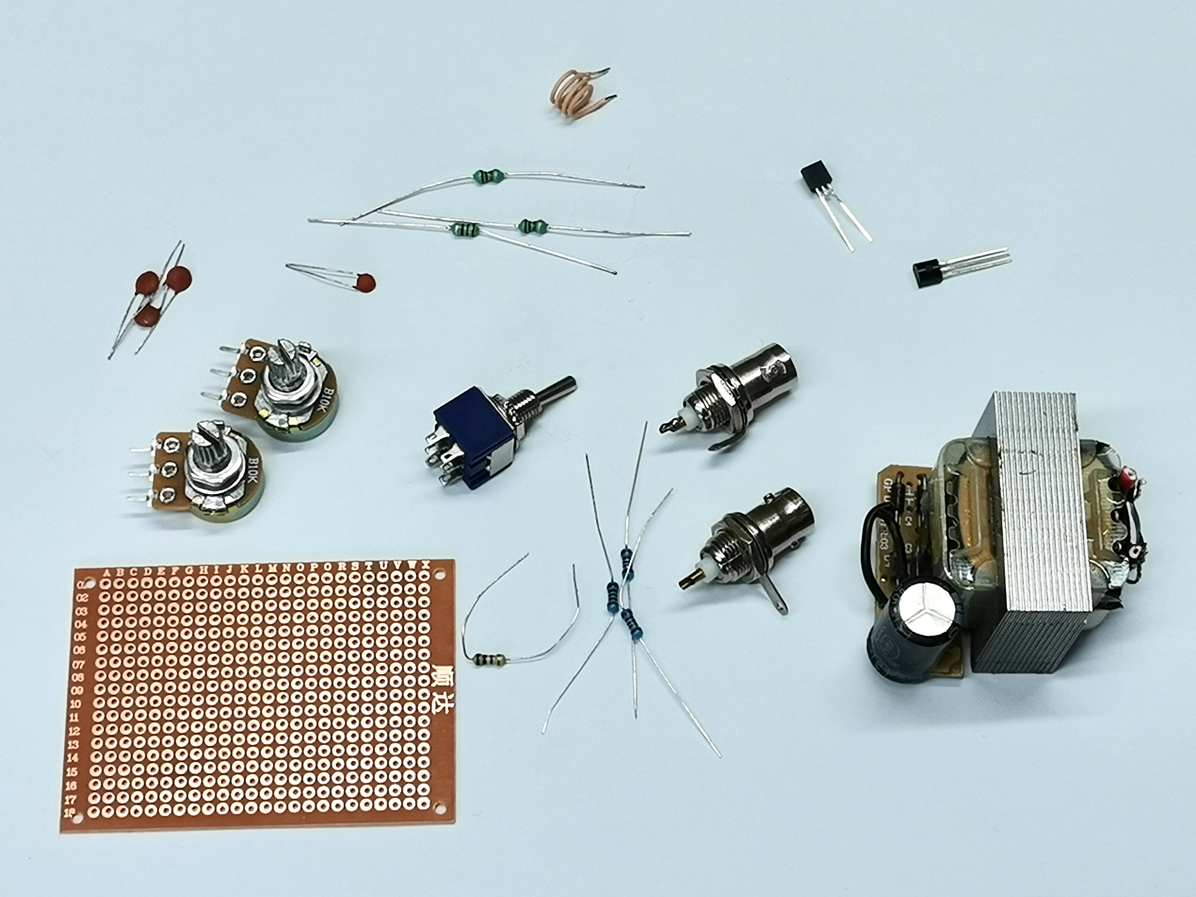

   The device is very simple to make and consists of several components:
     - Transformer with rectifier that provides DC voltage with a value of 10 to 12V (you can also use standard 9V Battery)
     - j310 mosfet
     - bb112 varicap diode
     - 10Kilohm potentiometer
     - and several passive elements, resistors, capacitors and inductors

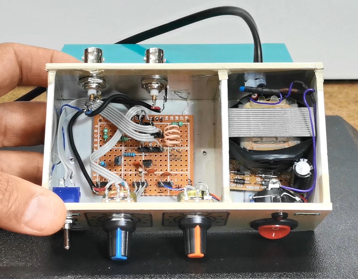

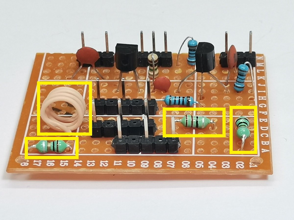

   As seen, circuit is simple and cheap to build and you do not need any inductors winding skills, as it uses molded chokes. We need to place the molded chokes in relative positions that are perpendicular to each other, or far away from each other, so as to avoid unwanted coupling between them.
  The tuner has only 2 ranges that cover the entire HF band. The potentiometer changes the voltage applied to the varicap diode and thus its capacitance, and in conjunction with the appropriate group of inductances we obtain the required range. At the input there is another potentiometer with which the RF gain is regulated. The inductor with a value of 100 Nanohenry is hard to find, so I made it with 4 turns of insulated wire on a body with a diameter of 7mm.

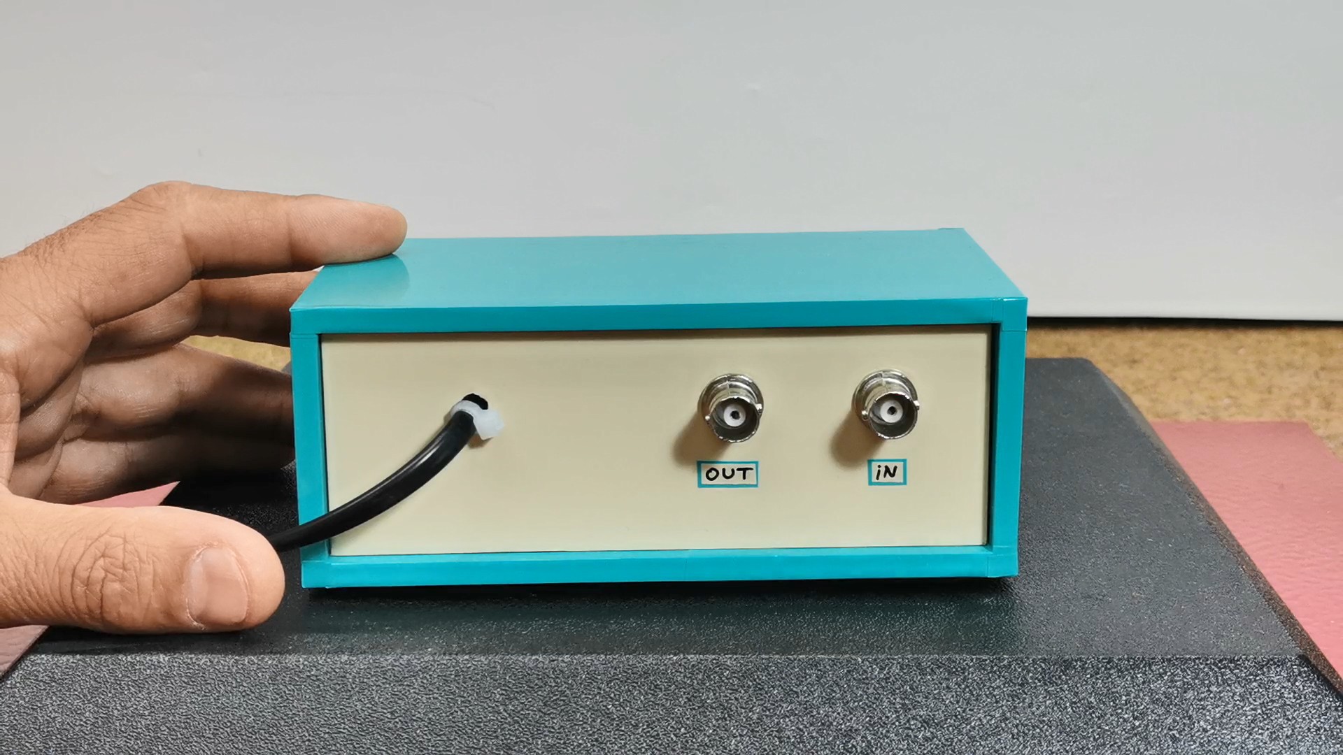

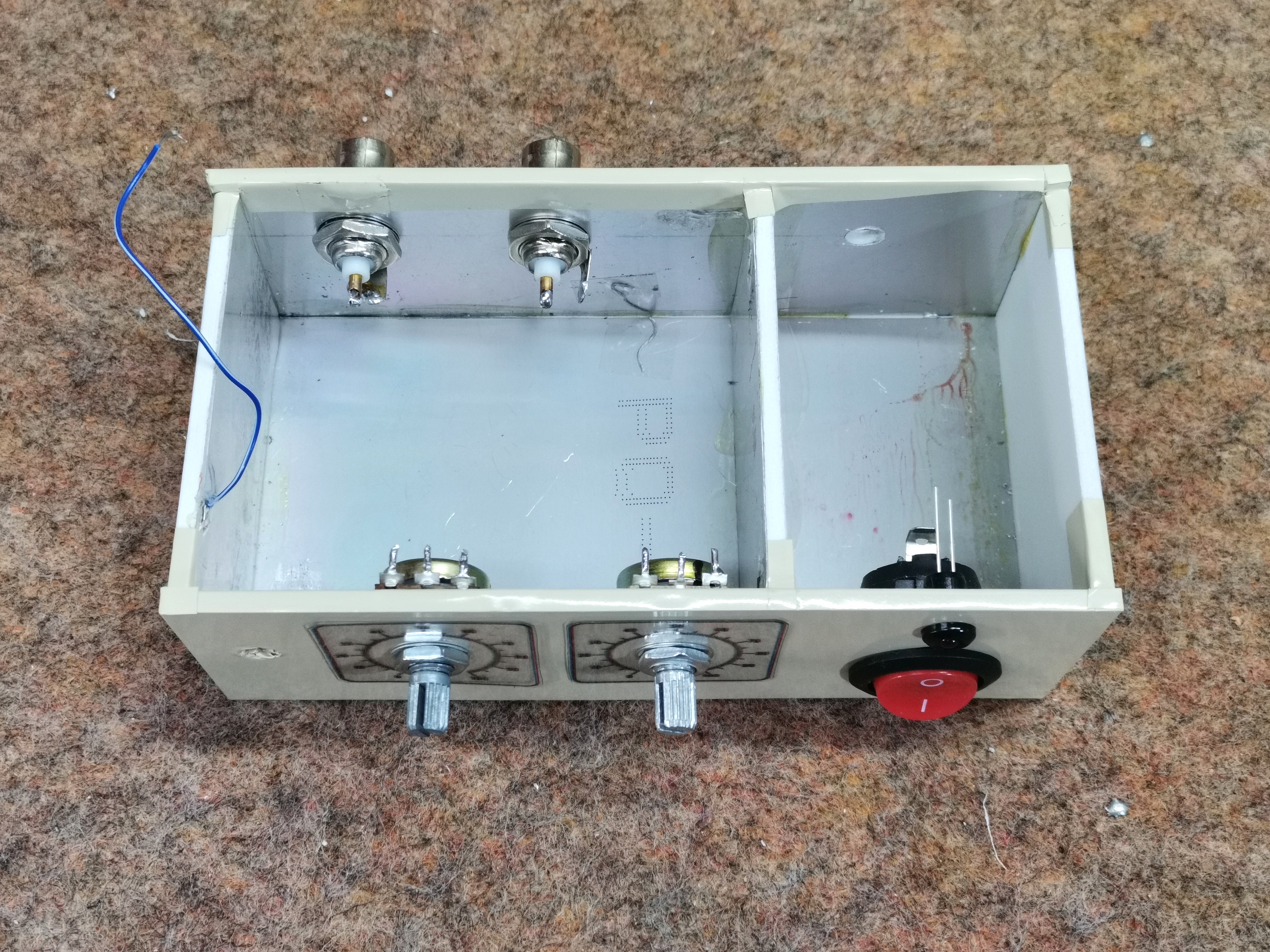

The PCB is built into a suitable box that is completely covered with a metal cover connected to the ground to avoid unwanted external influences.
  Instead of a transformer and rectifier, we can use a 9V battery because the total consumption is extremely low and the battery would allow for several months of uninterrupted operation.

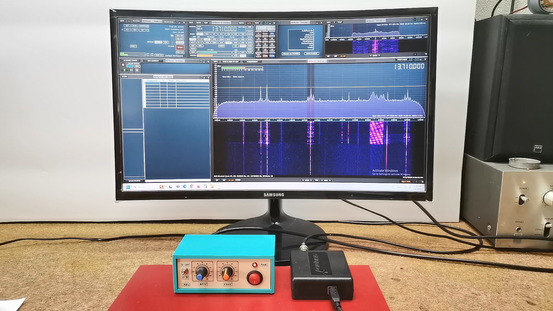

  Now let's see how this device works in real conditions. I will use my 10m long Long Wire antenna located on the roof of the house. As a radio receiver, I will use my SDRPlay software-defined radio because its software will provide us with an excellent visual presentation of the functionality of the antenna preselector. In fact, this SDR radio also has a built-in preselector circuit for each band, so the true efficiency and usability of this device would be best seen in a simple DIY radio receiver.
   I connected the long wire antenna to the input of the preselector, and I connected the output of the preselector to the SDRPlay receiver.
  As I mentioned, I will start by using the SDRUno software because it is the best way to visually understand the function of this preselector. Now I will move the Frequency knob until I get the strongest and clearest reception. It is immediately clear that the difference before the adjustment and now is huge. I try this on other bands too. After a short practice, we can almost instantly set the Frequency potentiometer to the ideal position in which we will get the best reception with the lowest noise level. Unless we have a particularly strong shortwave station nearby, the Gain potentiometer should always be in the position for the strongest reception.
