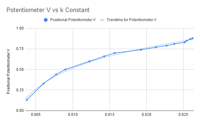

Phase 1: Calibration
The powermeter's design is based on the law of conservation of energy. When the flywheel is maintained at a constant rotational speed, most mechanical power input by the user is dissipated as heat through the braking system.
By characterizing the power dissipation of the magnetic brake, we can directly approximate user power output.
The power it dissipates follows a predictable physical law: P = k · ω². Hence the calibration step is to determine this k value for the bike at each of the 15 resistance levels.
Note: The manufacturer already has these values but they're not publicly available so we have to get them experimentally.

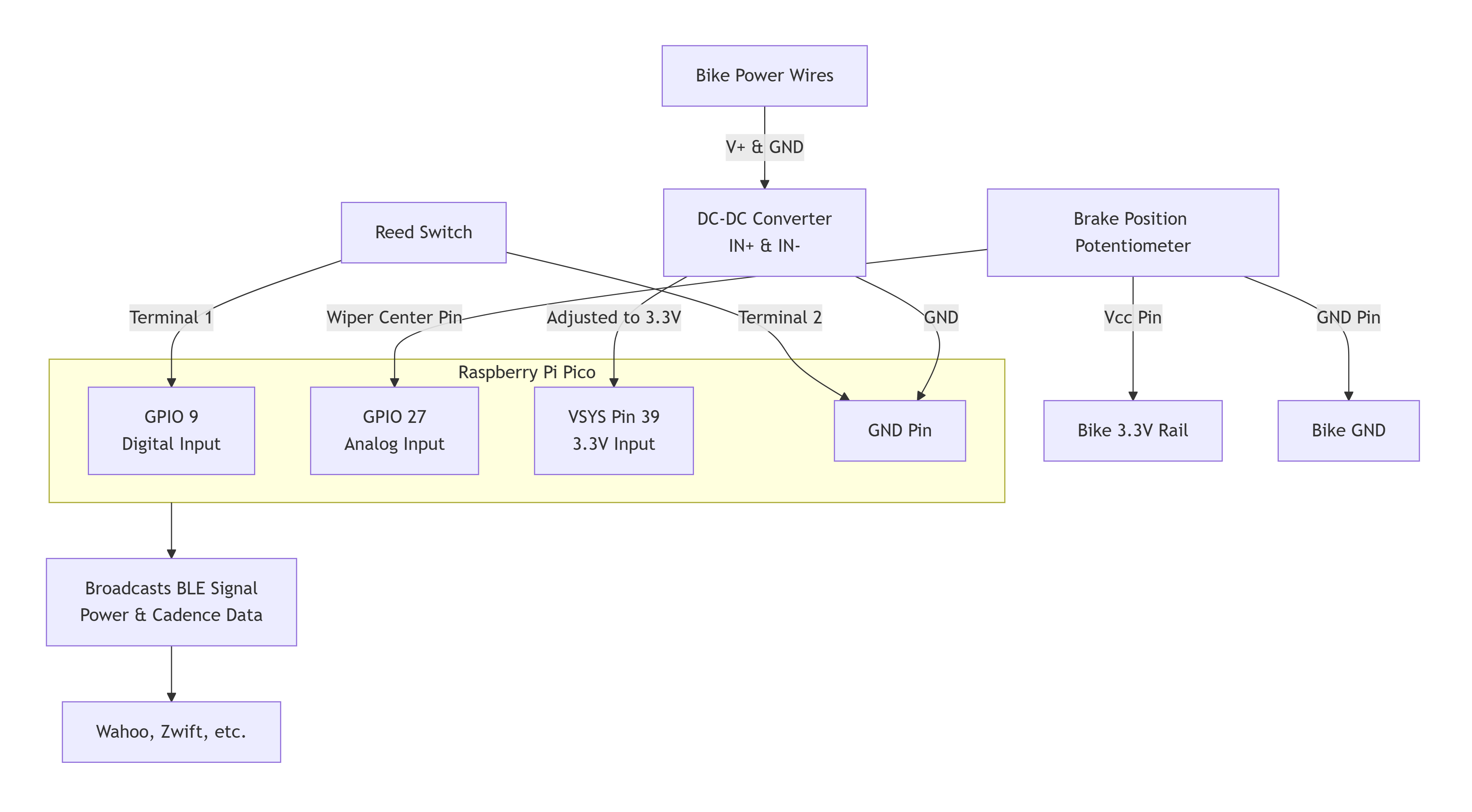

We load the bike's power characteristics into a look up table and modeled with Micropython onto the Pico. And wire it up to the bike's DC power and cadence sensor.
The powermeter will use the standard BLE service specifications for Cycling to broadcast the power, speed and cadence as a bluetooth sensor would. It should be detectable on the popular cycling fitness apps. Tested using Wahoo.
