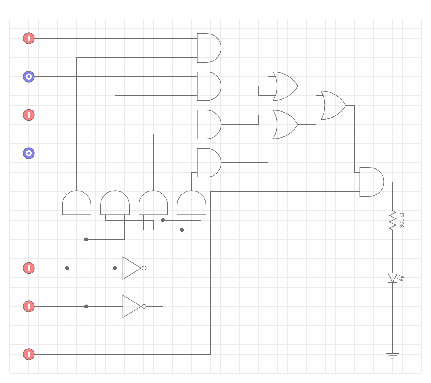

2. Instruction Memory (Abusing Multiplexers)

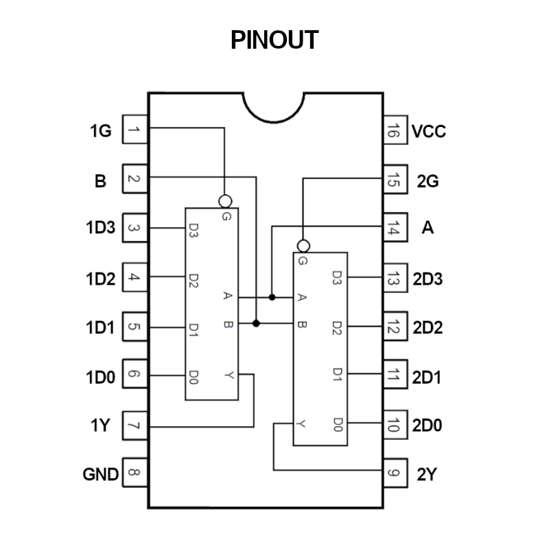

At the heart of the project lies a memory made from 8 multiplexers 4:1 (74LS153).
Each multiplexer stores one bit of a 4-word ROM. Two control lines (S<sub>0</sub>, S<sub>1</sub>)
select which instruction is active:
| S1 | S0 | D7 D6 D5 D4 D3 D2 D1 D0 | Instruction |
| 0 | 0 | 0 0 1 1 0 0 0 0 | Configure 8-bit mode |
| 0 | 1 | 0 0 1 1 1 0 0 0 | Enable 2 lines |
| 1 | 0 | 0 0 0 0 1 1 1 1 | Show cursor |
| 1 | 1 | 0 0 0 0 0 0 0 1 | Clear display |
Each combination of (S<sub>1</sub>, S<sub>0</sub>) triggers a unique 8-bit word that the LCD interprets as a valid command.
This structure transforms the MUXes into a hardware ROM.
