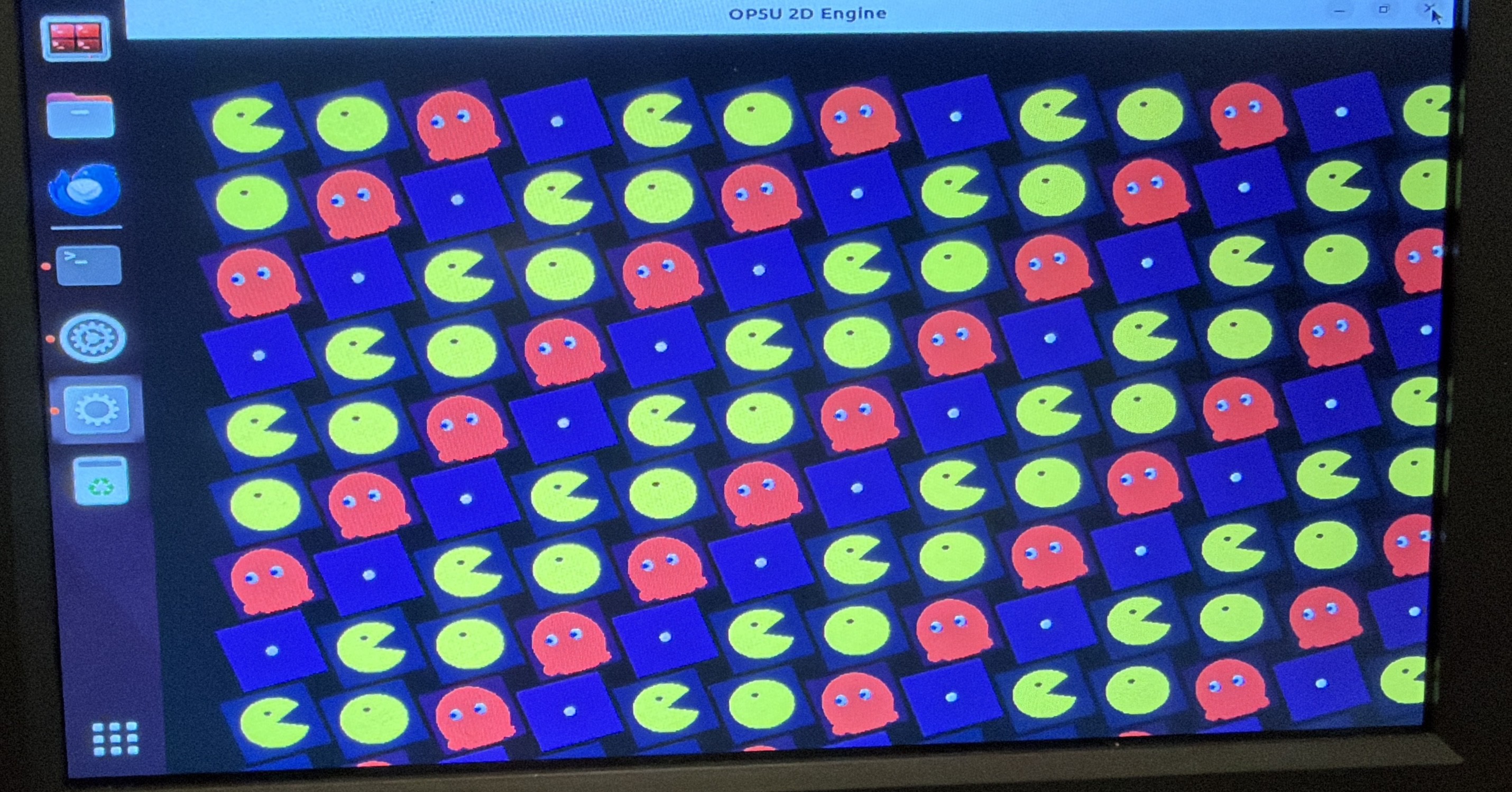

I wanted to see what it would take to push that GPU directly — so I wrote a renderer in C++17 using SDL2 and GLES 3.1, targeting pure performance and simplicity.
The result is an engine that can draw thousands of sprites at 60 FPS with instancing, full camera control, and smooth continuous rotation.
✳ Current Features
  • GPU instanced sprite rendering (each sprite is a hardware instance)
  • OpenGL ES 3.1 shaders written by hand
  • Pan, zoom, and vsync toggle
  • Per-sprite rotation and dynamic UVs
  • FPS logging and real-time performance readouts
  • A simple texture atlas system (512 × 512 pixels)

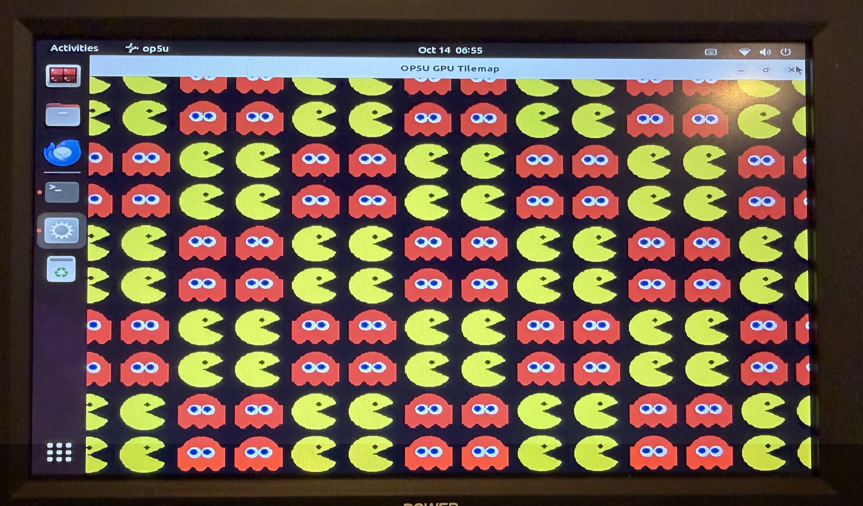

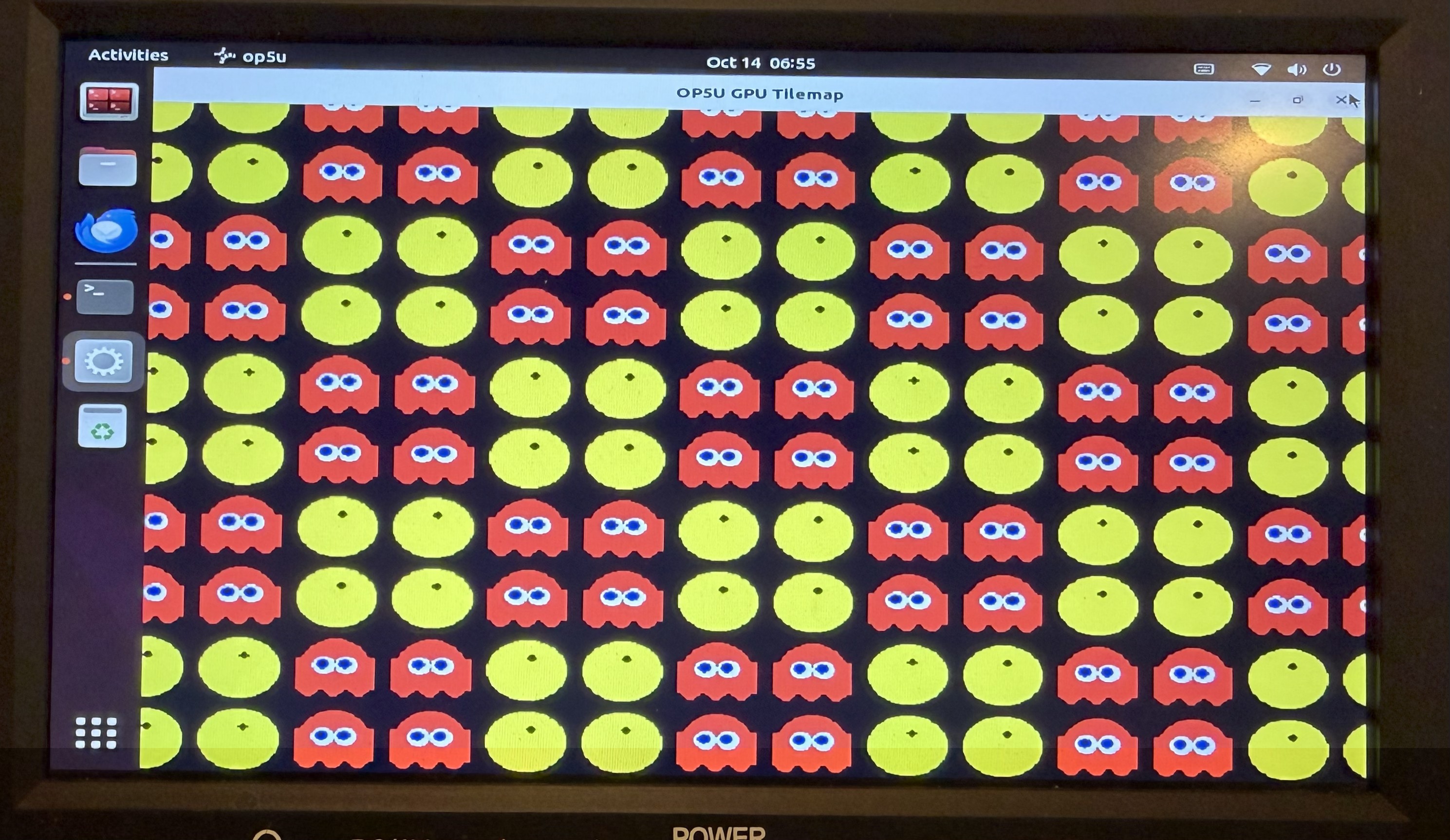

    Jonathan Stein10/13/2025 at 23:15 0 comments
    The OP5U 2D Engine just hit a major milestone — our first fully GPU-driven tilemap with live animation.
    The engine now renders hundreds of Pac-Man and Ghost sprites at 60 FPS using OpenGL ES 3.1 and the Mesa Panfrost driver on the Orange Pi 5 Ultra.
    The tilemap is drawn entirely via instancing; the CPU only updates a small 128×128 byte array representing the map. Even the classic Pac-Man “chomp” animation (open/closed mouth) runs with a single glTexSubImage2D call every 250 ms.
    The result: rock-solid 60 FPS, minimal CPU load, and perfect GPU pacing — our first real proof that the Panfrost driver can handle fully dynamic tile animation.

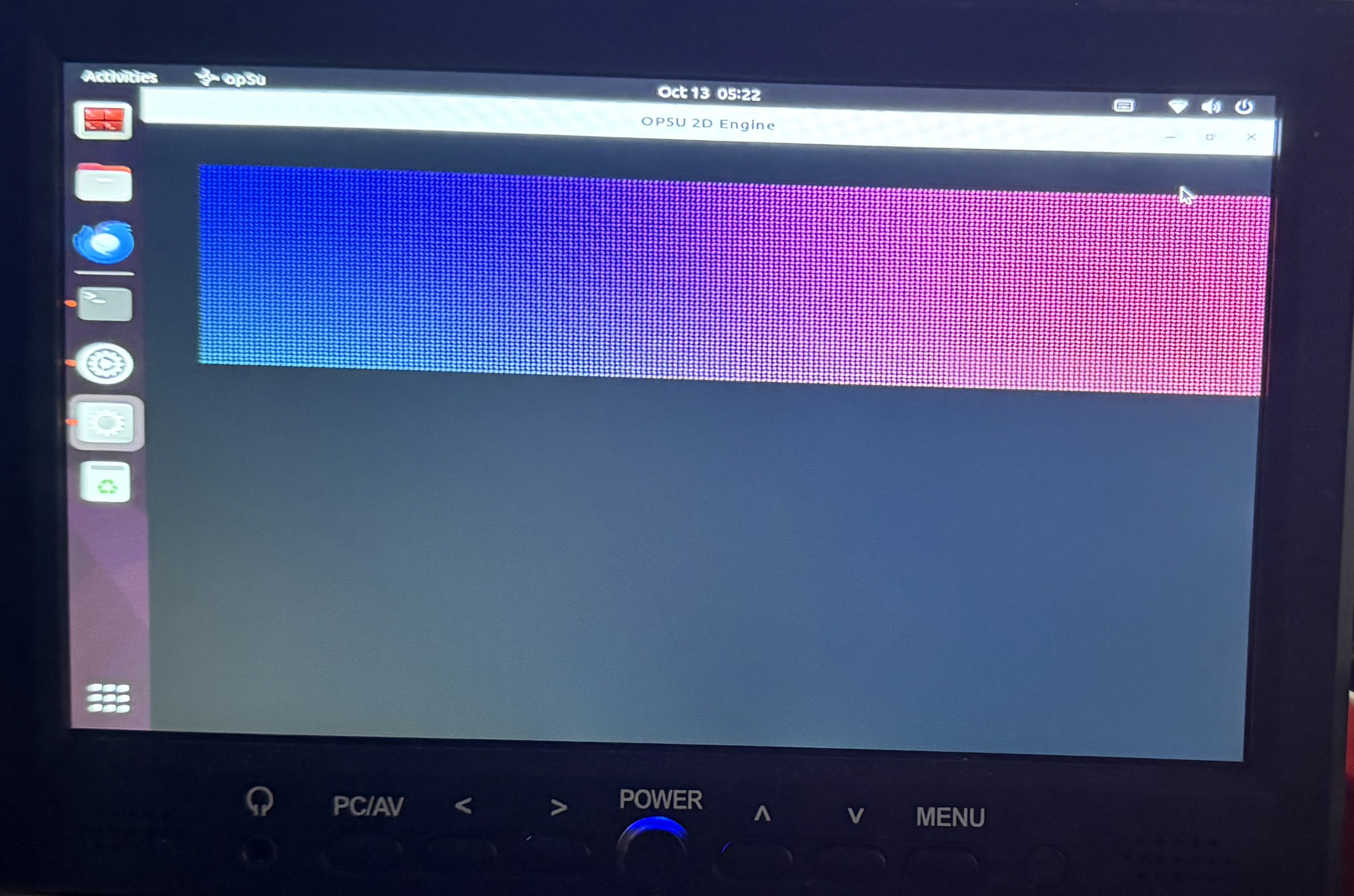

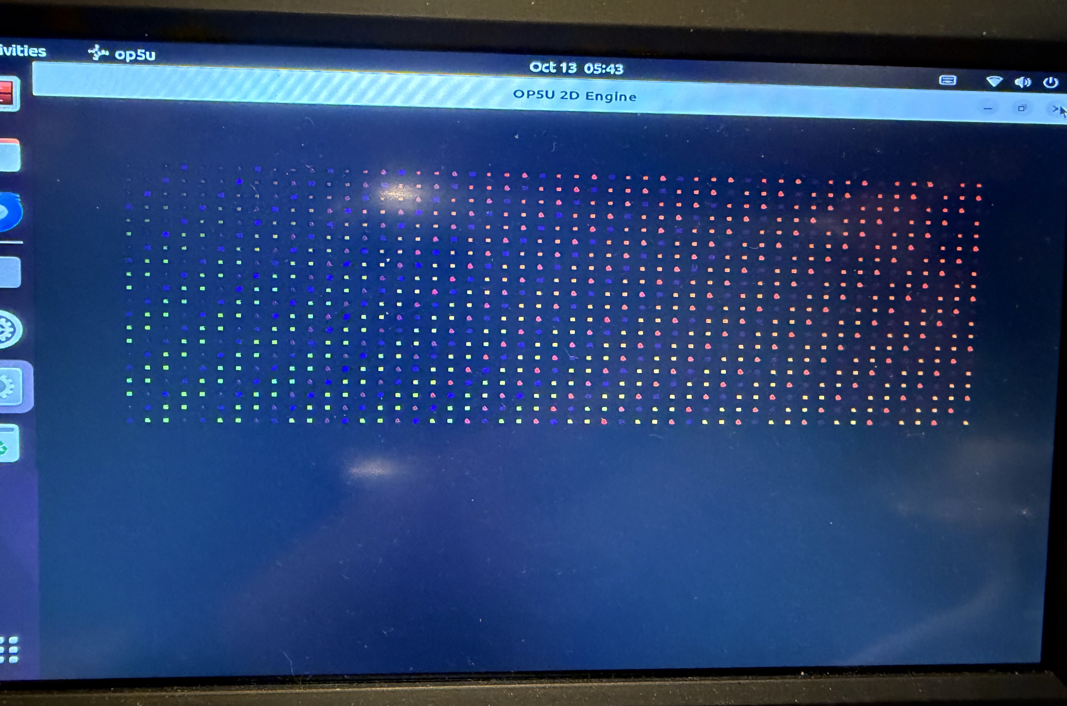

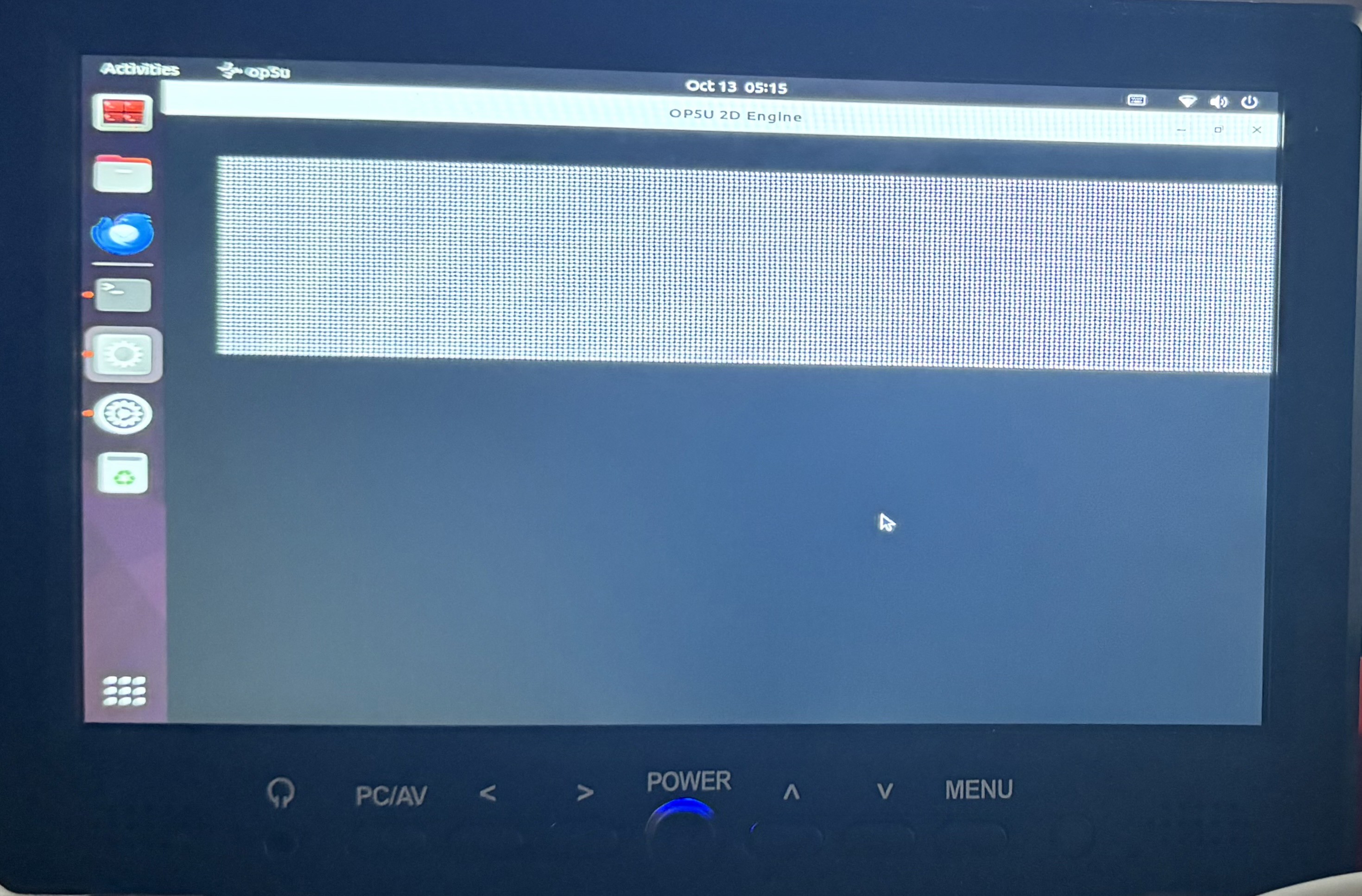

  • Devlog #1 – Getting Real-Time Sprites Running on the Orange Pi 5 Ultra
    Jonathan Stein10/13/2025 at 13:21 0 comments
    I’ve been building a 2D GPU engine from scratch on the Orange Pi 5 Ultra.
    This first milestone: rendering hundreds of animated Pac-Man sprites in real time using OpenGL ES 3.1 and SDL2.
    The engine runs at 60 FPS on the Panfrost driver with vsync, zoom, and camera control.
    What works so far:
    • GPU instanced sprite rendering (~10 000 sprites)
    • Continuous per-sprite rotation
    • Camera pan/zoom, vsync toggle, FPS logging
    • Texture atlas system (512×512)
    Next up: sprite animation (frame-flipping Pac-Man, blinking ghosts), and eventually a tilemap background.
