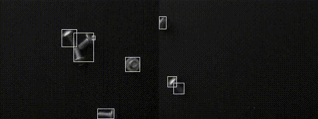

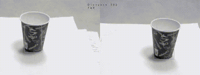

Blob detection based distance measurement
Here is simplified example of distance measurement based on blob detection algorithm, implemented in OpenMV framework:

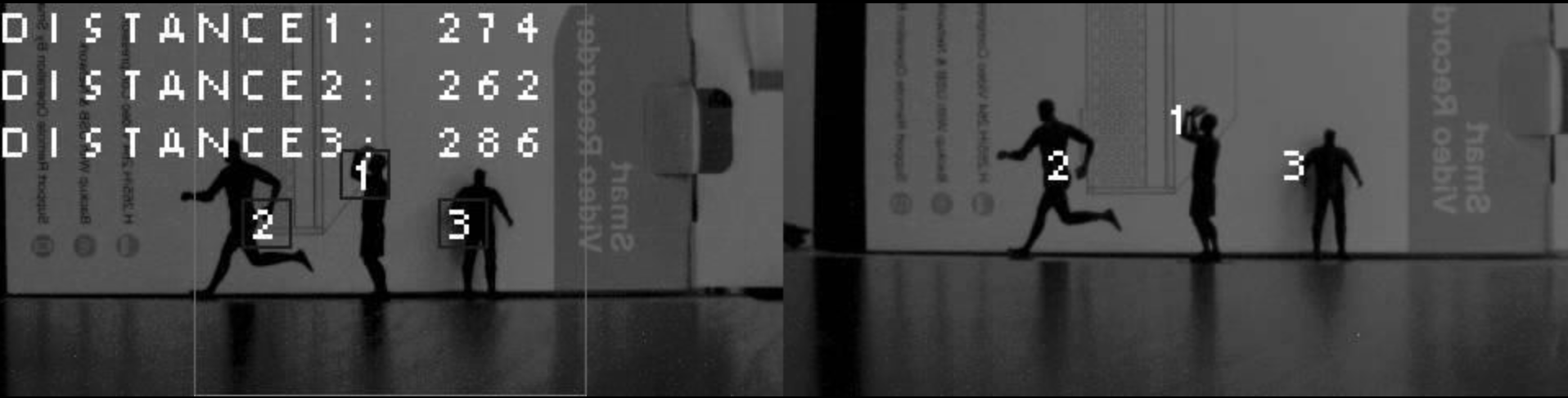

TensorFlow object detection and distance measurement
The principle is to detect a human figure using a neural network on the left side of the image, search for the corresponding object on the right side of the image using correlation, and calculate the conditional distance to the corresponding objects
for i, detection_list in enumerate(net.detect(img, roi=NET_ROI,thresholds=[(math.ceil(min_confidence * 255), 255)]) ):
    if i == 0:
        continue  # background class
    if len(detection_list) == 0:
           continue  # no detections for this class?
   img_template = img.copy(1.0, 1.0, ([x-10, y-10, w+20, h+20]), copy=True)
   r = img.find_template(img_template, 0.7, step=4 , roi=[WINDOW_FRAME_WIDTH, 0, WINDOW_FRAME_WIDTH, WINDOW_FRAME_HEIGH])
The size of the doubled frame in this test is 960x240. The object is searched for on the center of left half-frame, inside 240x240 pixel area. When three objects were found on the right frame and, accordingly, three correlation calculations, the processing speed dropped to 4 frames per second.
Scene view :

Output :
dist_mes

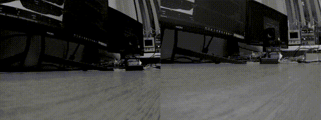

Frame difference mode
The output frame is obtained by subtracting the pixels of the current frame from the previous one.
openmv_diff_hw
Morphological Transformations
No filtering:
openmv_0
Both filters switched in erosion mode to visually "separate" nearby objects:
openmv_1
