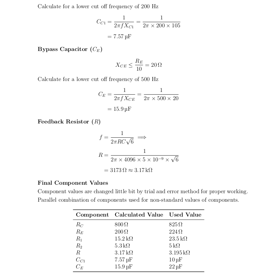

The feedback network is deciding the oscillation frequency. Here it is a 3-stage network with equal values of resistances and capacitances. It produces the necessary 180-degree phase shift for the required oscillation frequency. In one of the stages, added a preset to adjust the frequency a little bit to correct the errors. Resistors and capacitors are used as a combination of multiple in parallel to reduce the tolerance effect. Also, we can achieve nonstandard values this way. The feedback is connected to the transistor base through one capacitor to avoid disturbing the BJT biasing due to the feedback network.

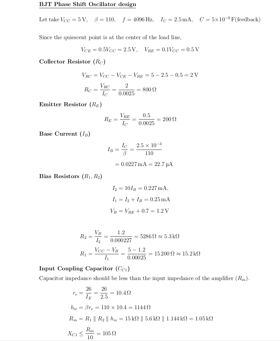

Amplifier using BJT
It is a simple RC-coupled amplifier. The gain is set around 29 to make an overall gain of unity to ensure the oscillation. The gain we can adjust using the emitter preset to keep the oscillator in the working region. Base resistors are used to bias the BJT. Here also introduced the parallel combination logic to reduce tolerance. The full design flow is given below
Results
The current consumption of the circuit is 3mA @ 4098Hz and 5V.
