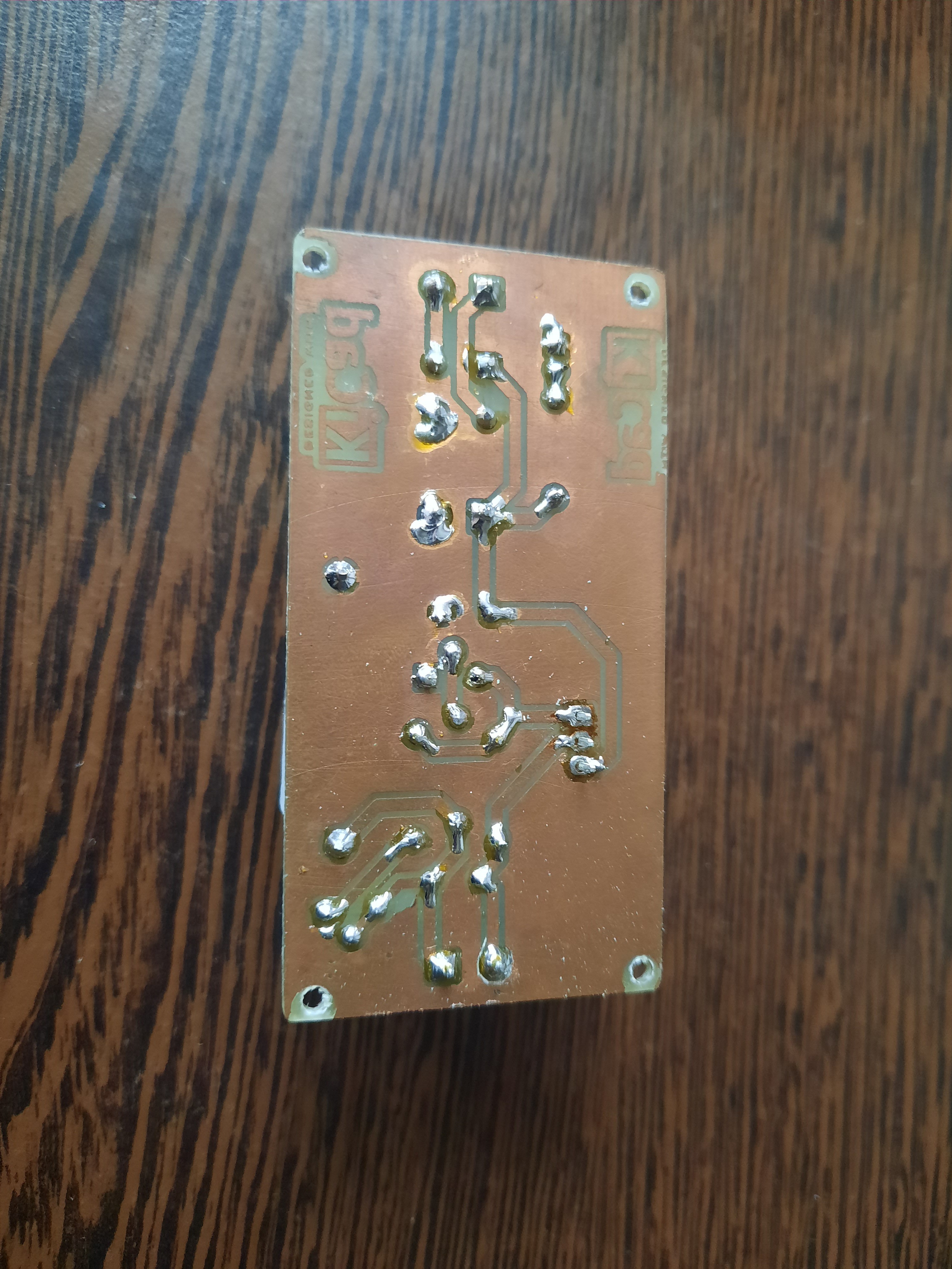

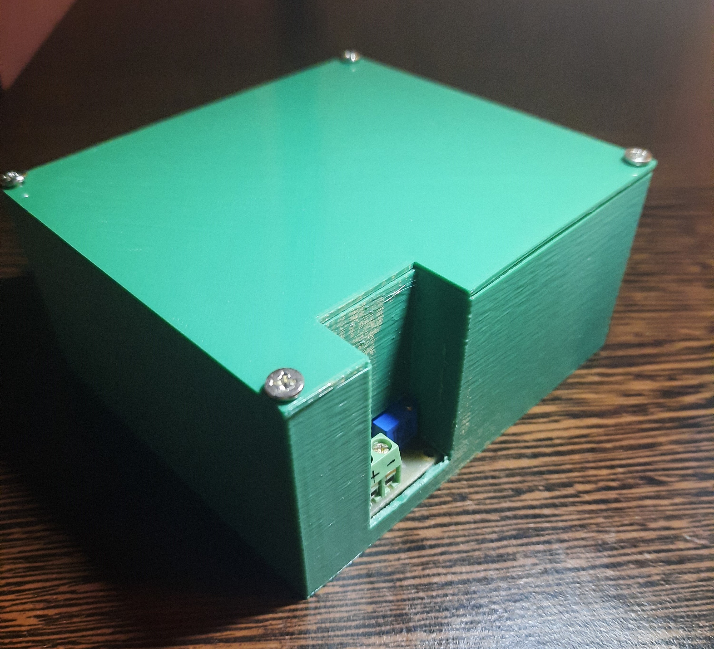

I present to you a project that really didn't reach its final state, until recently. It's been more than 1 year since I was working on a project that included a 12V battery (I don't even have that battery anymore 🤣🤣) and I needed a way to charge the battery. I like to spend my time working on something, and I opened the internet, KiCAD and look how I got a PCB. The method of making it -- homemade -- of course (thermal transfer using a clothes iron); over time the PCB got worse, it's not perfect, but it still works. What do you think about this ?

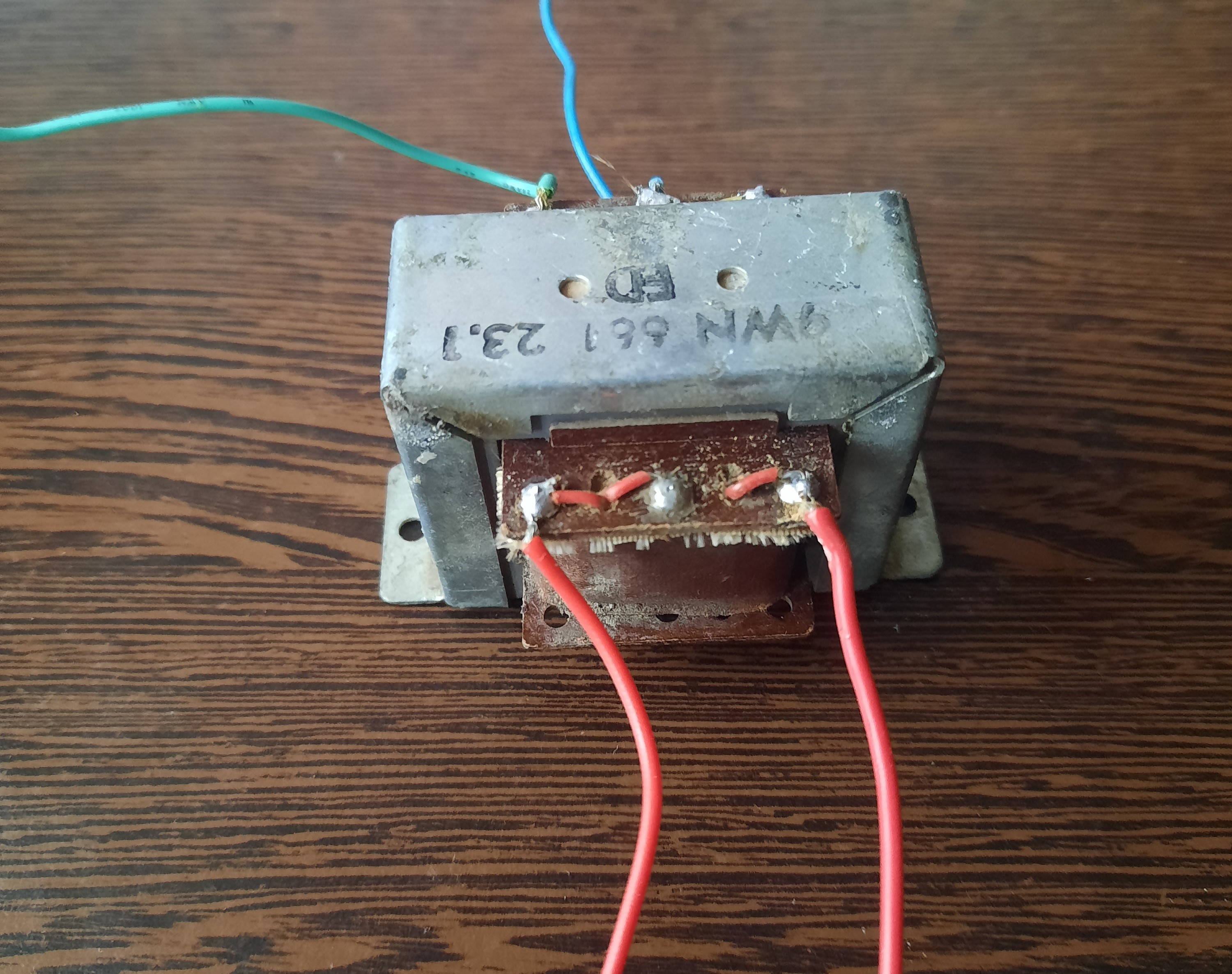

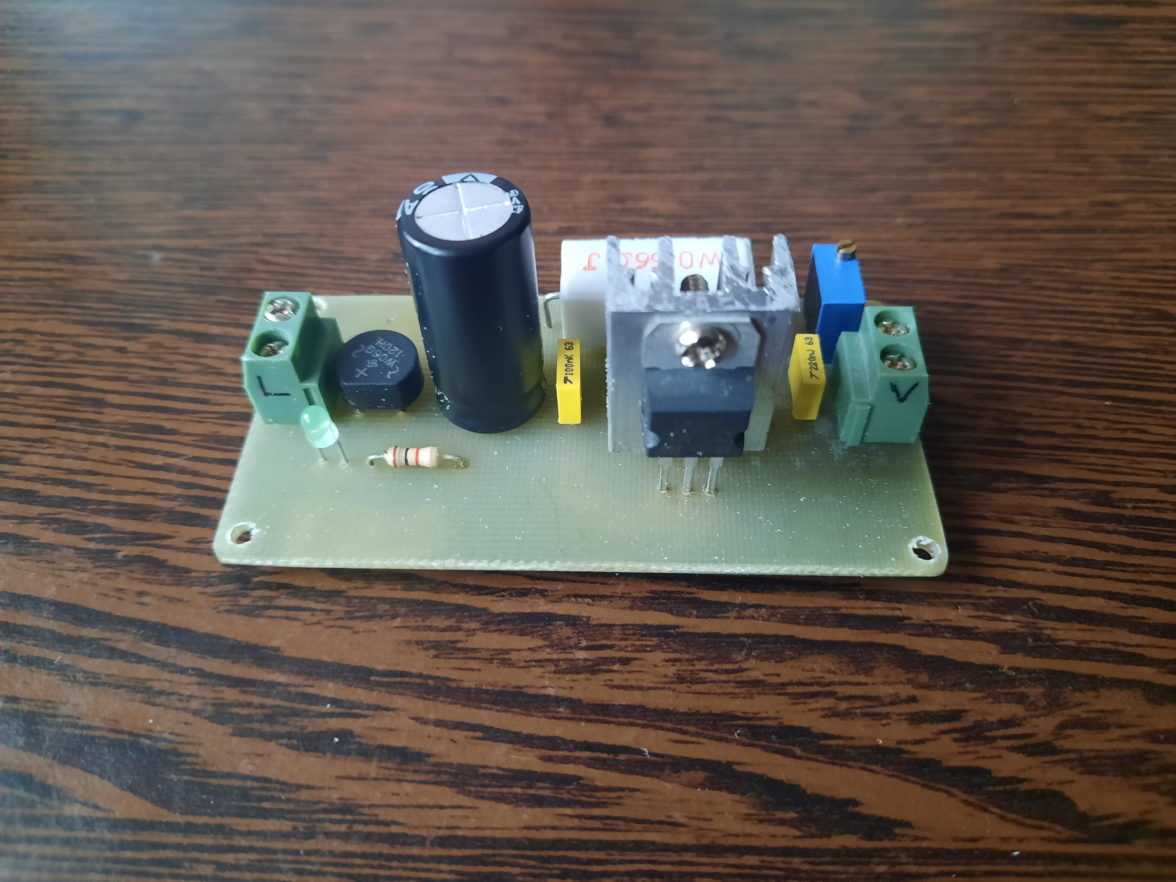

Most of the components are actually salvaged (I like to reuse what I have), but I also bought a few because I didn't have an equivalent. The transformer is recycled from an old radio, I think it can handle about 1A, it gets a little warm when I connect a more discharged battery (i.e. one that also draws a lot of current). It may not be pretty but for me it is still good to use. I think from of all these components, the transformer is probably the most unsuitable, meaning that putting one from a radio into a charger means some abuse, but I have enough "abused" components being unsoldered and later re-soldered.

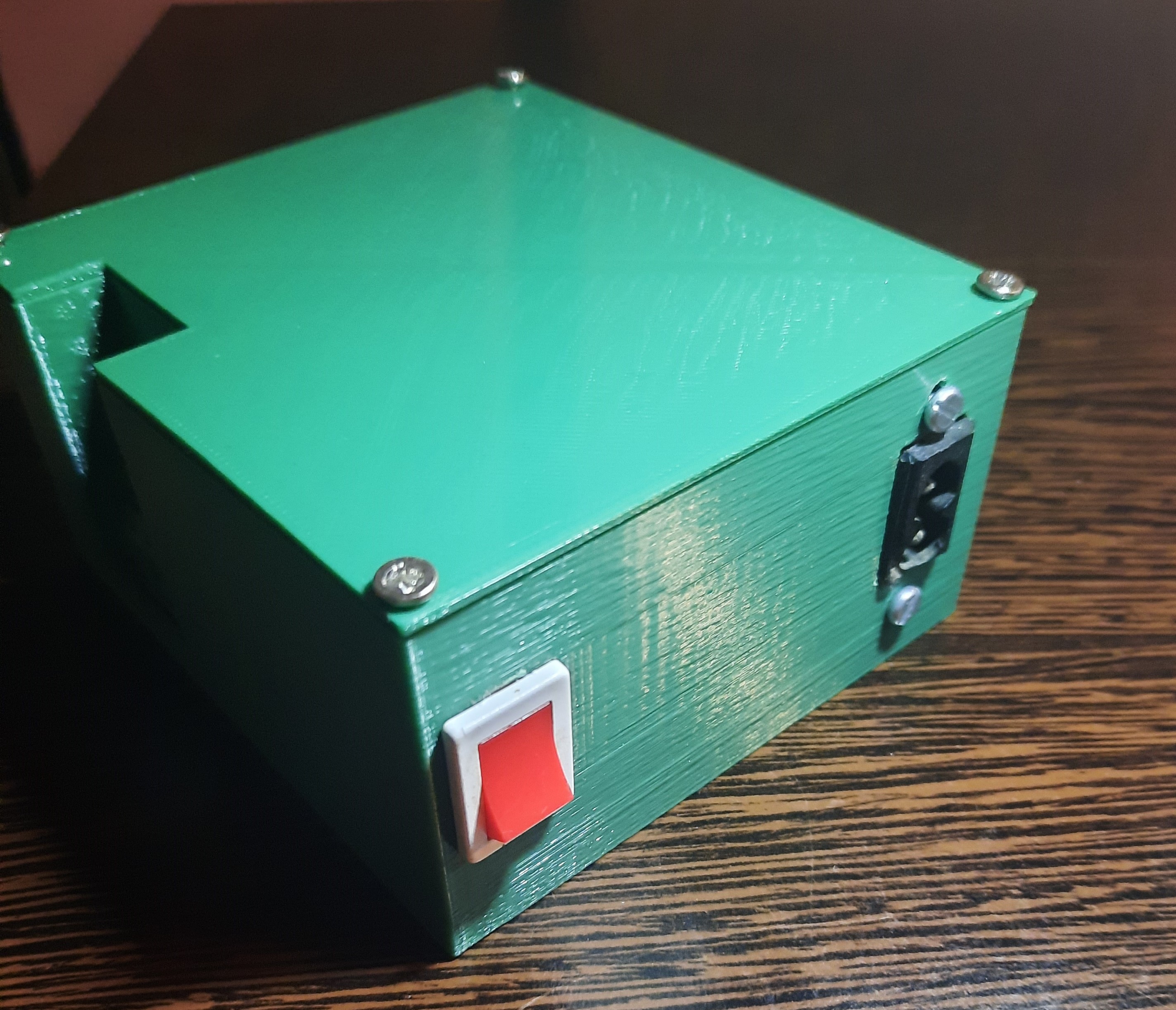

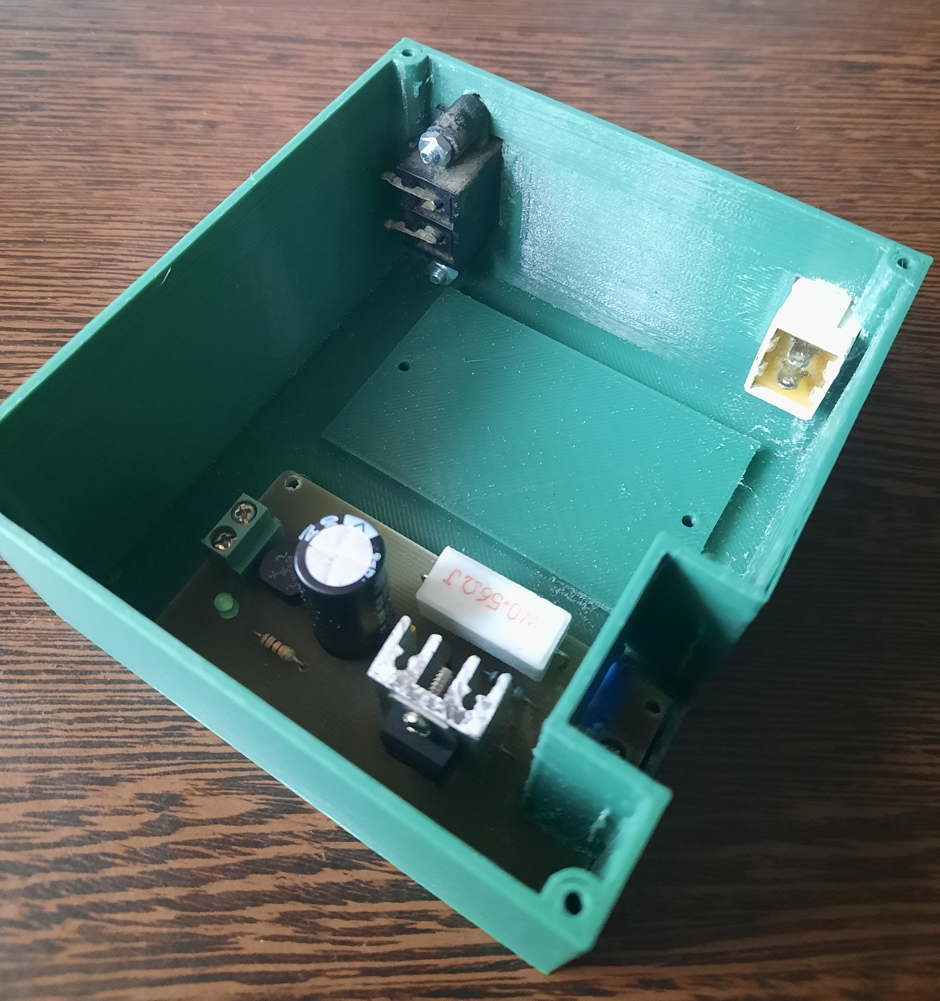

The recent novelty is 3D printing, after some experiments with Tinkercad I made some 3D designs, I went to town to a workshop where they have a 3D printer. It's not perfect, I had to use a file and a letcon to make room for the PCB. I like 3D printing because it allows me to create custom projects.

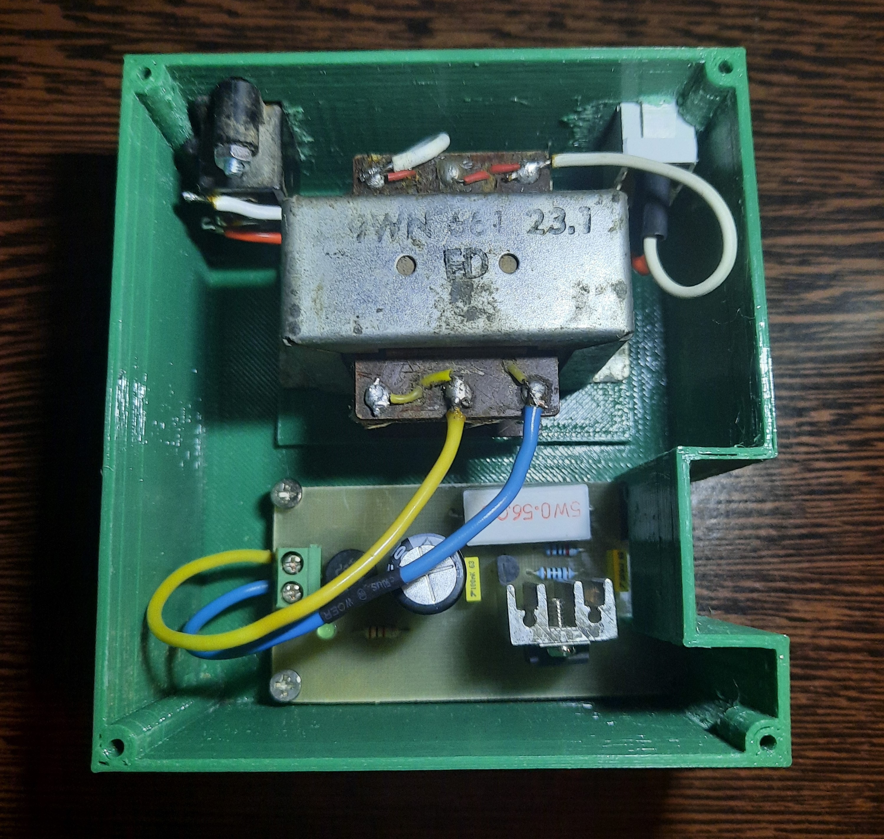

I soldered a few wires, I couldn't completely insulate them but since the case is plastic I don't worry about touching something that would make me smile too loud. 😆😅

The LM317 must be cooled with a sufficiently large heat sink (ultimately it depends on how much you ask of it).

The diode bridge D1 is rated at 2A, and the transformer is a voltage drop from 230Vac, I don't know what voltage it has in the secondary but I trust that I did it correctly.
