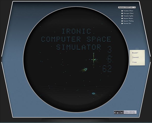

I was tempted to just scale my existing design down to 50% but worried that saving a bunch of time up front might lead to a lot of unforeseen issues on the back end. I decided to start from scratch. Besides I'm retired and have the time ;-)  Also in my effort to start learning how to program a PDP-1, I had been reading "Retrochallenge 2016/10: Ironic Computer Space Simulator (ICSS)" a wonderful recanting of the effort it took to reproduce an arcade video game from 1971, Computer Space on the DEC PDP-1. There I came across the following image:
with the caption: The Ironic Computer Space Simulator running on the emulated PDP-1.
Based on this, I think what I'm seeing is a photo that has been brought in as a background to the game screen over which controls (upper right) and the game display are being superimposed. To me this is the most perfect "front on" image of the Type 30 (?) Display that I had ever seen. Every other image I had seen is shot at an angle (sometimes small) that introduces parallax effects when trying to make measurements. One other caveat is that there is no guarantee that this is a Type 30 Display image.  I never-the-less decided to use this image as the basis for my smaller model.
So I brought this image into Fusion, "calibrated" it based on the screen cutout being 8 inches (half the originals 16 inches - see how easy that was ;-) and proceeded from there to model the rest using the now calibrated image as a guide.

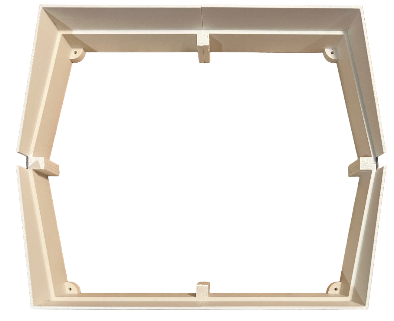

    Assemble The Sides​
    This is one of the places that I made a change, hopefully for the better. I found that bolting the sides together in the 2:3 scale version was a pain in the butt because of the angled sides. So for this version I switched to dovetails.
    Make sure that you have the four pieces in their right positions and slide the dovetails together. They are a little tight. I put a drop of sewing machine oil in the groves and the sides slide together pretty smoothly.

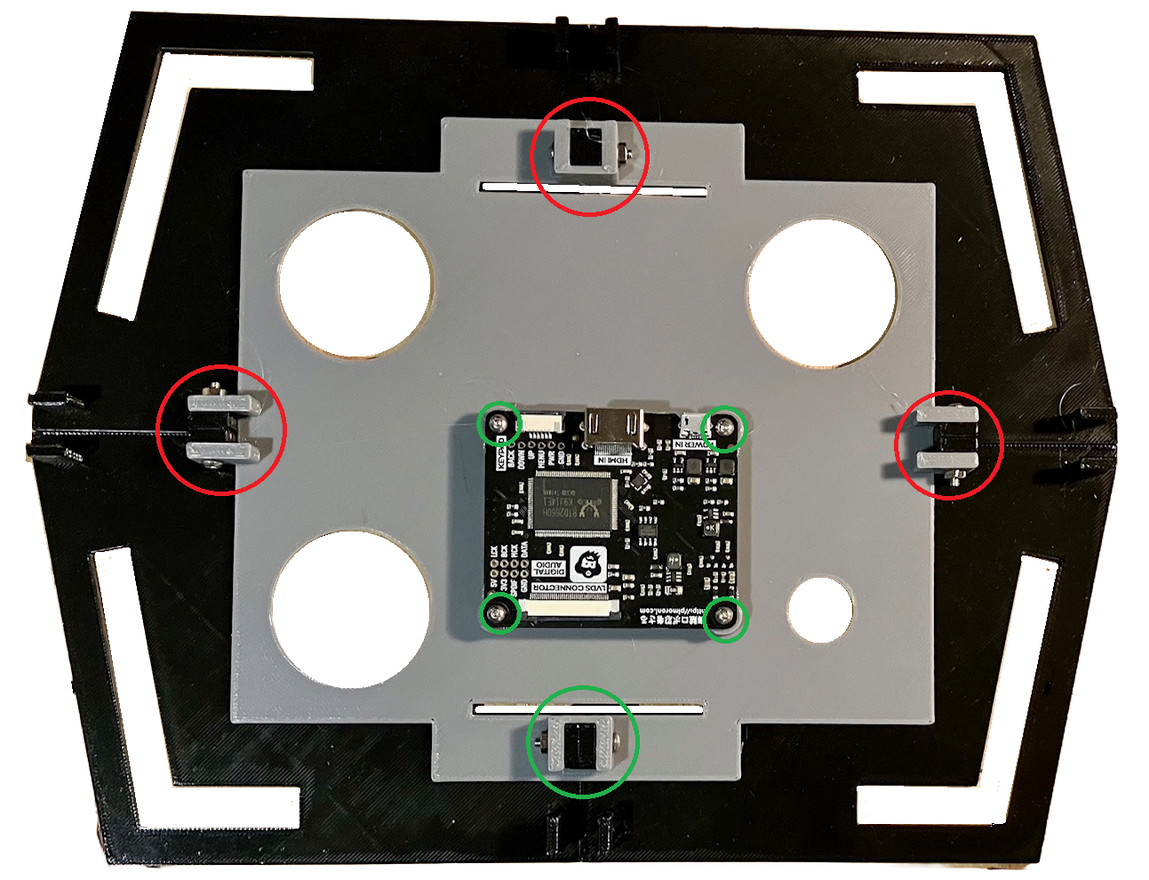

    Assemble The Display Holder
    Connect the four parts of the Display Holder while at the same time attaching the Display Back plate using four M3 x 12 mm bolts and nuts (red circles). Attach the PCB for the display to the standoffs on the Display Back using four M2.5 x 6 mm bolts (green circles).  Bolts are self threading so go easy.
