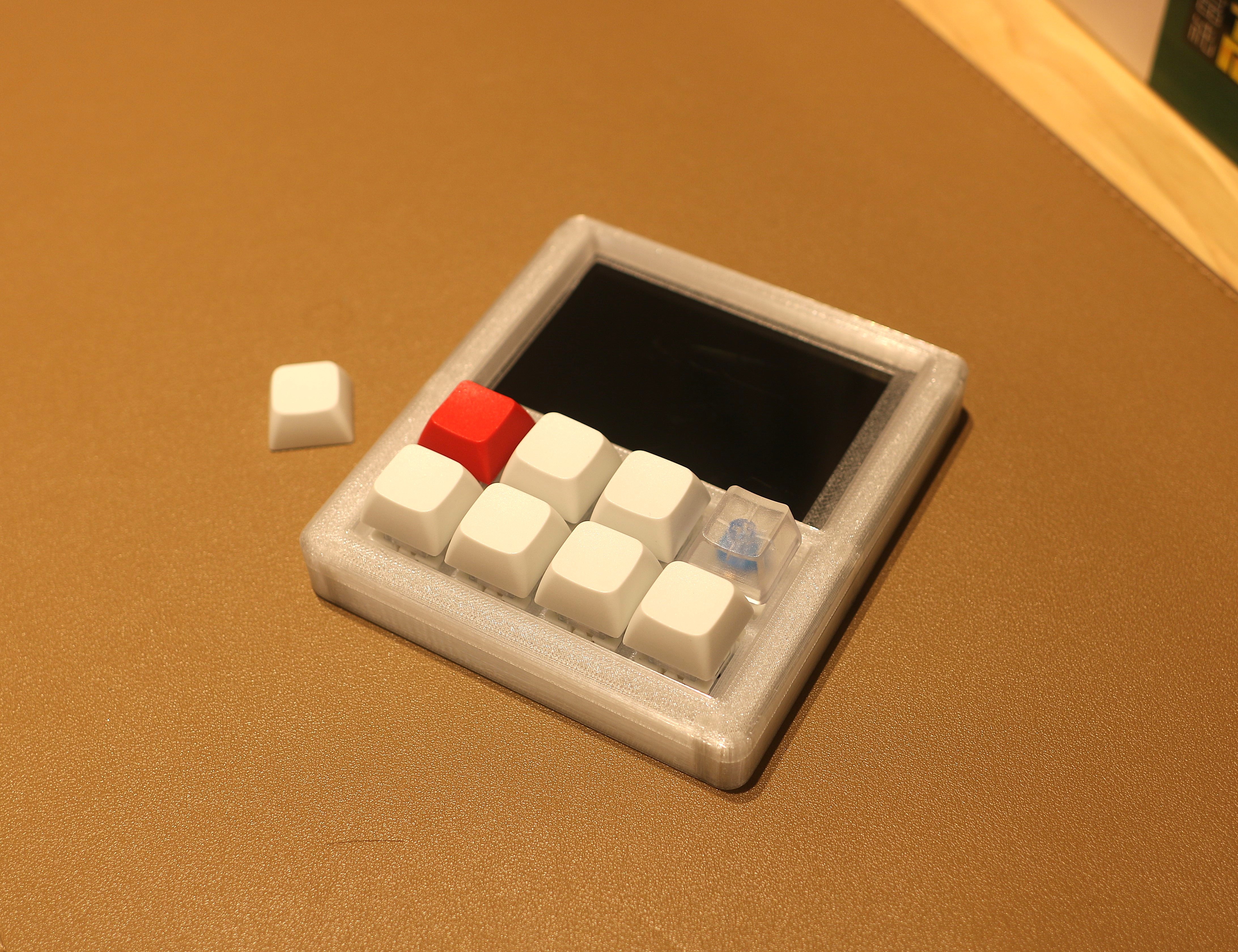

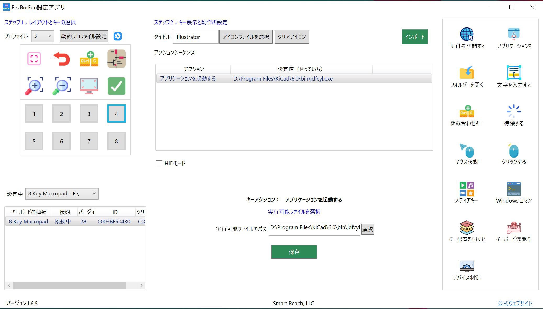

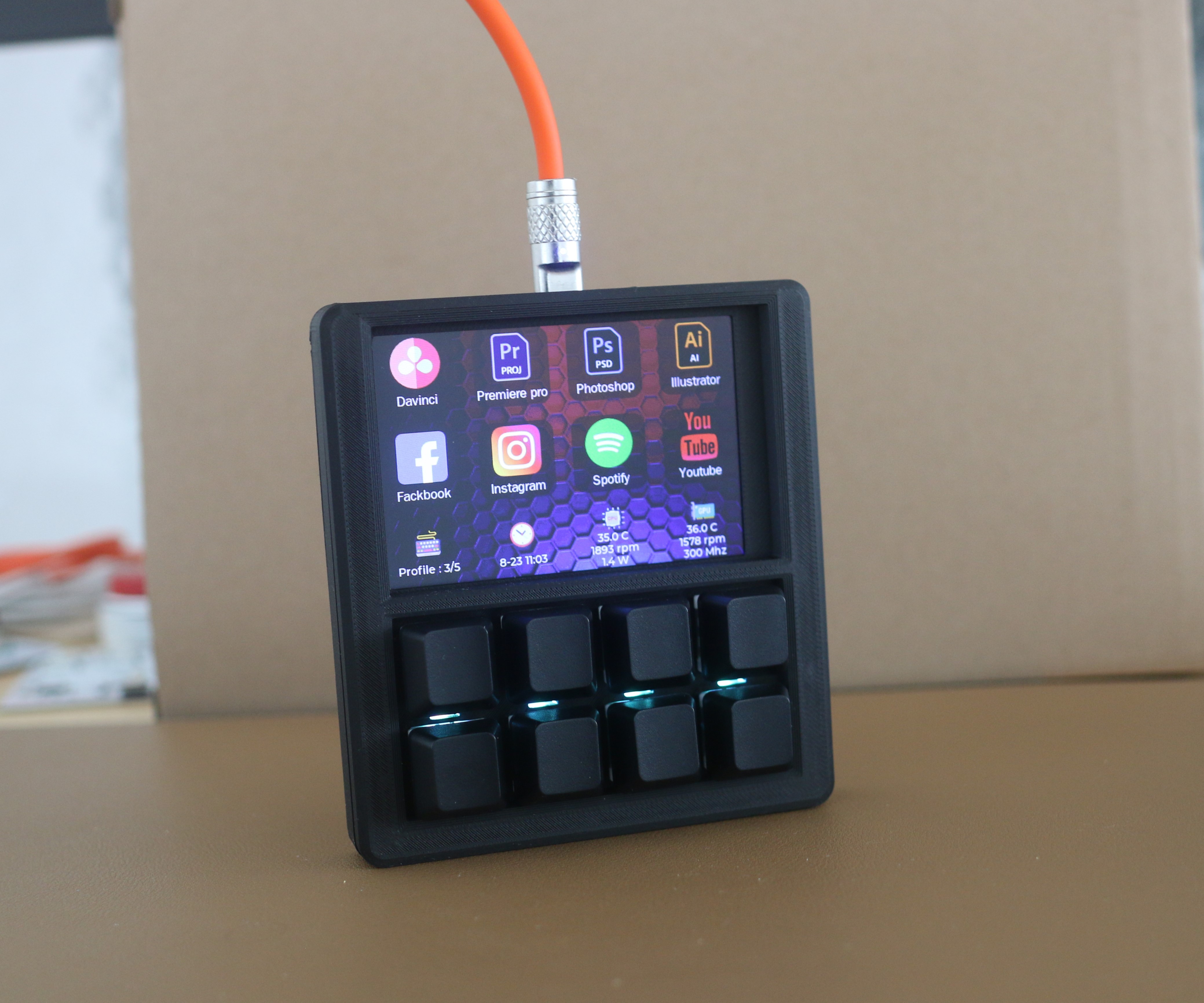

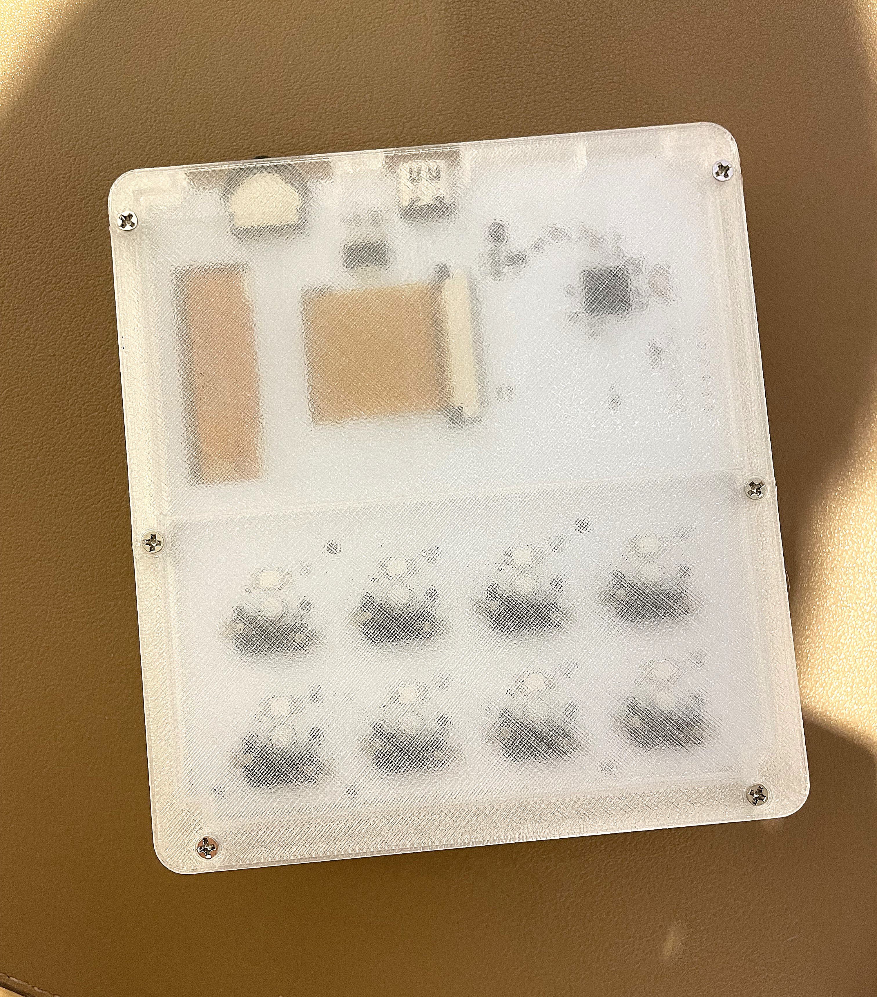

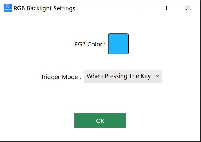

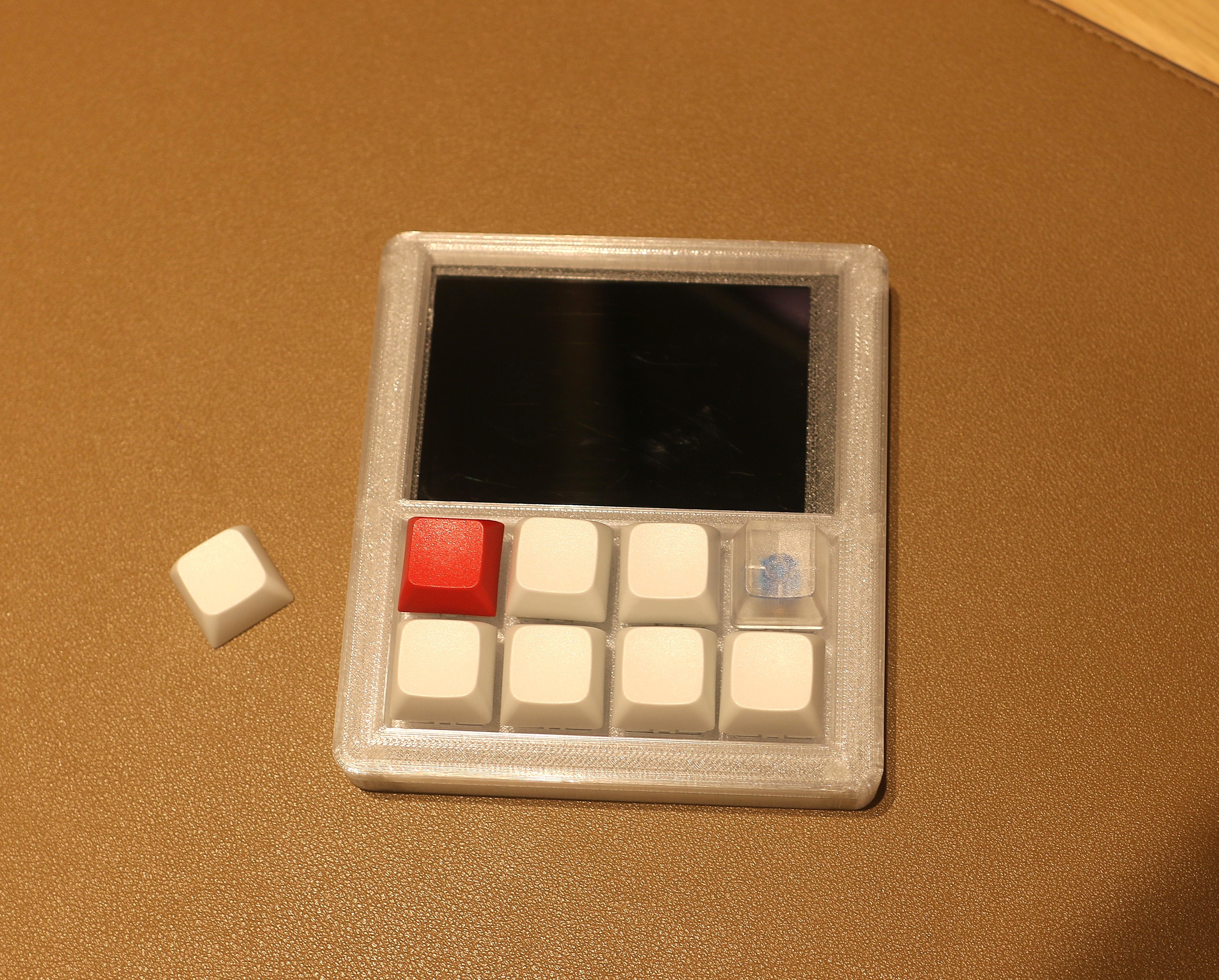

8-Key MacroPad with 3.5 inch LCD
The 8-key macro pad with LCD isn’t just another macro pad— it's a visual, scriptable, dynamic control deck you build and own.
Public Chat
The Idea: Make It Tactile Again What if a macro pad had real, mechanical keys — the kind your fingers can trust — but still showed icons and dynamic feedback like a Stream Deck? That became my goal: the perfect fusion of display and feel. Each key would be visually clear, physically satisfying, infinitely customizable.
⚙️ The Build
The 8-Key MacroPad is powered by an ESP32-S2 and features:
  • 🖥️ 3.5″ 480×320 LCD Display — draws real icons and text for each key
  • ⌨️ 8 Hot-Swappable Mechanical Keys — customizable switches for your preferred feel
  • 🔄 5 Profile Slots — instantly switch between layouts
  • 🧩 Script & Macro Engine — automate your daily routine
  • 🌈 RGB Backlighting — functional and beautiful
  • 🪟 Config App — what you see on screen is what you get on the pad
It connects as a standard HID device, so no special drivers are needed. Just plug and start creating
💡 What You Can Do With It
  • 🚀 Launch apps, build scripts, or developer tools
  • 🎮 Control OBS, audio mixers, or lighting rigs
  • 🧠 Run local logic or show real-time stats (CPU, time, network)
  • 🎨 Switch creative tools or brush presets in Photoshop, Blender, etc.
Each key is both a button and a display — your workflow, visualized and personalized.
housing-bottom.STL
Standard Tesselated Geometry - 120.98 kB - 10/16/2025 at 14:23
Download
housing-top.STL
Standard Tesselated Geometry - 106.23 kB - 10/16/2025 at 14:23
Download
key-holder-for-3d-print.STL
Standard Tesselated Geometry - 44.81 kB - 10/16/2025 at 14:23
Download
screen-cover-for-3d-print.STL
Standard Tesselated Geometry - 45.20 kB - 10/16/2025 at 14:23
Download
tilt-stand.STL
Standard Tesselated Geometry - 40.32 kB - 10/16/2025 at 14:23
Download
  • 1 × 3.5 inch TFT 480x320 resolution and 8 bit parallel interface - much faster than SPI interface
  • 1 × ESP32S2 MCU - where the firmware runs
  • 1 × 3-dir-tact Used to change profile (layout of the key)
  • 1 × Crystal 40M 3225
  • 1 × AMS1117-3.3
View all 10 components
  • Config App Updated
    YANG SHU11/09/2025 at 09:01 0 comments
    1. Add RGB backlight settings, support 5 mode: always on / when pressing / breath / flowing / always off
    2. Support Japanese language
    Japanese language support
  • Switched to Transparent PETG for a Vintage Look
    YANG SHU11/07/2025 at 15:06 0 comments
    Just made a small but impactful change — I reprinted the case using transparent PETG, and it completely transformed the vibe.
    The slight gloss and depth from the material give it a retro, vintage instrument feel — kind of like old game boy gear with tinted plastic covers. The internal glow from the RGB backlight also looks way cooler now.
    No redesigns this time, just a material swap, but it really brings the build to life.
    Sometimes a filament change is all it takes. 😄
    front view 1
    front view 2
    back side
  • 3D printing case
    YANG SHU10/16/2025 at 14:30 0 comments
    I designed a 3D printing case for the macro pad and I am quite happy with the look.
    I used PLA MATTE and printed by a Bambu Lab A1 using 0.16 layer height which improve the quality and just increased a little bit print time, so I think it's a good trade off.
View all 3 project logs
  • 1
    How to assemble 8 key macro pad with the 3D printed case
View all instructions
Torsten C. wrote 10/23/2025 at 22:53 point
Thanks for sharing this project — also the configuration tool looks great!
I noticed the app is currently available only for Windows.
Would you consider open-sourcing the configuration software so the community could help make it cross-platform — for example, as a Linux or Electron-based version?
YANG SHU wrote 10/25/2025 at 05:04 point
Thank you for you interest. For cross platform configuration, I have implemented a web version based on JavaScript and Web Serial API. It is fully open source and I will upload it to the github repo this week.
