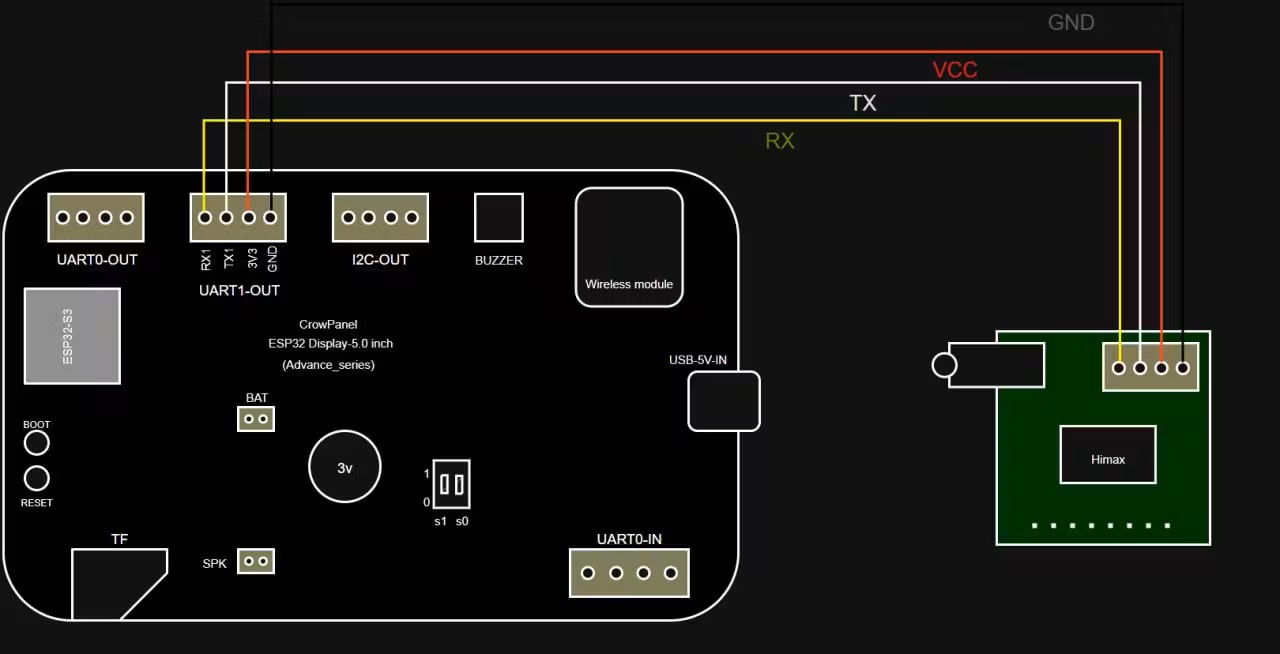

Wiring
- CrowPanel TX → TinyTTS RX
- CrowPanel RX → TinyTTS TX
- GND → GND
- Audio out: 3.5 mm jack on TinyTTS → speakers
- Power: via USB-C (CrowPanel) and 5 V (TinyTTS)

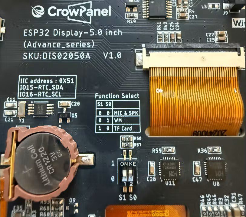

Set the UART1-OUT switch on CrowPanel to WM mode (see photo).

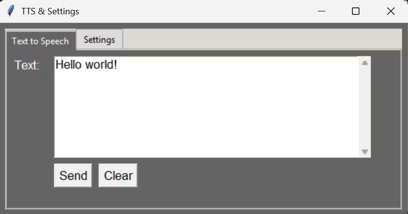

- Run an app from python/app, enter text on the PC, send it to the CrowPanel, and press "Say" on the CrowPanel touchscreen.
- The TinyTTS module will synthesize and play the spoken audio.
