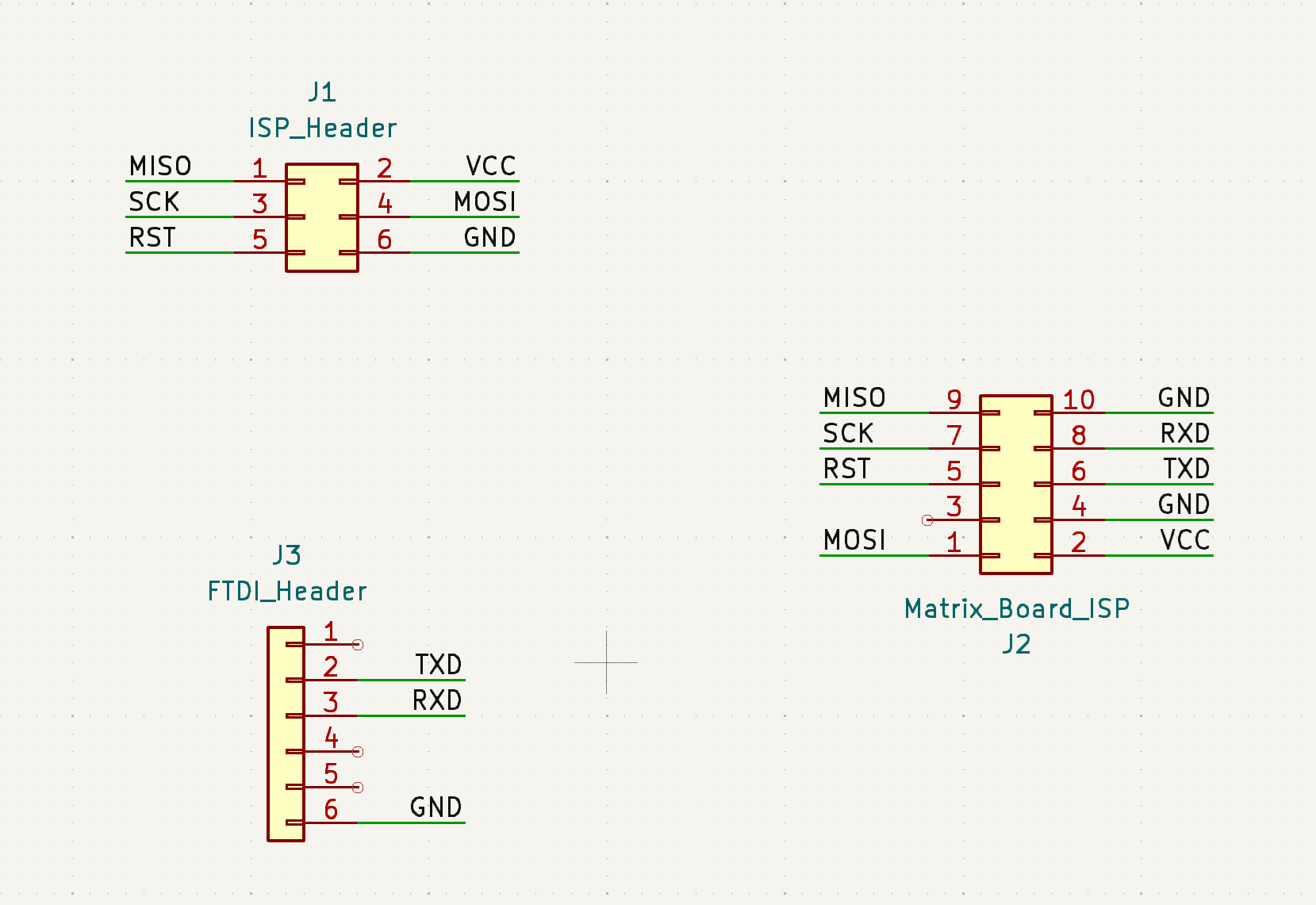

    Flipping the board on its face reveals two main chips. The ATMEGA8 and the HT1632C. The unpopulated components, one of which had a silk screen identifier (DS18B20) and the other was a give away due to the footprint for a tuning fork crystal. Which RTC IC was now the mystery, so out came the trusty multimeter and datasheets.
    The IC (8 pin SOIC) was either going to be a DS1307 or a DS1302. The location of the crystal connections is different for both ICs so the DS1302 was assumed the correct one after a check of the datasheets. The multimeter then told me which pins of the ATMEGA IC they where connected to.
    My attention them moved to figuring out where the HT1632C pins went and recording them. After that was established the 10pin IDC header was the next stop.
    The IDC header had the pins for programming with an AVR ISP MKII as well as serial. I wanted to use the Arduino IDE however the header didn't have the DTR pin for reset the ATMEGA. So I choose to use the AVR ISP MKII and was able to use the "Upload Via Programmer" function.
