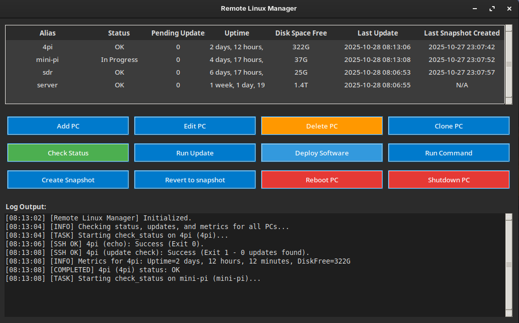

  • New version adds a Clone PC option
    diddy04/15/2026 at 20:18 0 comments

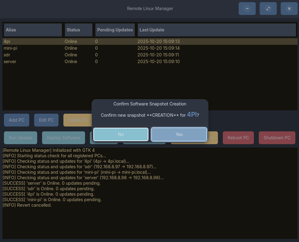

      New version adds a powerful clone pc option (rapid deploy).
      uses a snapshot from a pc in the list view (that a user can select) and will clone the same software onto a selected pc, No disk level copying or hard drive partition cloning. just users, groups and software lists.
      Can clone from :-
    • Pi → x86
    • x86 → Pi
    • Ubuntu → Debian
    • Old Debian → new Debian
    • will also create users and groups also but new users will not have a password set until a user logs in on the target pc.
      Attempts to match the UID as well, if the UID is taken, will map to the next UID.
      very easy way to take a new pc just added to the network up to a configured pc (with a snapshot).
      Extensively tested in simulation but should work for real.
      A weeks serious coding and adding in guarding to get woking.
      I even had to re-write the snapshot generation code, so existing users of this tool may want to re snapshot your managed pcs before moving onto cloning a pc.
      What it does not do is copy config files or different configurations from the default installed software, there are too many variables to cater for with this approach. this tool is a get a new pc to 95% of the way there and then its up to the administrator to configure afterwards.
      This tool will NOT clone users Home directories as it could take hours to copy multiple GB of data across.
      Download from :-
      https://github.com/diddy-boy/Remote-Linux-Manager

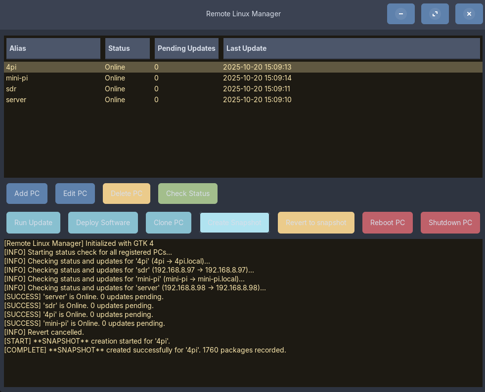

  • Updated to version 2 with fresh UI
    diddy04/10/2026 at 12:00 0 comments
    Cosmetic update.
    All functionality still exists but because of the previous update had status updates added, we could afford to tweak the UI to a new look.
    All toy town Windows XP look buttons are gone and are replaced with icons down the left hand side.
    now there is more room to view windows and the stats can be presented to the administrator in a more friendly way
    The pc list and Log file can be dragged vertically for the user to tailor
    Can be downloaded from :-

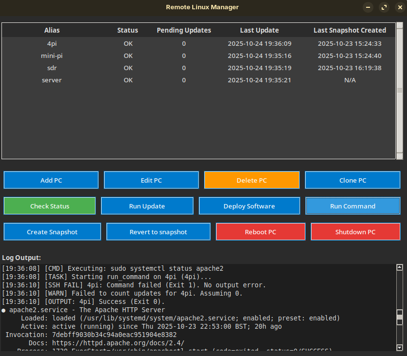

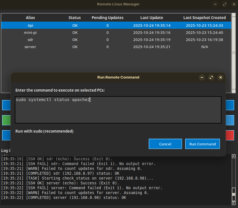

  • New version has send file option and updated run command
    diddy12/09/2025 at 23:49 0 comments
    New version has a 'send file' option where a local file can be sent to the remote pc users home directory
    also updated the 'run command' view with a list of popular commands but the user can still enter their own commands if needed
    also added Garuda Linux to the list of supported Linux pcs so the Linux launcher should now work on all popular Linux distributions

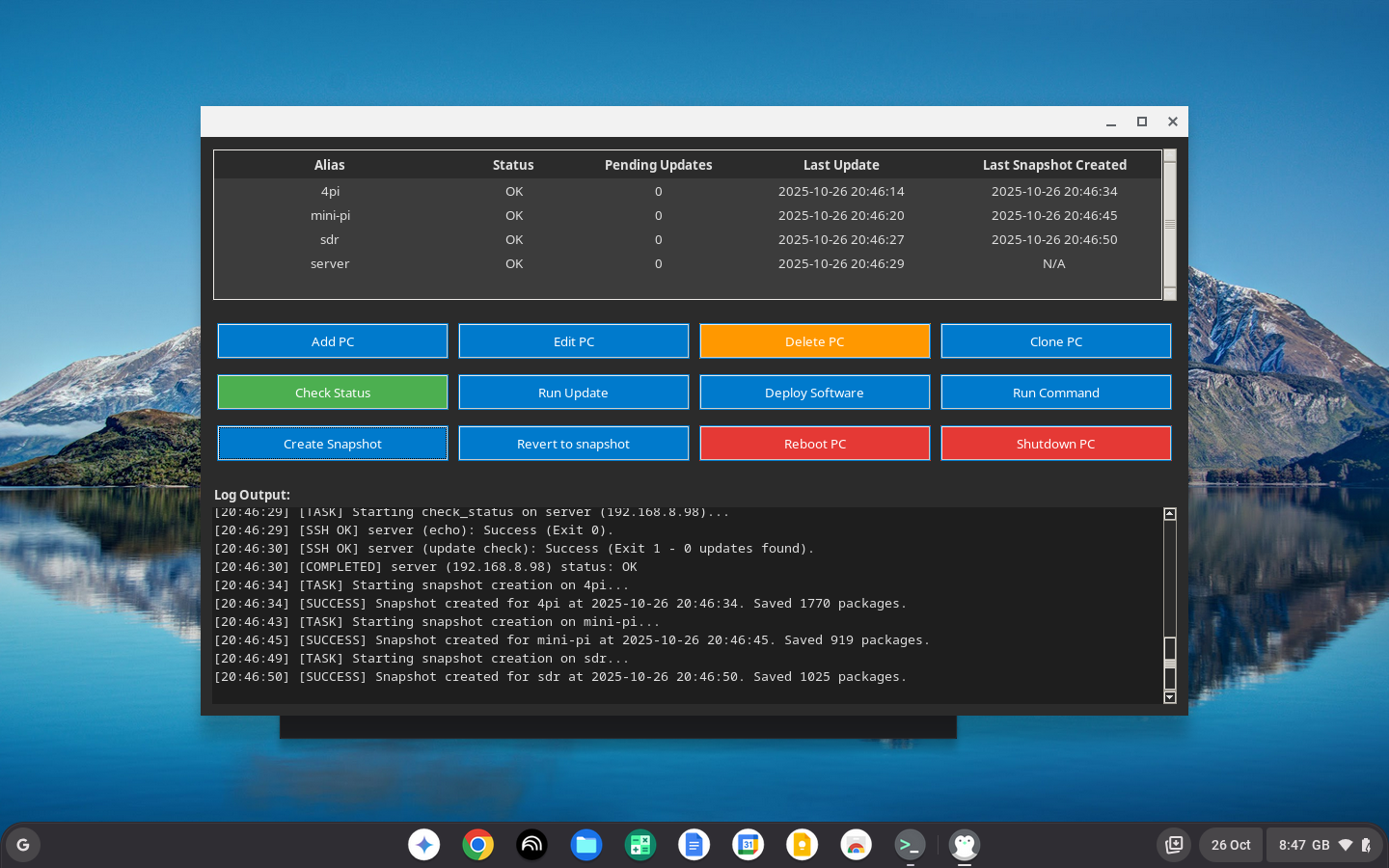

  • New version has colour coded pc list view
    diddy11/04/2025 at 20:21 0 comments
    New version has colour coded PC List view that ties up with the colour coded activity log view.
    so now its very easy to follow each pc's log output.
    if running on the linux development machine under chrome os, to fix the pc name lookup, install the following on the chrome os linux temrinal :-
    sudo apt install libnss-mdns
    sudo apt install samba winbind libnss-winbind
    edit the nssswitch.conf file with :-
    sudo nano /etc/nsswitch.conf
    edit the hosts to use wins name lookup so it should look like :-
    hosts:          files wins mdns4_minimal [NOTFOUND=return] dns
    save and exit. now the Linux remote app can be ran up with cd /manage-pcs
    ./linux.sh
    Running on Chrome OS Flex
