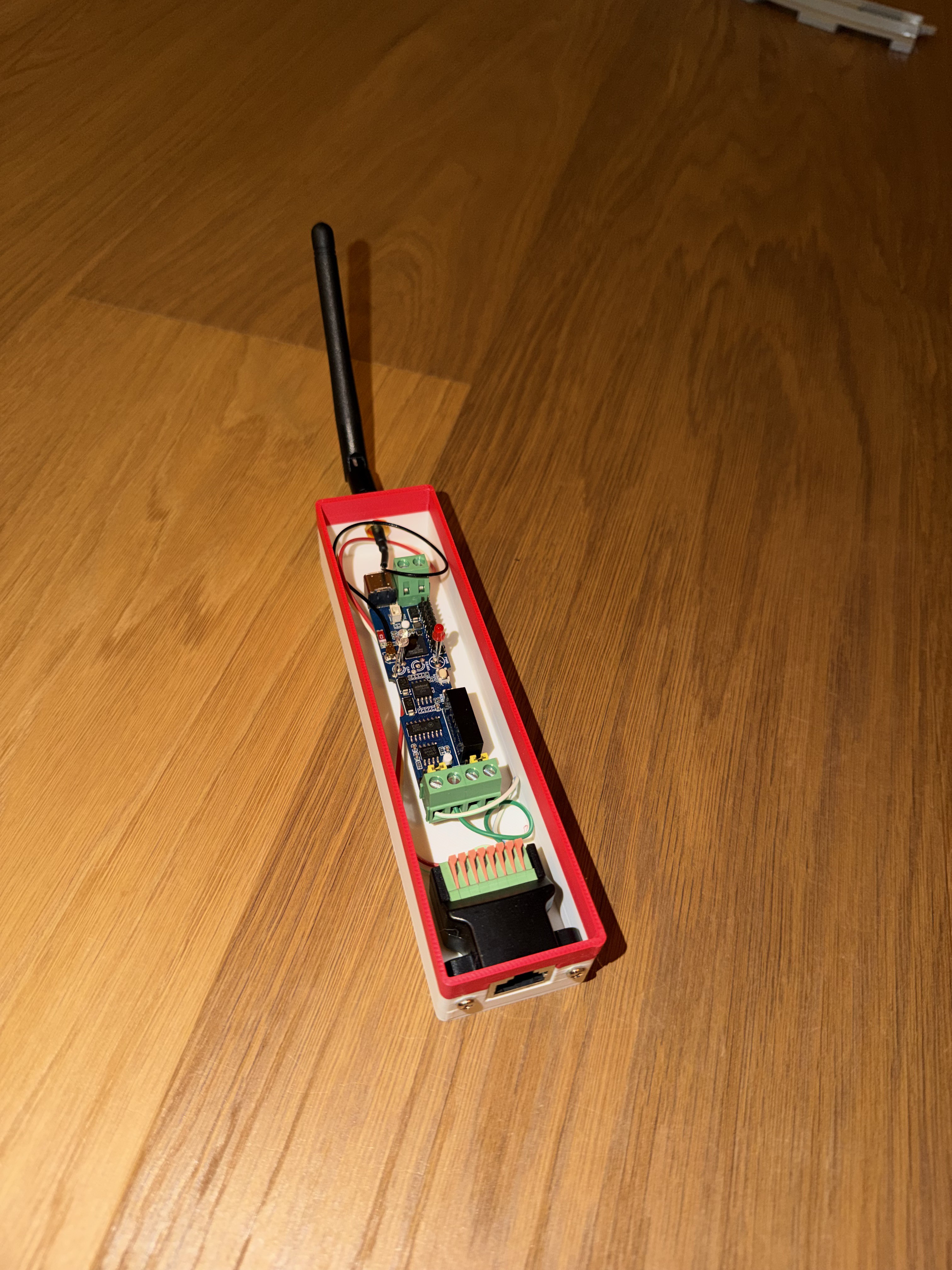

    existing complex firmware works perfectly on another non LCD ESP32 S3 device with CAN transceiver integrated ! Only change needed are the pins<->GPIO mappings. Future version should include auto board detection.

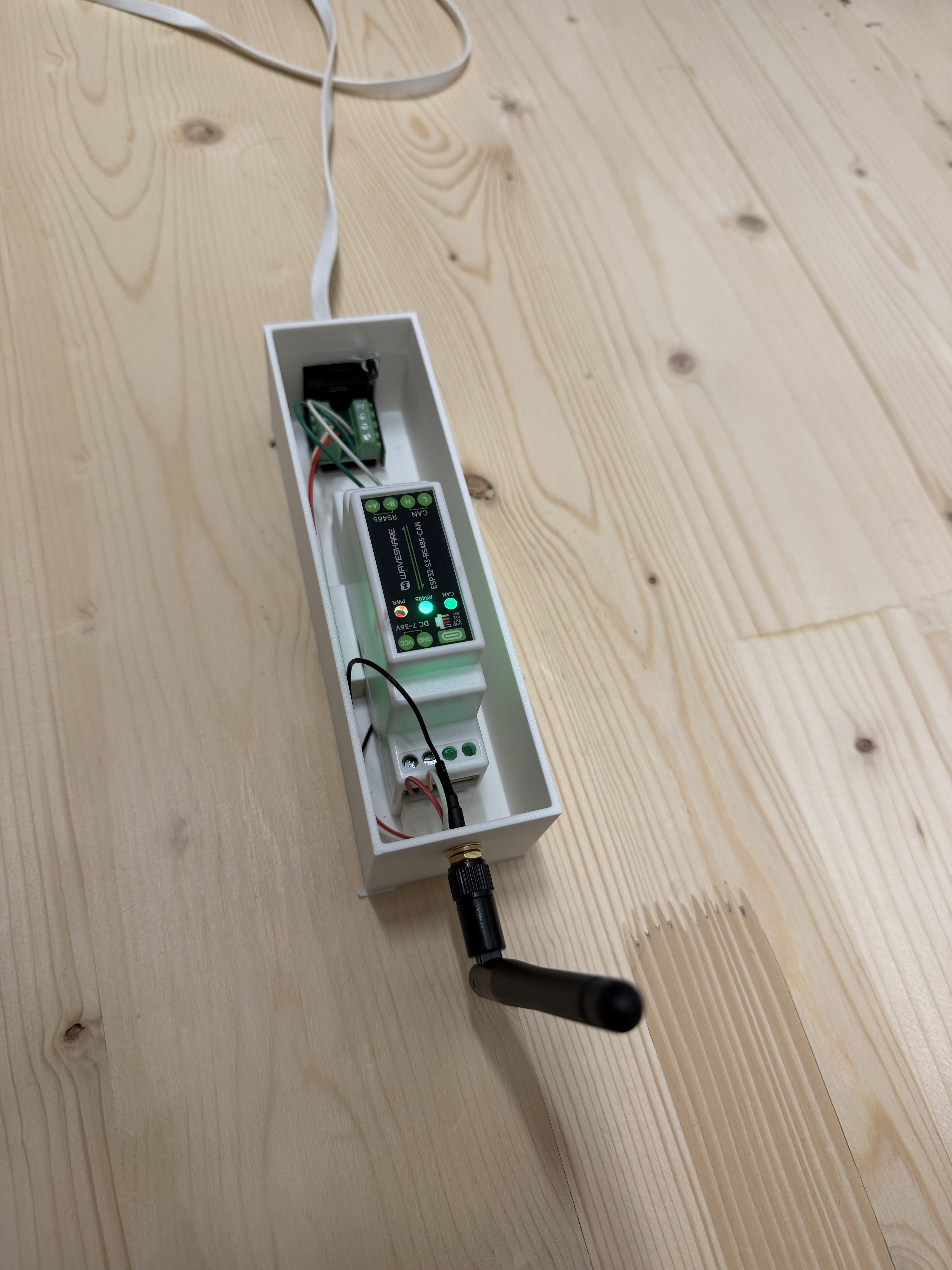

    couple of pictures with new enclosure

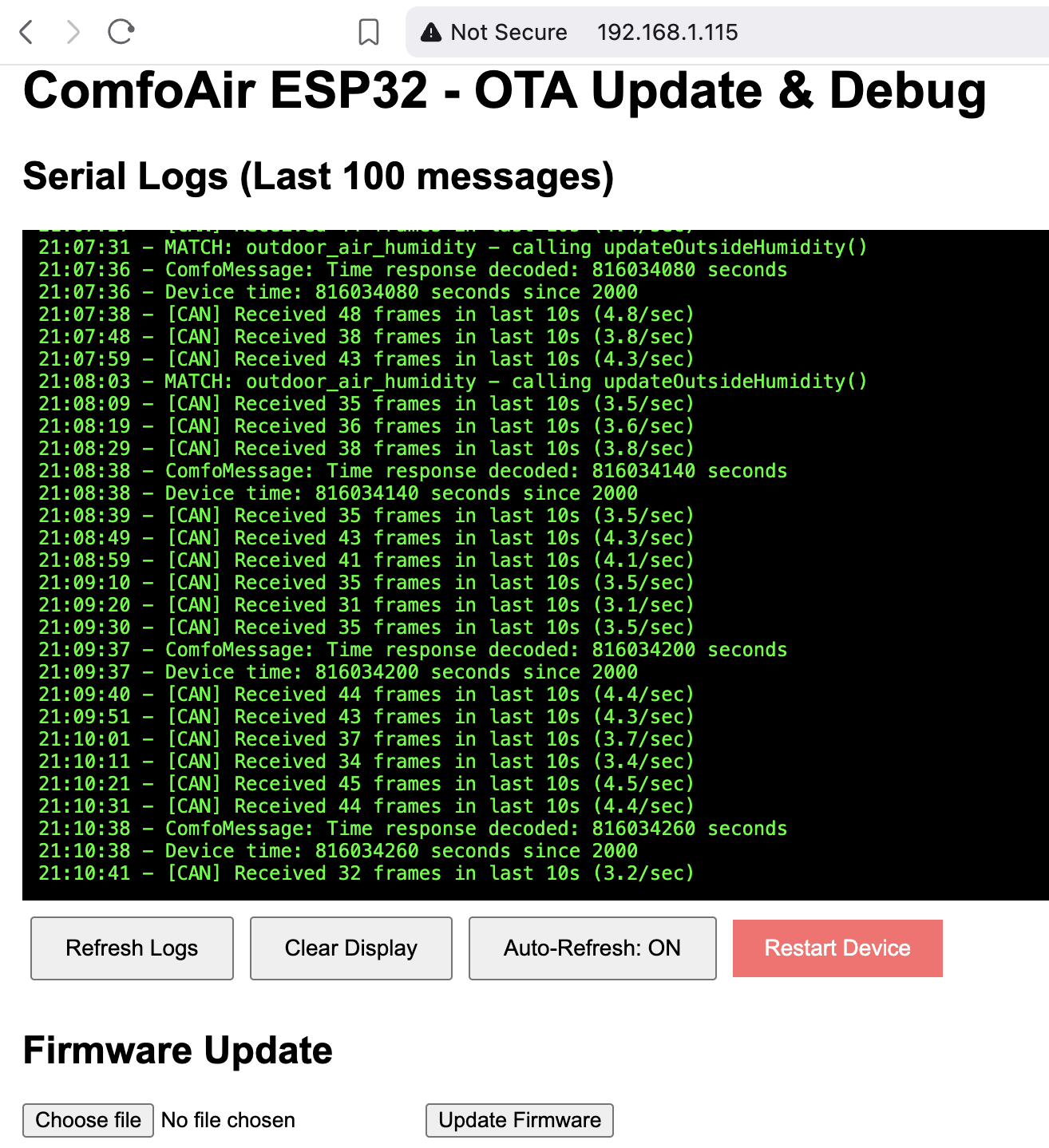

  • Added Serial via OTA

    I was getting tired of running  up and down to the attic or debug in the attic itself so I've implemented a serial output OTA display

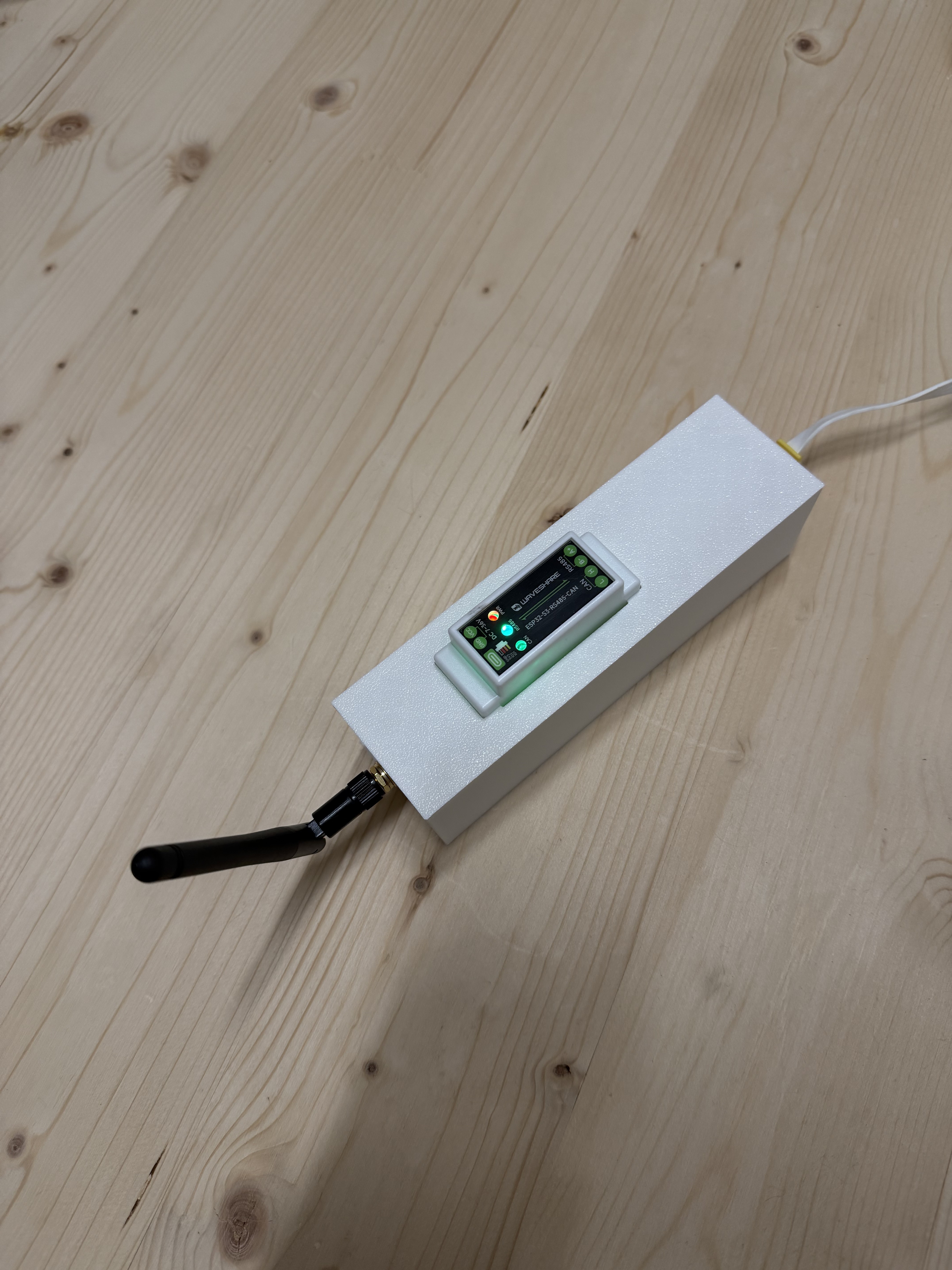

    I will also publish my own version in a single board which can be hooked up via the RJ45 port directly but here's a preview in the meantime
    The benefit of this mode is the display doesn't have to be hooked up to the Comfonet and can be installed anywhere in the house, as a secondary controller.
