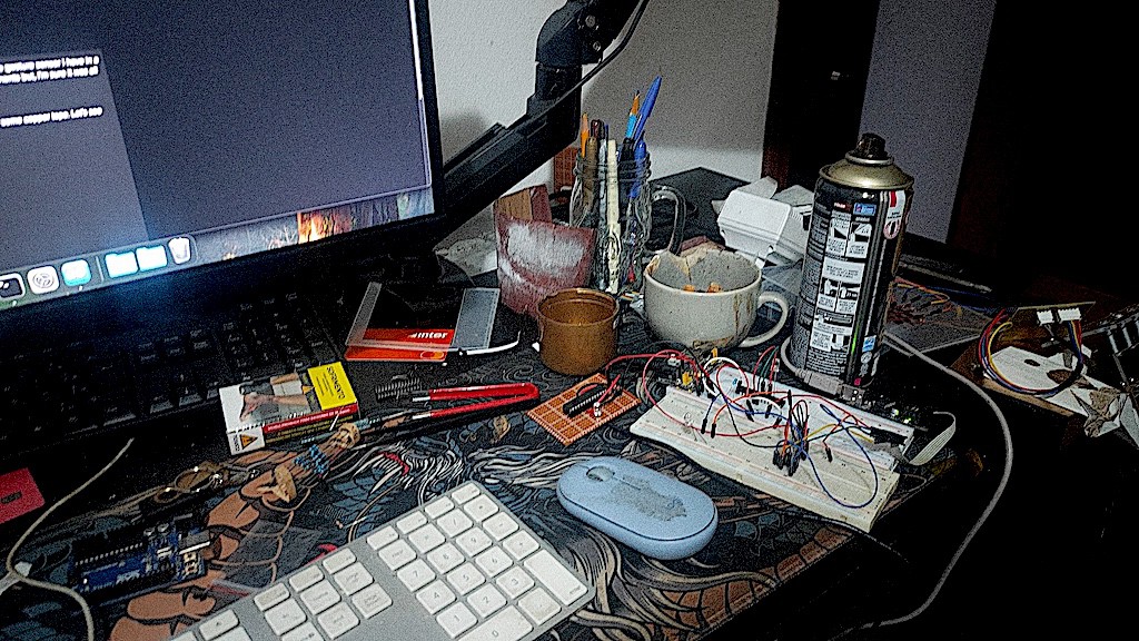

    So, at first I was trying to use a rotary encoder for the media control, after some rage outburst I remembered of some gesture sensor I have in a box here, tried with them, no success again – another rage attack... I was going to blame the cheap chinese components but, I'm sure it was all my fault...
    Now – as I think I haven't suffered enough – I've decided to try a gesture touchpad using an ATMEGA328P and some copper tape. Let's see where I can get with that now.

    So, it's been a long time since I've worked on a personal project, and i is the first time I log one, I'll try my best.
    Well, the project is somewhat advanced. What is done so far:
    • Design of the module almost at final version
    • Module prototype supports and panels mounted on the table
    • rPi Pico boot selector is working
    • Changed the media control from rotary encoder to gesture sensor
    • Gesture sensor is working fine with the Pico
