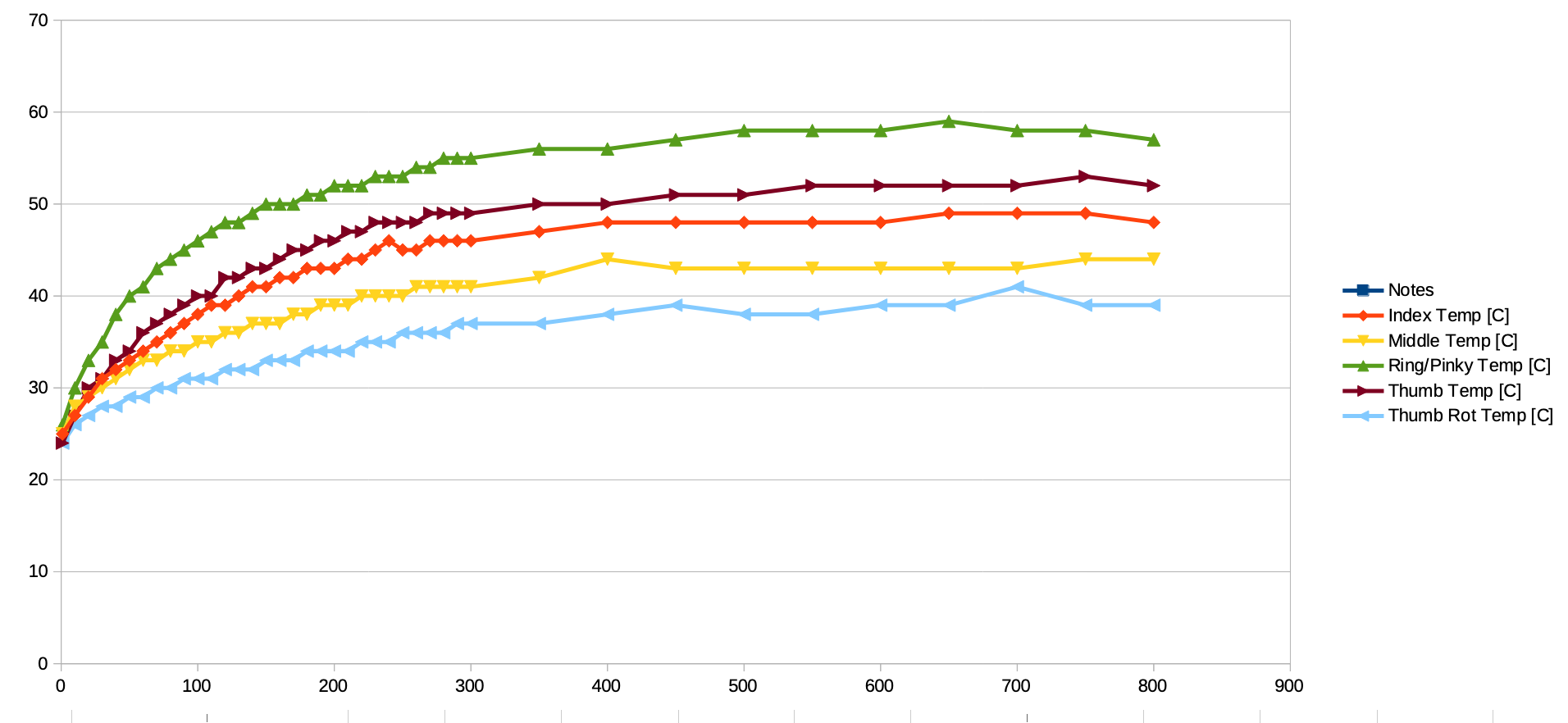

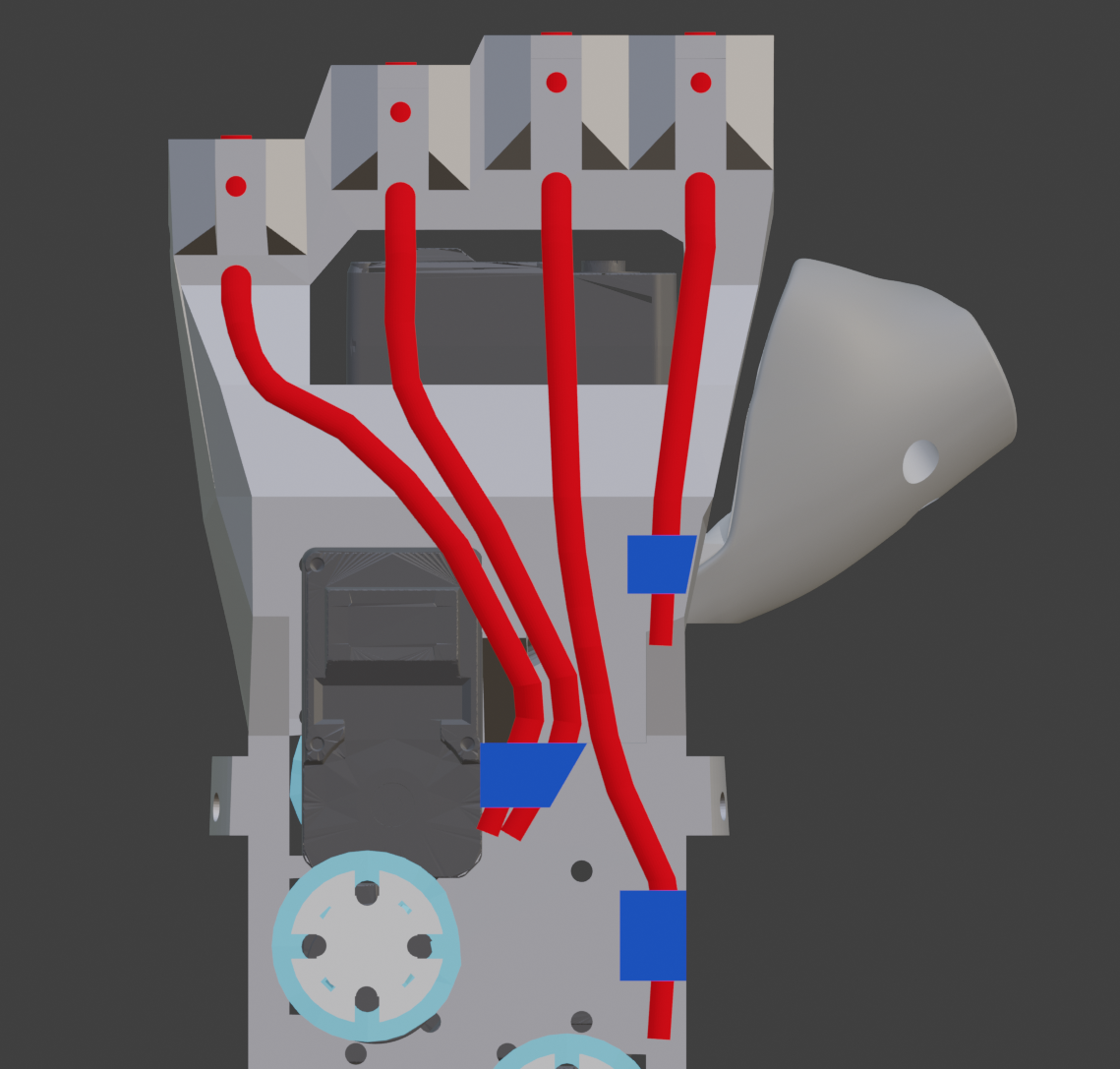

    During the STRESS TEST, an sequence of open/close actions repeated every 10 sec, the ring+pinky servomotor got overheated ( > 67C ), so we decided to reduce the friction of the tendons by tunneling them into PTFE pipes.
    We installed pipes for the index, middle and ring+pinky flexion tendon.
    After this we executed again the STRESS TEST, and the overheating problem was solved: the motor temperature set at 58C, please check this graph:
    In green we can see the ring+pinky servomotor, setting at 58C after 800 repetitions.
    The CAD was updated as in the screenshot below.
    In RED: the PTFE pipes.
    In BLUE: the pipe holders, incorporated into the skeleton part.
    PROBLEM: Now, how do we lock the PTFE pipes in the holders
    We tried with Loctite unsuccesfully, it doesn't work with PTFE !!
